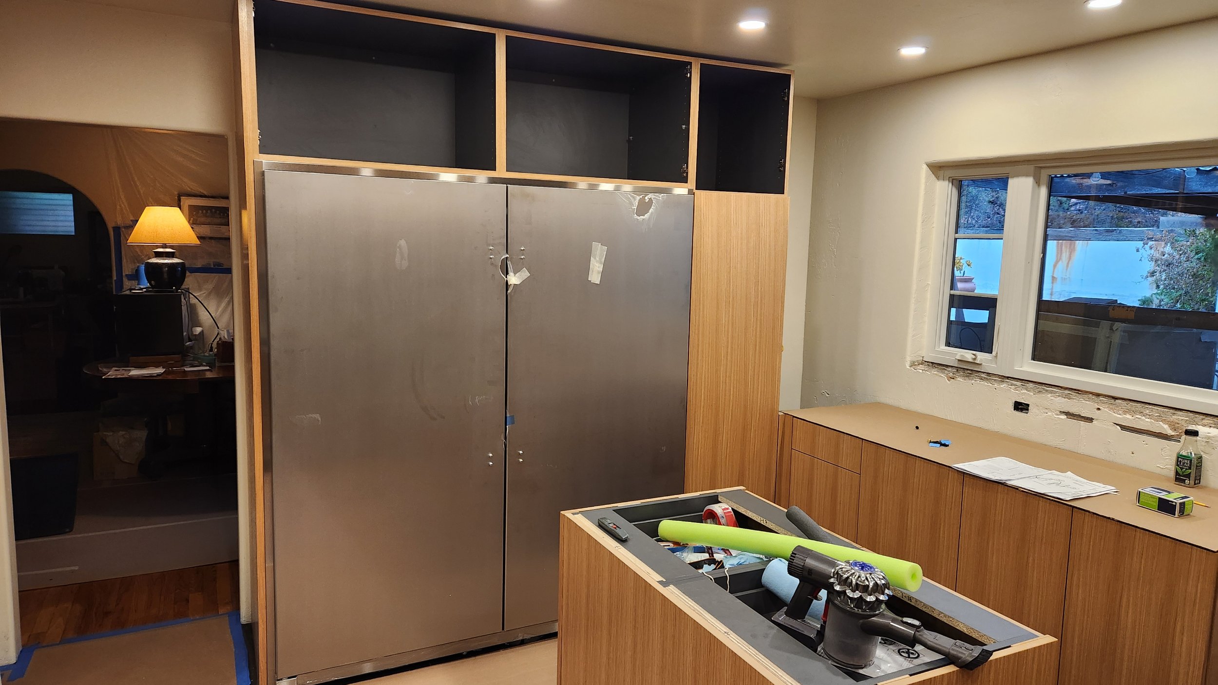

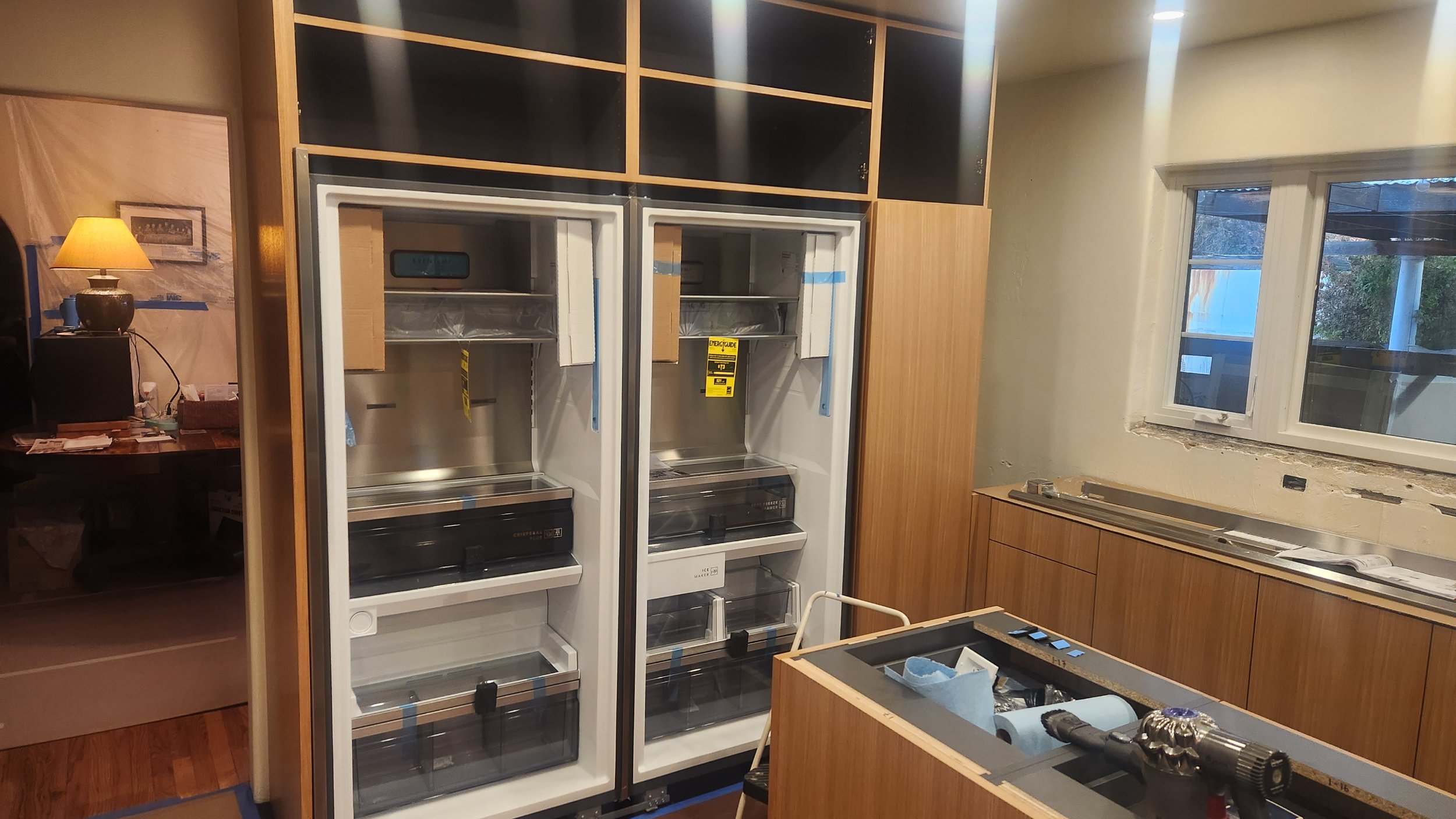

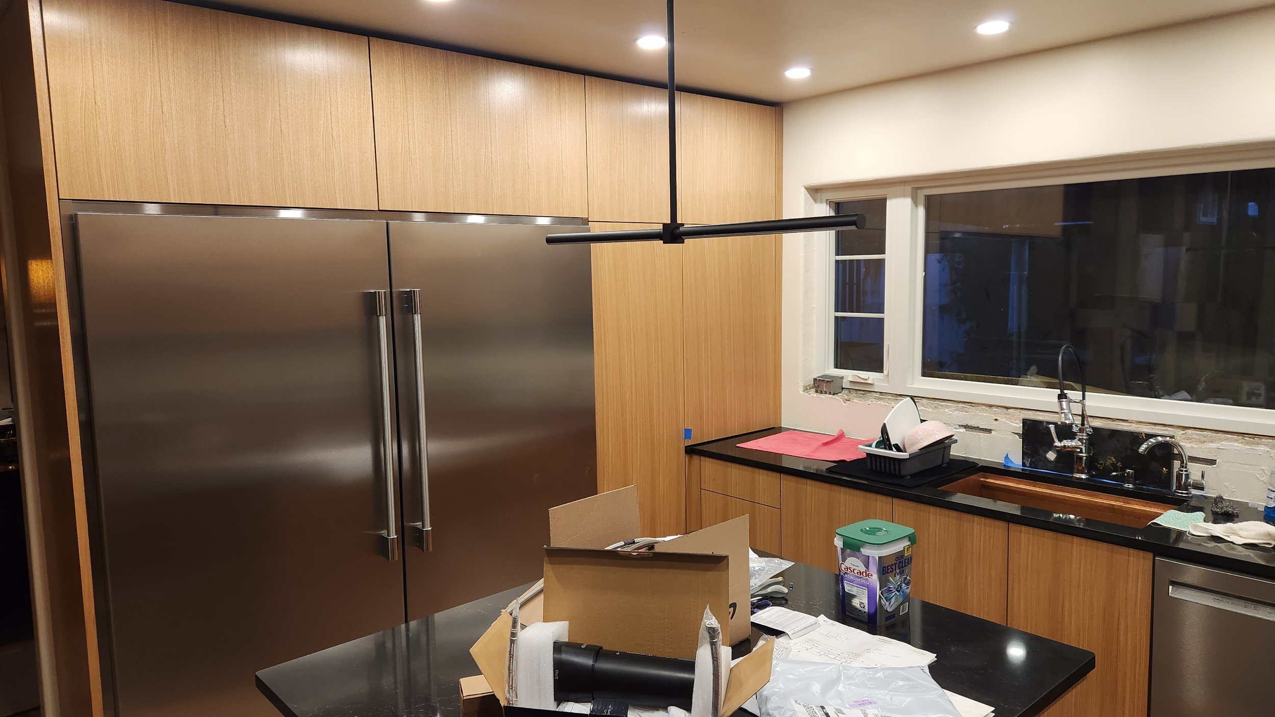

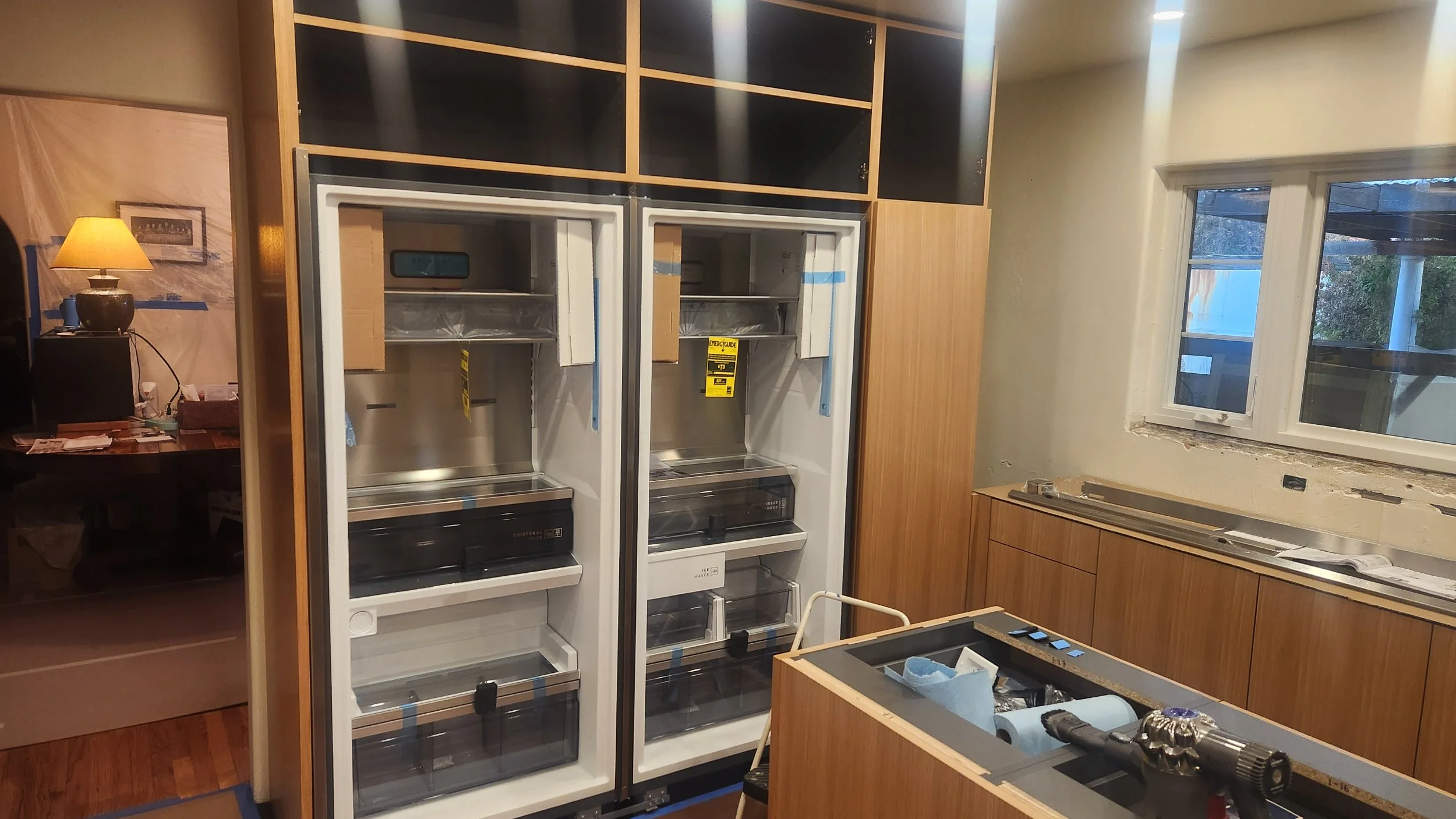

Got the column fridge and freezer installed, took almost 2 days. First you install the pairing kit which fastens everything together to make it one single unit, wheel kits, water pairing kit so you only need one water feed for both units then the heater kit that goes in between them. Also had to reverse the doors because we wanted the fridge on the left.

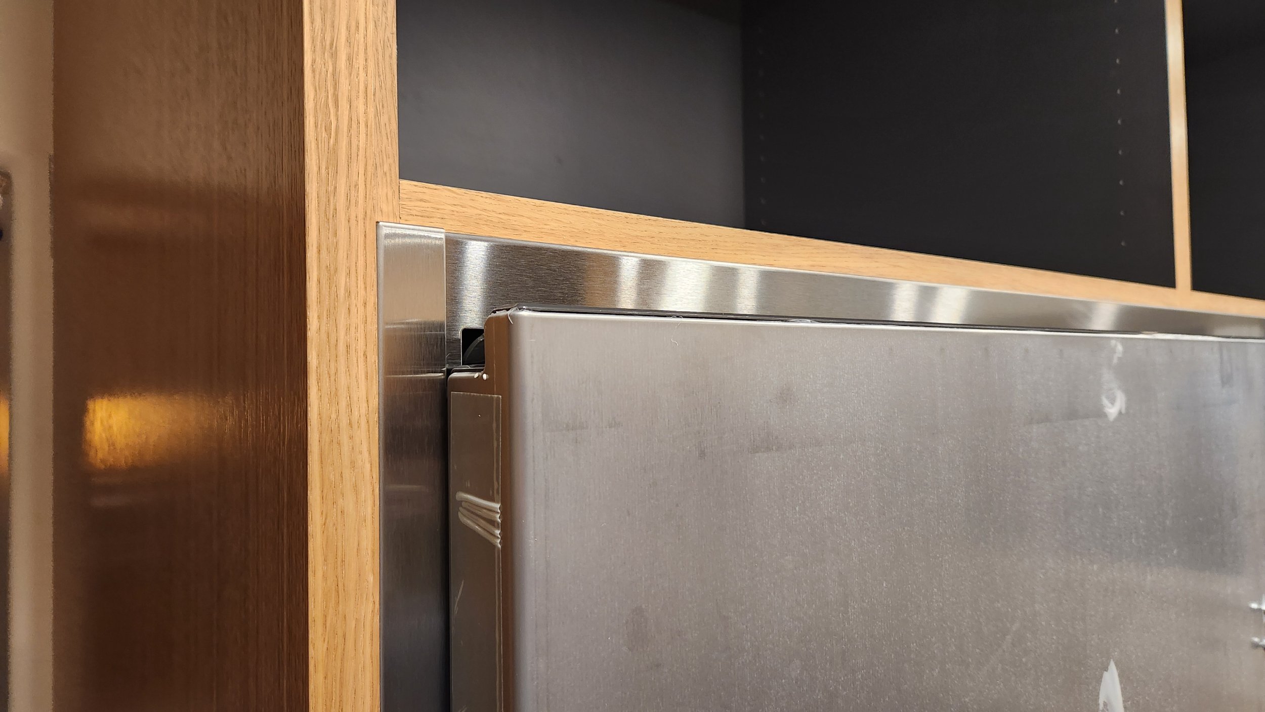

The upper cabinets have been removed twice now because they didn't fit the first time so he made them shorter but we still needed another 5/8" to fit the trim kit so he pulled them again this morning, took them to the shop, shortened them and brought them back after lunch. Thankfully the errors are all on him and won't cost me anything.
The instructions for the ice kit and the trim kit were piss poor and the supplied assembly screws were terrible. I had to drill the stainless trim kit in 4 places where they drilled the holes in the wrong place. Technical support is non-existent, all you get is someone from India reading out of the same instructions you already have
I sure miss the days when you called for support and you got someone who knew all about the product and was easy to understand.

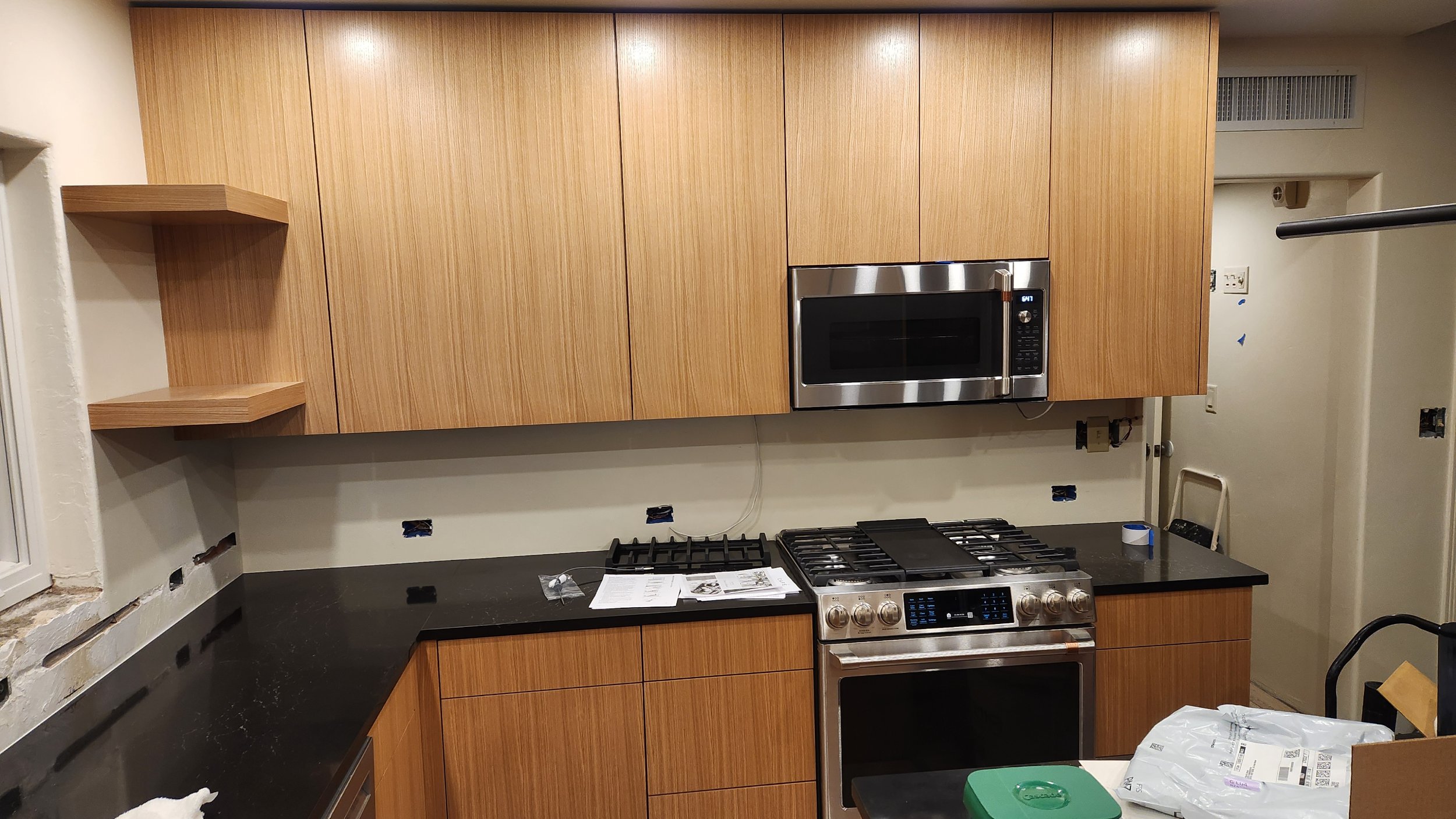

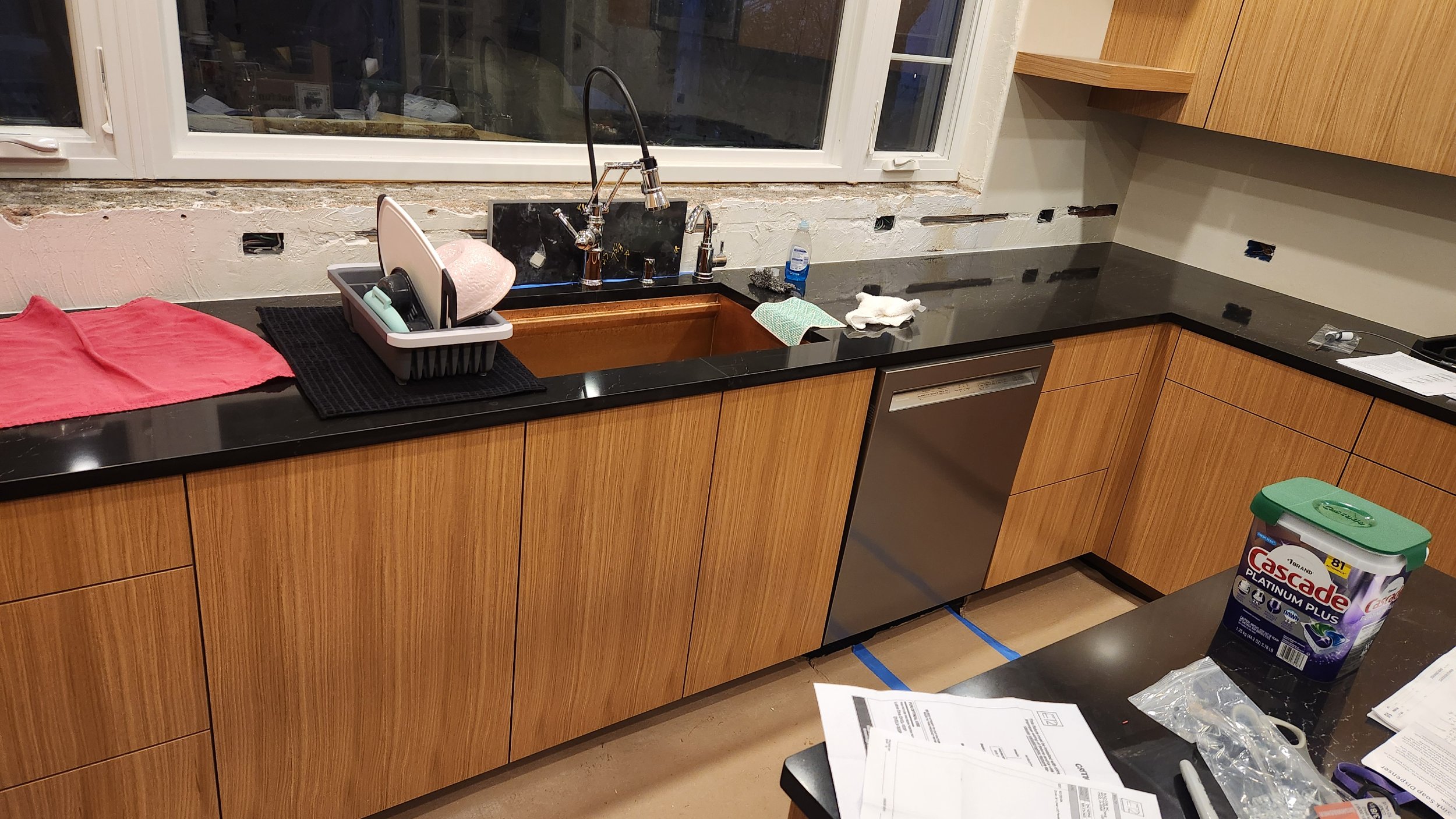

Will fire up the units tomorrow then start on the range. Countertops coming Tuesday. The corner by the window gets an appliance garage after the counter top goes in.
