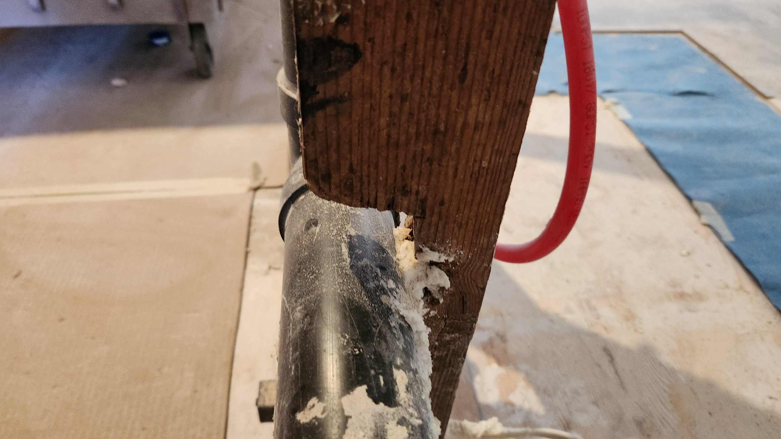

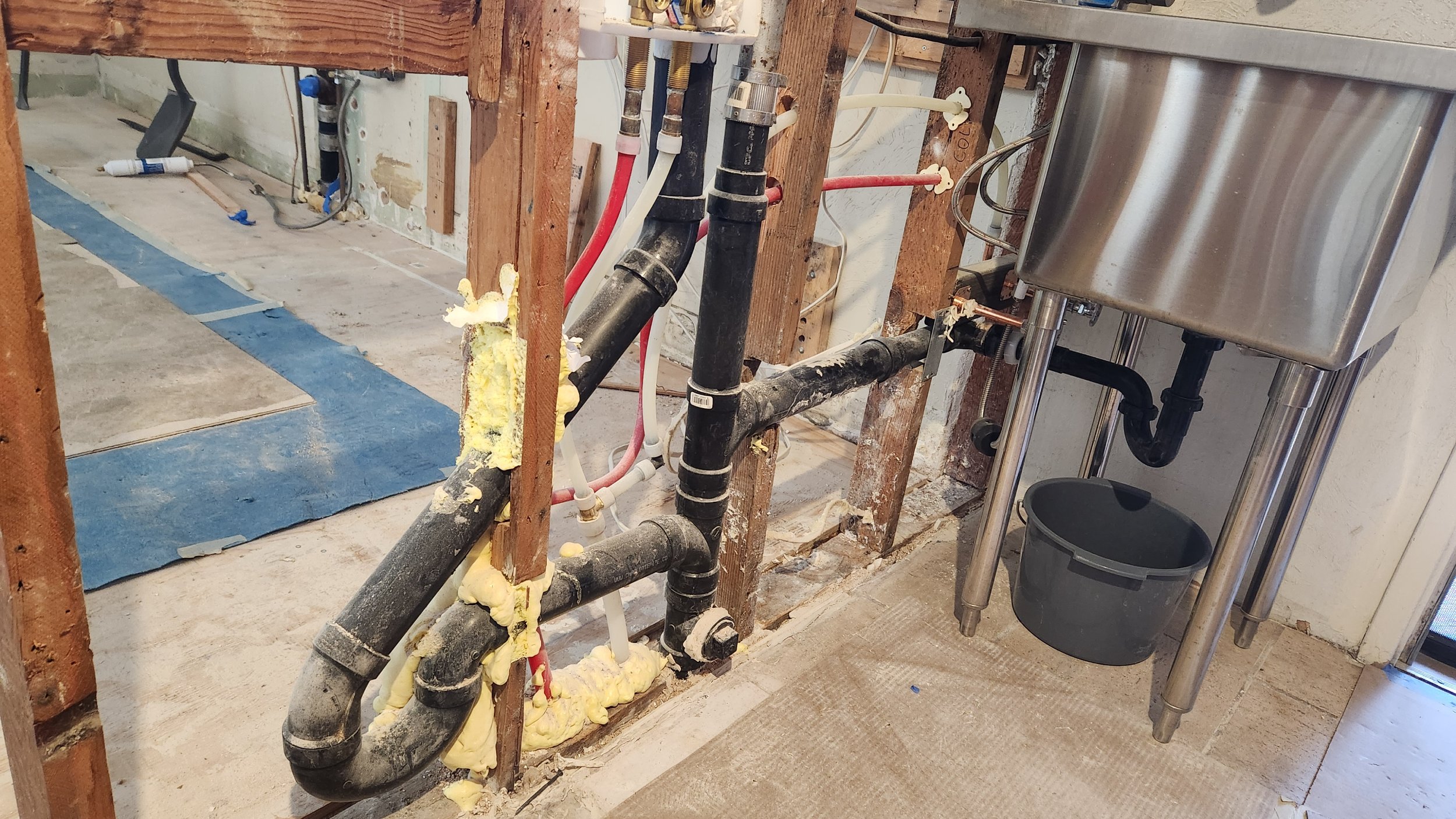

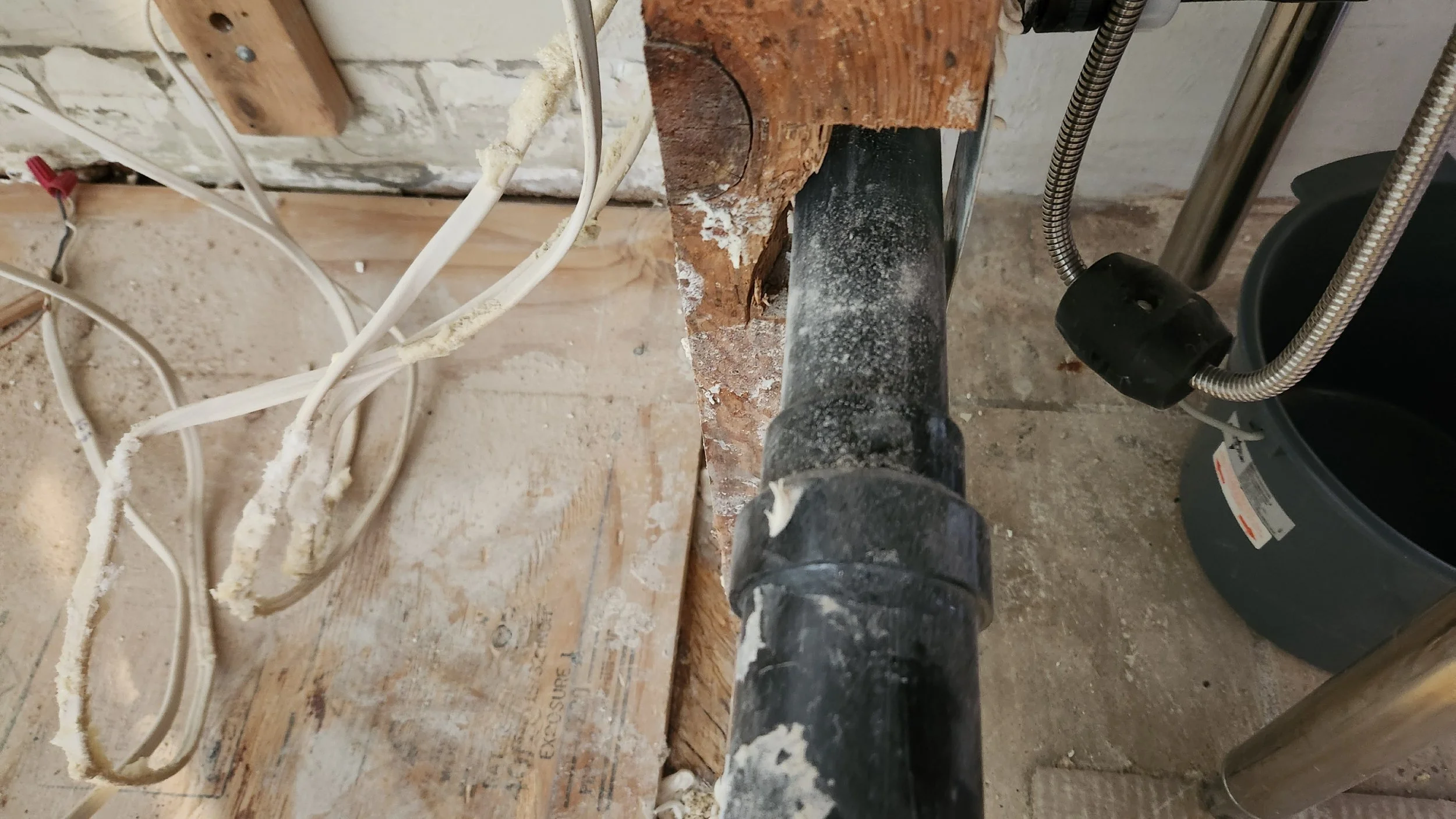

Thanks, the luan is a good idea. one side needs 1/2" and another side needs 1/4". Then I have 3 studs (2x4) in a row that got hacked pretty bad for a 2" laundry sink drain pipe and that's a bearing wall holding up the kitchen ceiling. 1 stud is totally trashed and 2 more are notched about 2/3rds thru. I'll get some FHA straps to put over the notches plus I have room to add 2x4s or 2x6s perpendicular (turned so the wide dimension faces out to the drywall) from the bottom plate to the top plate and nail thru the damaged ones into the new ones all the way up.
Can you show me a picture of those compromised studs?

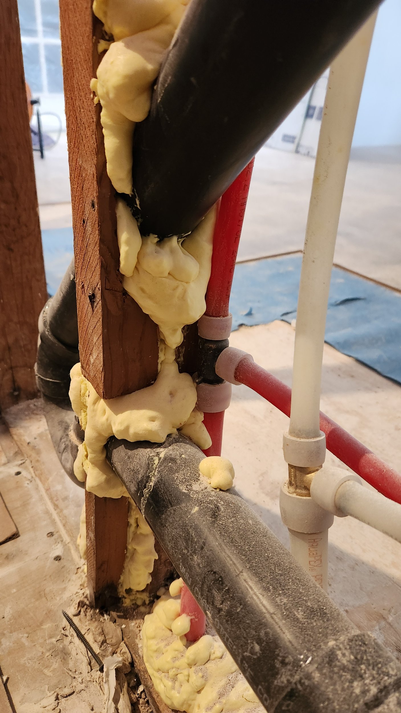

Originally it was only 2 notched from the original construction but I had a plumber move the laundry sink farther to the right and they notched a third one, plus they moved the washer box over and cut into that first one that was already notched for the old 2" steel drain pipe. They replaced everything with ABS and PEX at that time and I foamed to keep mice and bugs from coming into the bays from the crawl space. I'm thinking about moving the washer box back where it will be accessible so we can shut off the valves when traveling. There will be a 12" base cabinet between the pedestal washer and dryer and it would be right above that. I know most people would want to hide that but I don't see the point, it's a utility room.
If I move the washer box back to the left that would give me the opportunity to cut the pipe and drill a new stud to slide over the pipe, but with a 2" pipe there just isn't going to be much left even then.
For your sake, I do hope that's a non-bearing partition. ;)
nope. load bearing w/double top plate and two of the cuts have been there since the house was built in 1952. Have some options for repair and will wait to see what Andy says. A 6" wall would have been nice but I don't see any good way to do that now.
Reactions: chili_pepper
Safe to assume you don't have the space to fur out a 2x4 non-bearing "wet wall" of sorts to shift the bulk (not all) of the plumbing to in your planned renovations? That would allow you to shore up that bearing wall a bit.

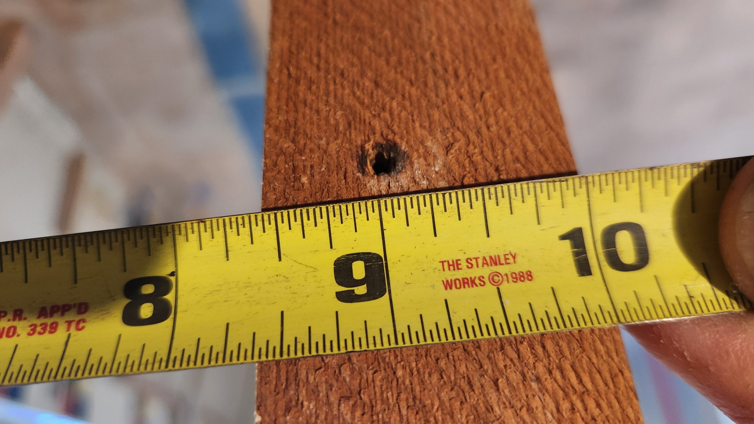

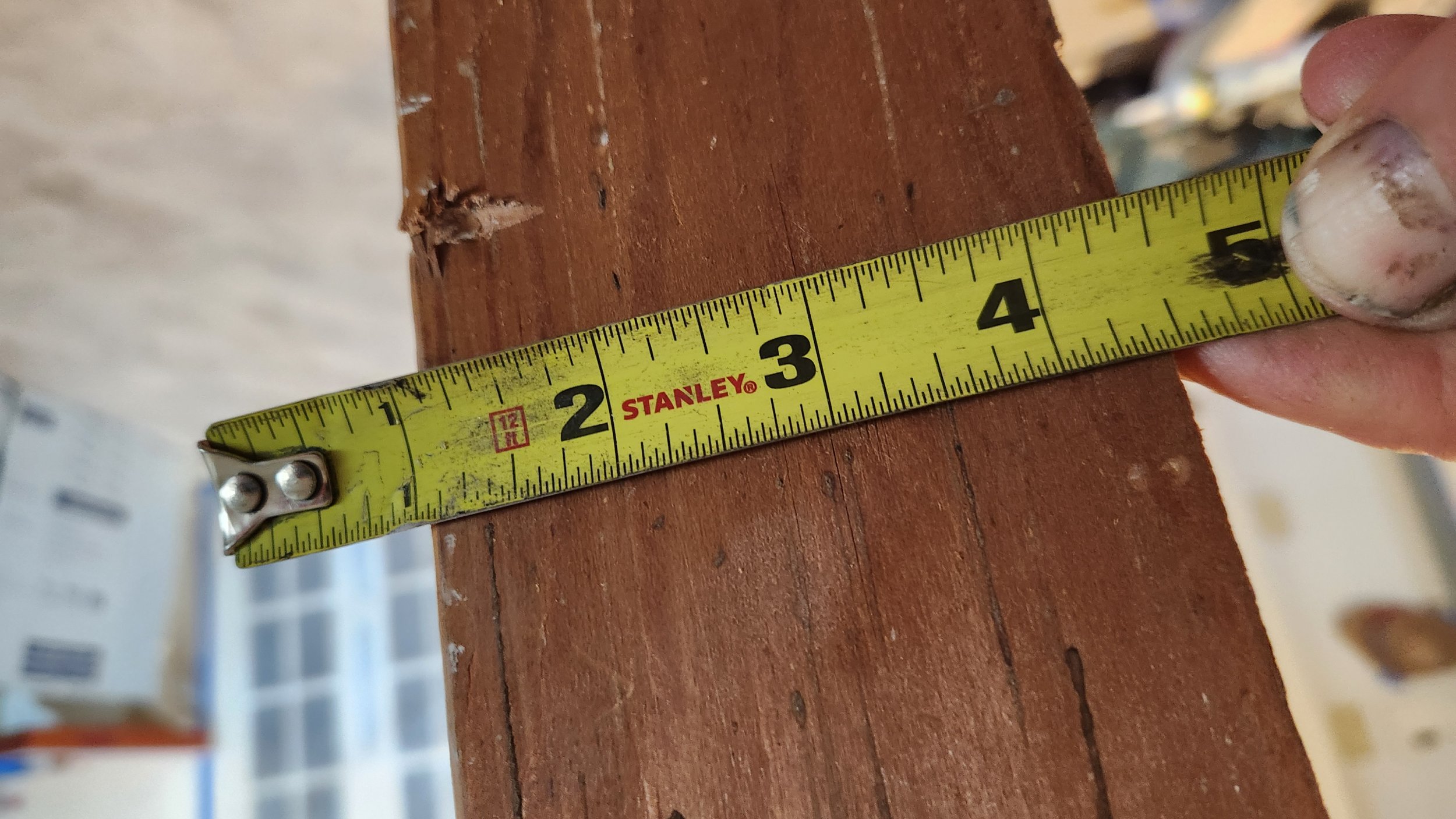

Mine appear to be slightly larger than new 2x4s but not as big as true rough cut? 1-11/16" X 3-1/2 to 3-5/8" View attachment 564644View attachment 564645
That's about correct for the era your house was built (believe you mentioned 1952).
Rather unfortunately, the dimensioned lumber available today can still be a bit off the mark, depending on the mill. I'm having issues on a current job at work due to this very thing.
Reactions: AndyG
Notice the amount of growth rings in the old ones vs. the newer. That tells you a lot.
