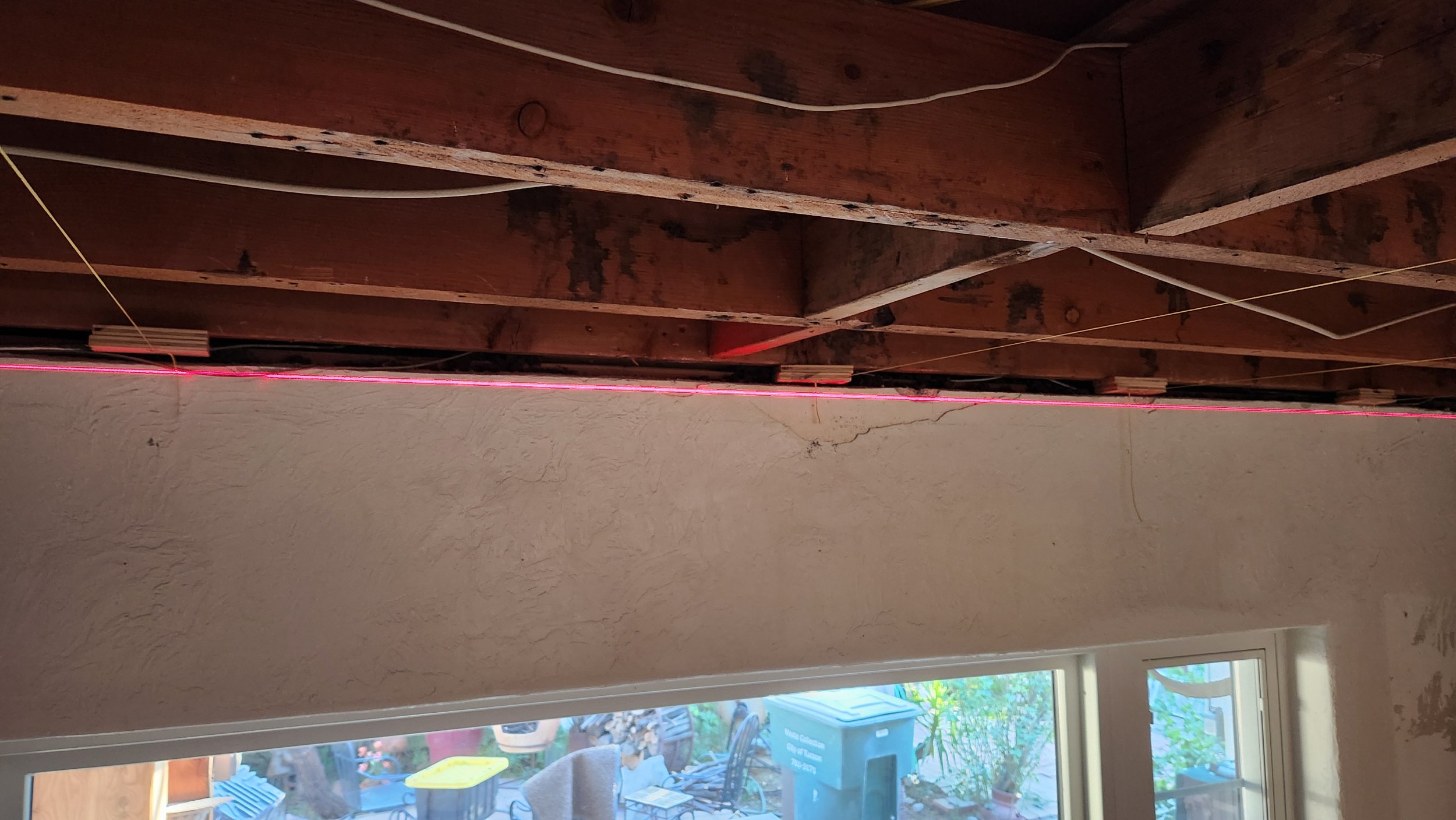

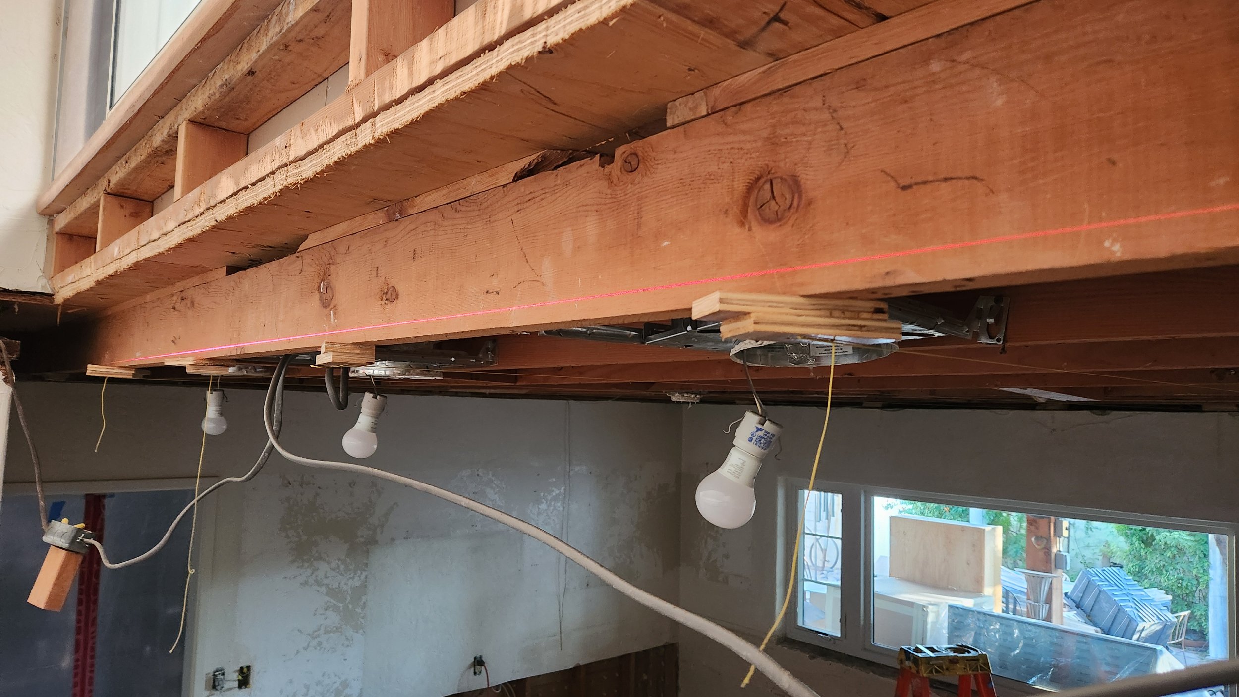

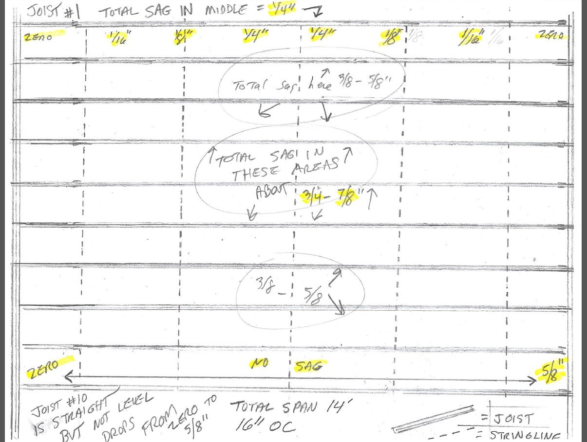

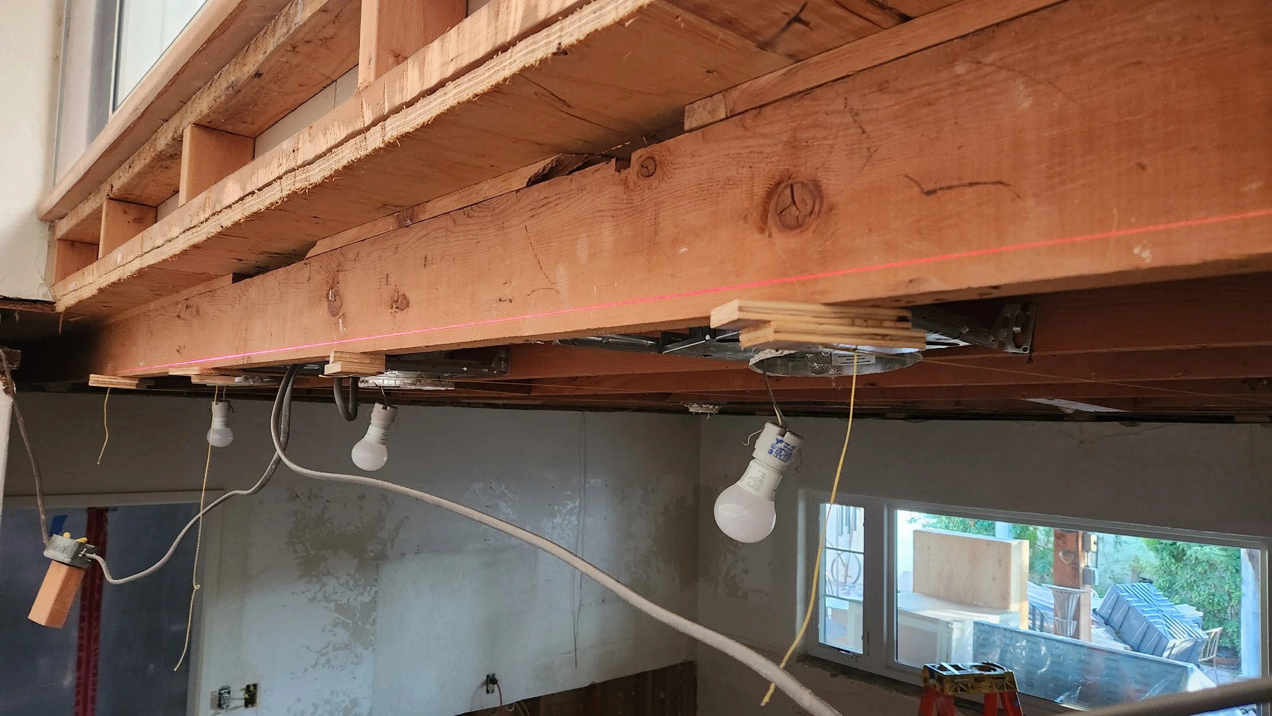

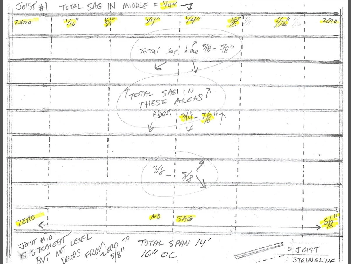

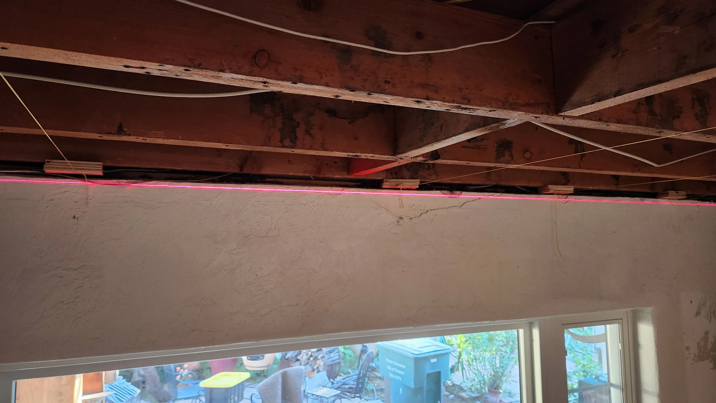

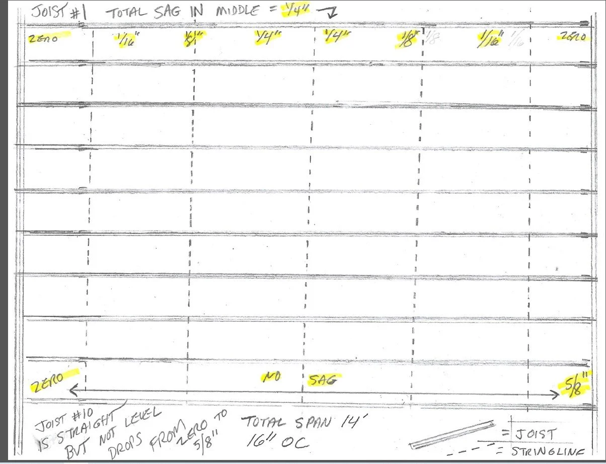

Ran around getting materials today then I set up 5 string lines to determine how much sag there was on my joists. I spaced the string down 1" at the end joists and measured sag at 5 points along each joist, the worst was a couple in the middle at 7/8" total sag in the middle. Then I realized if the first and last joist were sagged it would throw everything off so I got out the laser and found joist number 1 to be sagged a total of 1/4" in the middle. I found joist number 10 to be straight with no sag, however it is out of level by 5/8".
So I can adjust joist #10, and I'm guessing I should attach a 2x4 to #1 and bring it down to match my lowest joist then put 2x4s on all the rest to make it all equal?
I still have my cutting and heading off to do and won't try to level things out till that is finished, but I didn't want to start that late in the day so I decided to check the joists in preparation for what I'll have to do to make the drywall flat.
Note: An 11th Joist to be added to this edge then drywall will wrap around and up to meet window sill. The new joist will reach both bearing walls.

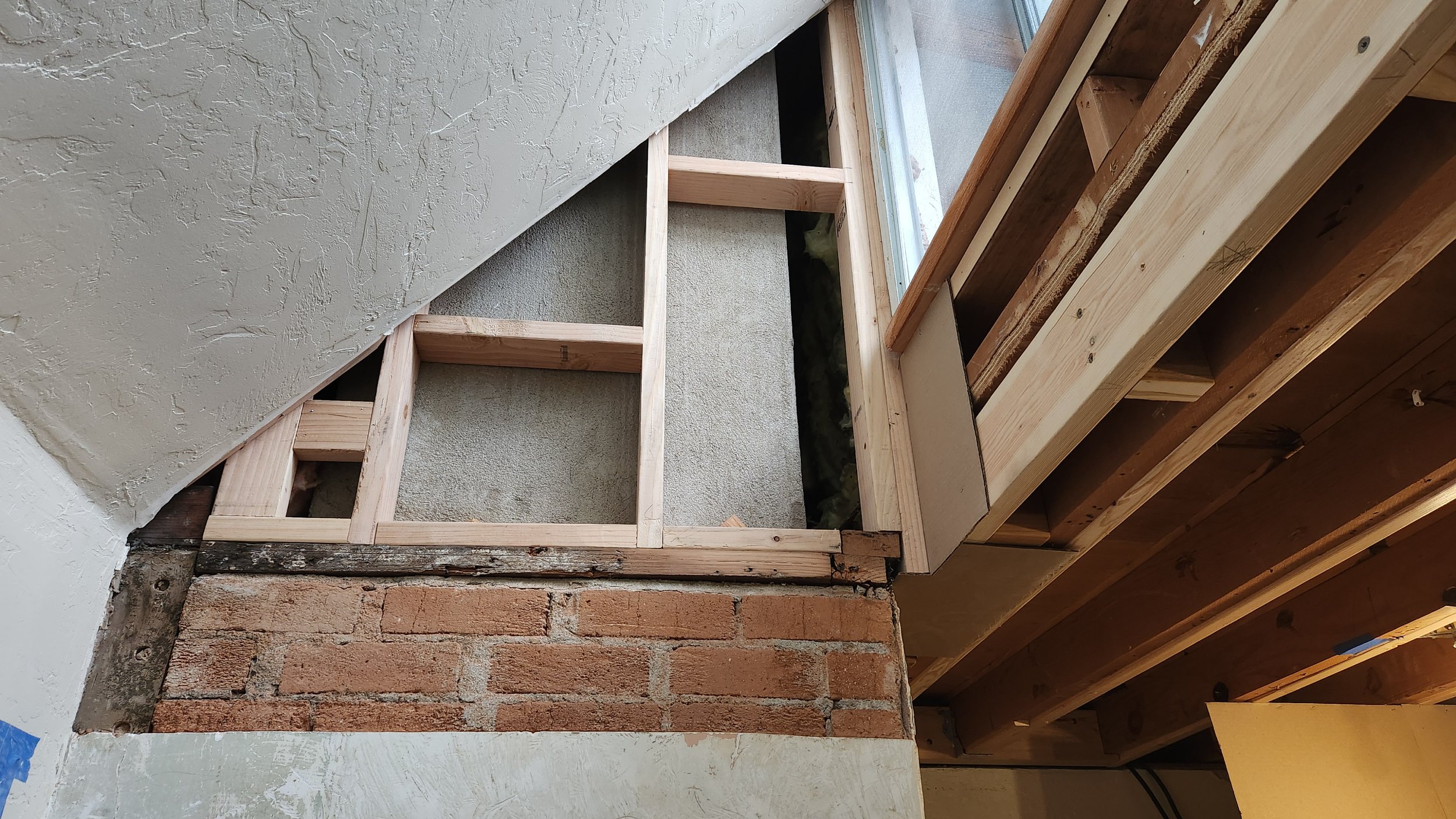

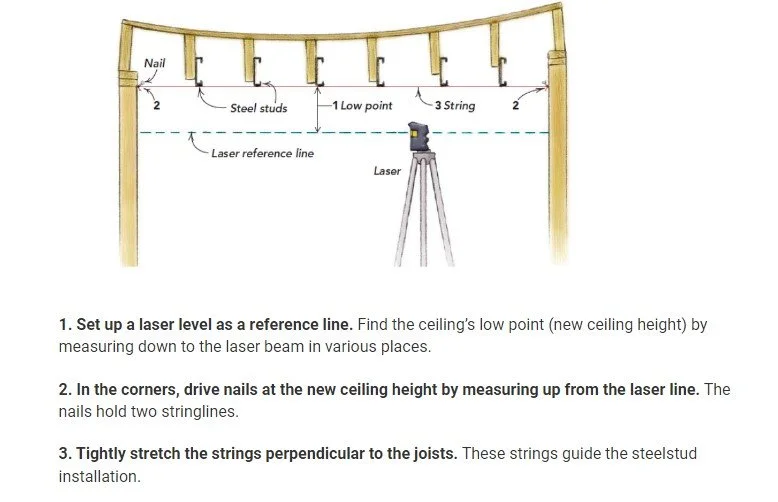

Found this on Fine Homebuilding, looks like the way to go although I'm not sold on steel studs and would rather go with 2x4s. I wonder how much of a challenge it would be to find straight 14 foot 2x4s? Of course a little crown could probably be straightened as they are fastened? I also wonder how much sag would be noticeable, there are no cabinets along either side of the room that will run the same direction as the joists but both walls perpendicular to the joists will have floor to ceiling or base and uppers to ceiling so those ends need to be flat. We're going to leave a small gap at the ceiling above the cabinets, no crown molding.

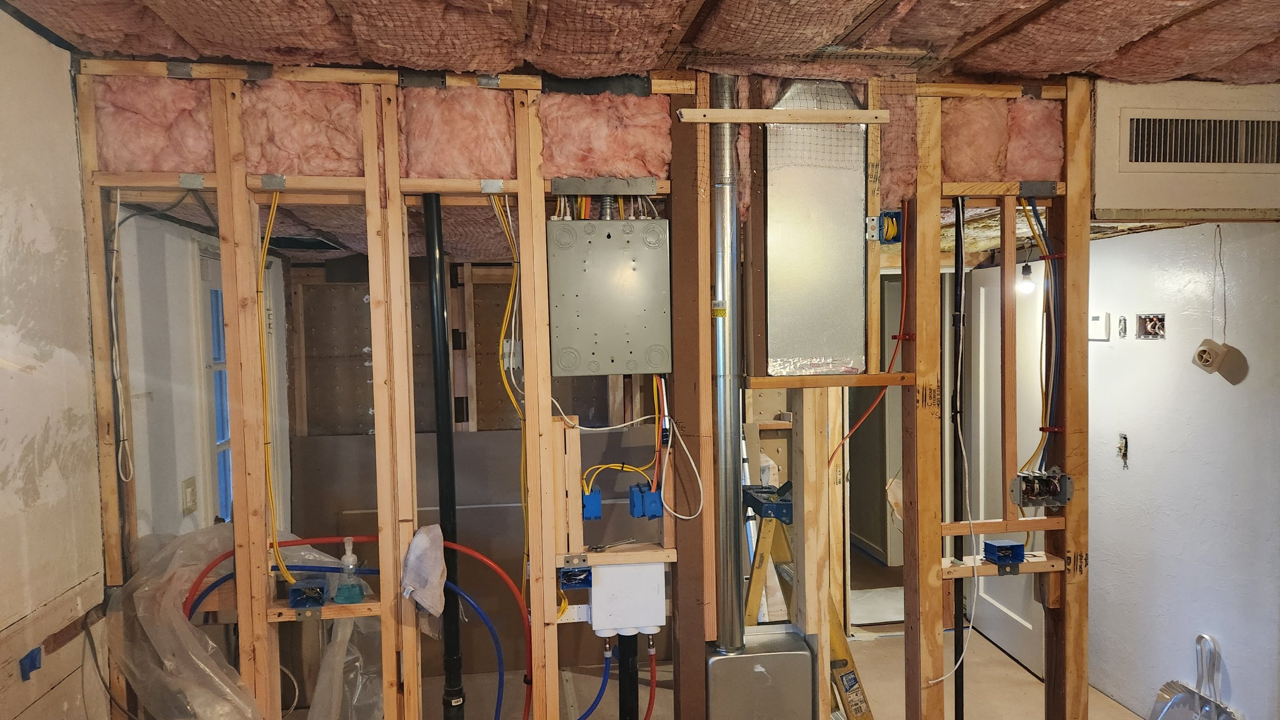

Things are moving along although slow. Can"t get the cabinet guy to return my calls so the plumbing is being held up till he gets us final measurements. Framing is mostly finished and I spent a couple days getting the fire place wall as plumb as possible as we're having it tiled, it was pretty bad and also leans outward about 1/4" from bottom to top. I ground off all the joint compound and got to the original flat plaster.

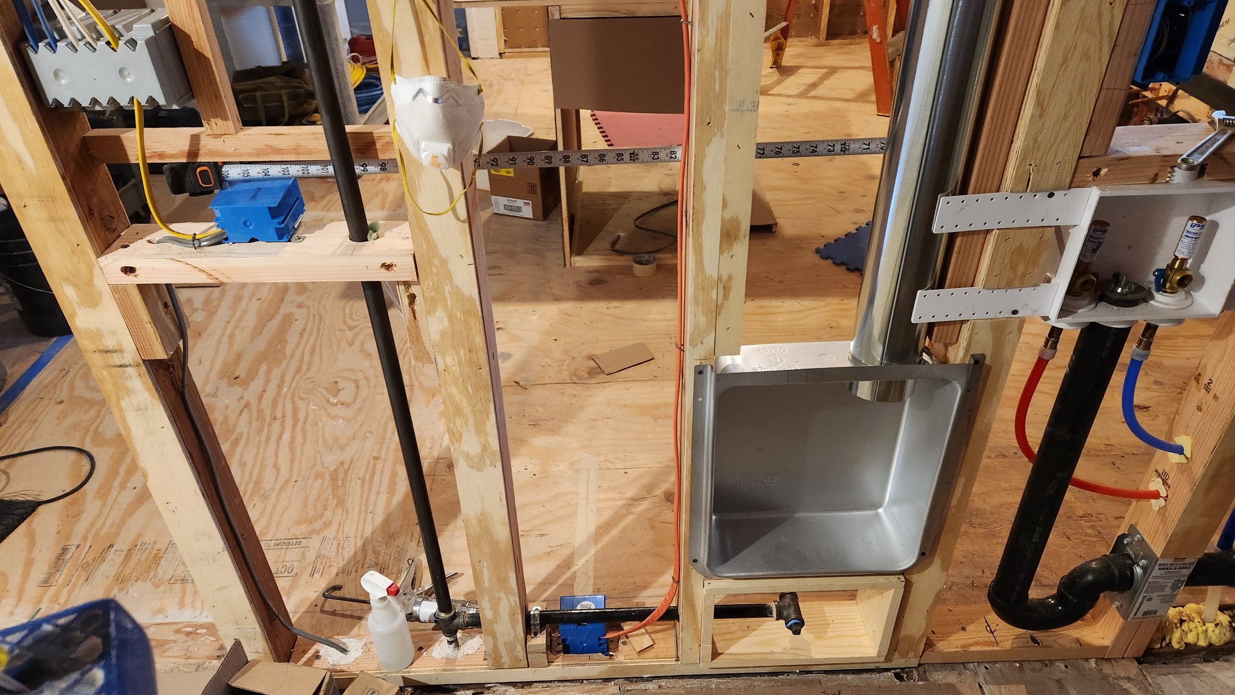

Got the hood vent made and installed in the wall and the dryer box.
I also spent 3 days with a demolition hammer, shovel with the handle cut off, buckets and a wheelbarrow clearing out under the house to make the kitchen plumbing accessible, mainly the gas line which needs to be put inside the wall and go under the house to supply the fire place and to the kitchen and laundry for the dual fuel range and the clothes dryer. Will also add an electric dryer circuit.
Getting to some of the electrical, demoed all the existing for a fresh start. Installed a sub panel today at the East end of the house to take those circuits out of my over-crowded 100 amp sub panel in the laundry so now that one will have plenty of room. Also need to put the feeder in conduit as it was done with THWNs and no conduit from the 200 amp main, now is the time.

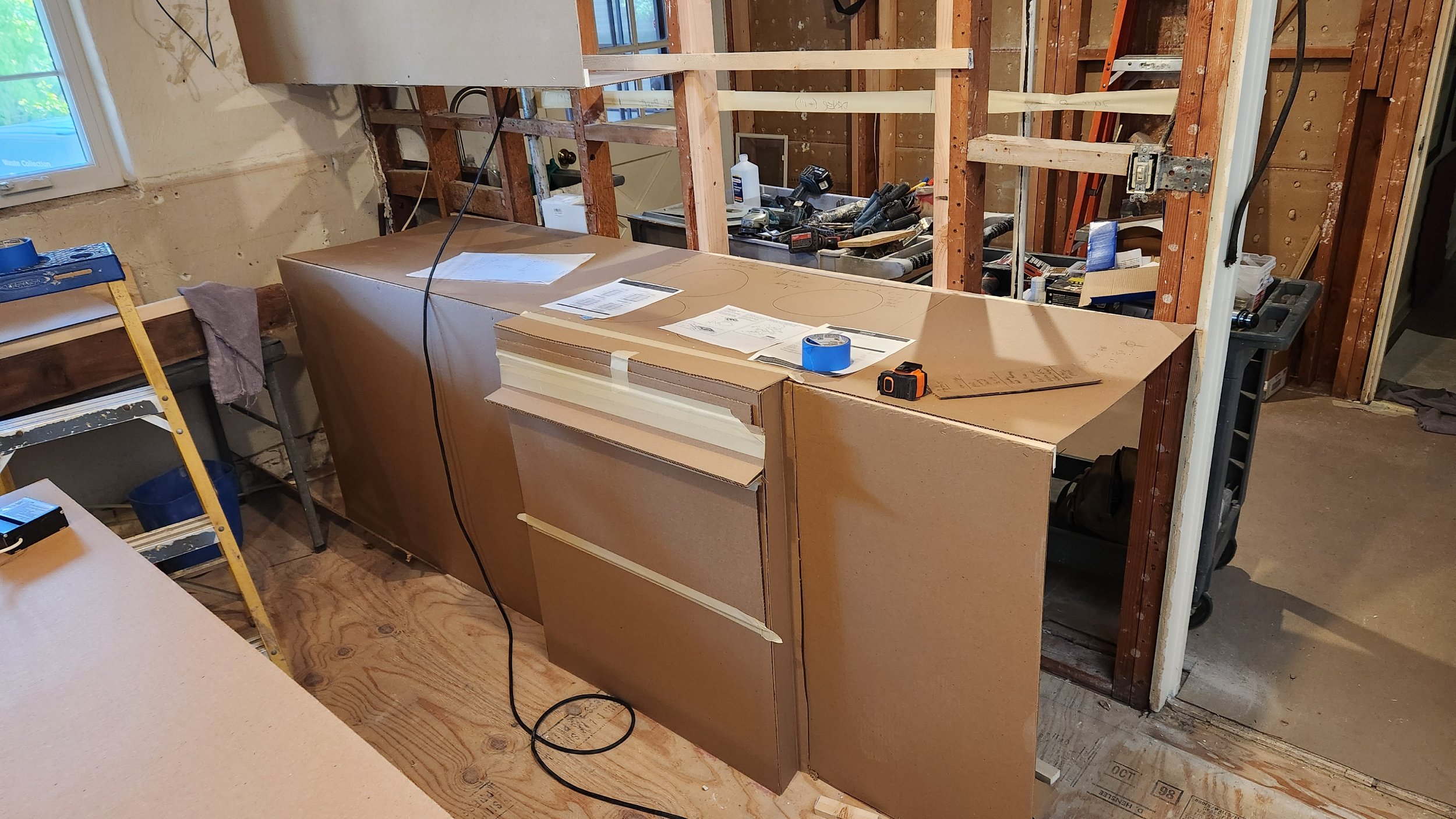

I also made a cardboard mock up so we could see how everything "fits".
It's starting to cool off here at night so next I'll insulate as right now it's open to the attic.

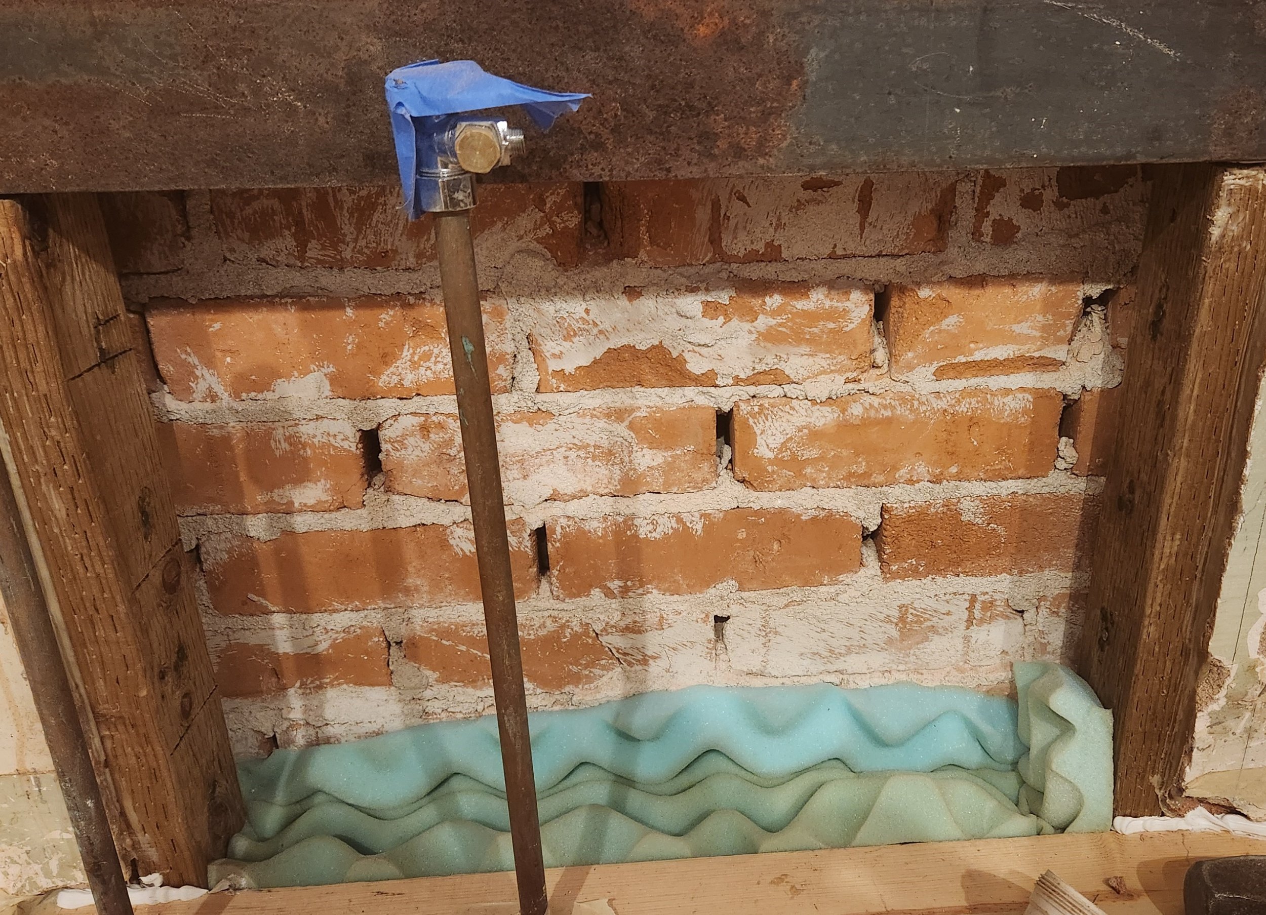

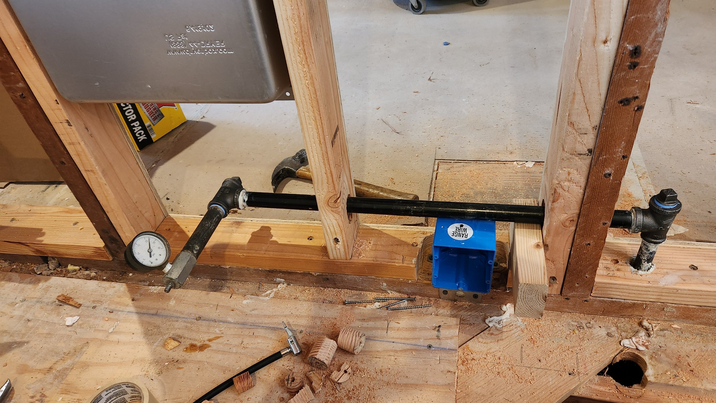

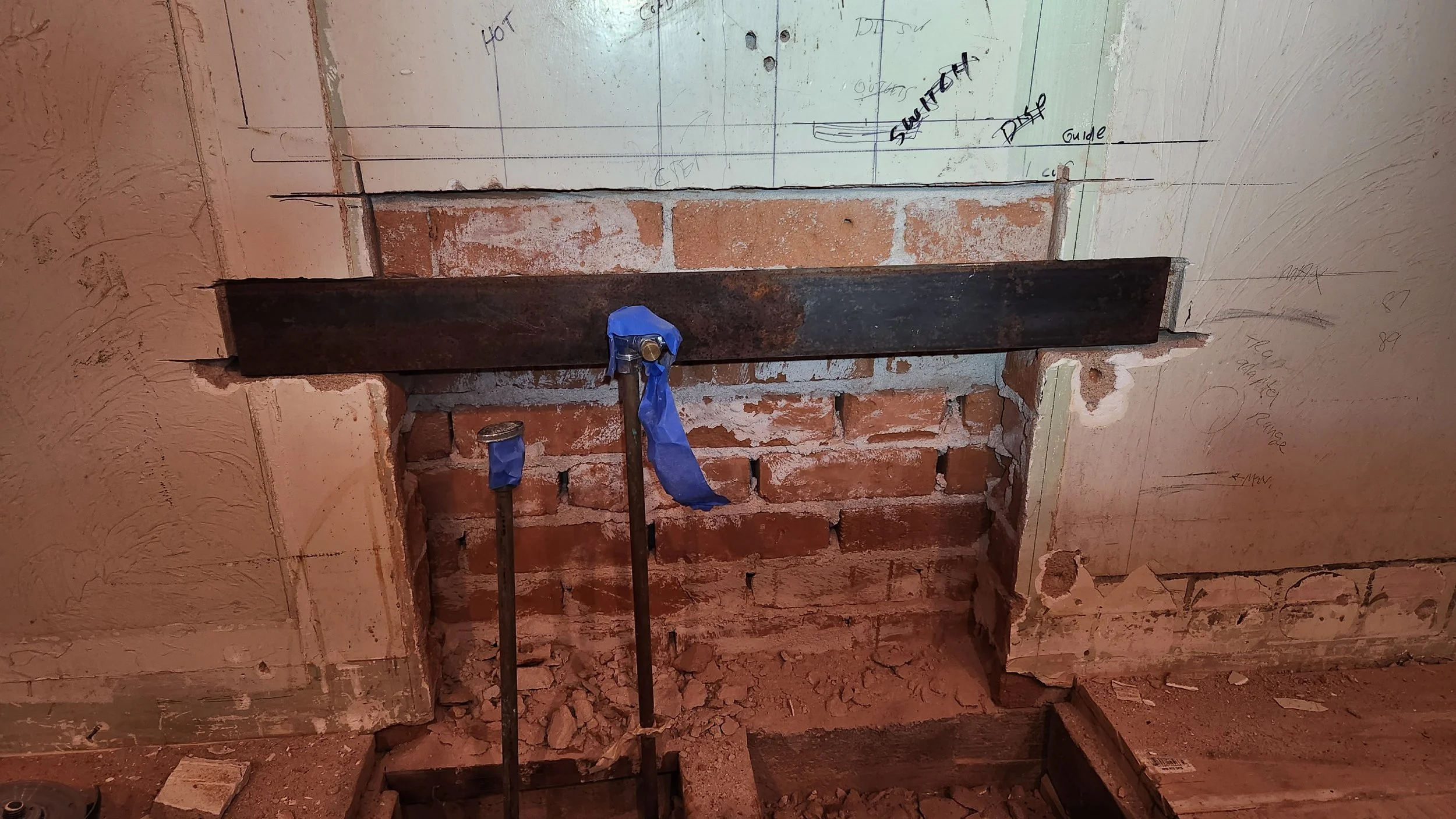

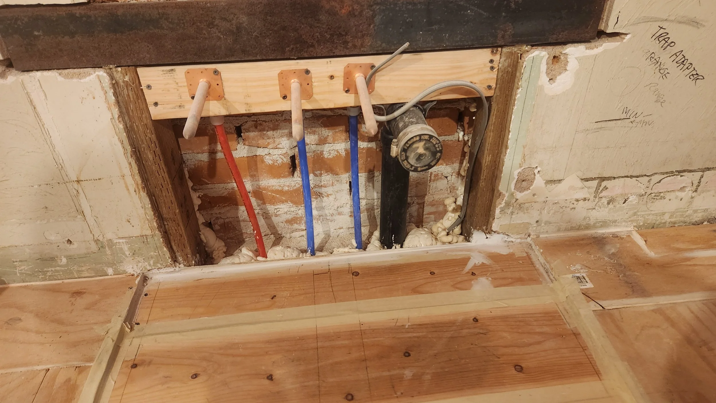

Finally got the location of the sink so I spent today with a grinder and a chipping hammer removing the inner layer of brick from the double brick wall to make a cavity in which to recess the plumbing. I had planned on going 2 courses higher but after removing the plaster I saw a rowlock course at 16" so not wanting to mess with that I stopped at 16" and put in a lintel then added 2 sides of pressure treated for attaching stub out boards to and the outlet box for the dishwasher.
The height will still work for the trap adapter but fitting in a cleanout will be tight. (The vent stack is in the adjacent wall since this wall is all window.)
The sink is a single bowl with a standard offset drain so my trap adapter will be centered on the 4th pencil line from the left (where it says switch) and the 3 pencil lines left of that will be hot, cold and ice maker. I will have an ice maker box behind the fridge supplied with PEX but I need a way to turn it off easily so I will have it stubbed out next to the cold then I can put an angle stop on it and feed it from a double outlet angle stop on the cold stub out and a supply line. This also leaves the option of an under sink filter instead of depending on the one internal to the fridge which will be a special one and likely pretty expensive and who knows what the quality is, and for how long it will be available?
Tomorrow I'm cutting the masonry wall for the receptacle boxes and wire, then I'll be finished with the really dusty work and back to my electric. (Fortunately the other walls are framed.)

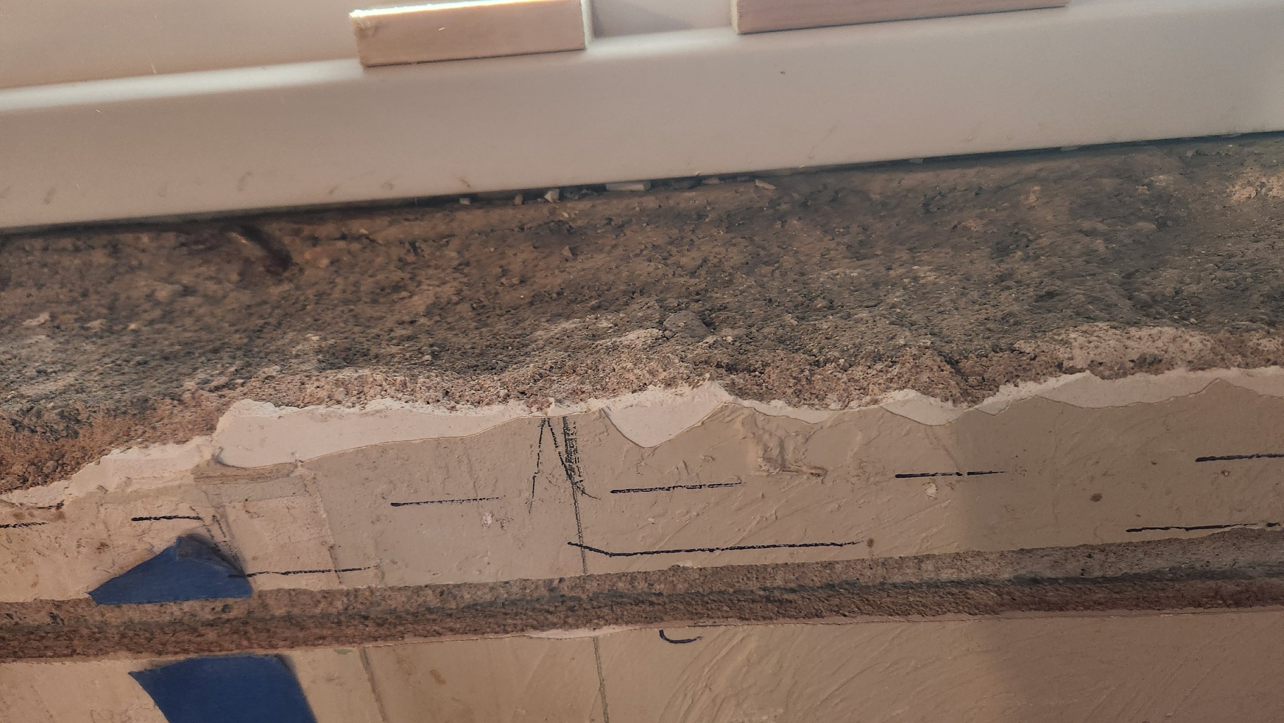

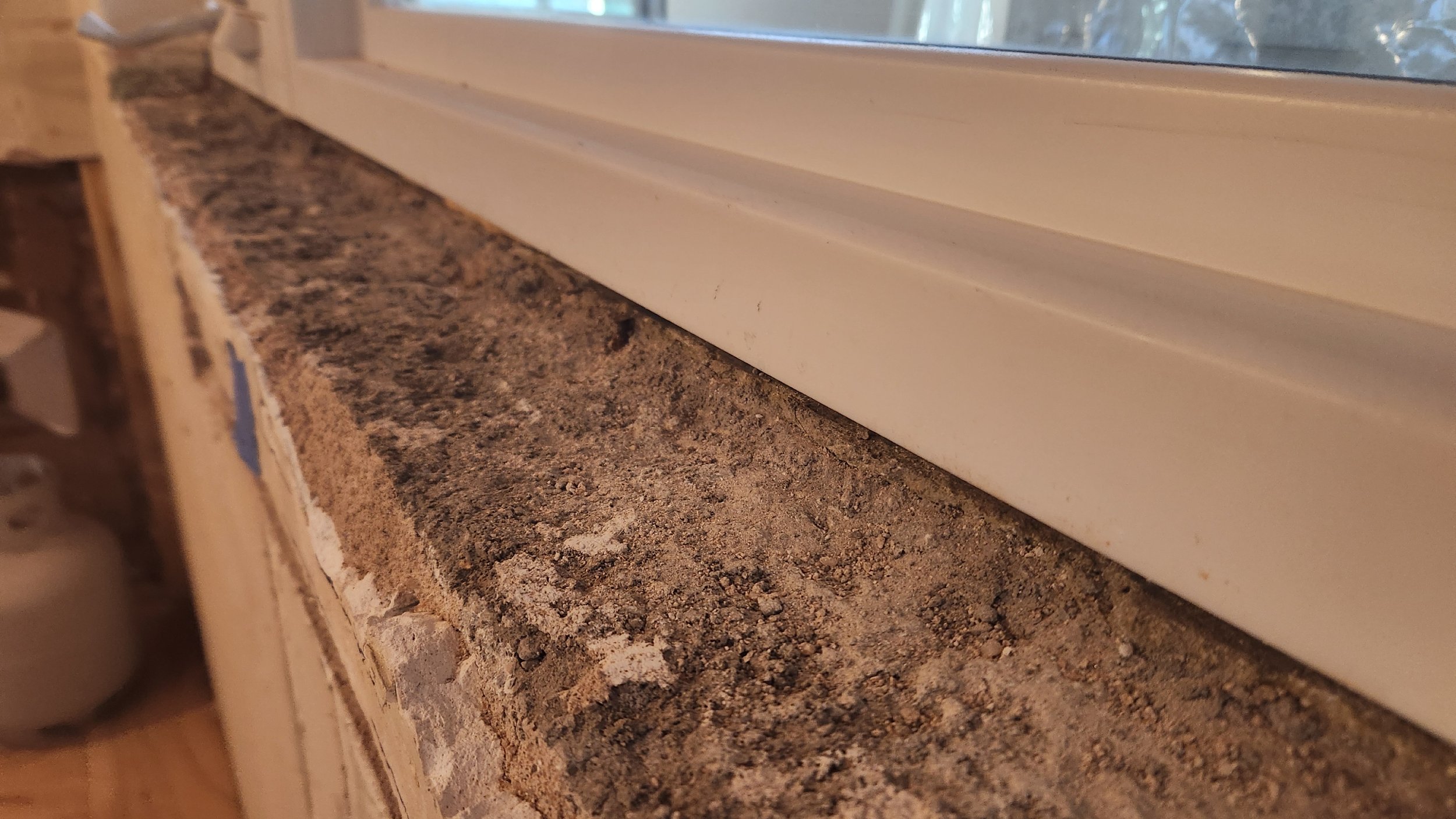

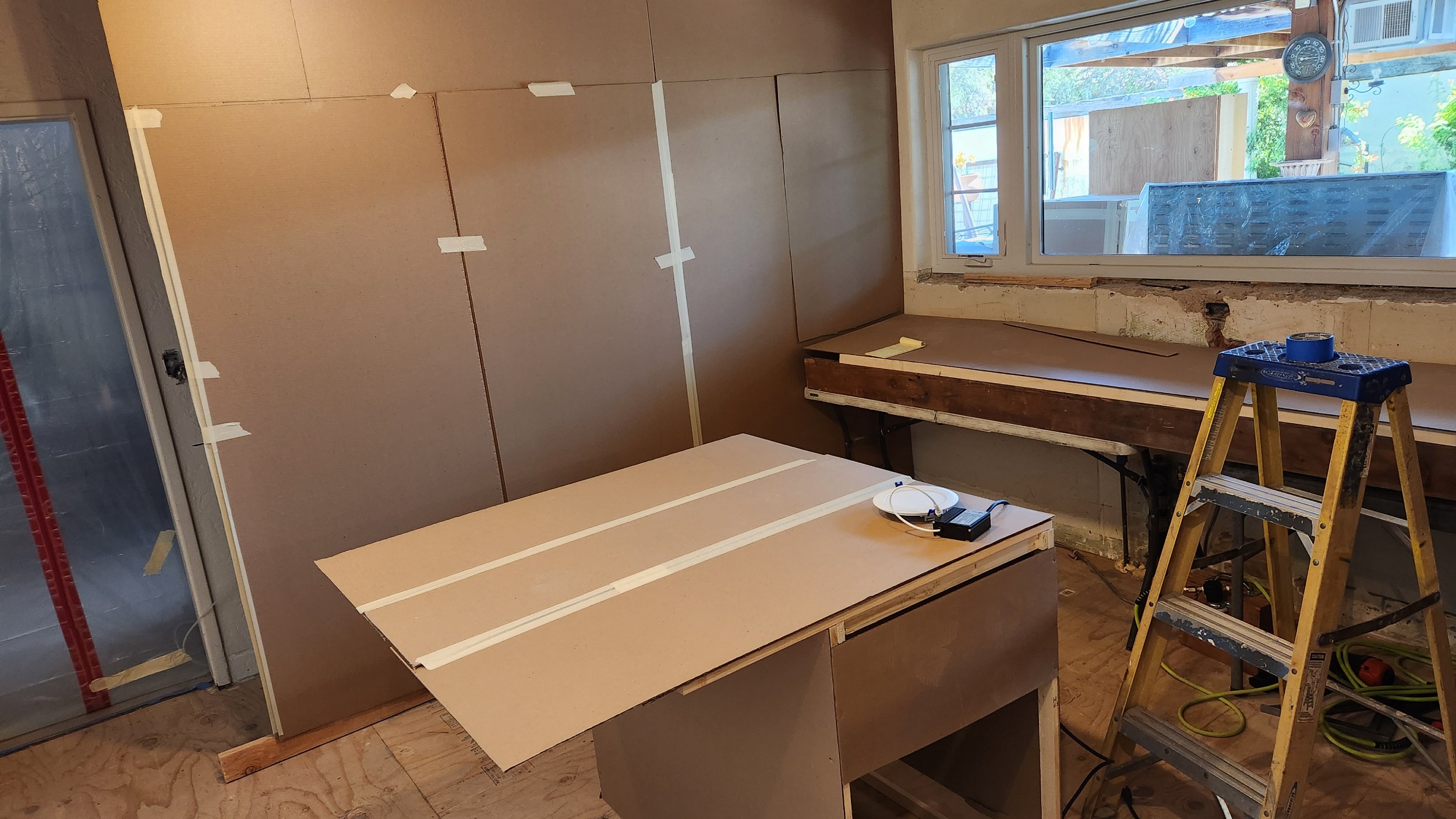

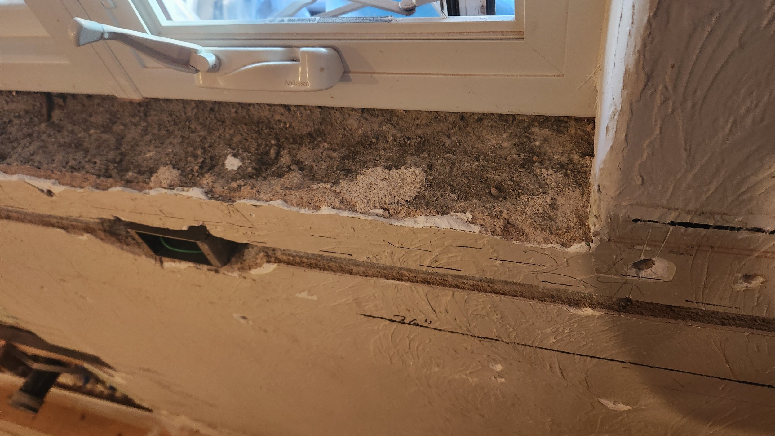

I need to level out this 9 feet of concrete sill so the countertop guy can put his quartz up there. I was thinking I'd screw some wood to the front edge (along the wall) wall to act as both a dam and a level then fill it in with Pour Stone or a similar product unless anyone has a better idea or knows of a better self leveling product for concrete. Maybe just a floor leveling product, I don't know why it would have to be a concrete product. The quartz will cover the entire area from the counter top to the sill with another piece on top of the sill. @AndyG ?
This looks promising

First seal the window connection at the concrete and let it cure- a good latex caulk is ok or use polyurethane if you need a faster cure- air loss is a reality.
Then vacuum it
Prime it if required
Dam it with tapcons and a 1x, dead level
Caulk the dam to the wall if needed to prevent flow out
Fill er up
Or set the top and the splash then use spray foam misted with water to make it kick and trim it even and set the sill.
Elevation is key on that set up- watch the crank handle rotation clearance.
You can also set the splash and then use mortar then the sill-
Your house is non typical but your attentive mindset and thorough work is showing through.
Phones on in am tomorrow if ya need me.
Your pal,
Andy G

Thanks Andy, I knew you'd come through! I'll take the 1X to my friend who has a huge 3 phase table saw so we can make sure one edge is perfectly straight.

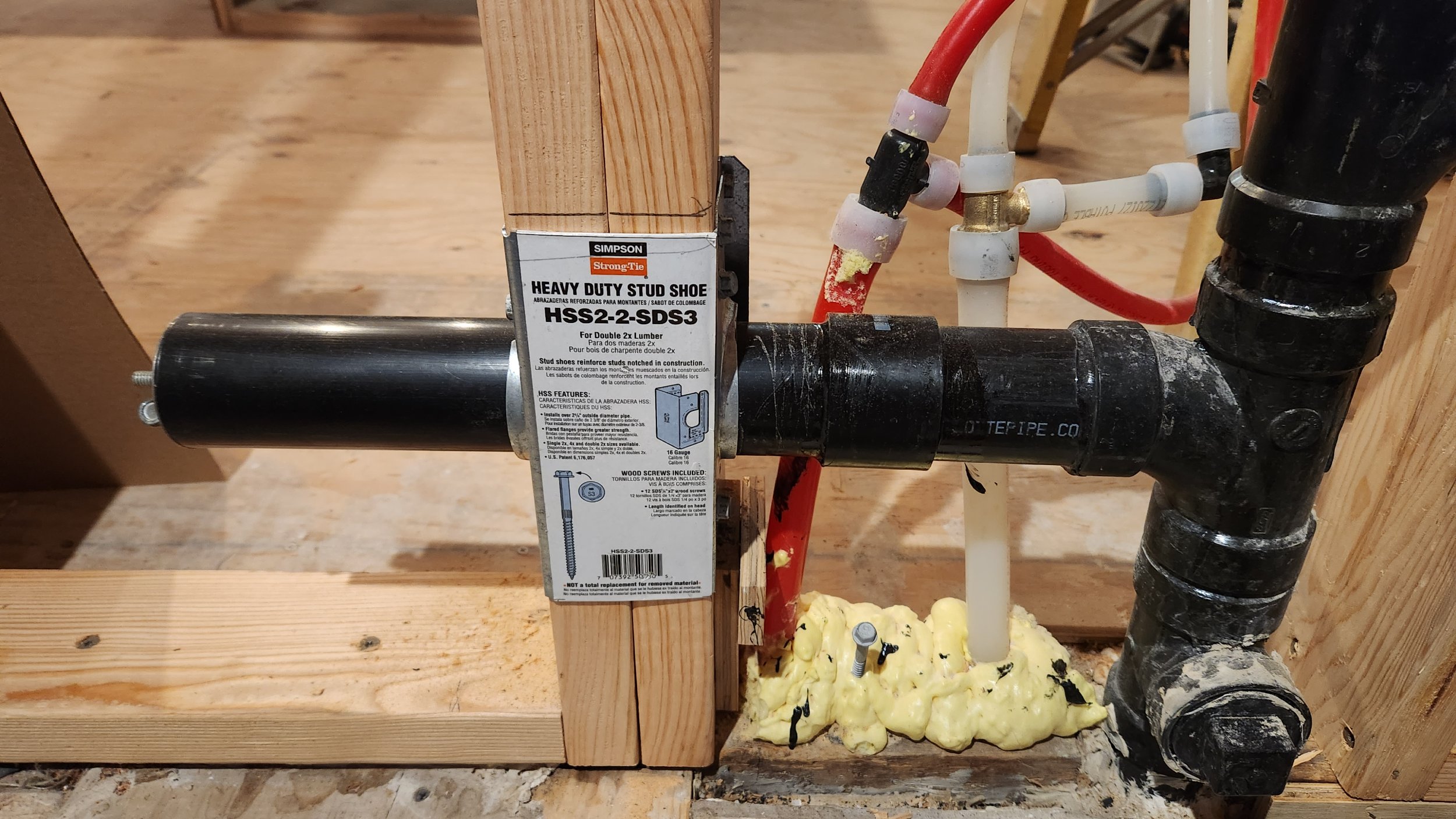

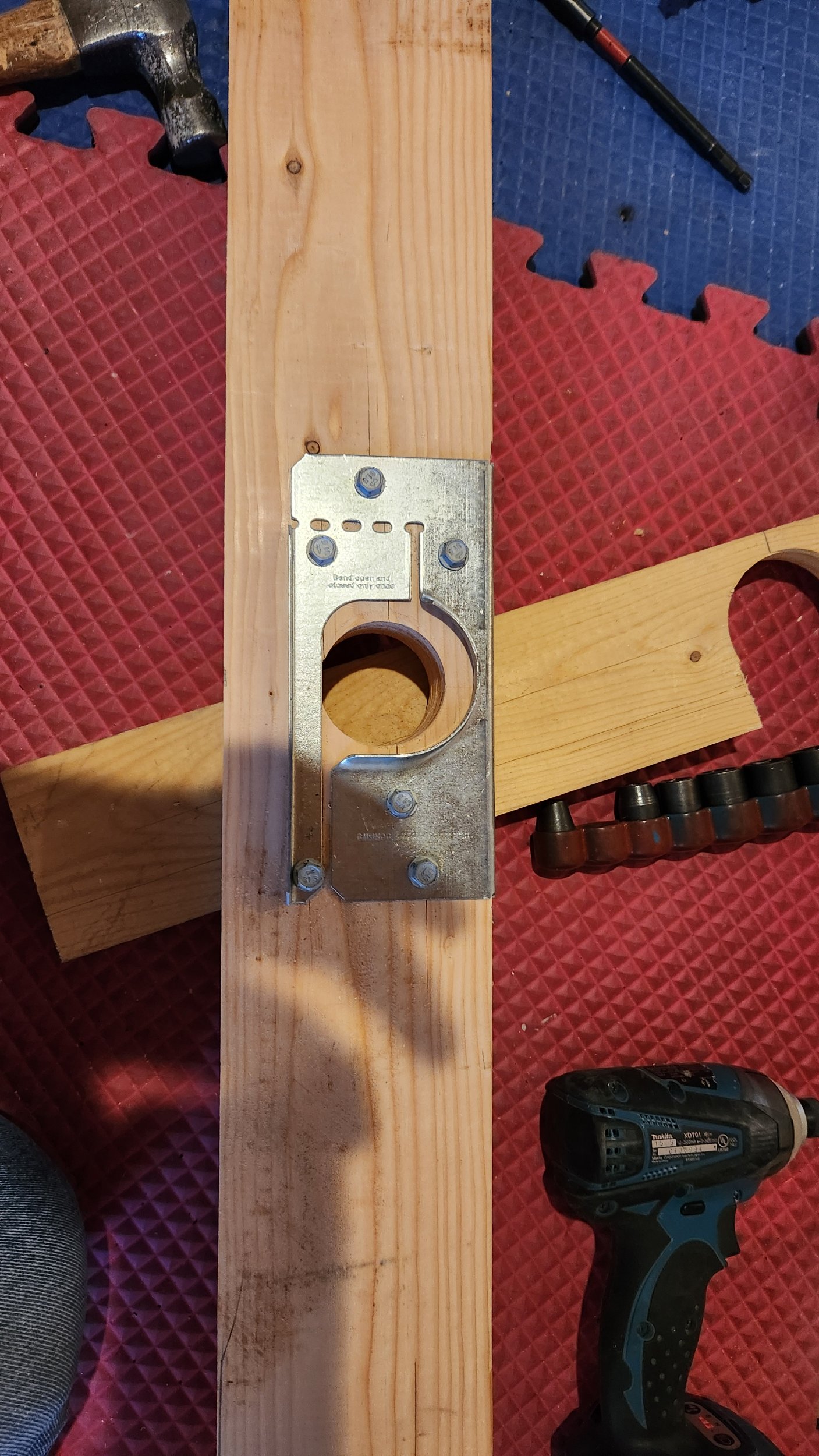

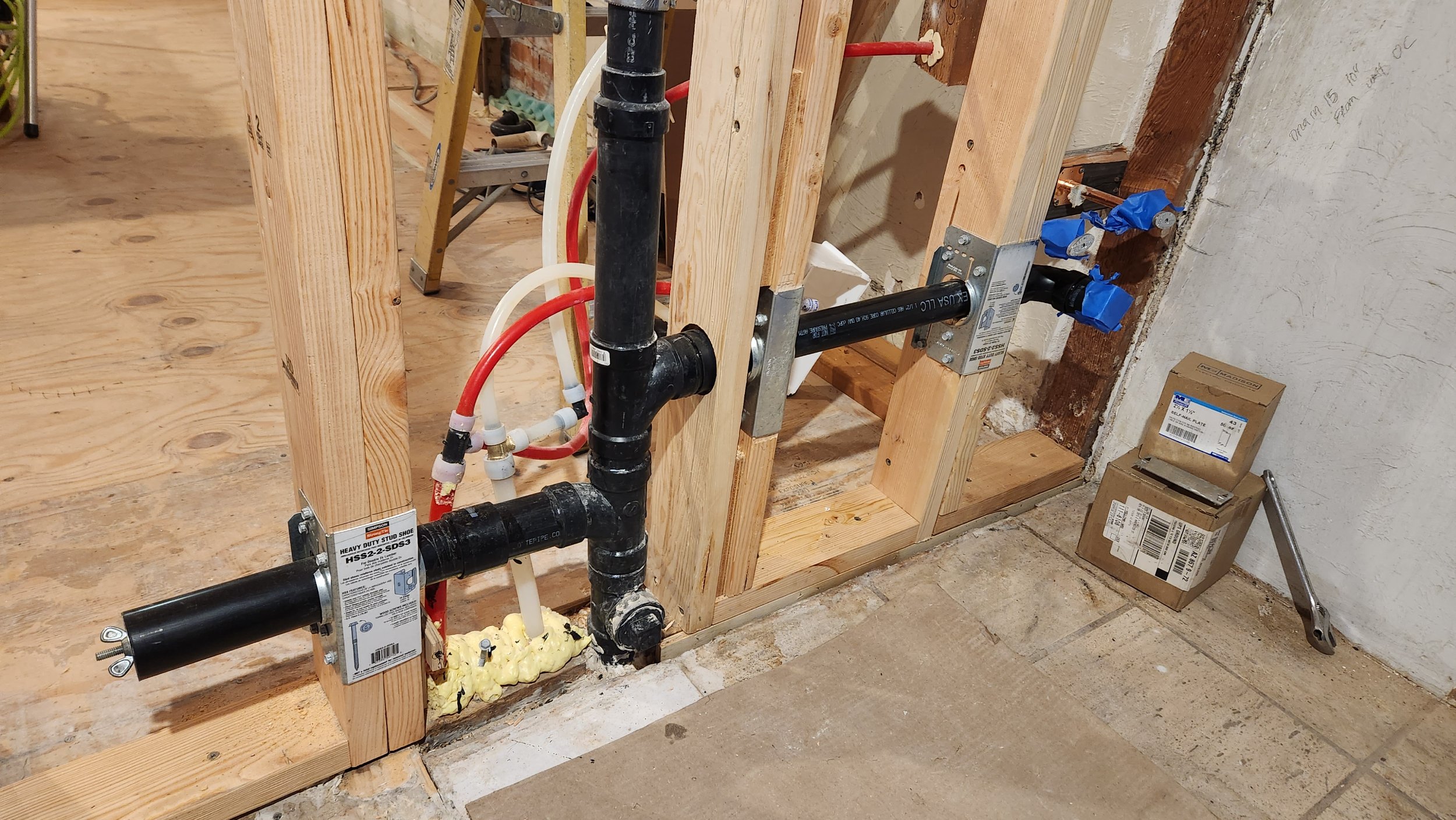

I'm attaching a few pics of the finished wet wall, compare it to the pics in posts #18 and 48. The stud shoes were a great idea. Since that wall was getting furred out anyway what I ended up doing was buying 2X6's and ripping them into 2X5's giving me more meat on each side of the plumbing. I also drilled the DWV holes and assembled the pipe as I went instead of notching so now there is solid wood on both sides of the holes in addition to doubling up on all the studs.
It comes in handy when you're the same person doing 3 trades at once, you can accommodate each trade as you go.

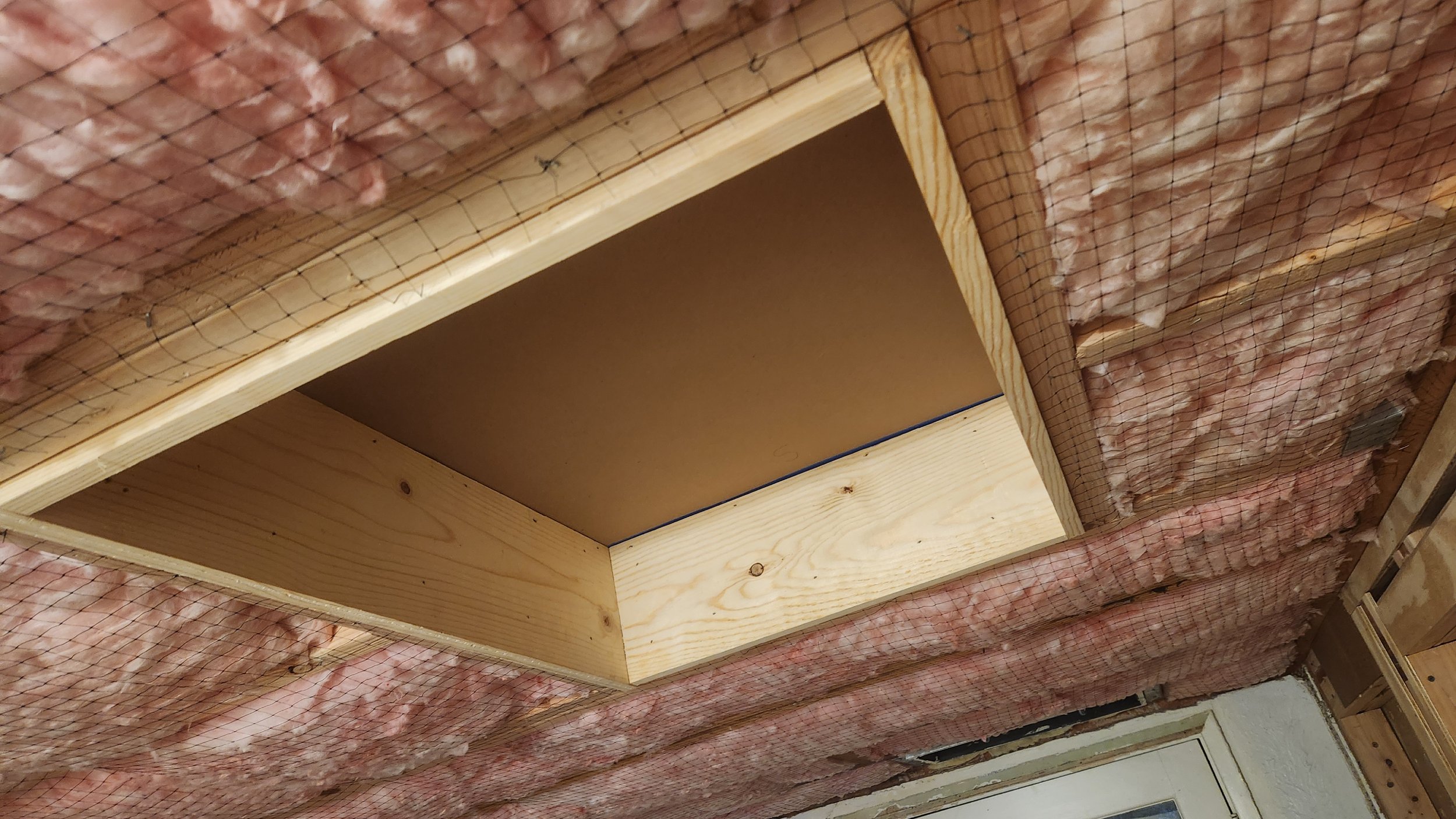

I also did the gas line. One of my plumber friends stopped by and did all the PEX as I didn't want to learn that and invest in PEX tools at this time. I also built a second floor in the attic above where the 2x4 floor was for added insulation above the laundry. Instead of 4" for insulation I now have 9". I got rid of the pull down ladder and made a 22 x 32 access giving me more ceiling area for lighting and a much better seal, that ladder was junk.
