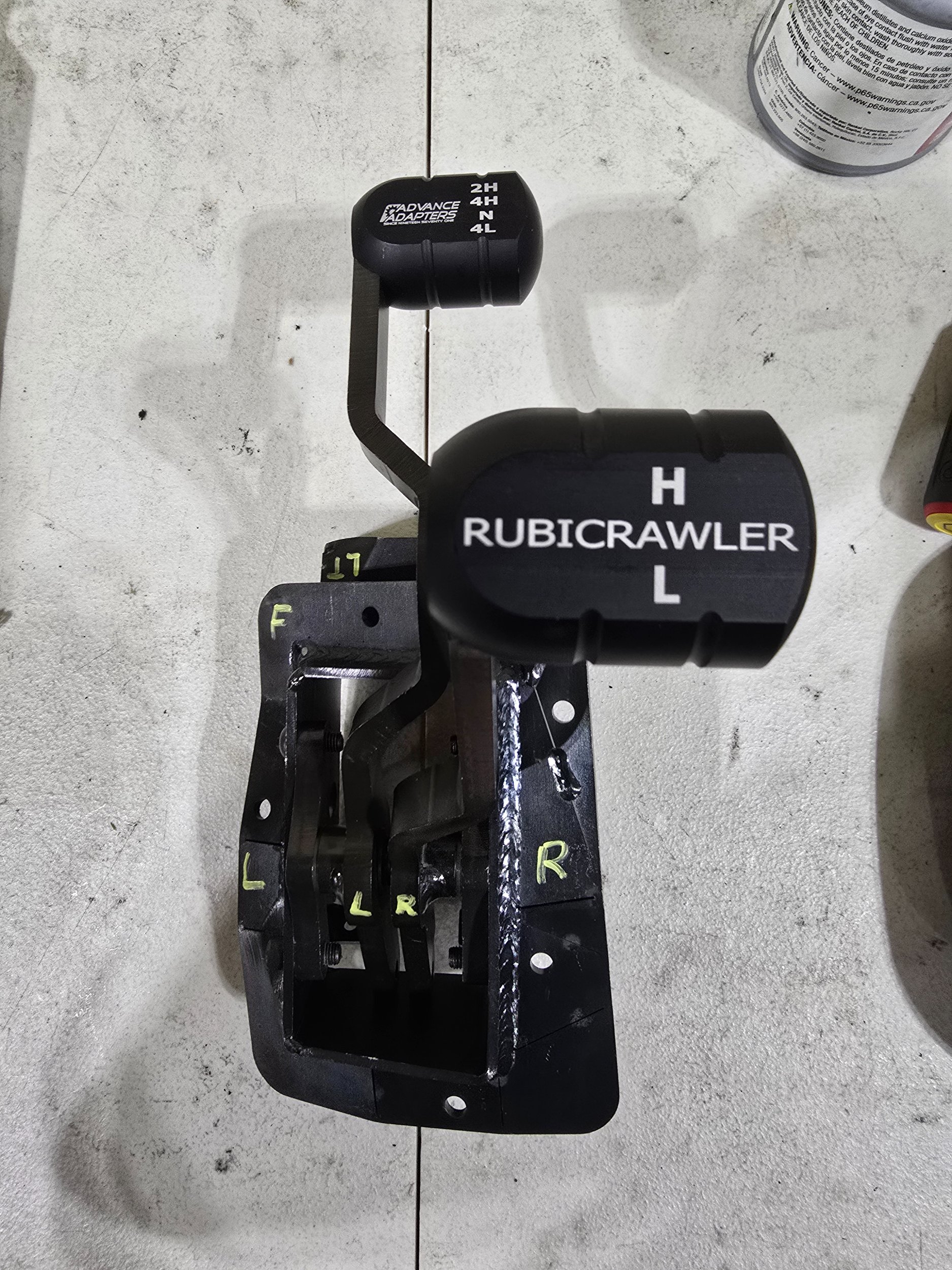

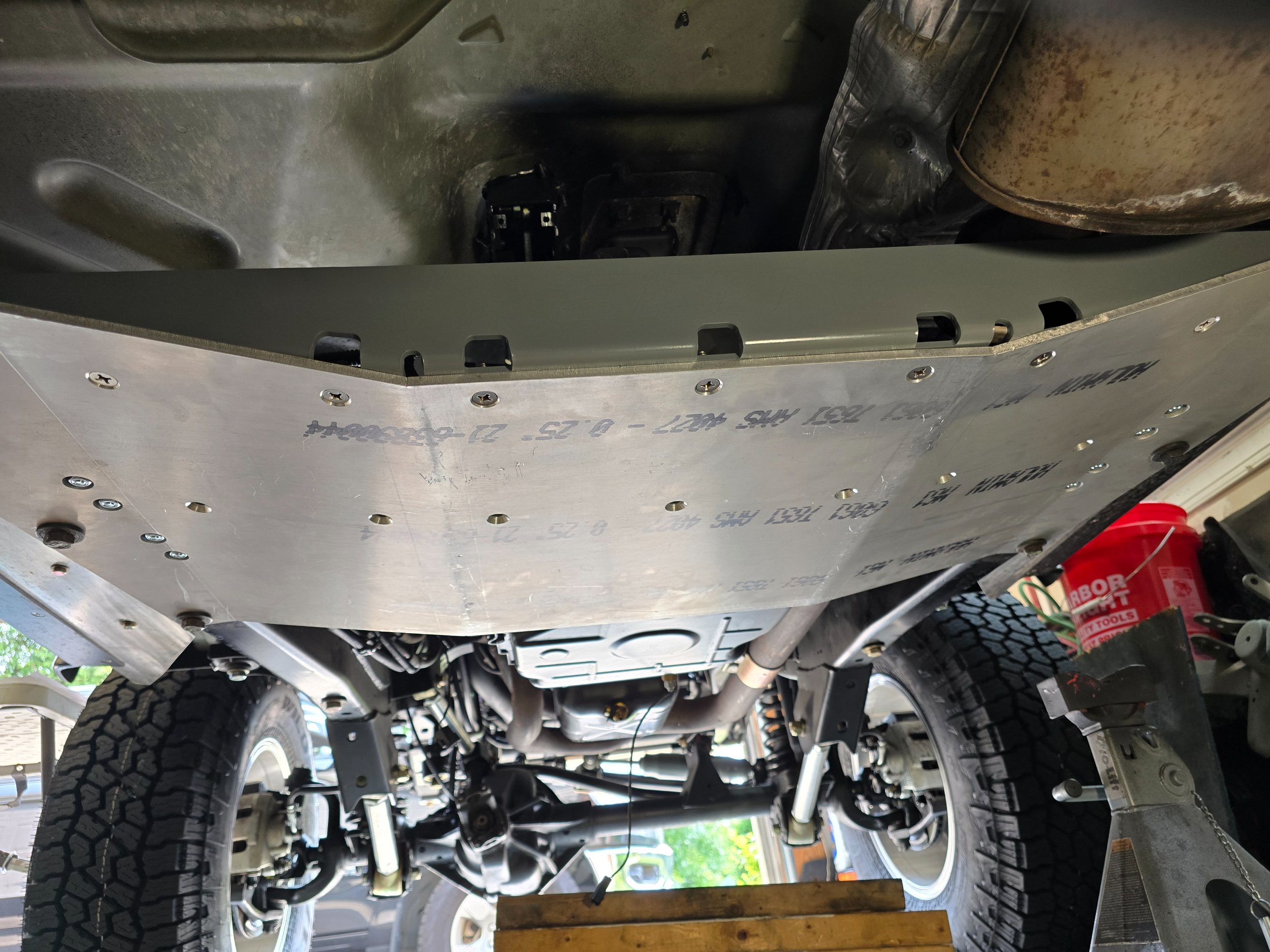

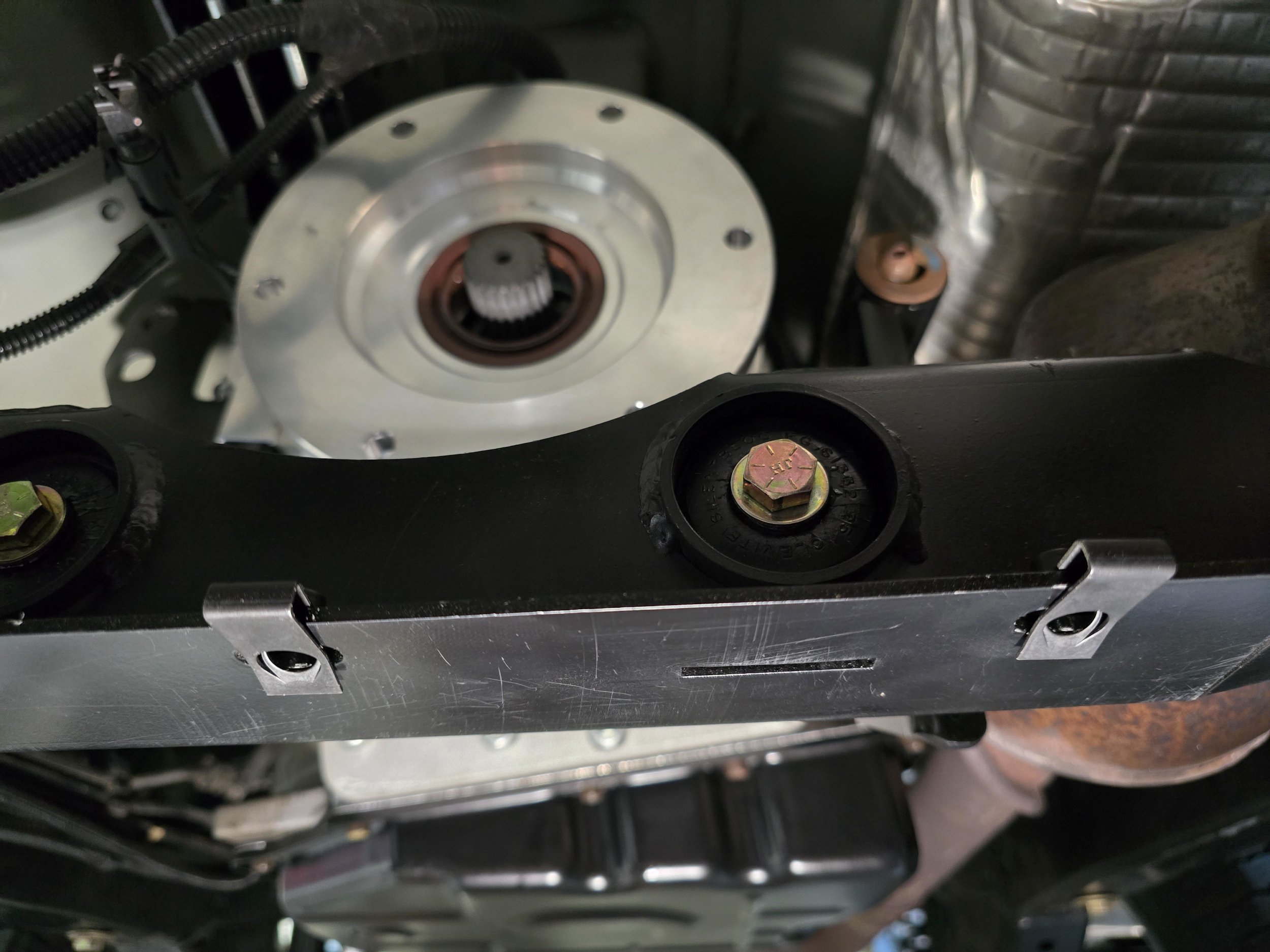

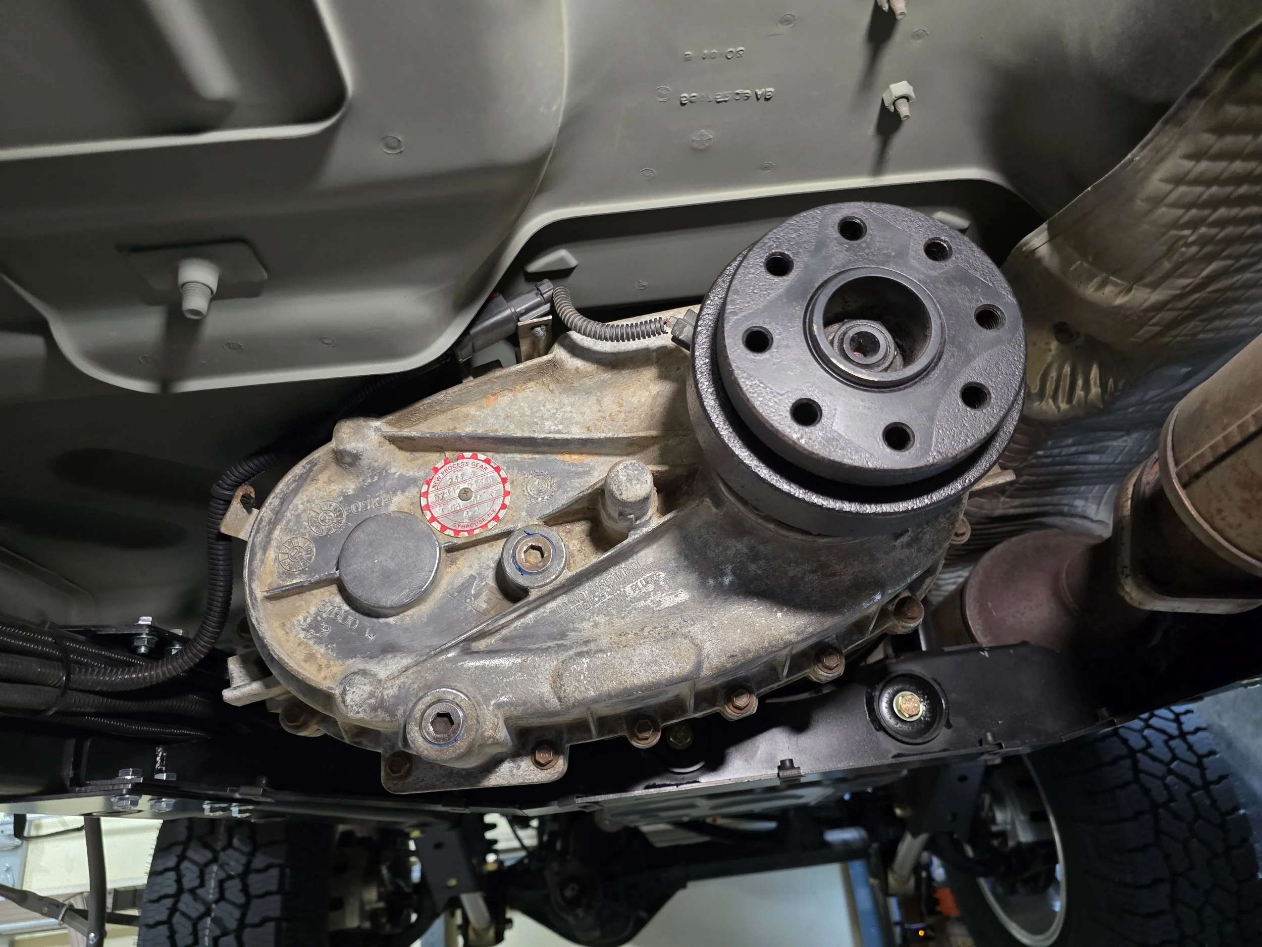

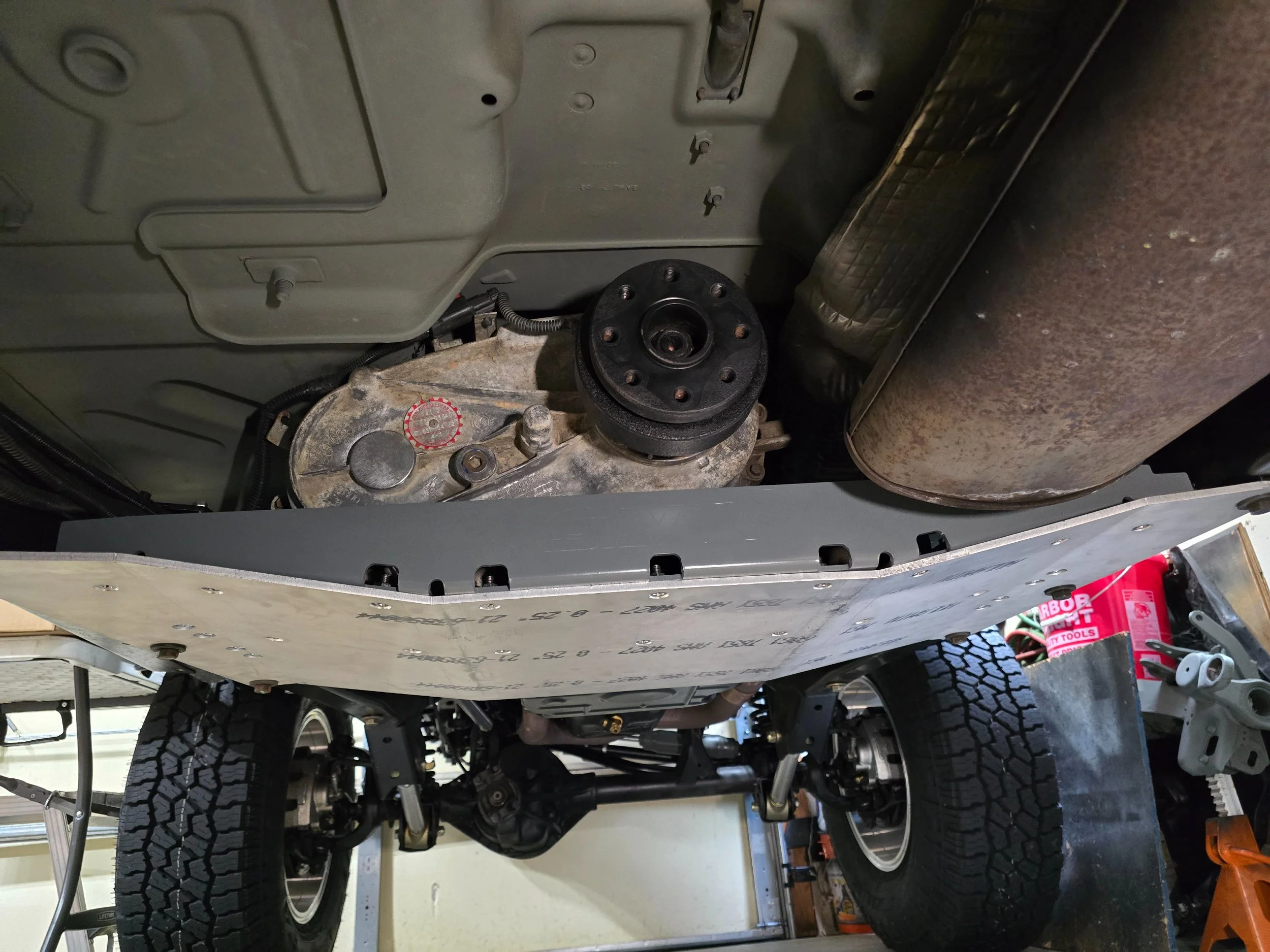

RubiCrawler is in and all that needs to be done is connecting and adjusting the cables. Also installed the Savvy skid crossmember and test fit the belly skid. Sitting on 3" RockJock springs, with a 1" aluminum spacer up front, I'm at 18 3/4" clearance at the skid. I've thought about going to 4" springs, but that gets expensive. Reason being, the domino effect is outboarding the rear shocks, a mid-arm, and tuned shocks. For now, the Jeep is setup with almost perfectly balanced 10" travel shocks, provides a very comfortable ride, and meets my trail needs, for now.

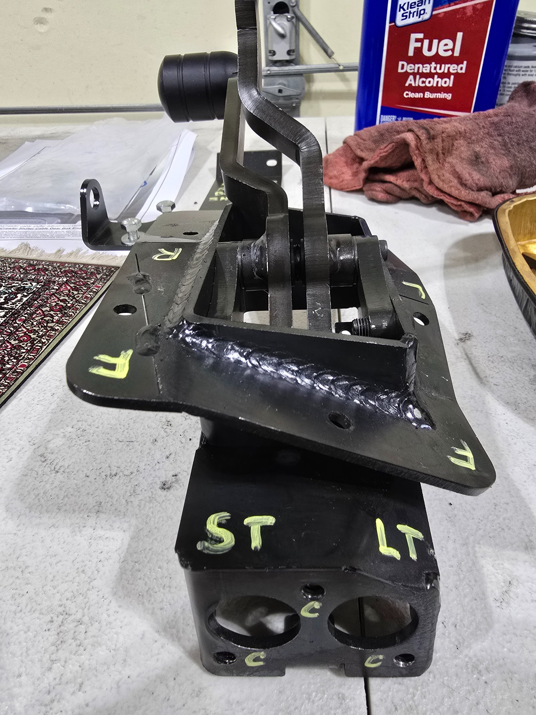

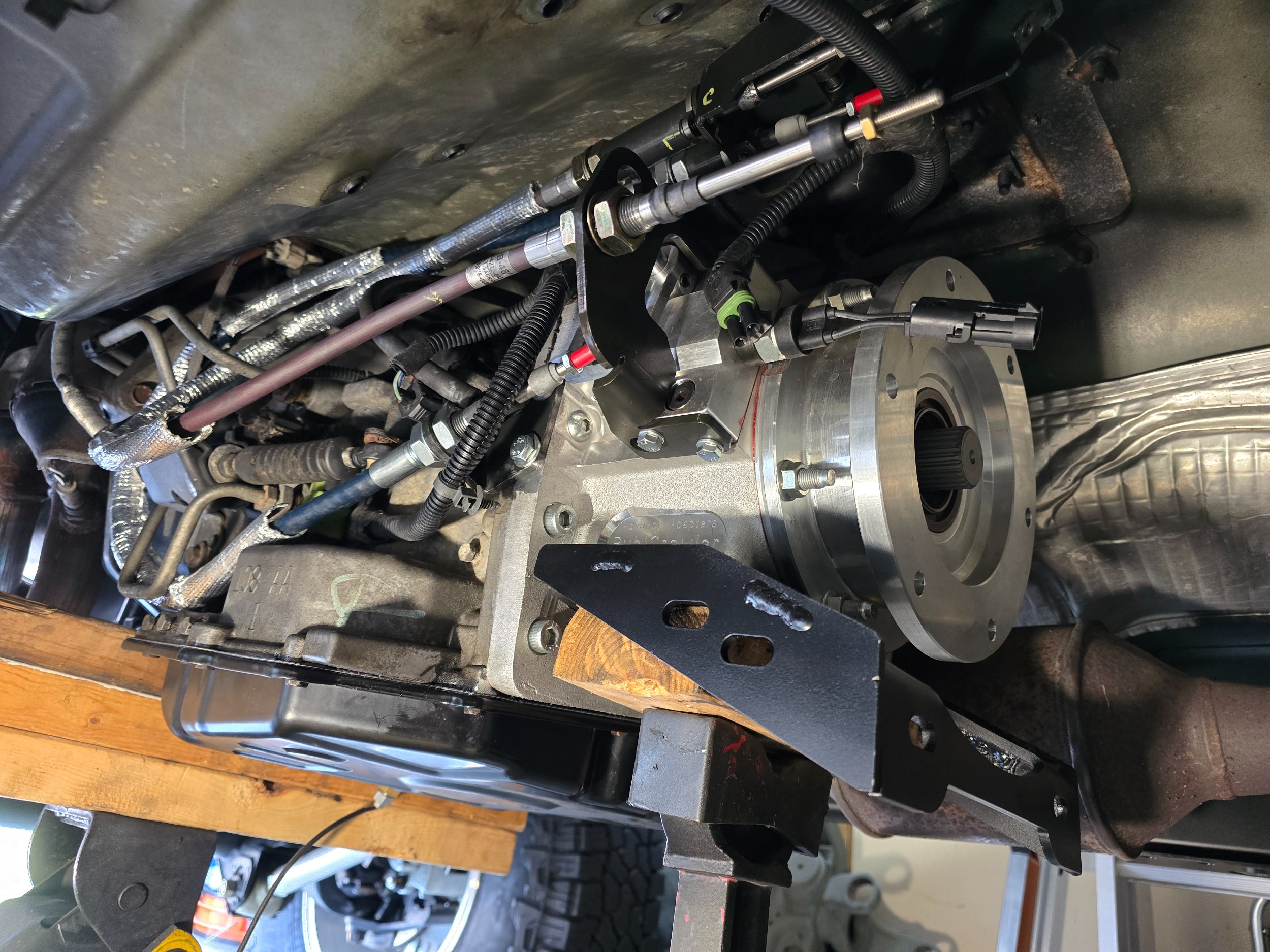

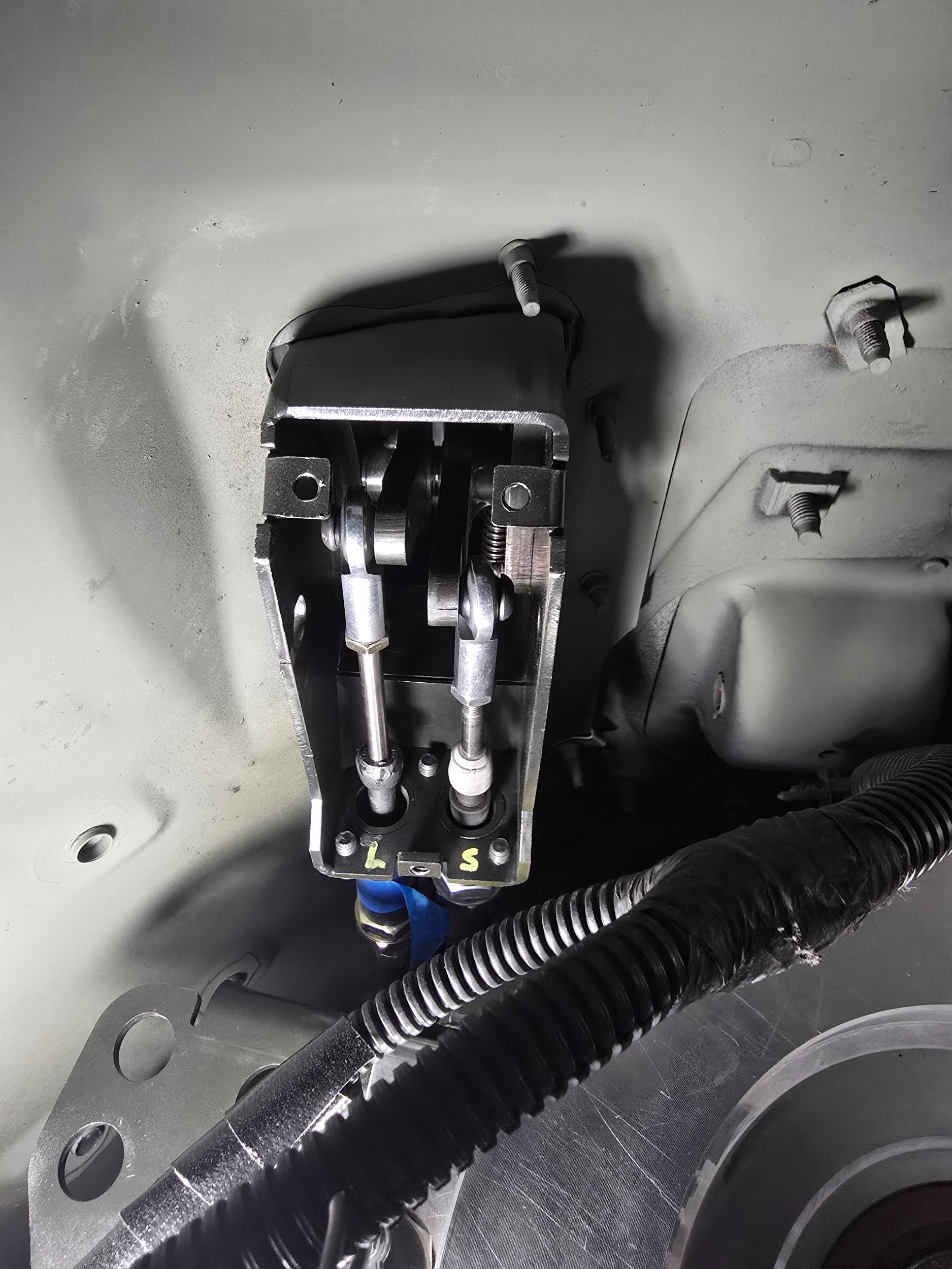

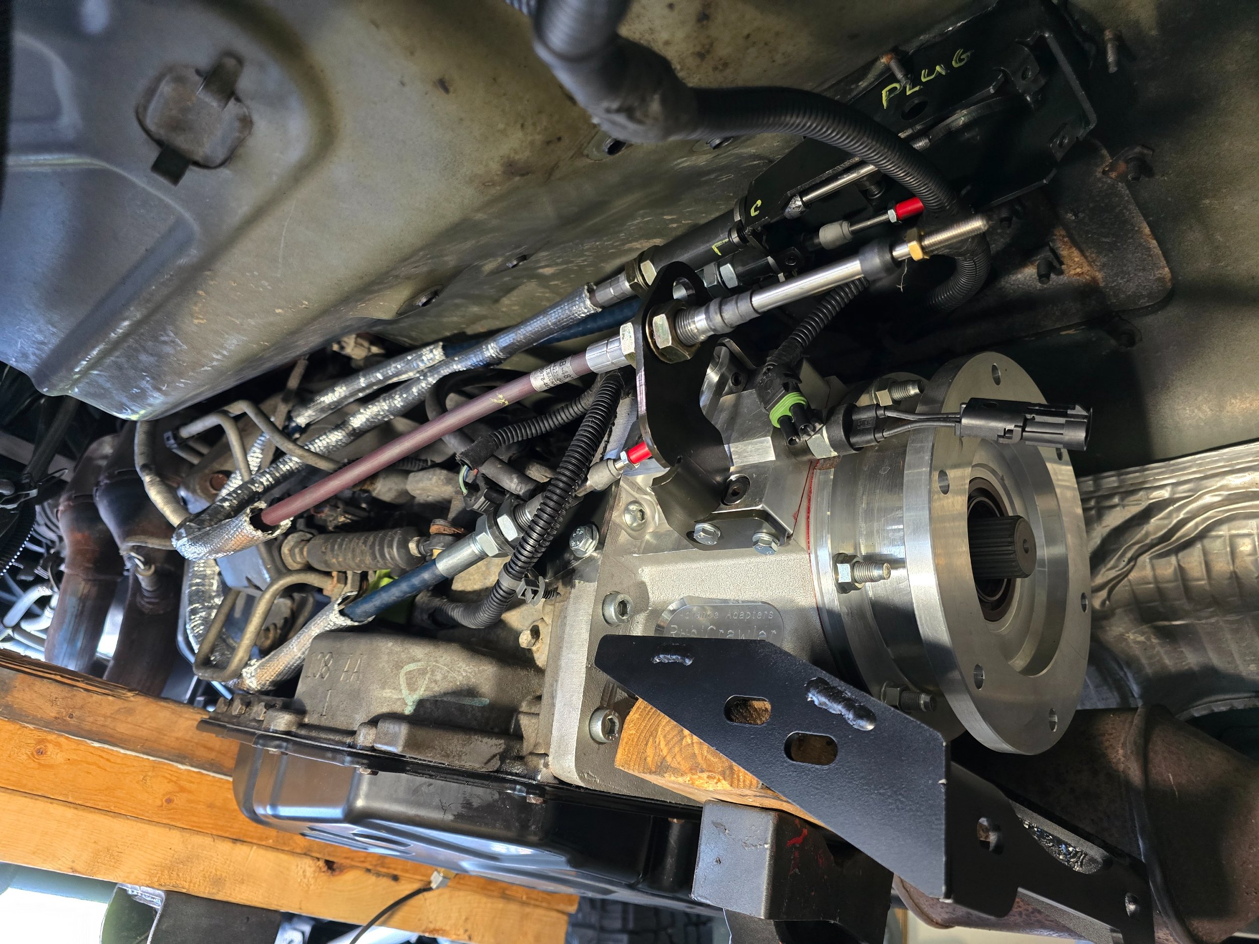

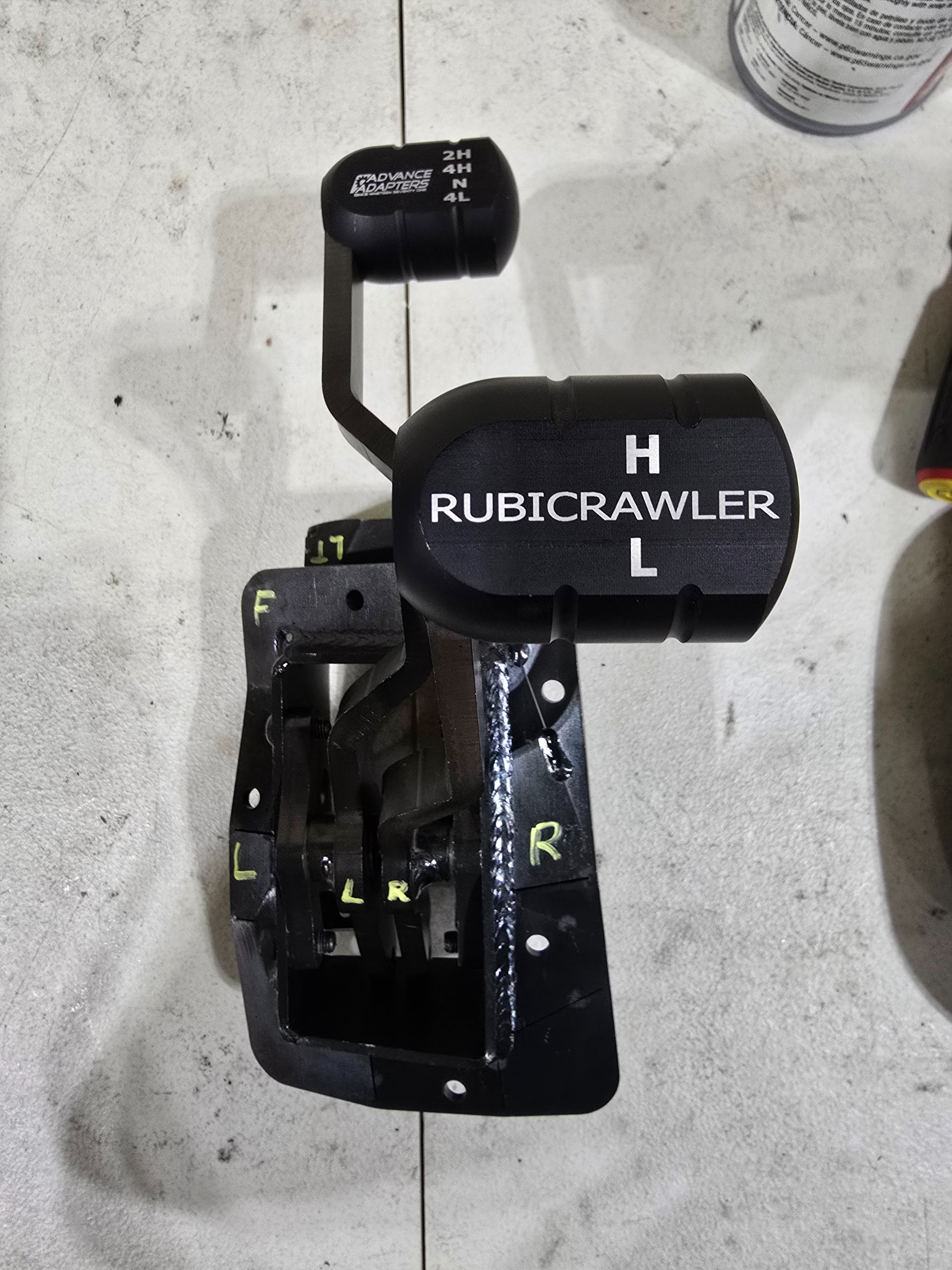

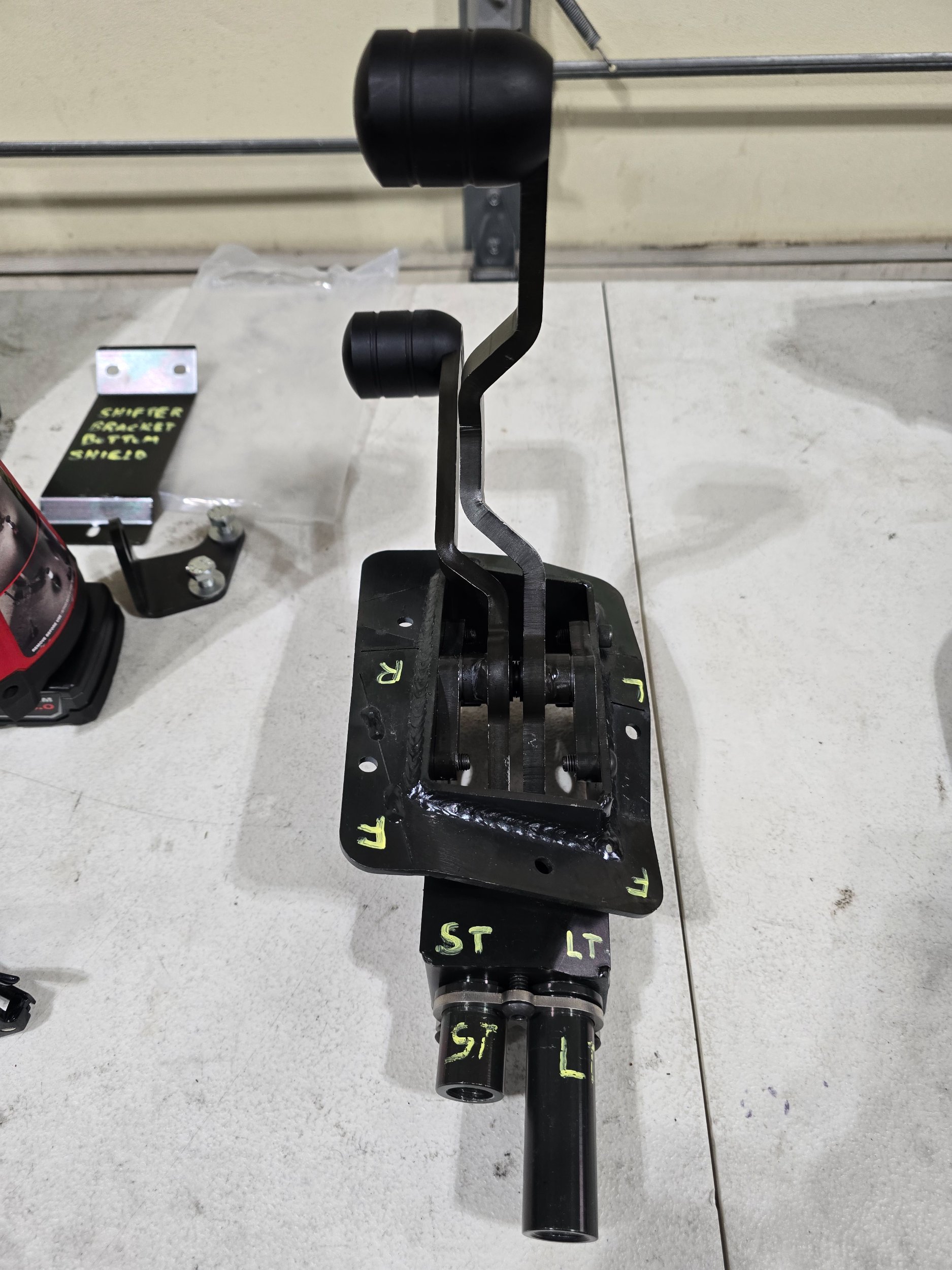

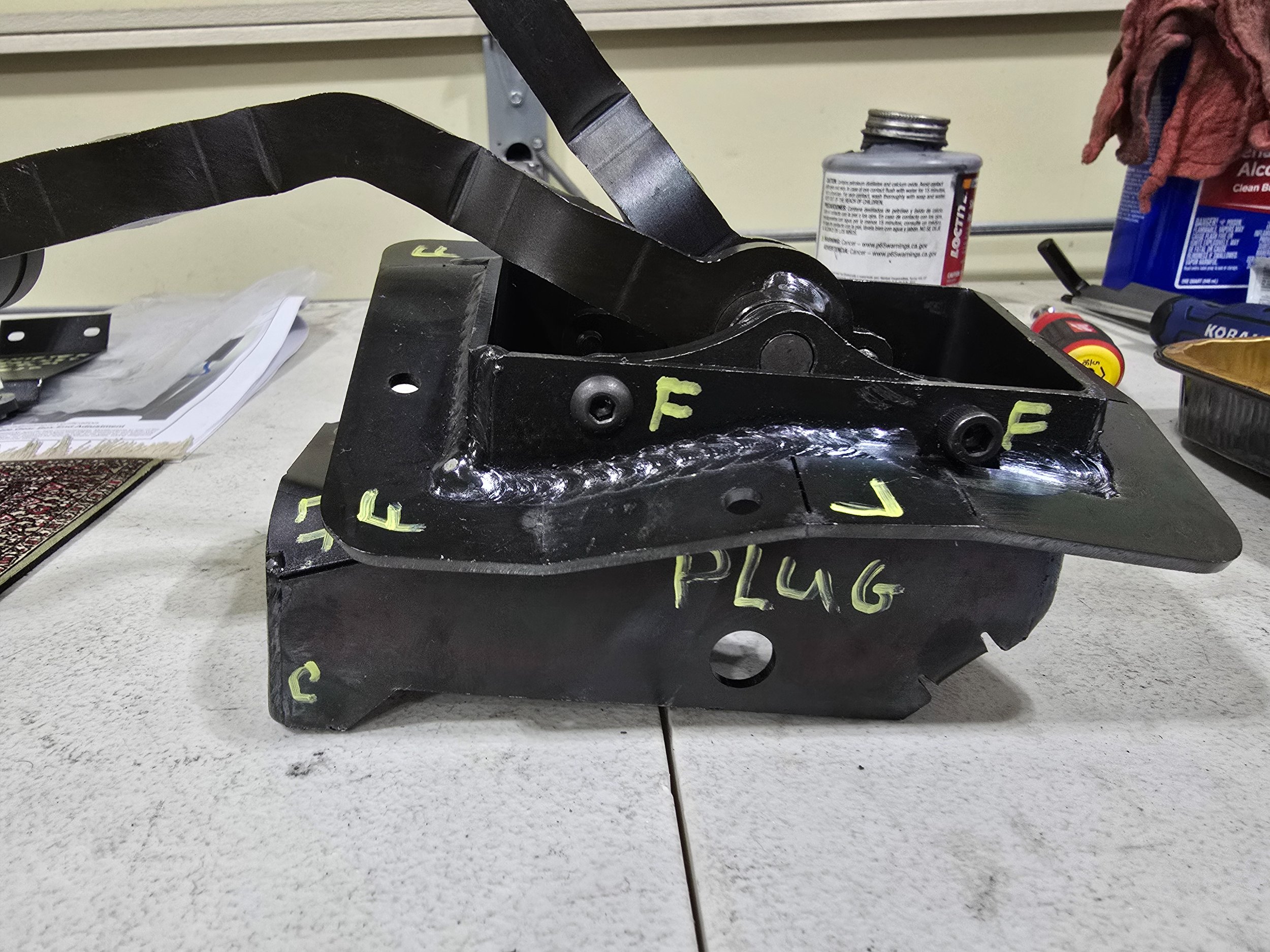

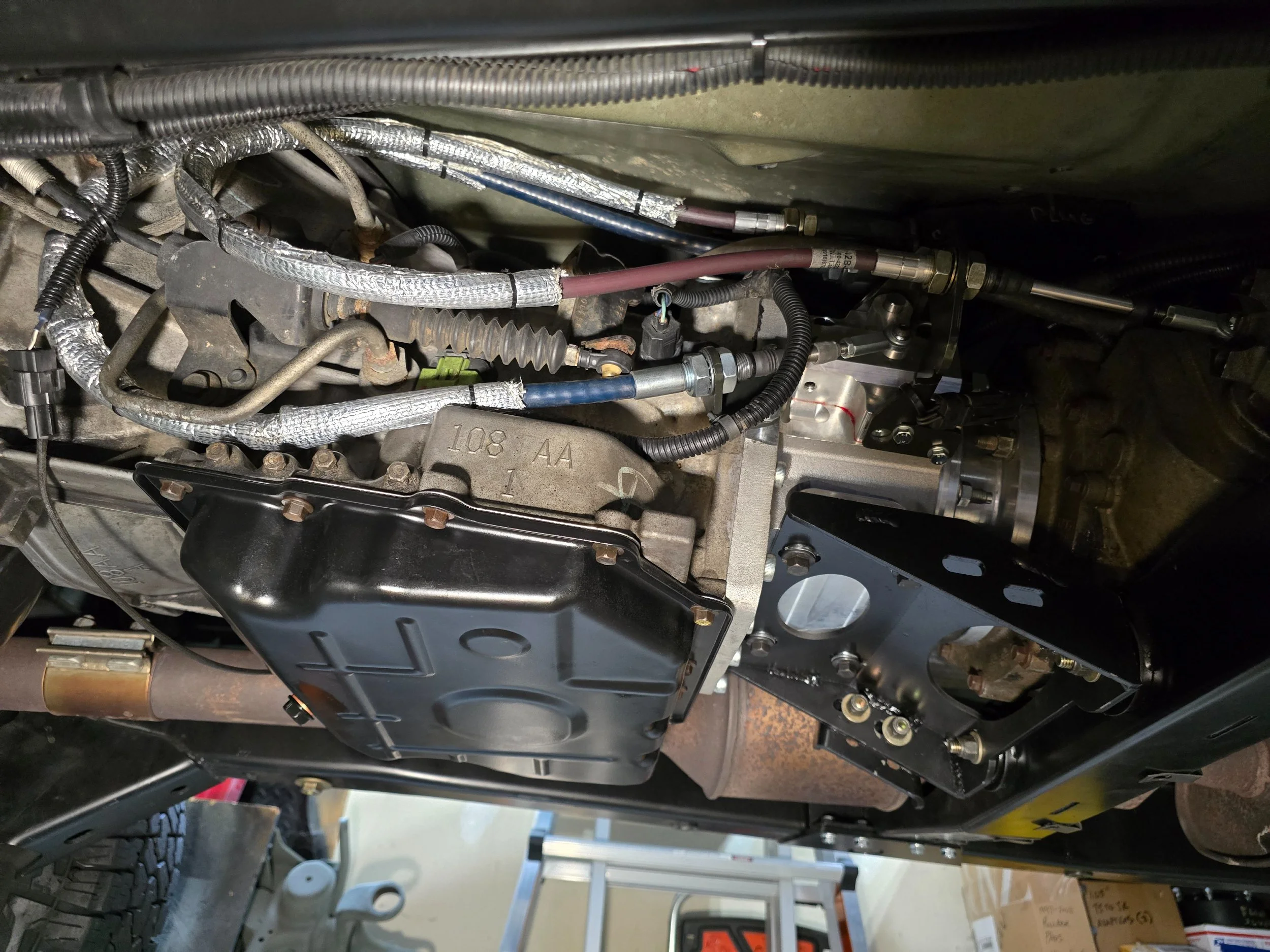

RubiCrawler cable is connected and adjusted. Dorman 4wd switch (600-506) swapped with stock 241 switch, and the GM pigtail (GM#12126453) for the switch is wired. Also, installed the 5/16-18 extruded U nuts on the Savvy crossmember. This makes removing the skid much easier, because you don't have to reach over and hold the nuts.

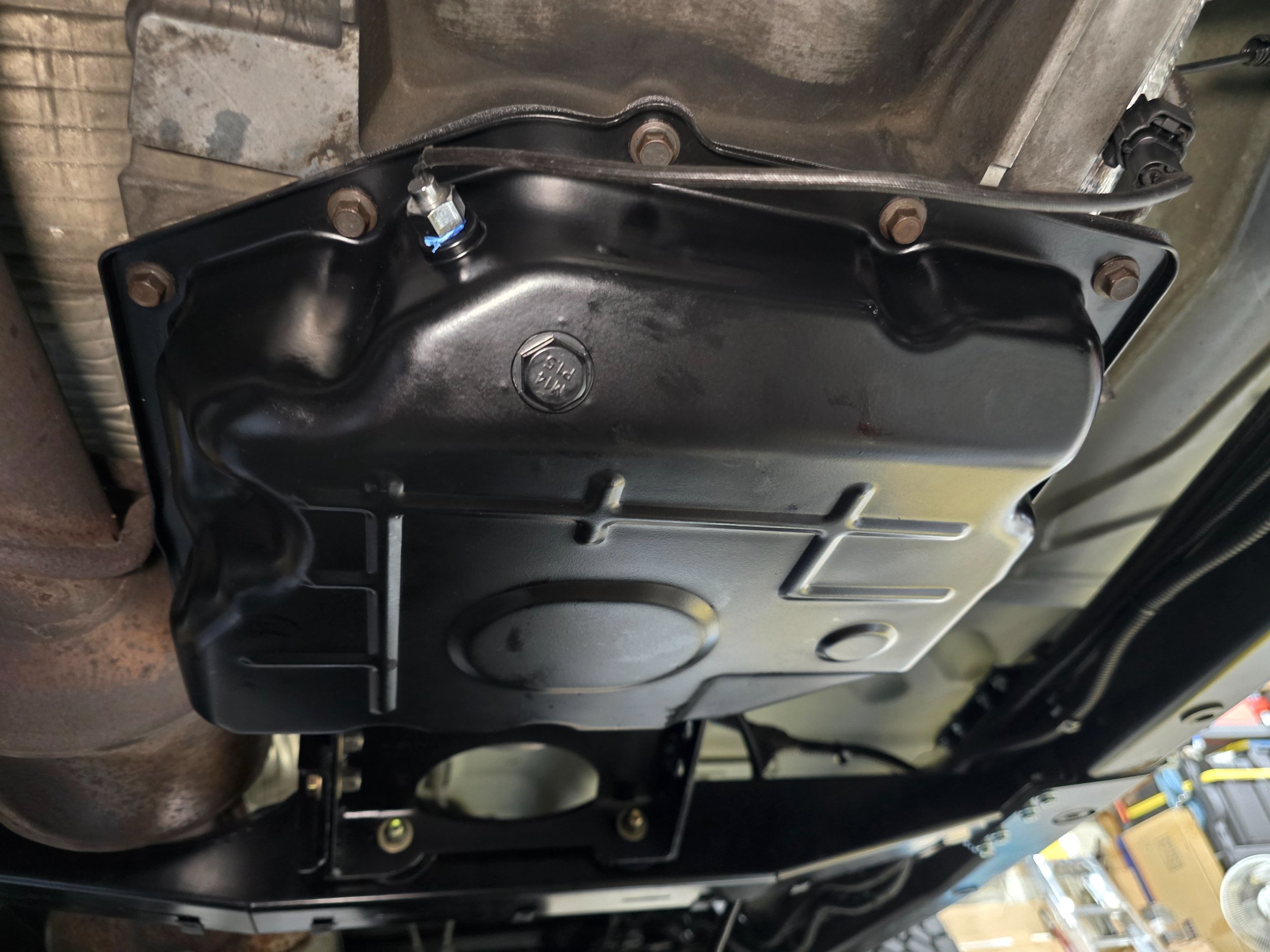

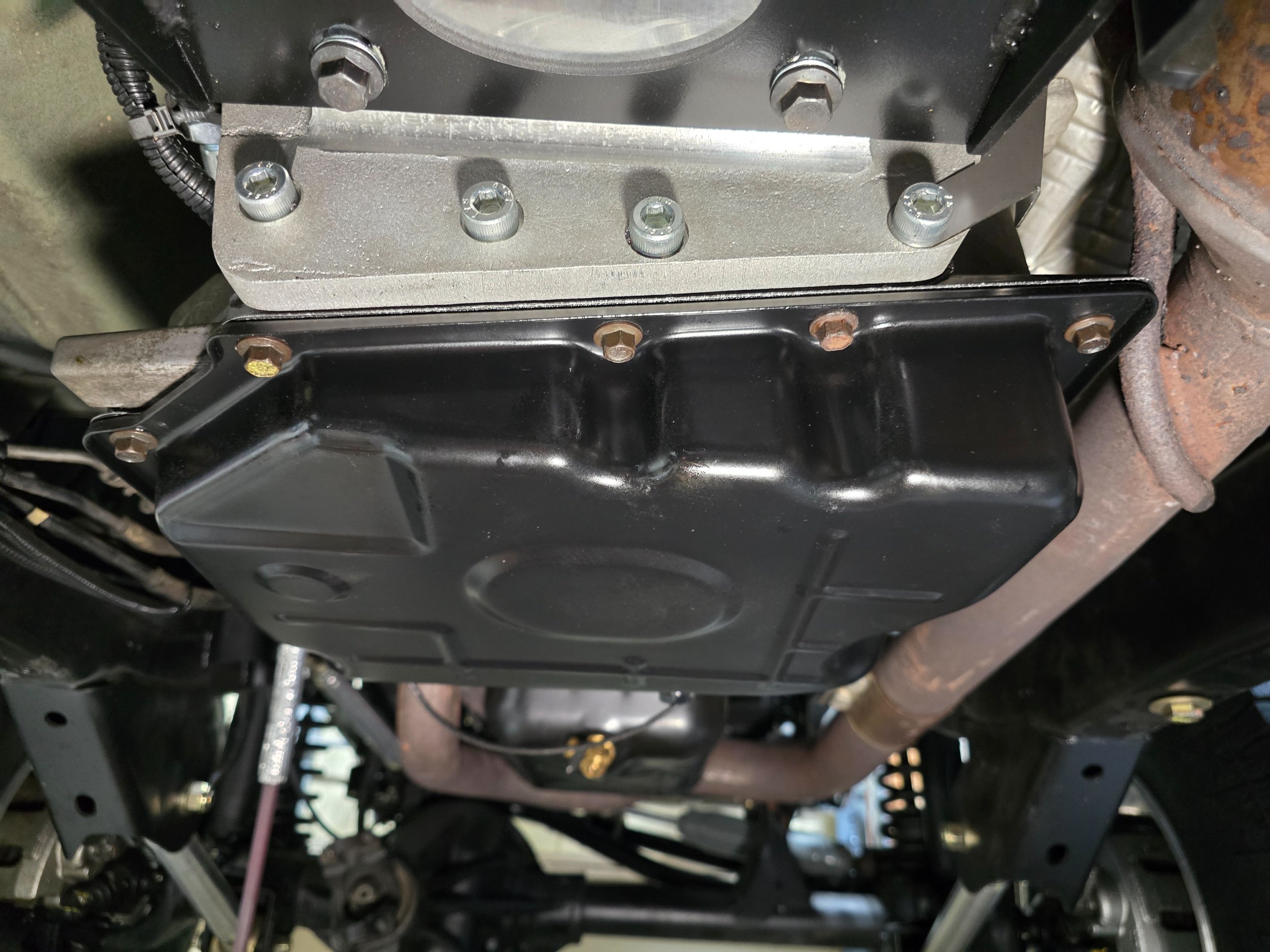

The last item for the weekend was to install Blaine's transmission pan, with the bung for the temp sensor welded in. It's a very nice addition that fixed the adapter I stuck in the drain plug hole on the Dorman pan.

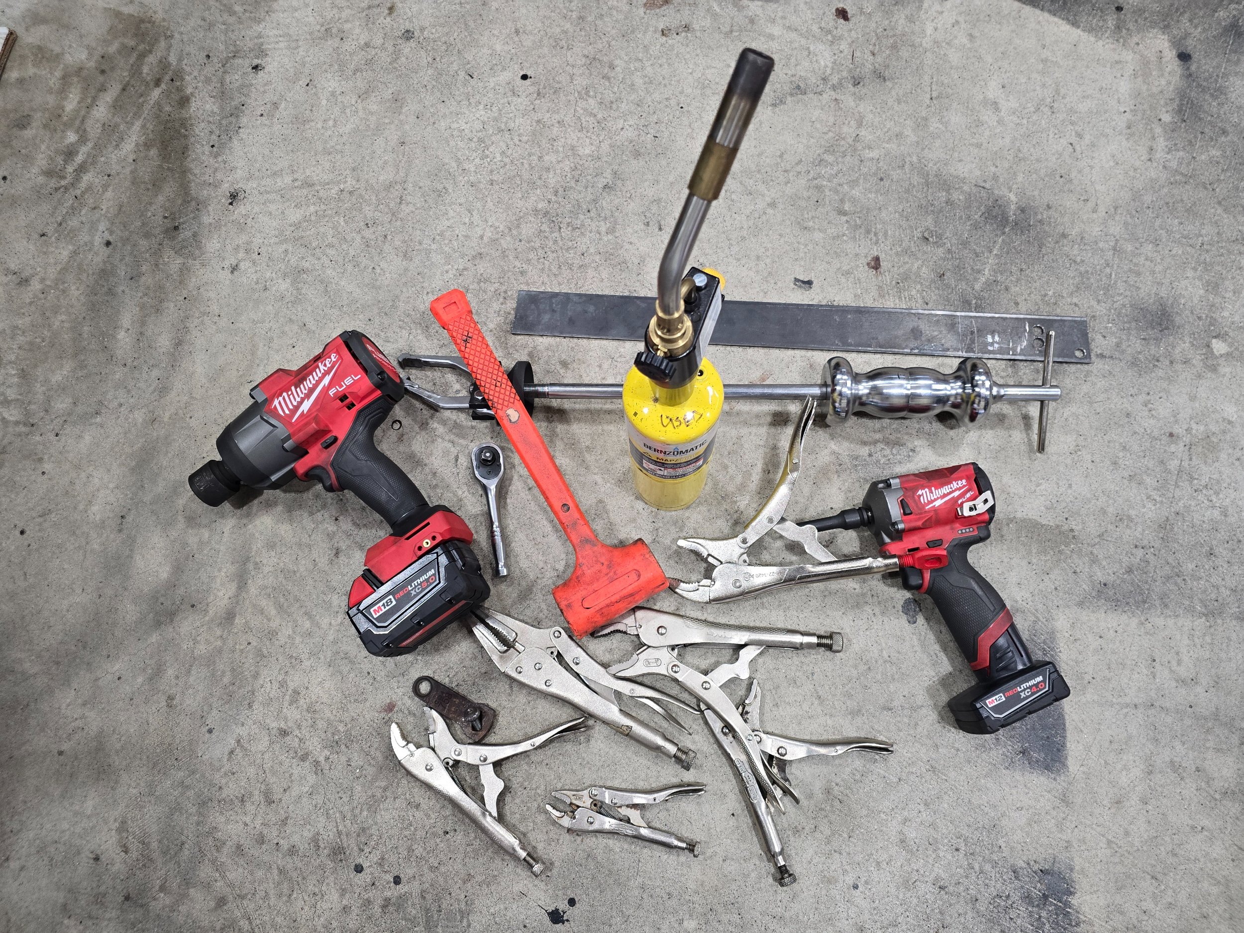

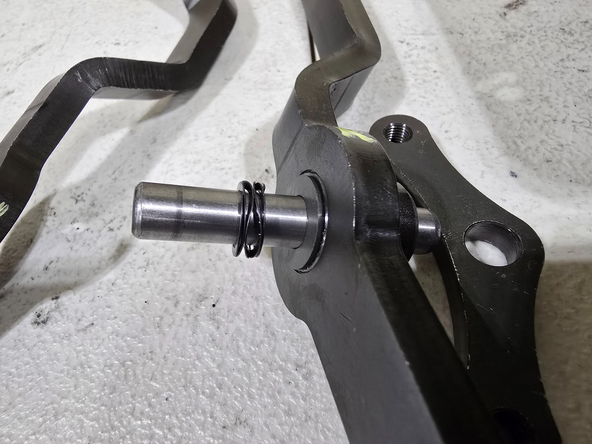

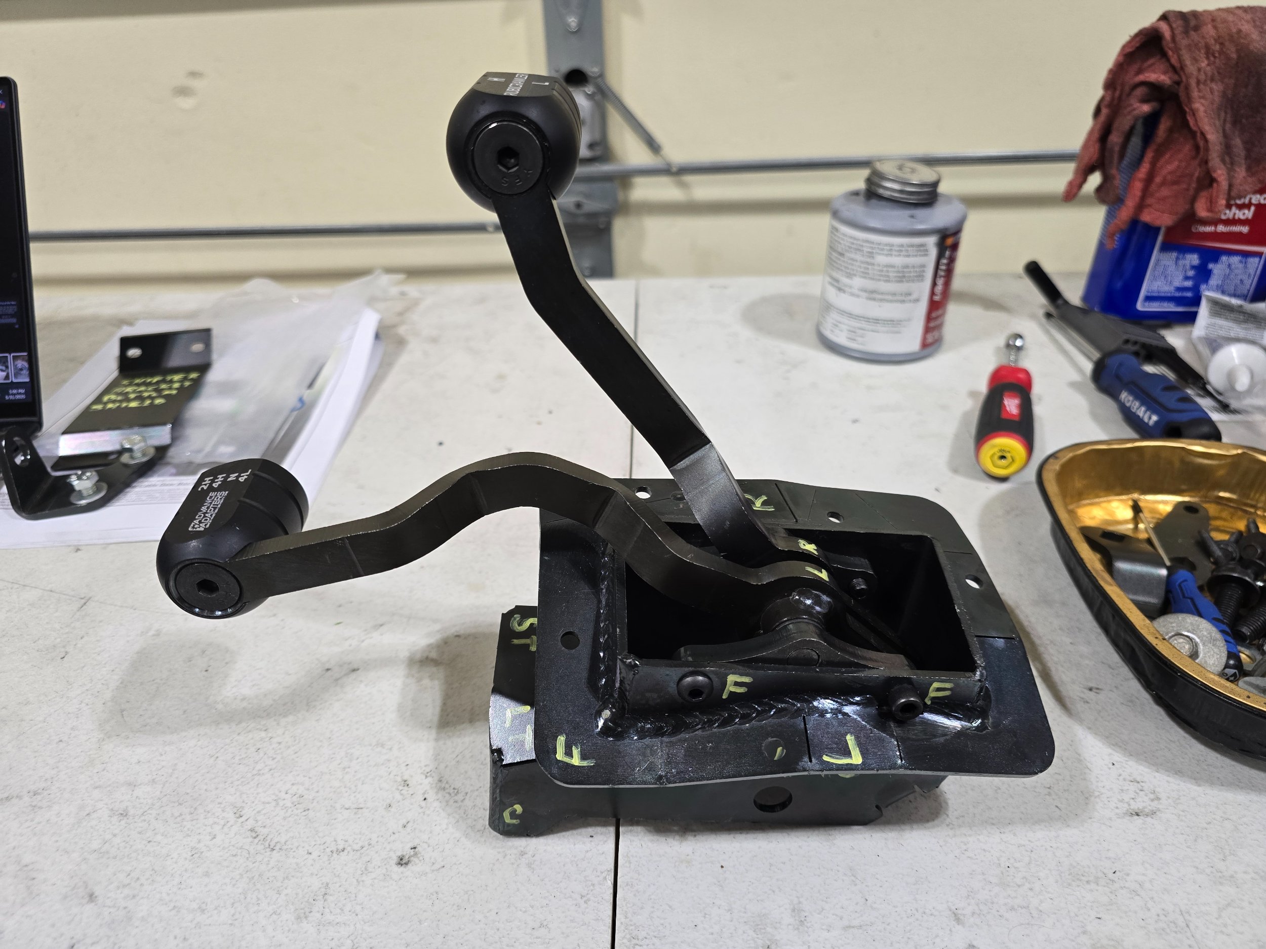

FWIW, the bottom picture is the pile of tools pulled to remove the 241shift lever. The factory puts a strong thread locking compound on a bolt that requires 20 ft lbs torque. It was not fun to remove!

https://blackmagicbrakes.com/ols/products/42rle-transmission-pan

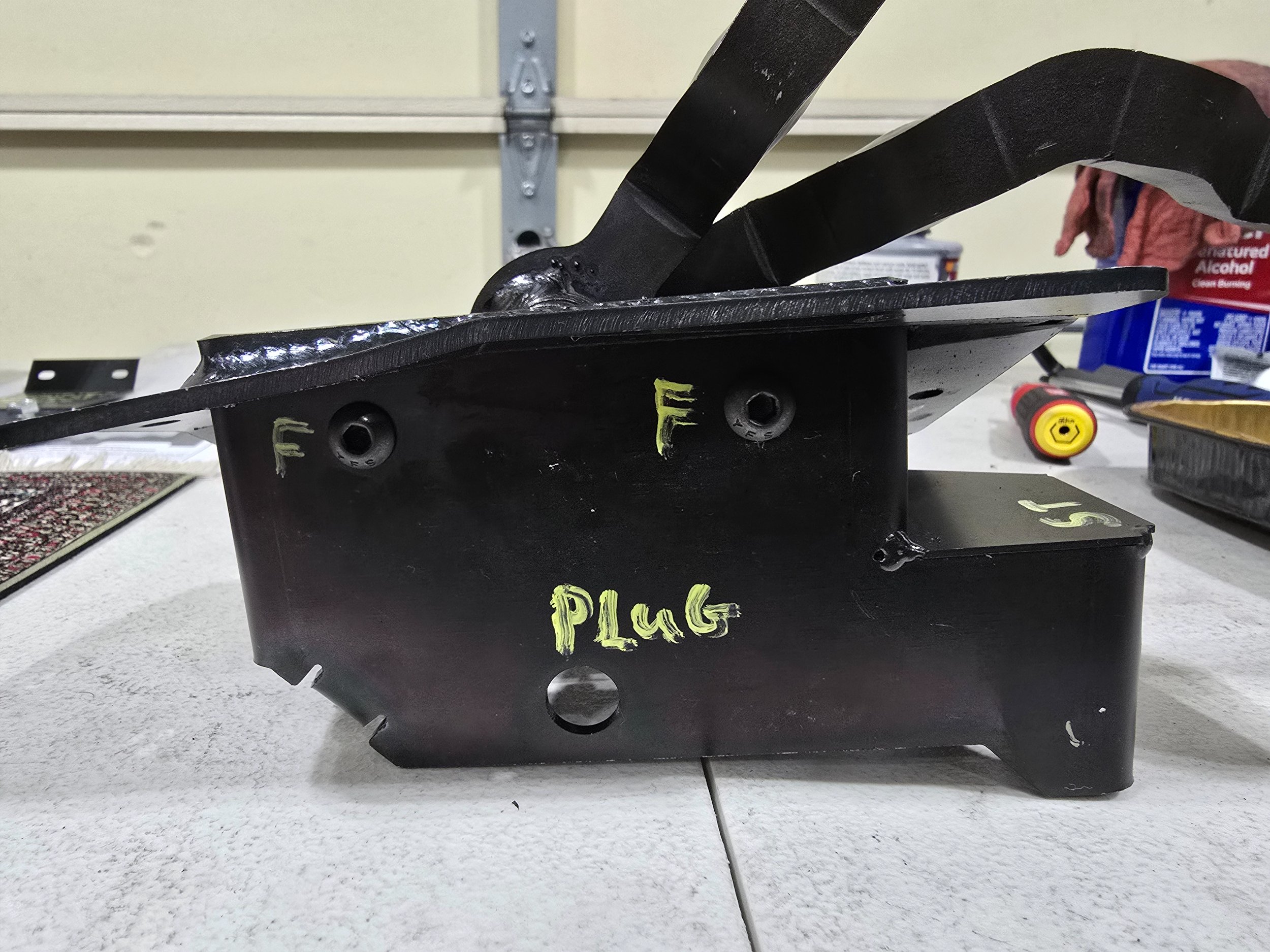

All that's left is to install the 241, adjust the cable, install the cover over the shifter bracket, then finish the console install.
Looking good Rich. Having installed my Atlas cable shifters recently, I can appreciate the quality of the AA Rubicrawler shifters. They build great quality products that just flat work. I'm excited to see the finished product!

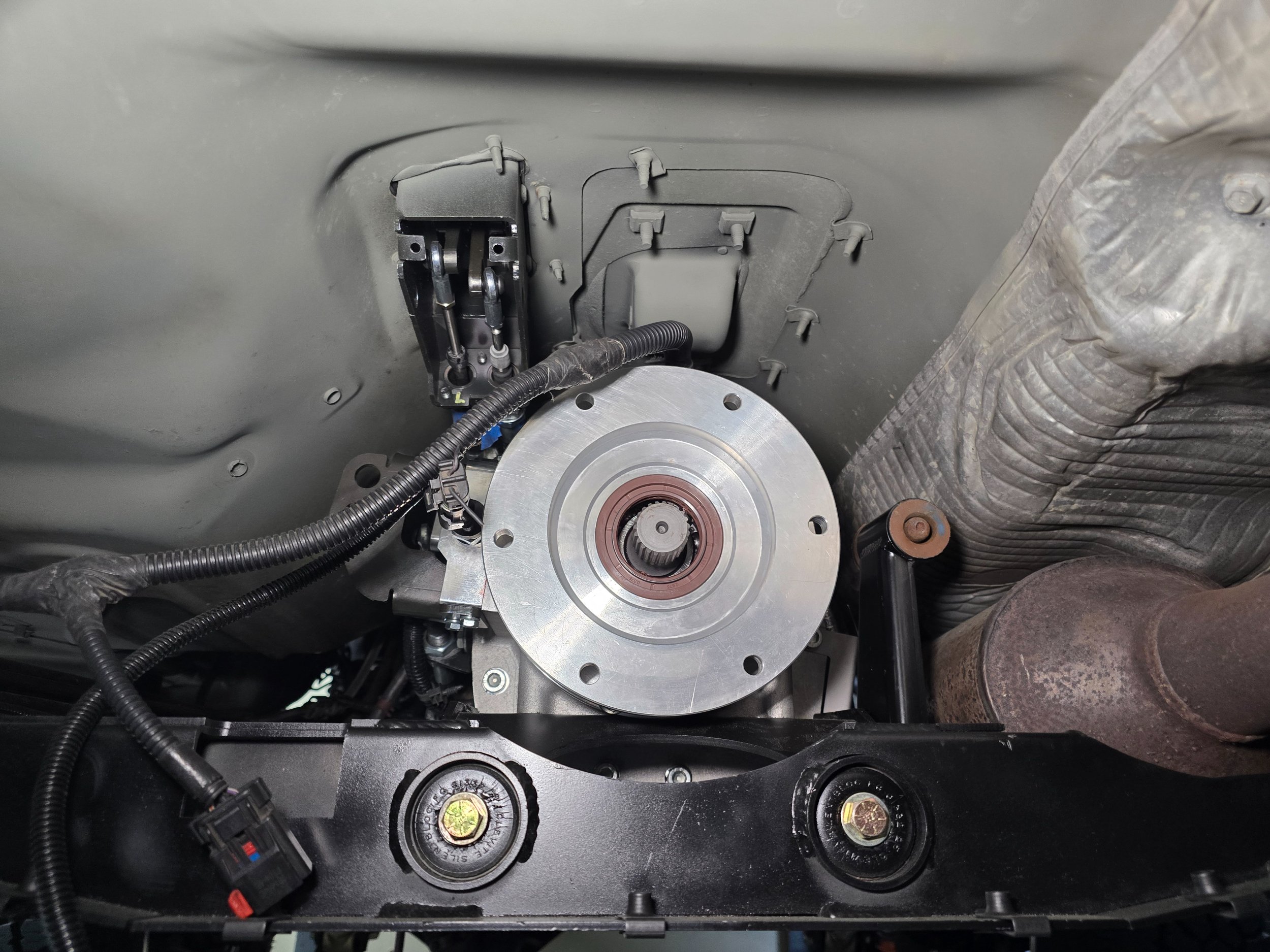

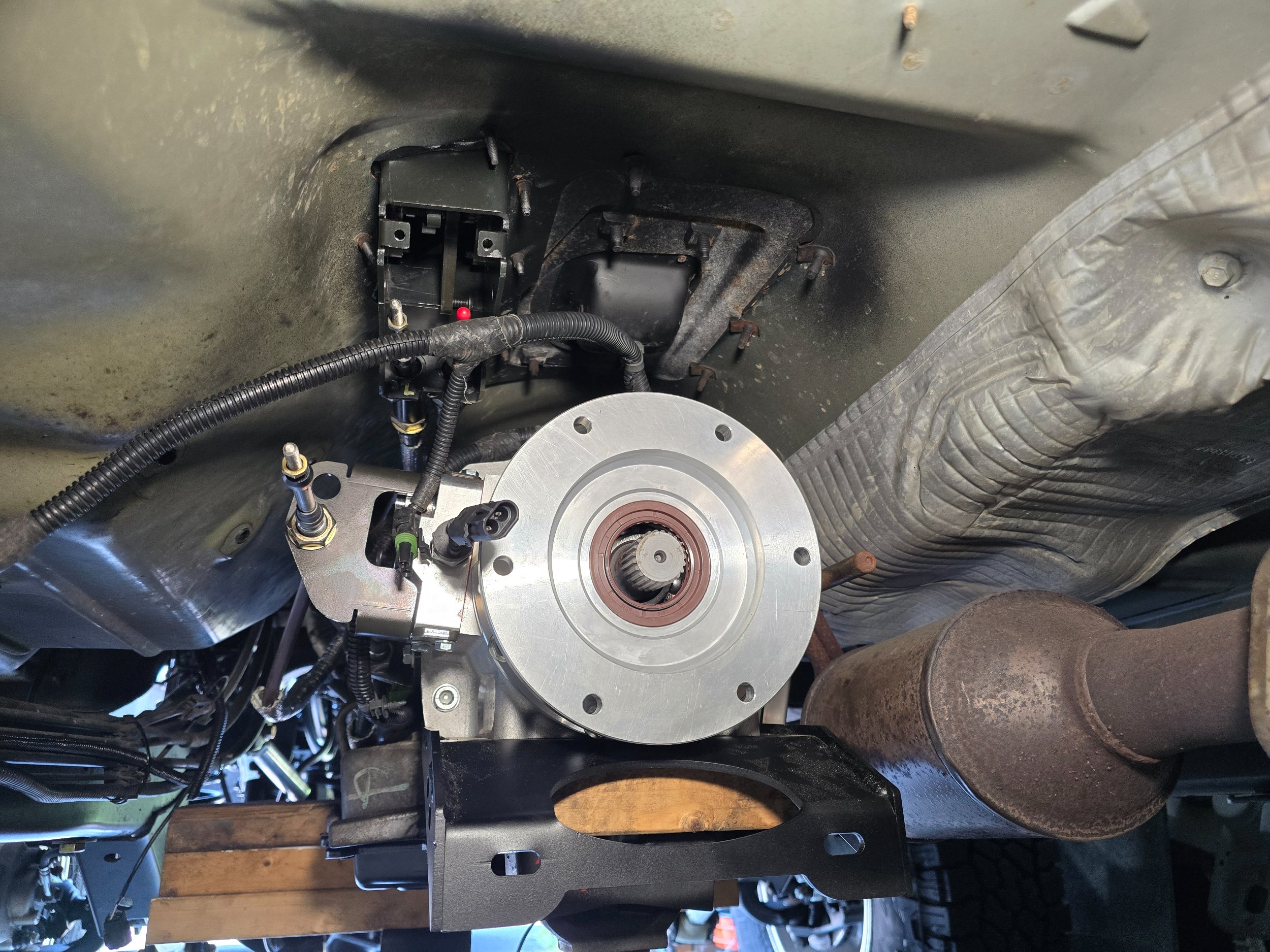

Thanks. I've got some pretty heavy personal stuff going on now and the Jeep has been my coping mechanism. Chris, @SkylinesSuck, came over yesterday evening and helped me get the 241-case in. All that's left now is the install and adjust the transfer case cable, then measure for driveshafts .

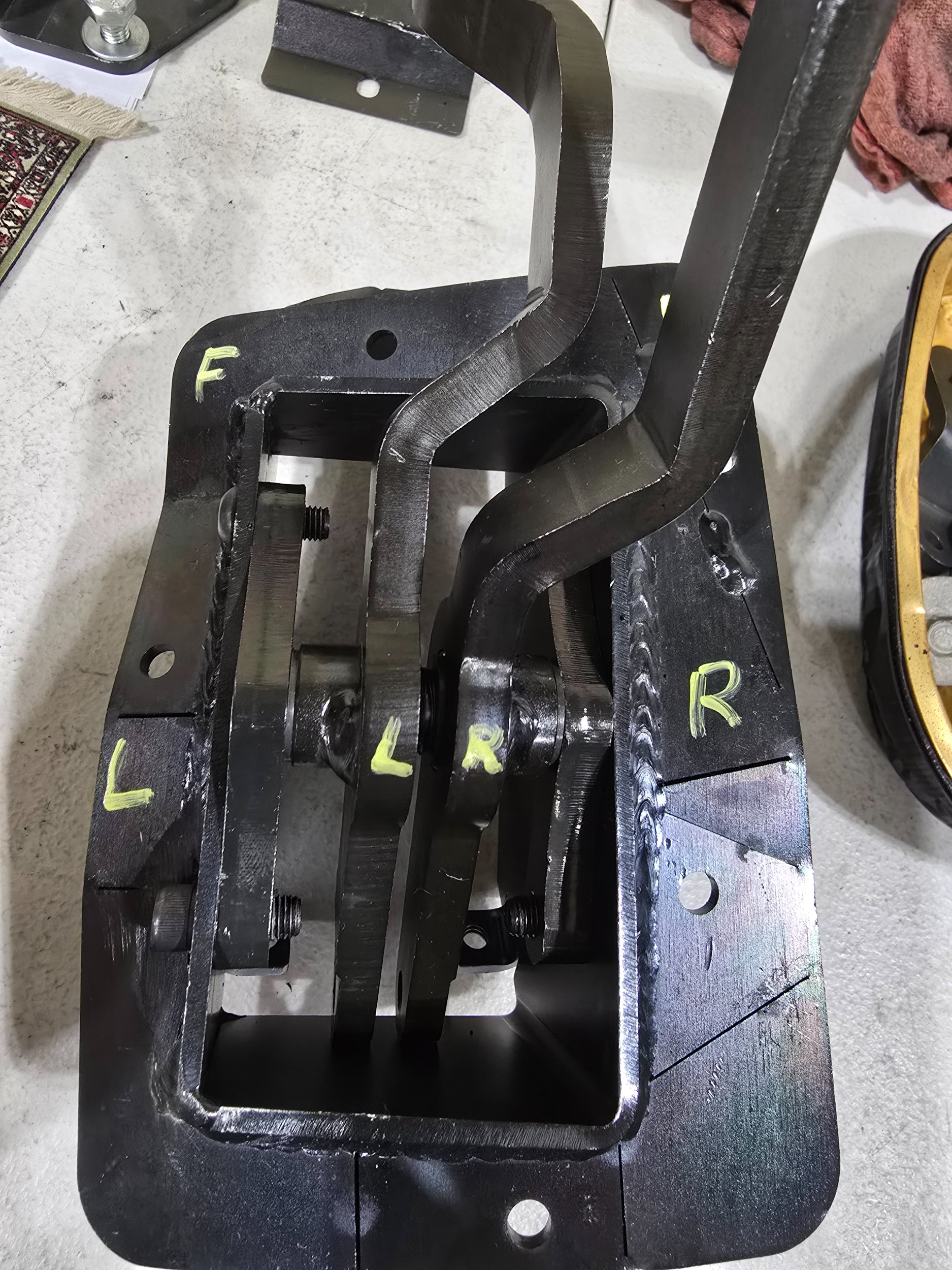

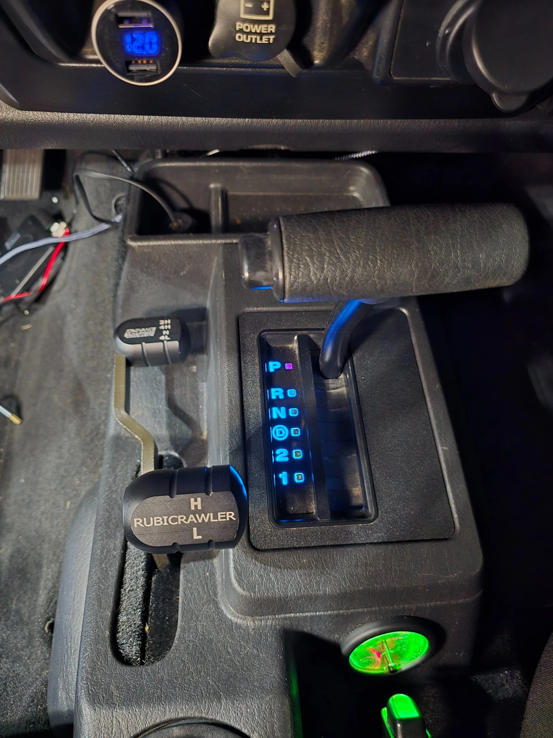

The RubiCrawler cables and shifters are adjusted, and everything works like it should. The shield that that covers the bottom of the shifter bracket needs to be installed and I need to go over every nut and bolt to make sure I've not missed something. After that, I'll be able to measure and order driveshafts. For this one, I'm a little disappointed with myself. When I did the rear, I meant to swap the rear LJ yoke (1310) with a Rubicon (1330) one. I get that the 1310 is strong enough, but making the upgrade would have been smart. :cautious:

Without the driveshafts, ran the transmission and transfer case through the gears. Let it run for 15 minutes with no strange noises or issues. Now the driveshafts can be ordered. Also, super happy my 4wd light works, when engaged.
