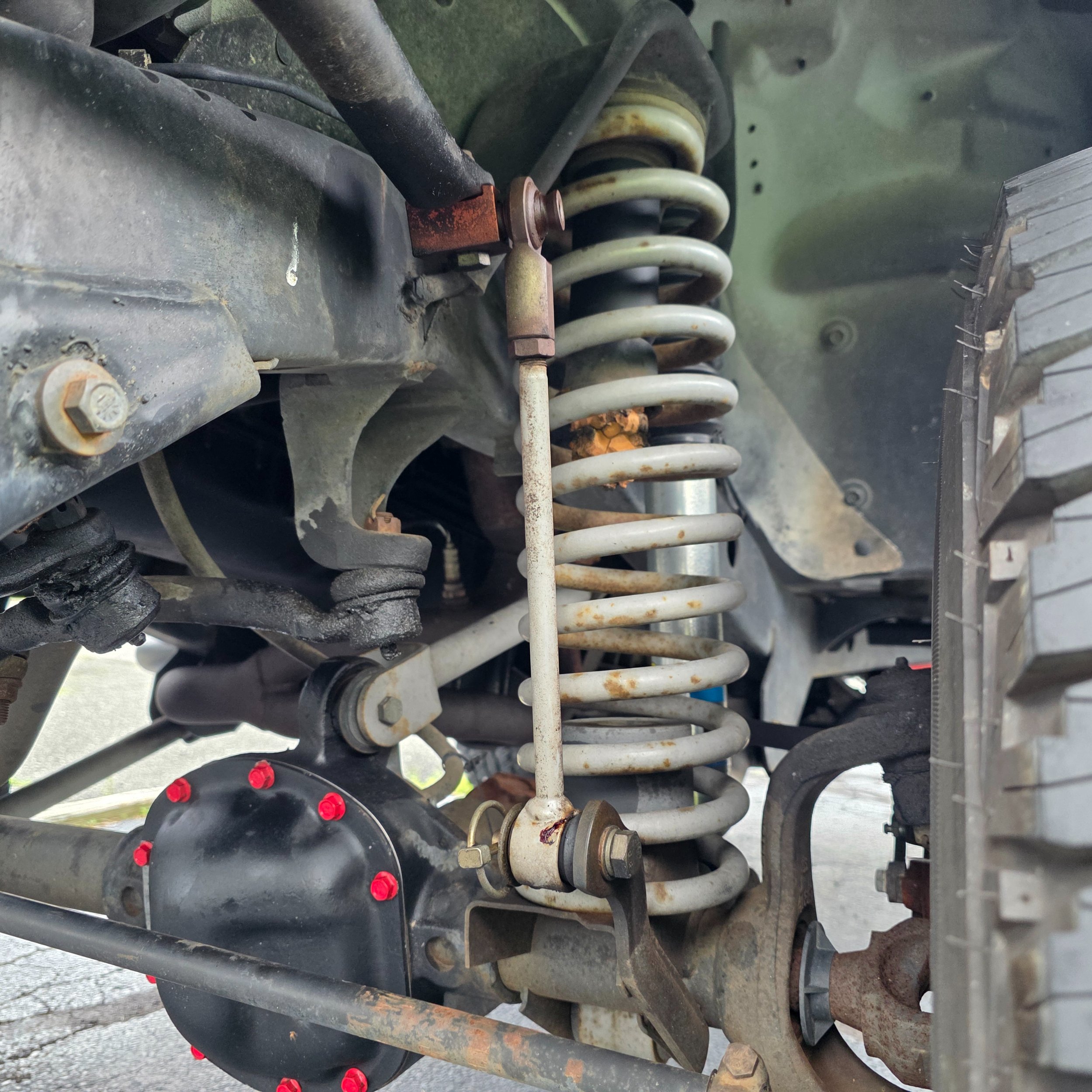

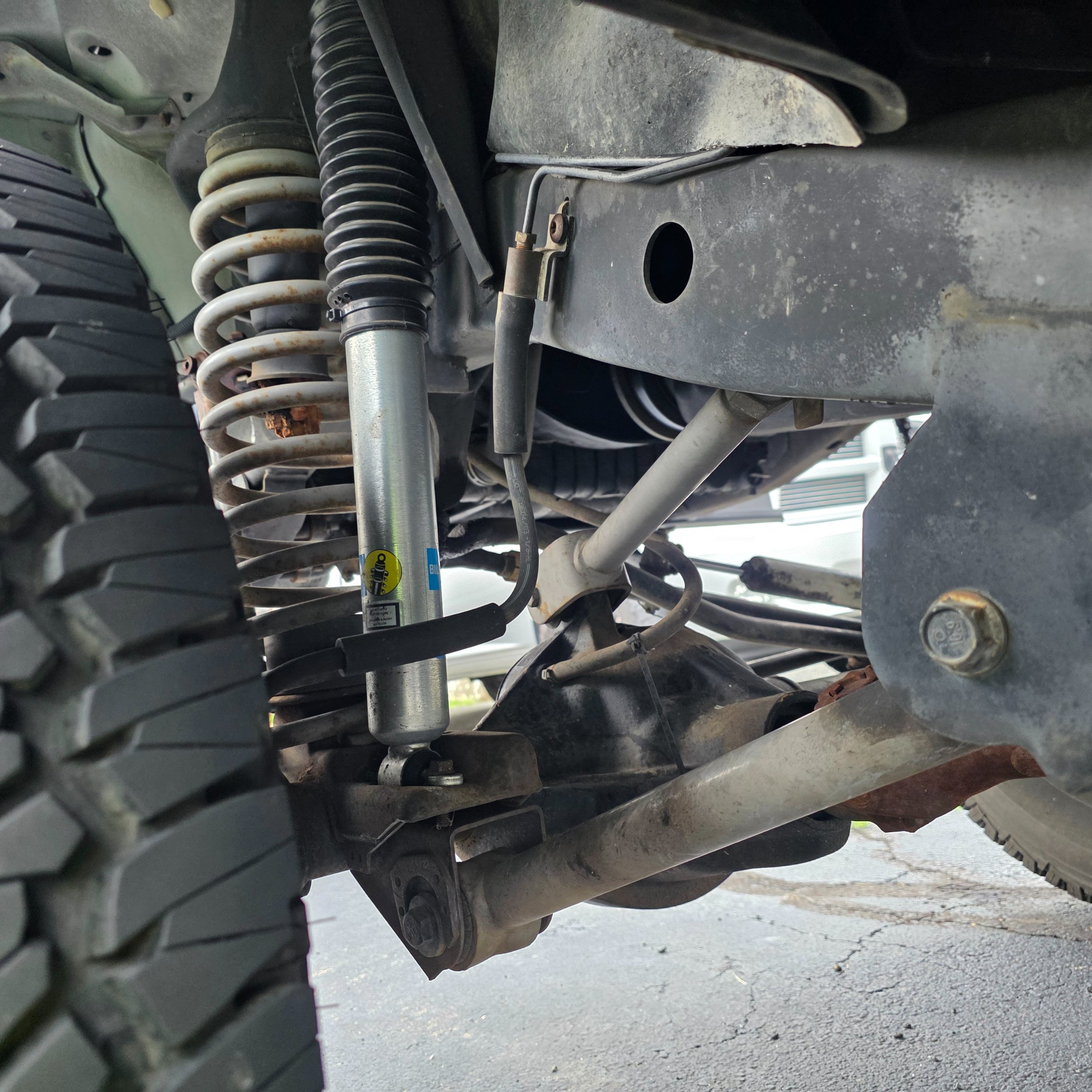

4" Lift (unknown brand, anyone recognize it?)

Sounds like you've got a lot of work planned ahead of you but have a clean starting platform.
Silver coil springs and control arms would generally point to Rubicon Express, but I can't say for sure.

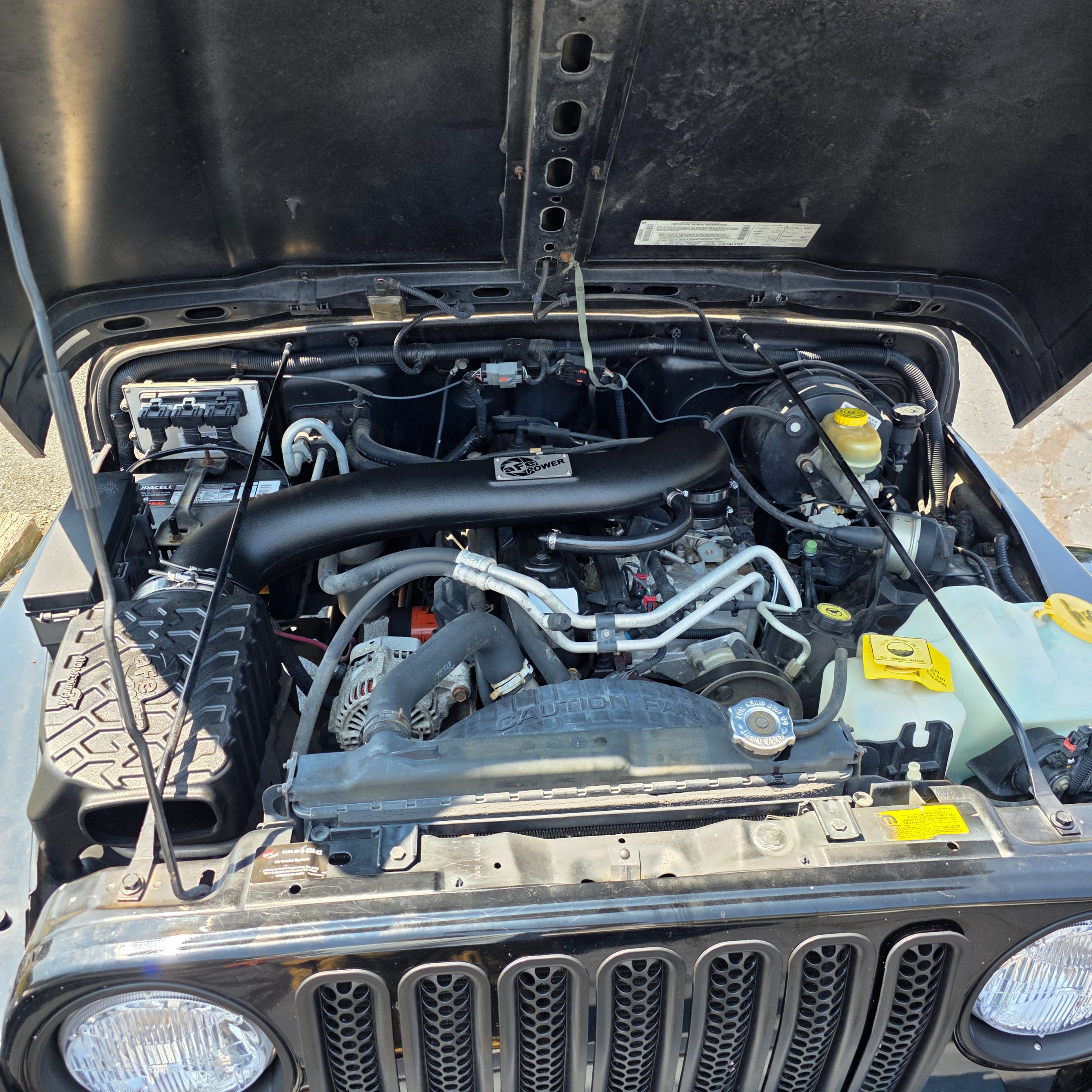

For the AFE intake, generally a stock air box or cowl intake like a Windstar is going to be recommended over any type of cone filter intake that is drawing heat from the engine bay. But like anything, it's your Jeep (and money) so by all means, build it how you want!
There's a ton of great information and builds on here to keep you busy!
Thanks for the input. This is why i chose the AFE intake, I can draw air from outside the vehicle only like factory box using a urethane plug, or draw from both outside and inside engine bay with plug removed. I thought this was a good middle ground, I run and AFE on my duramax and it performs extremely well. We shall see though, new to this platform.

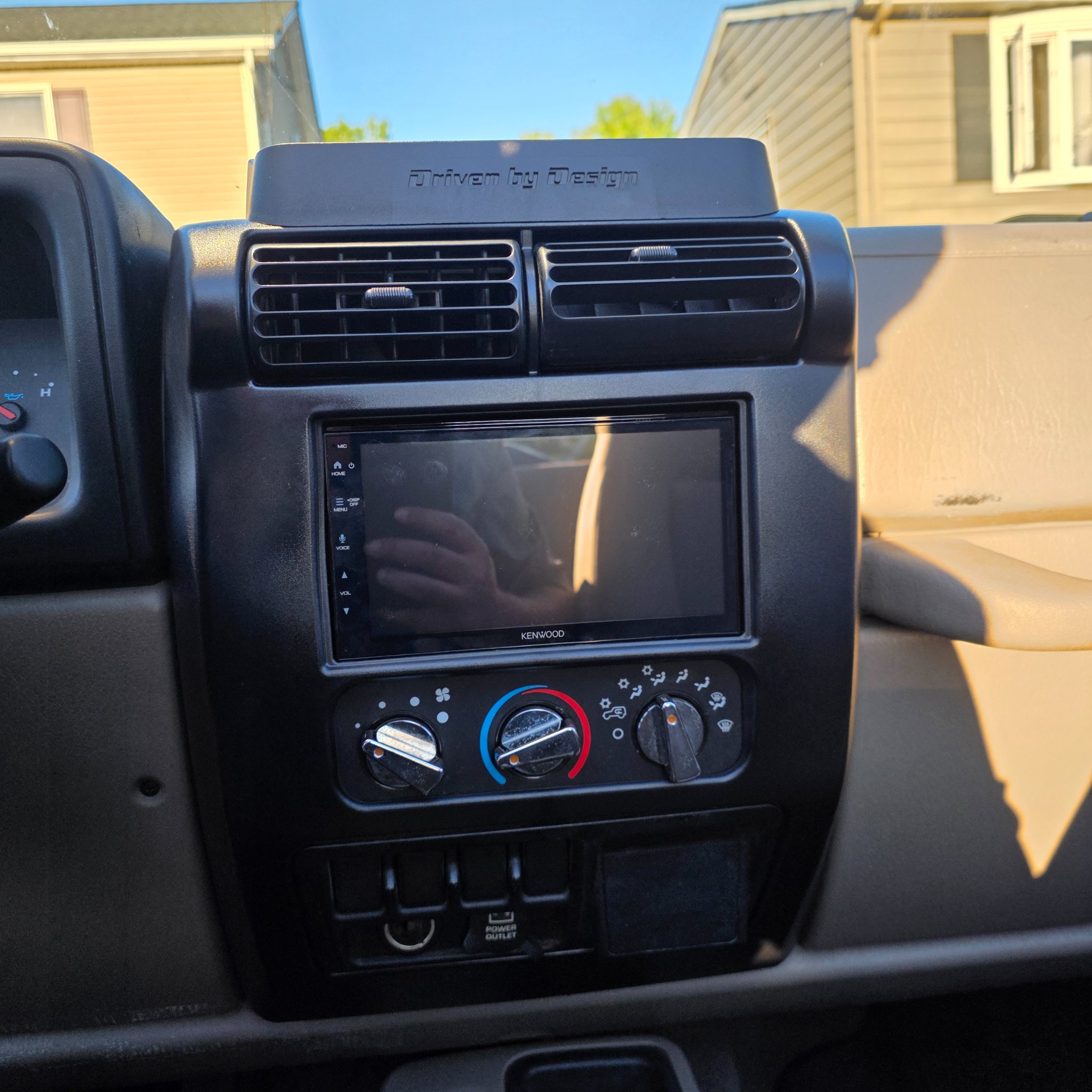

Got the new Head Unit and speakers installed, huge difference. Old paper speakers were shot, and having wireless android auto is great. I do immediately miss a volume knob though. Install was easy, used a oscillating tool to trim subdash. Crutchfield gave me everything I needed, even used their trim tools. I also used poly fill in the soundbar before installing new speakers. Ill tackle the console "sub" at a later date.
Kenwood DMX5710S
Rockford Fosgate R1525X2 Prime Series 5-1/4" 2-way car speakers (In Dash, Rollbar)
SiriusXM SXV300V1 Tuner

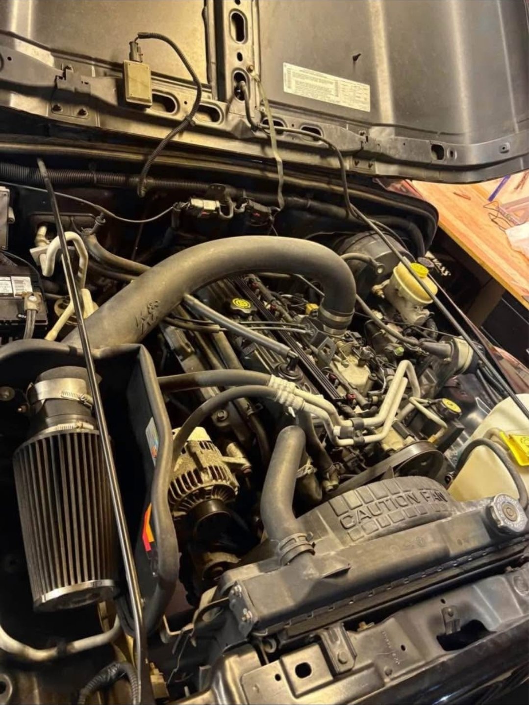

Well got the K&N CAI off and installed the AFE one. I'm pretty happy with it. Looks good.

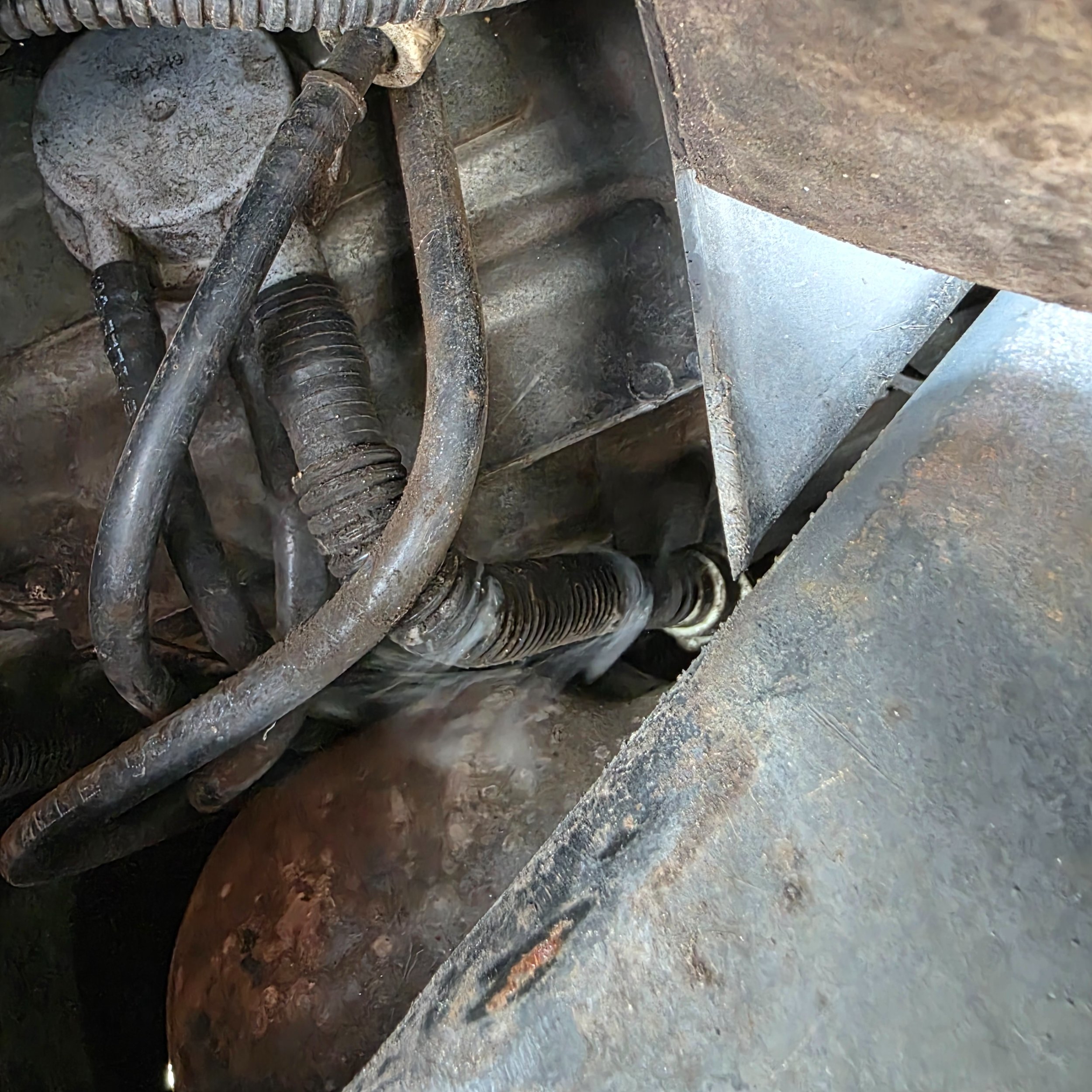

I also managed to smoke check the EVAP system and found my leak. Not sure if I can replace this part or how hard it will be to get access. Looks like it's the line that goes from my tank to the hardline set in rear of jeep. Pic attached as well.

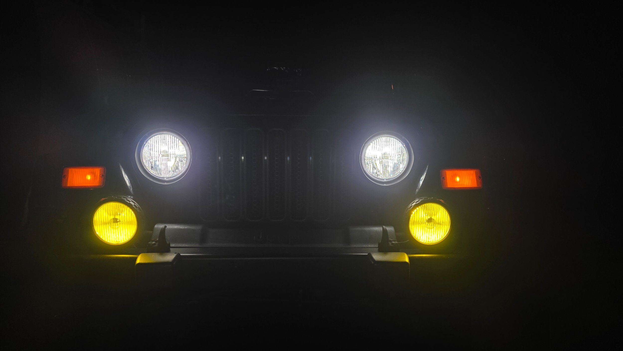

Other stuff I've done is replace the headlights with the Holly Retrobrights and my foglight bulbs with some Amazon yellow Leds. I'm so happy with the upgrade, the difference is insane.
