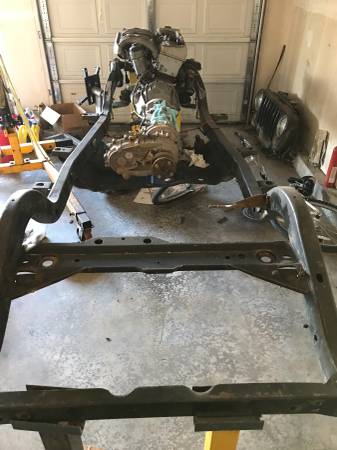

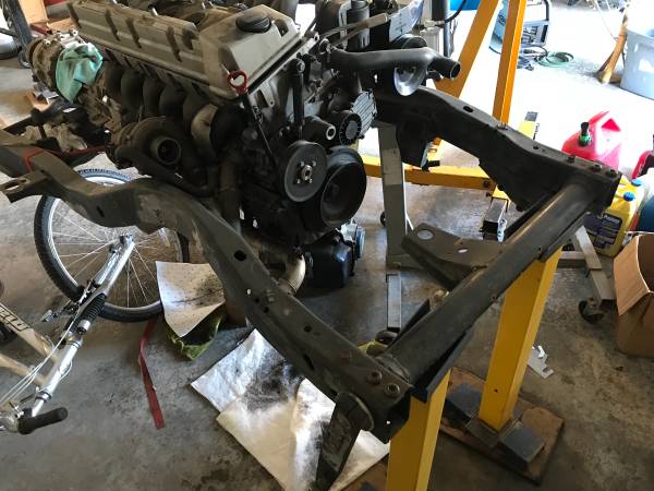

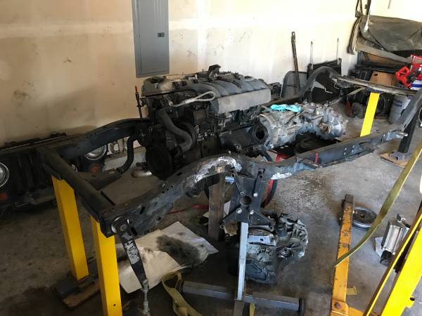

Too bad this guy cut off all the suspension mounts. He had a complete Currie AR in the front, and was asking $400 for the whole set-up. Then he removed the mention of the AR in the ad, and dropped to $300, and now $100. It's in Washington state, so shipping would be a killer.

This listing is for a 1997 Jeep Tj frame that was part of a project that just stalled out and is now taking up too much space.
The frame is in great shape but has all of the motor and suspension brackets cut off with the exception of the front trac bar mount and the skid plate/trans mount.
Shoot me an offer! Worst I can say is no! I want this thing gone quick!
