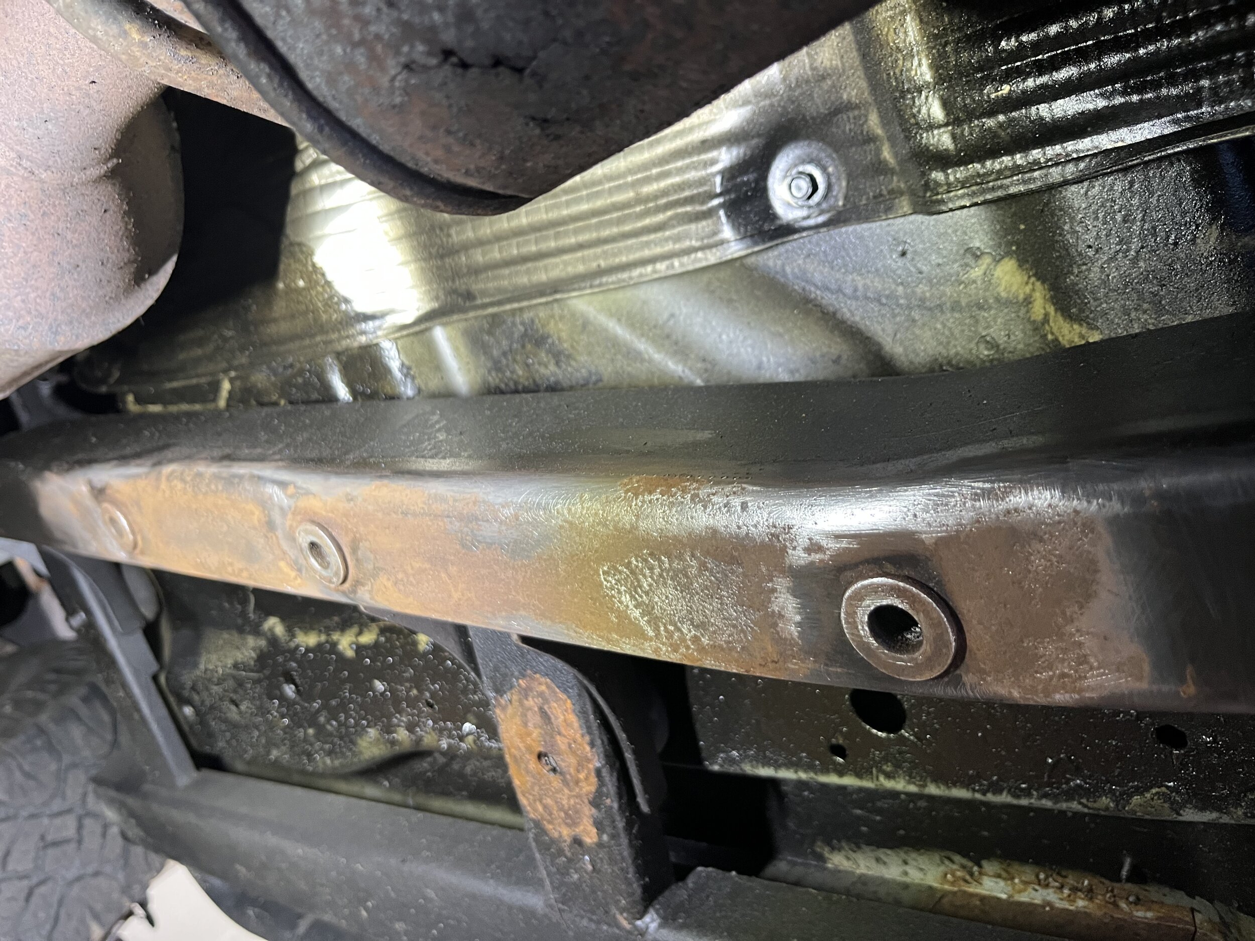

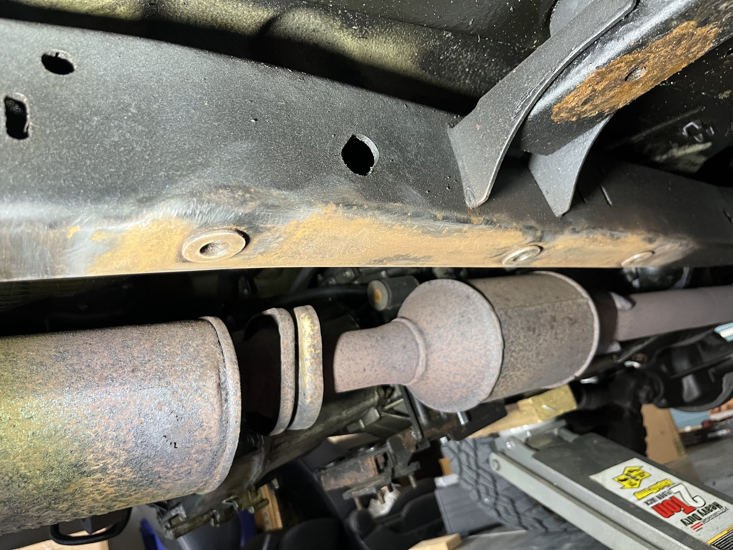

I have attached a few photos below of what one frame rail looks like after a wire wheel, polycarbide abrasive wheel and 80 grit sand paper. Looks like there's plenty of good metal left.
How much more rust removal / sanding would be recommended? I think whatever is remaining will need to come off with sandpaper by hand at this point. Also, what is the consensus on self etching primer vs rust converter in this application? Would one be any better than the other?
