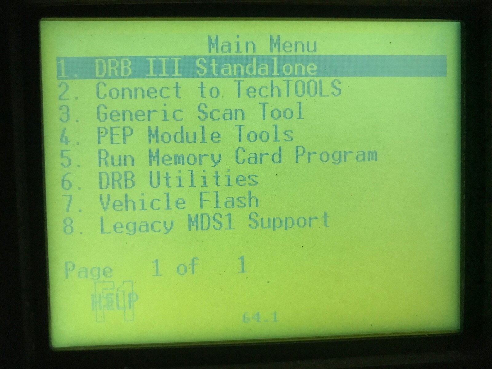

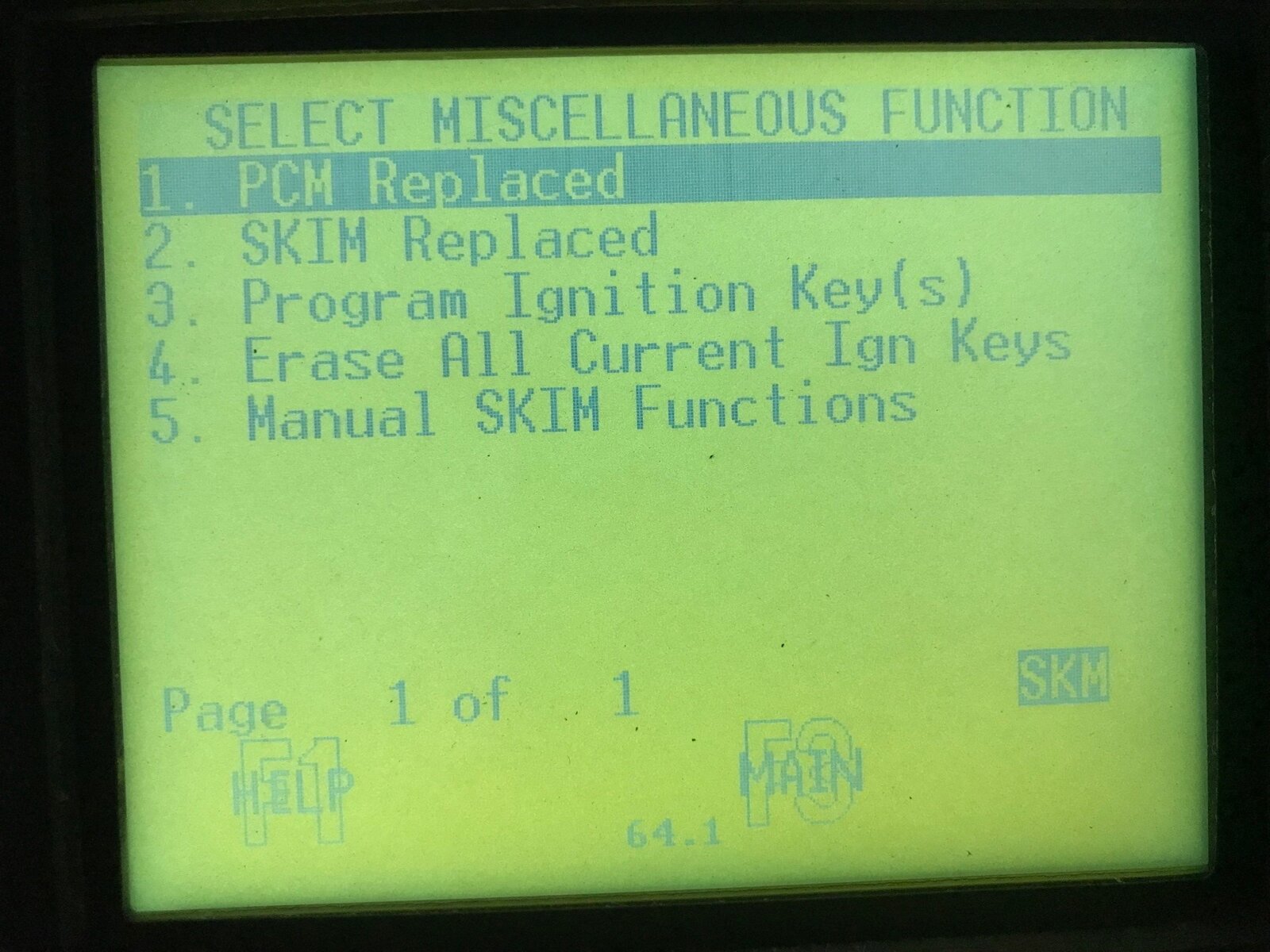

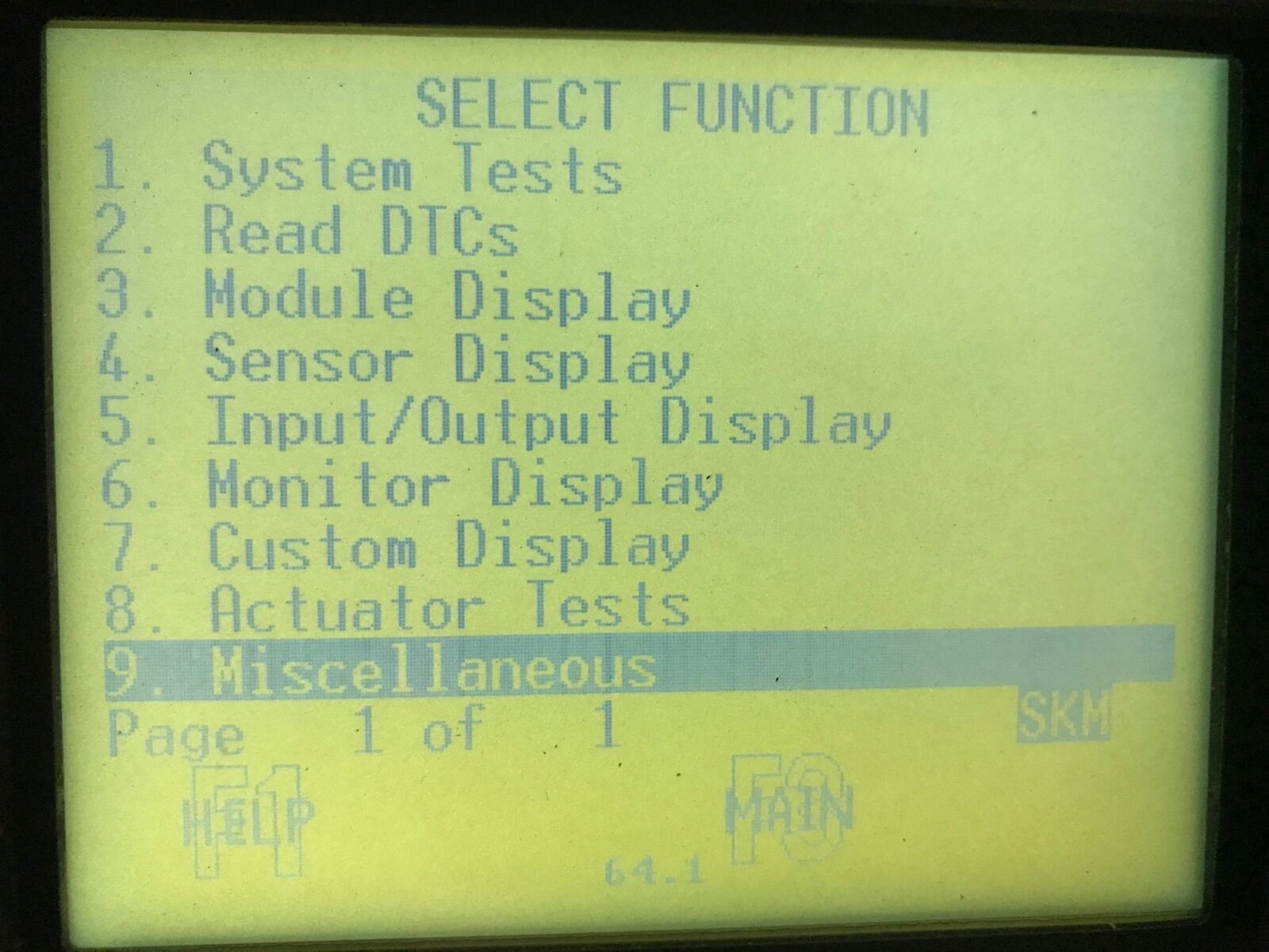

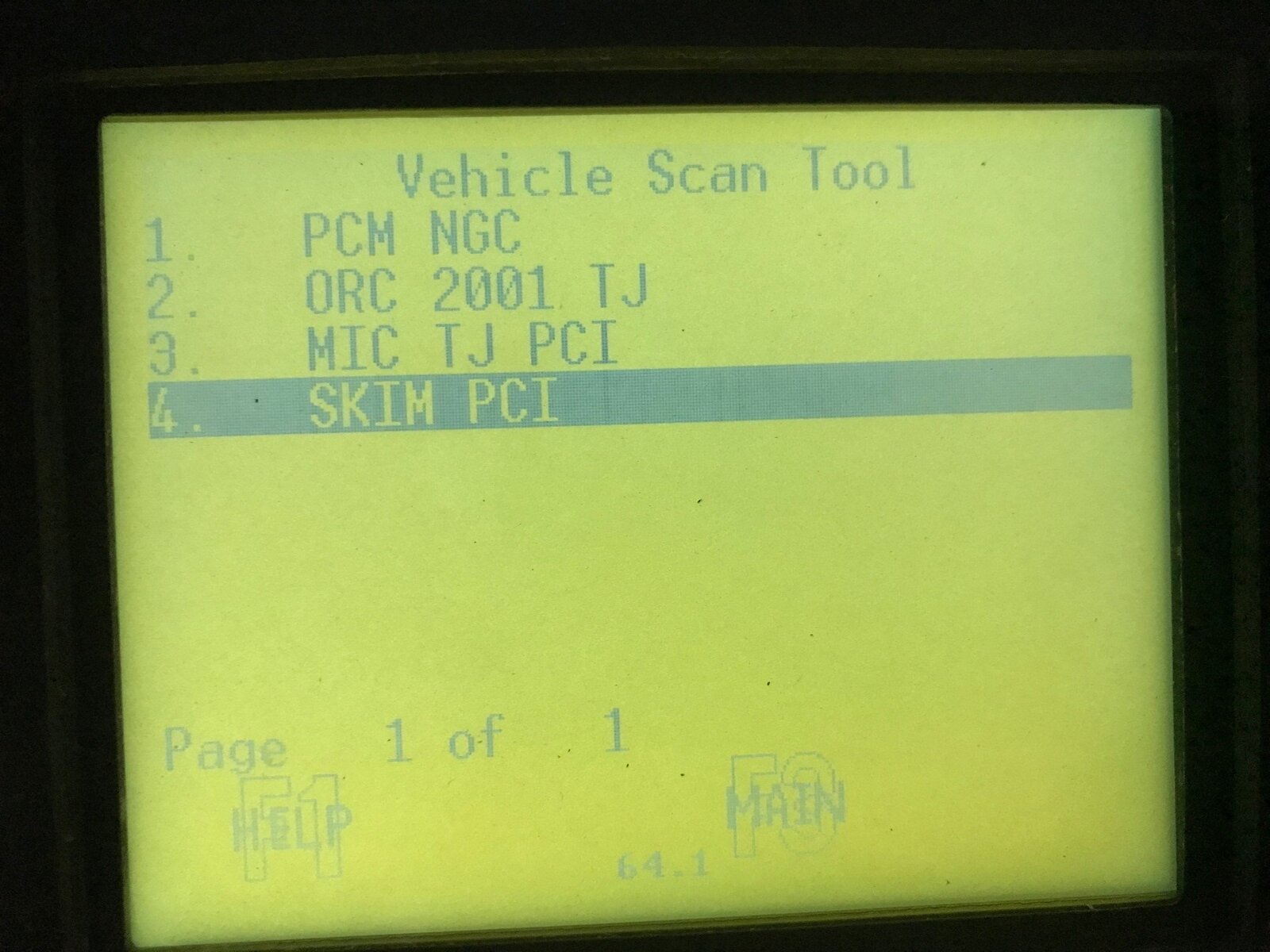

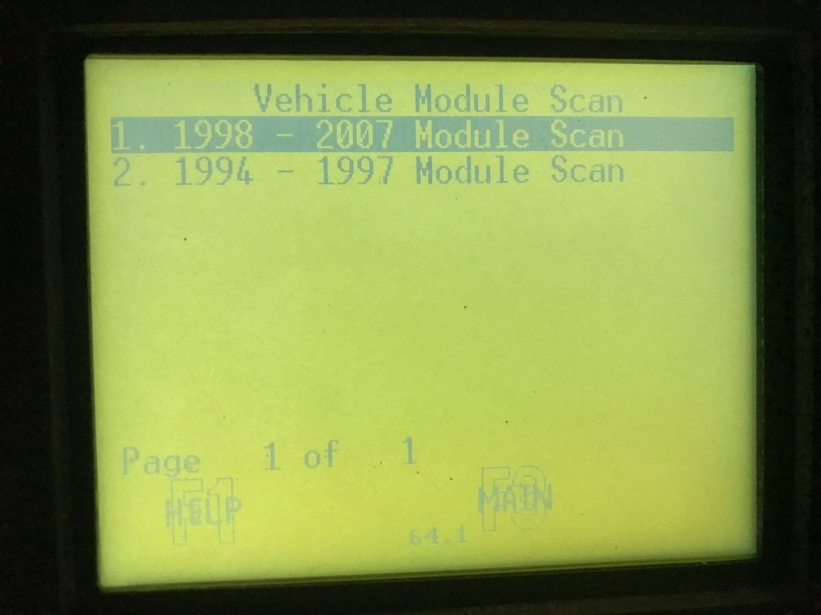

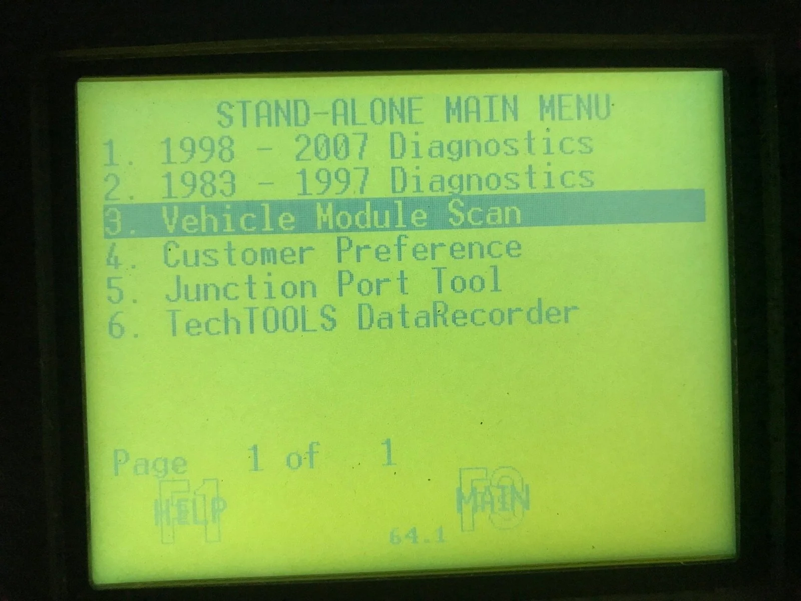

I just got this DRB III, so I’m as far away from a subject matter expert as one can get, unfortunately. However, I’ll look through the menus and take some screen shots if that will help.
Anything would help I'm sure. I've read everything from "program the PIN into the skim" which sounds relatively easy, to that the ecm has to be completely reflashed with a file that has skim enabled, which may or may not be more complex but nonetheless is completely different. I'd like to go into a conversation with the owner if the tool sounding like I have some idea what I'm talking about.
OK, here's the best I can do with my limited skill set. Starting from the opening menu, here's the progression (be aware that from the third to fourth screen shot took some time):
I didn't want to explore any further, since it may cause problems with my PCM or SKIM.
Thank you!!!
That makes so much sense to me now. If the pcm had been replaced, it would come without skim enabled so the tech would have occasion to do this operation in that scenario.
Perhaps it just sets a flag used by the PCM to do something the next time it's running?

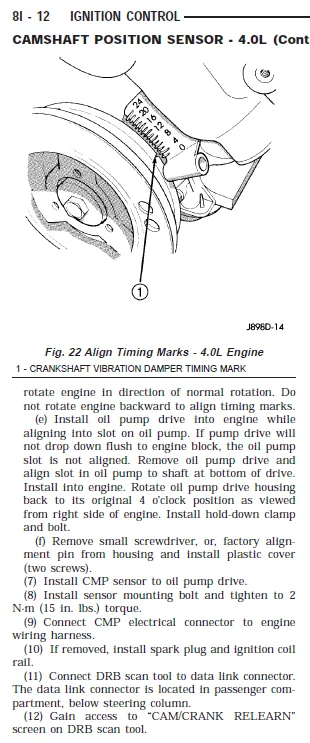

I have a 2004, section 8I-10 of the factory service manual describes the correct procedure for using the DRB to reset the OPDA on my Jeep. Step 11 refers to the "SET SYNC" screen which I used. I don't know the process on yours. People refer to relearn all the time, maybe because it's a menu item? It isn't what you do on a 2004.
Not yet, but I thought 2005-2006 was an entirely new PCM so I wouldn't expect the procedure to be the same as for an 04.
Reactions: pagrey
From the brief time I've used it (I got it this week), I noticed one important characteristic. The menus change based on the specific vehicle plugged in. It scans the modules on the vehicle and creates the menu system. That would explain the difference between your 2004 and my 2005, especially since the ODPA changed in between those model years...
Reactions: pagrey
Apparently, the relearn is specific to the 2005-6 OPDA. Page 8i-12 from the FSM (see Step 12):
So, the reason you've heard reference to a relearn function is because it exists, but only for the 2005-6 model years...
