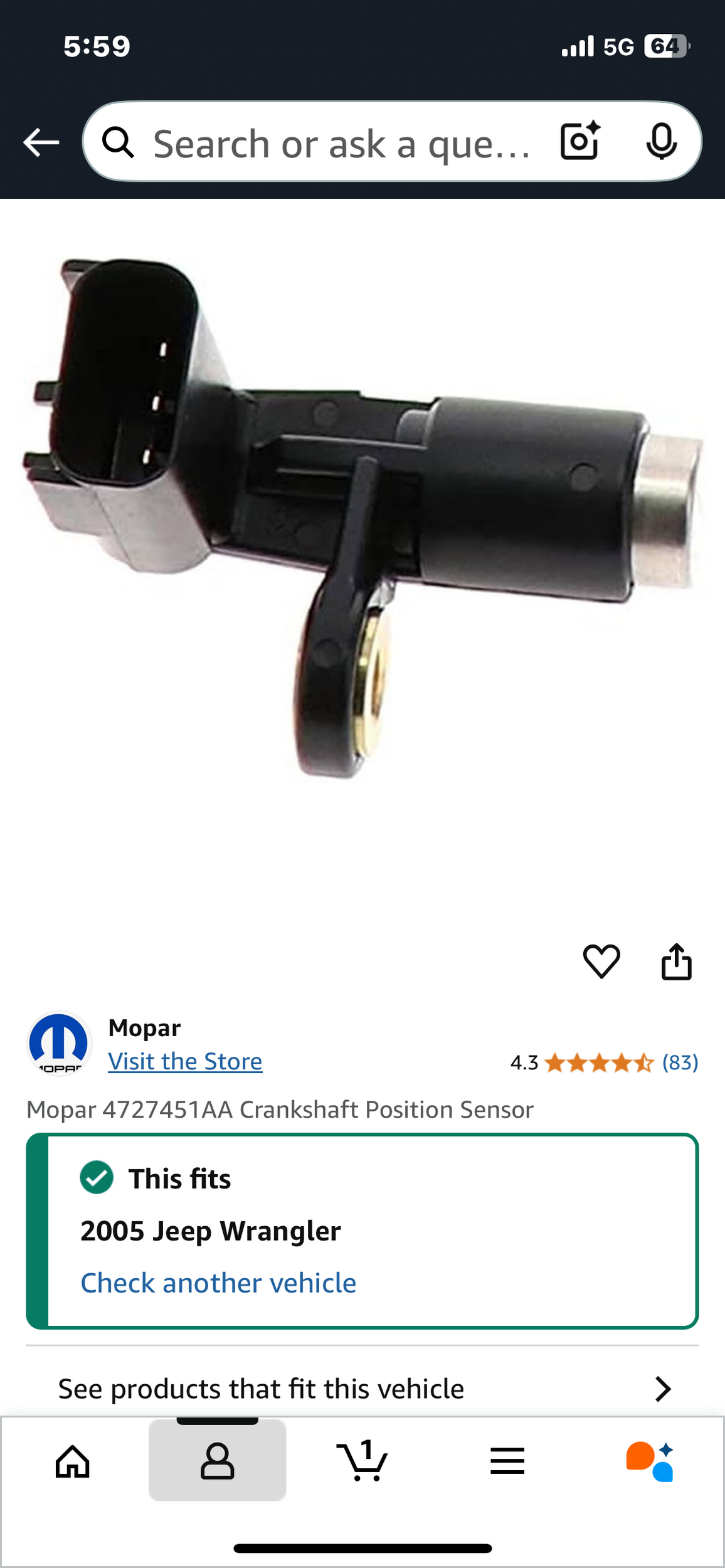

I scanned it quickly with my OBD reader and it was the Crank Position Sensor A code again and wouldn't Rev over 2300 RPM without bucking. I put it in neutral, snapped the key off and restarted it while rolling down 40, the CEL stopped flashing and it ran fine. When I got off the interstate in Effland, I cleared the code from the PCM and drove home in the rain without repeat or issue. It hasn't thrown that code sense either.
I'm not sure what to make of it right now. Considering trying a different brand crank and/or cam sensor to see if it's just a fluke related to a sensor.
