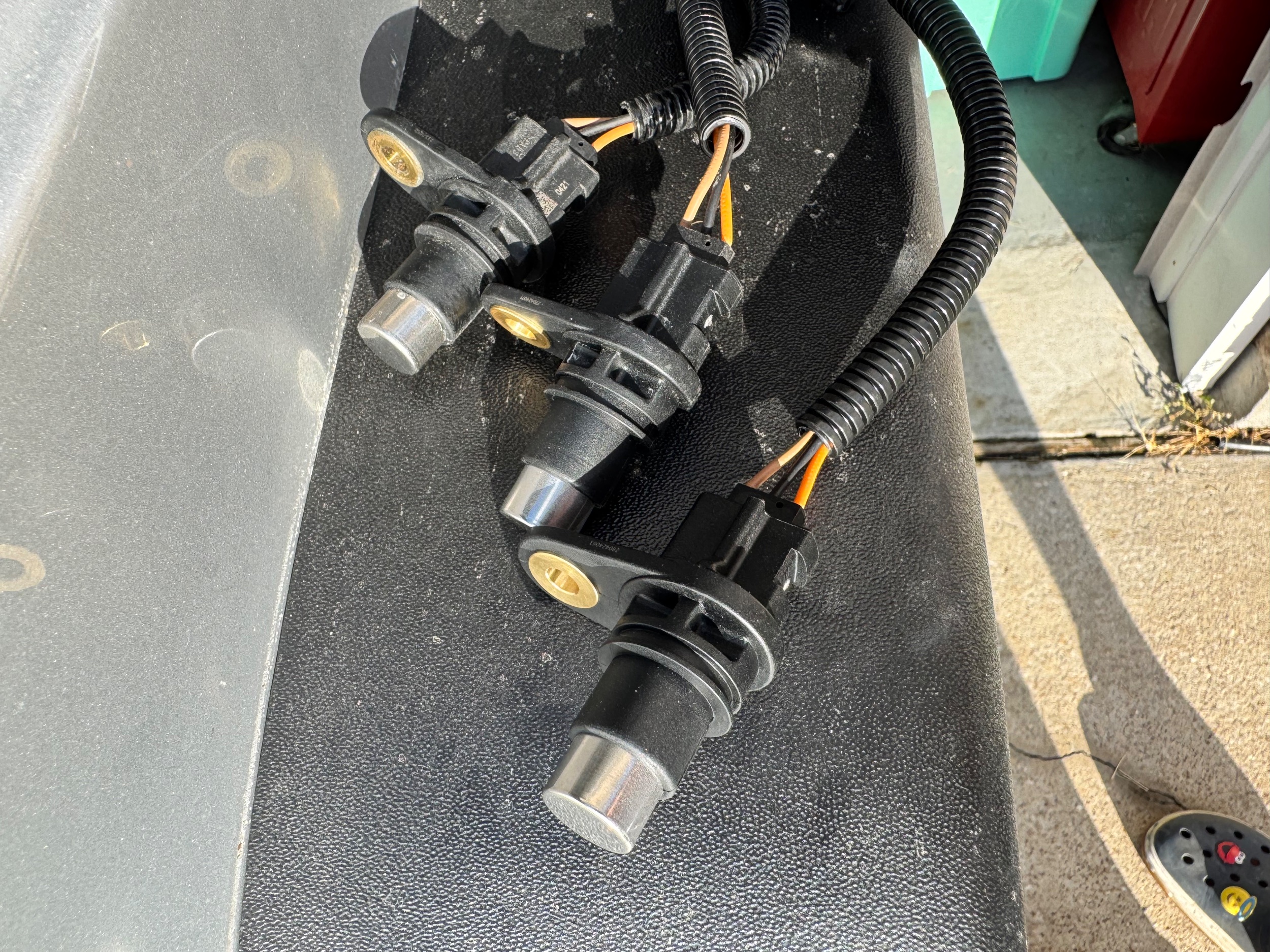

But also point of order, the thread is about CAMshaft position sensors, but the pics posted by a newer member on page 1 were of CRANKshaft position sensors. Regardless, I've always wondered why these "go bad" given that the Hall Effect sensors have no moving parts and the magnets used are permanent magnets....the only things I can come up with are internal wiring or something like heat cycling pushing it out of spec over time.
I’m OP and those were my pics. Each of those sensors came from the oil pump drive assembly, which is where the camshaft position sensor sits.
Crankshaft position sensor sits on transmission bell housing. They may differ after 2004, the 2005-06 OPDA is a different design than the previous years.
Your larger point stands, and my assumption is heat on poorly made components. Some people see issues from the harness itself degrading, from what I understand
