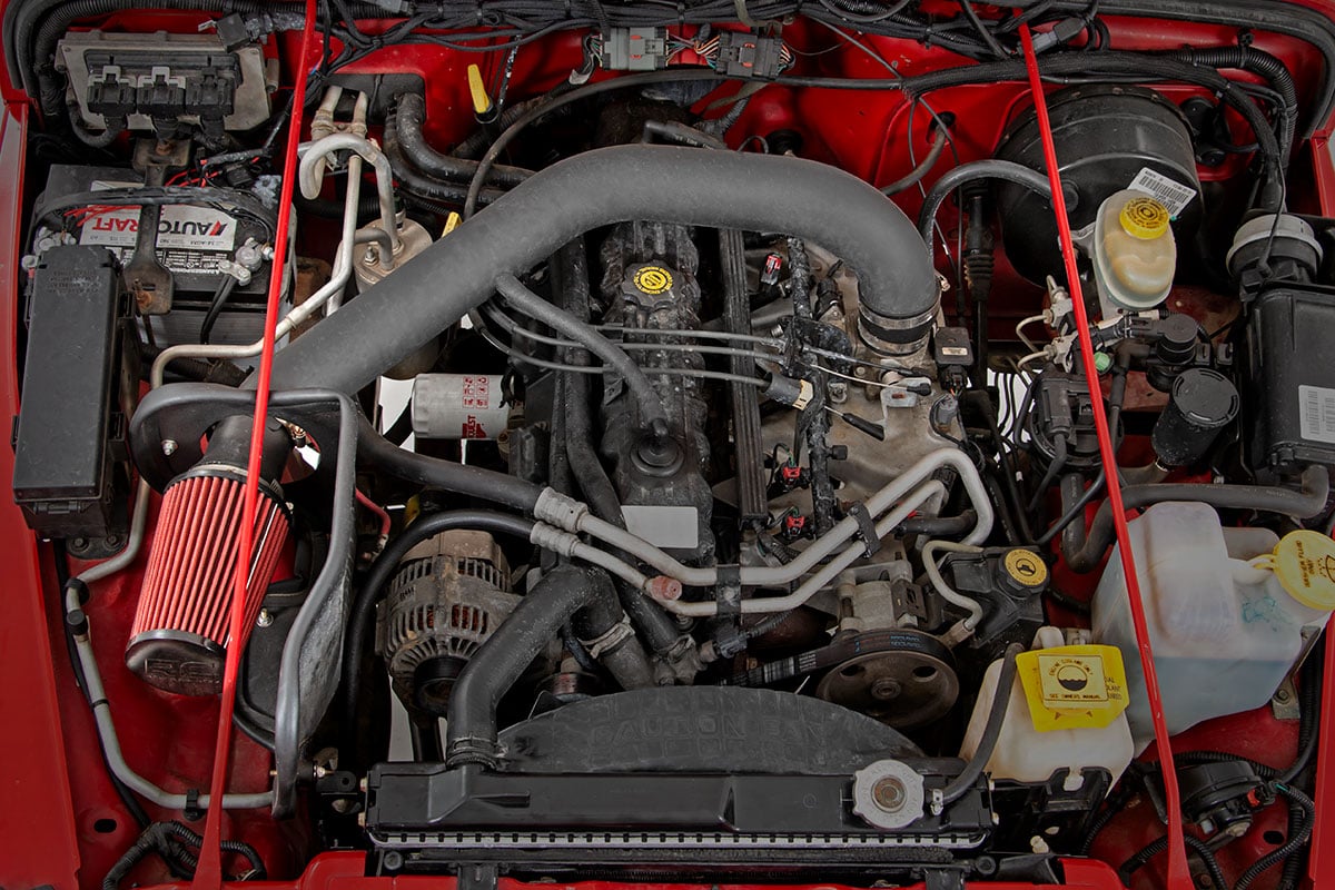

The CAI is unlikely to be the culprit here. The sensor you installed in your CAI is an intake air temp (IAT) sensor. The PCM uses it plus the manifold absolute pressure (MAP) sensor to calculate the air density. It isn't going to be tricked into running lean (which can be an issue with MAF sensors), though I think the sensor in the intake manifold after the throttle body like the 04 and earlier is a little more accurate for the way these reverse flow engines like to heat the intake air at low speeds/loads.

For the record, I've done several like that. None of them have melted cats. You can take that a few ways. We aren't introducing "slugs" of cold air, or we aren't getting any cooler air into the intake. Or, cooler air isn't responsible for melted cats.

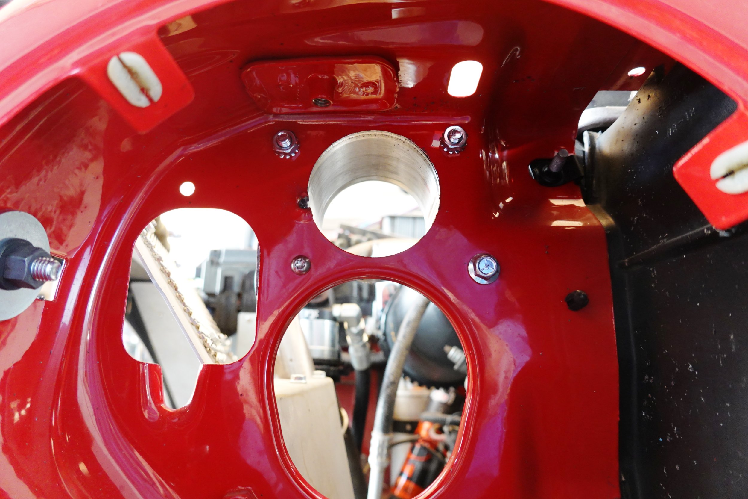

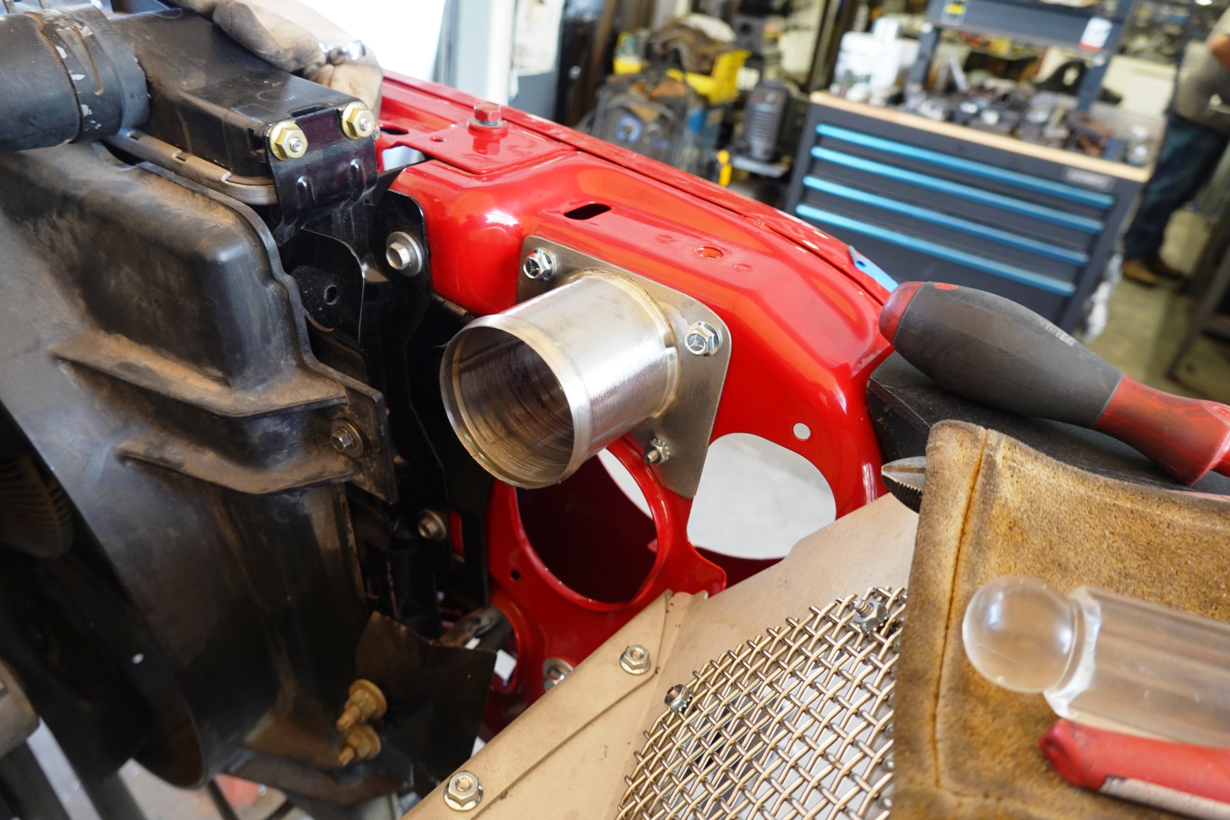

Are these gonna be on your site?,does it get air above the headlight?having trouble visualizing from the pic.

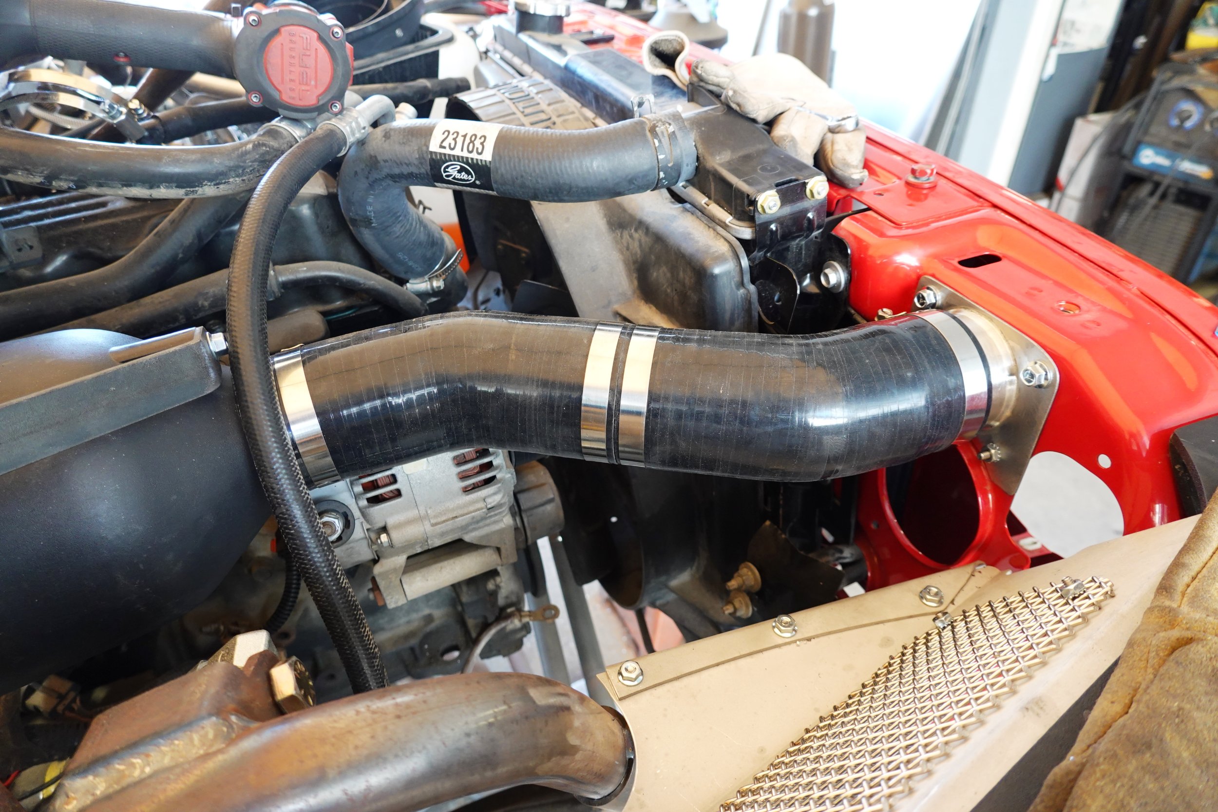

Yes the air comes from behind the headlight. That is how they did it on the last years of the CJ with the BBD carb. Pull the cold air. To pass emissions on the YJ and TJ, they used under hood air because it was consistently a smaller range of temperature.
Nice work Blaine . Details like the rolled bump on the end is a first rate touch .

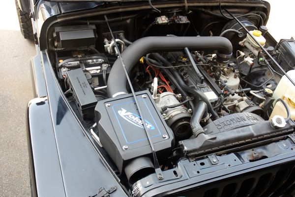

The hot air being drawn in the "CAI" can cause the ECM to lean out the mixture because the air is less dense.
Yes, that's what is SUPPOSED to happen in order to maintain the correct fuel/air ratio. "CAI" kits can reduce power by sucking hot air instead of cold, but that by itself doesn't throw off the mixture.

You don't recognize the headlight opening when there isn't a headlight bucket in it?
Each of them I've done takes about a grand in time and materials.
Yes I do,when the headlight and trim is in it seems like not a lot of opening for the air?that’s what I meant about hard to visualize.
The radiator has plastic air dams that go straight in from the radiator side. Above and below them are large openings that allow grill slat air to get in and around the headlight bucket.
