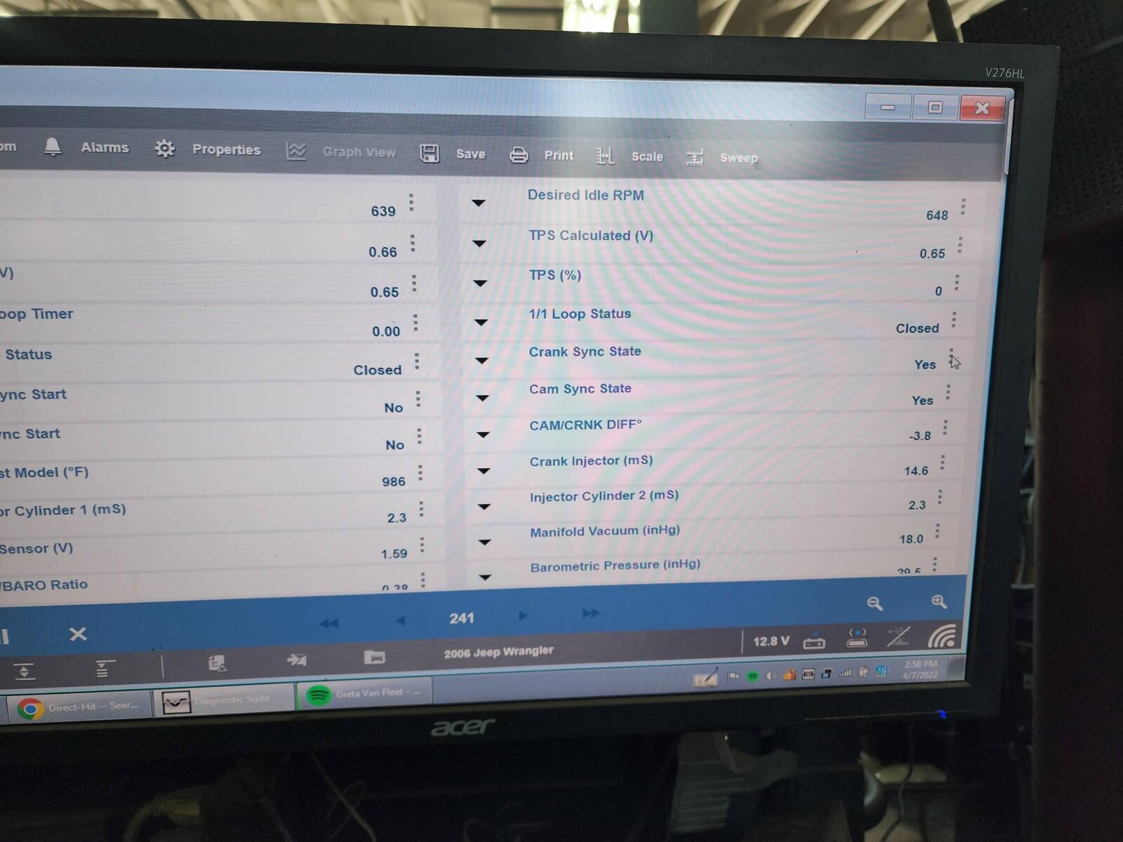

Thanks. It sounds as though the scanner is simply clearing the memory to start fresh. If it would actually indicate the degrees between the crankshaft and camshaft sensors that would be impressive but I’m not sure I see enough use for me to spend $500.
There are a lot of MK808 videos but none related to how it interacts with our Jeeps.

any more feedback on this?? Has it resolved the sync issue?
I’m looking at renting a scanner for this.
Is the sync process and relearn process different. If so, what does the sync process involve? I understand relearn is just hitting a button that erases the relationship from memory. What is the sync process??
Sorry the dumb question but i WILL get this p0344 issue fixed
Yup! Completely resolved it.
That said something else has happened since, but 99% chance it is unrelated. Might have jumped a timing tooth or blown a cat, possibly even the PCM. (I don't have any reason to suspect it could be a result of the scanner.)
