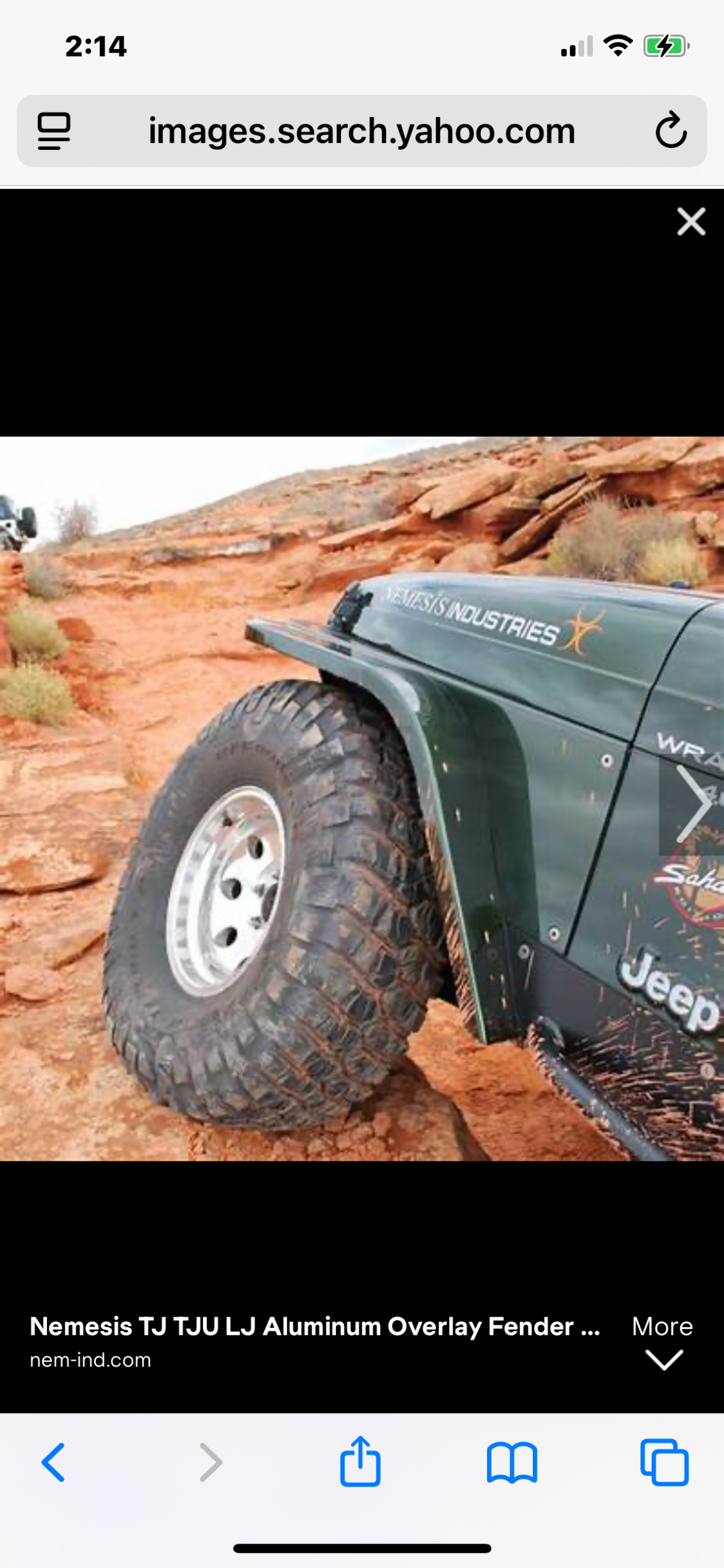

Is Nemesis still in business?i e never heard of the (aluminum overlay)looks pretty cool.

Working for me, weird. Either way, the TJ stuff on their website is horribly out of date and descriptions non-existent. I’d suggest emailing them to get the current drawings of their products you’re interested in. They’ve had some design updates on their highlines and flares that aren’t on the website. Notably on the break in the fender near where it mounts to the firewall and also the mounting to the grill.
One nice thing about them though, they’ll make a custom length corner or flare for you at a pretty reasonable price. I had my flares made in a different length than their offerings and it was only $100 extra for the customization.
