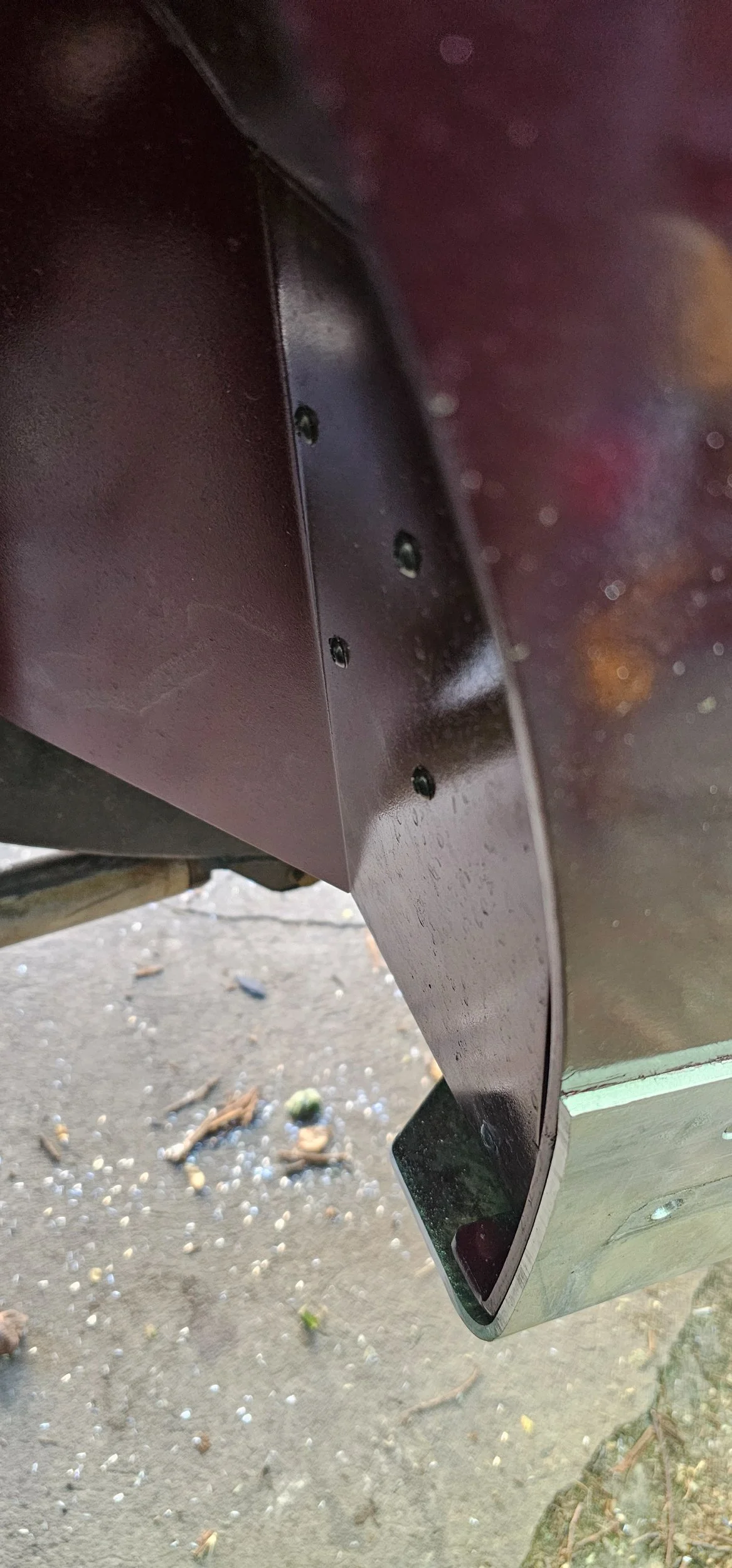

Hi everyone, I've got a set of PS 3" fenders installed on my '04 TJ and am considering Genright rockers & corners since Savvy is pretty much not an option any more. I know the mini boat sides require bending back the bottom inch of the tub but I'm curious if any one here is running this or a similar combo and, if so, how did you deal with the front fenders? I'm guessing I'll have to cut the bottom of the fender & flare along the same line and then maybe weld a small plate at the bottom of the fenders for rigidity...any one have any pics of how this was dealt with? Am I better off with the standard Genright rockers - or perhaps another brand?

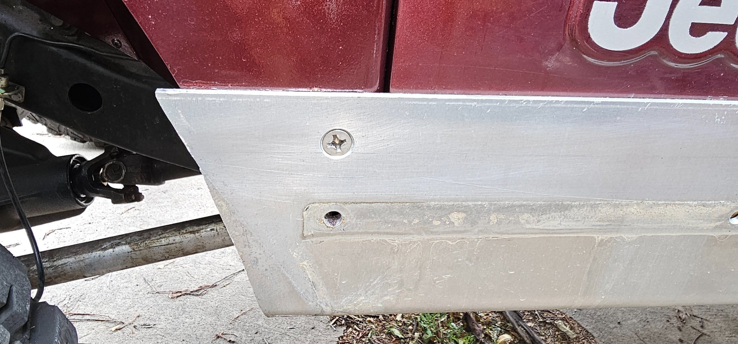

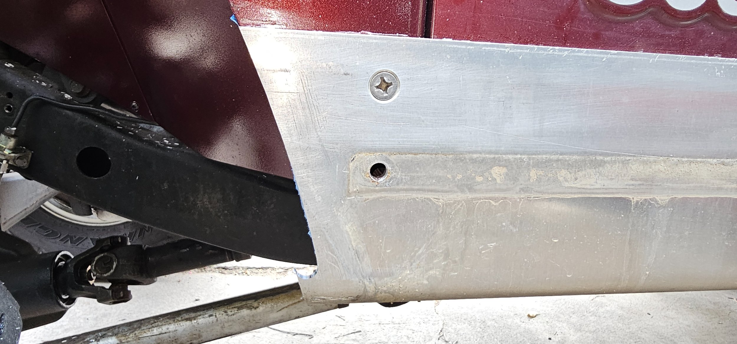

Well I have the old Savvy sliders and PS high lines. The aluminum slider backer I had to trim to fit the fender, no clue on the new version

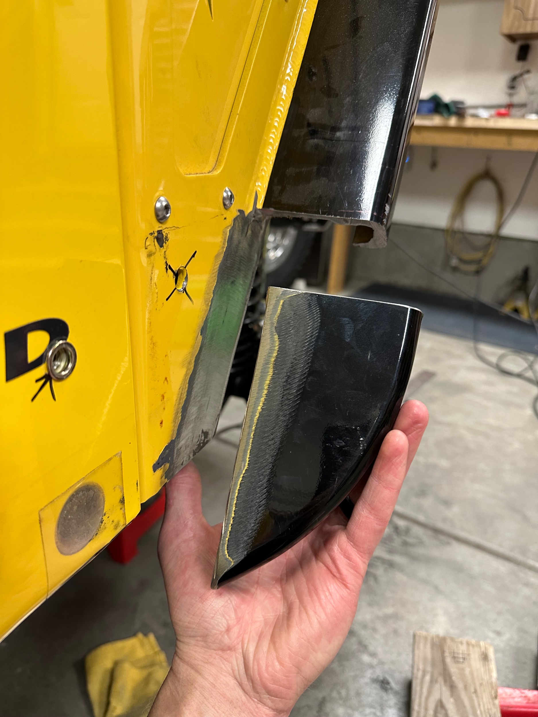

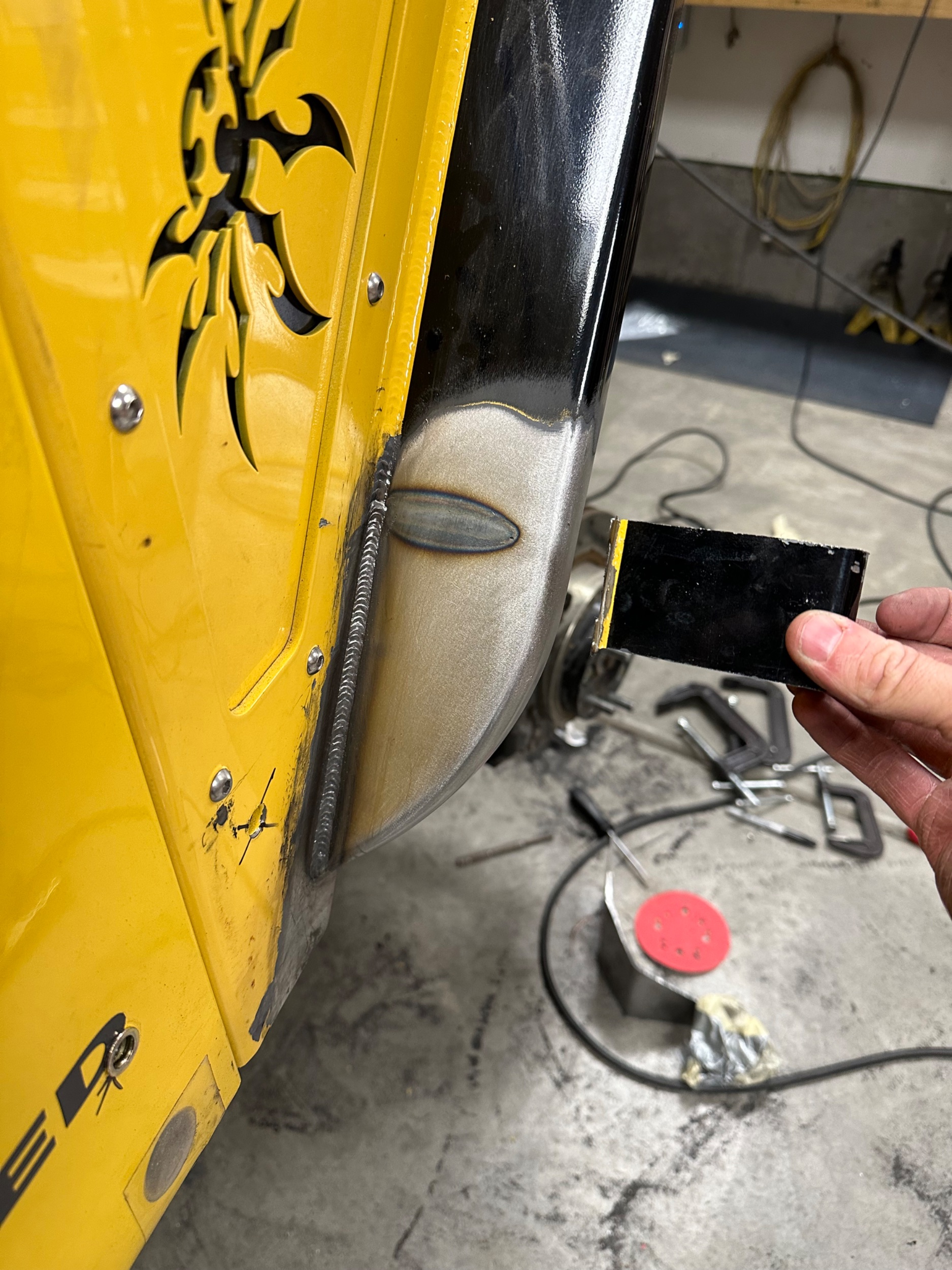

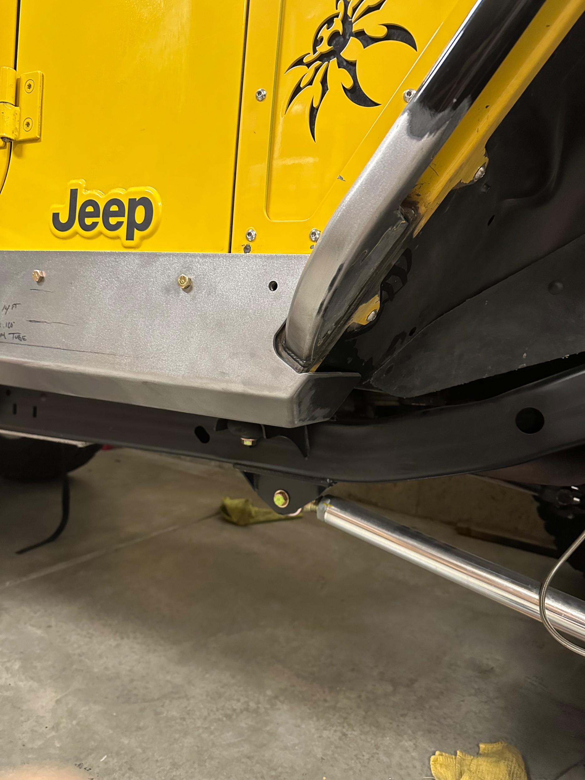

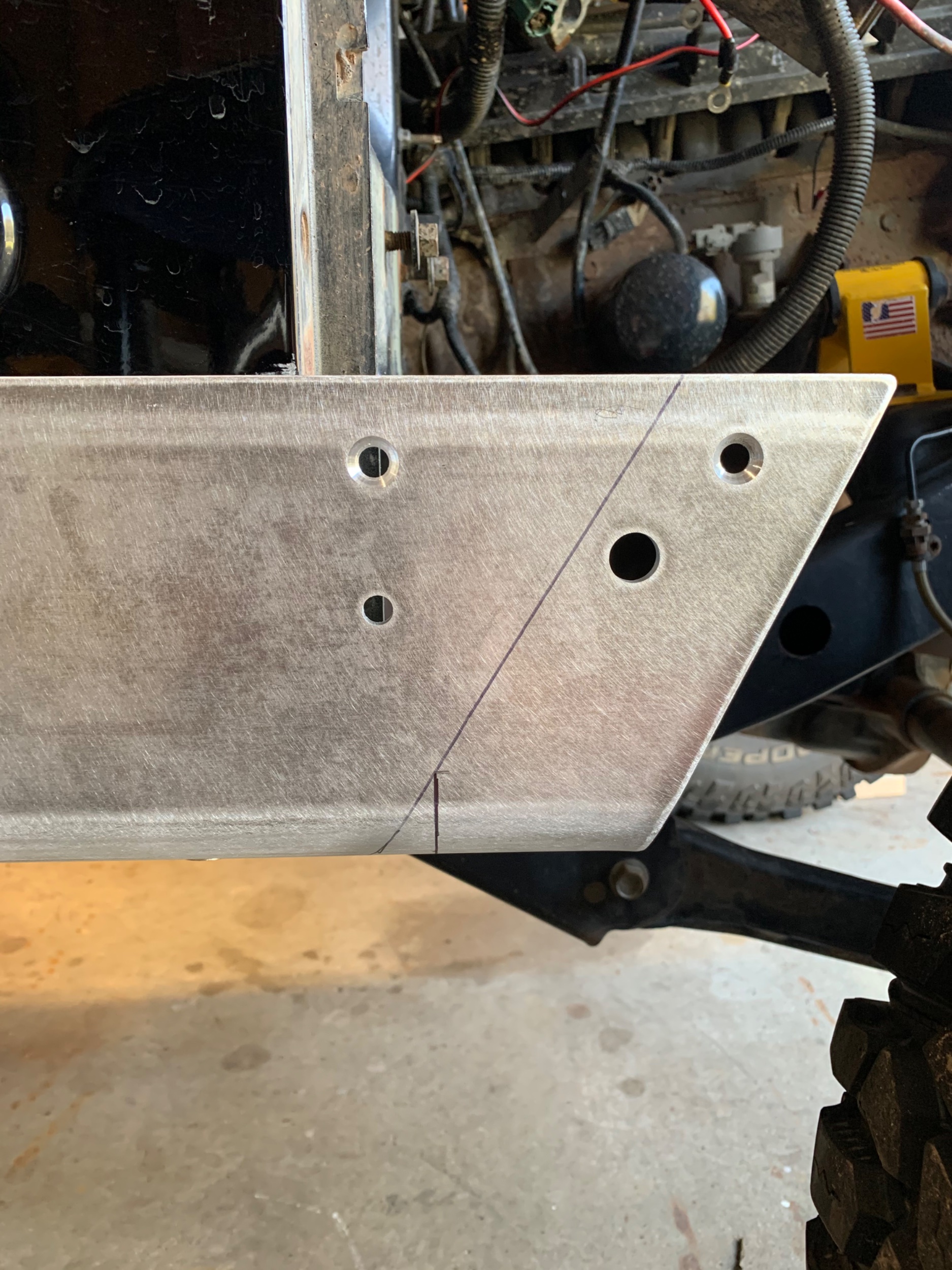

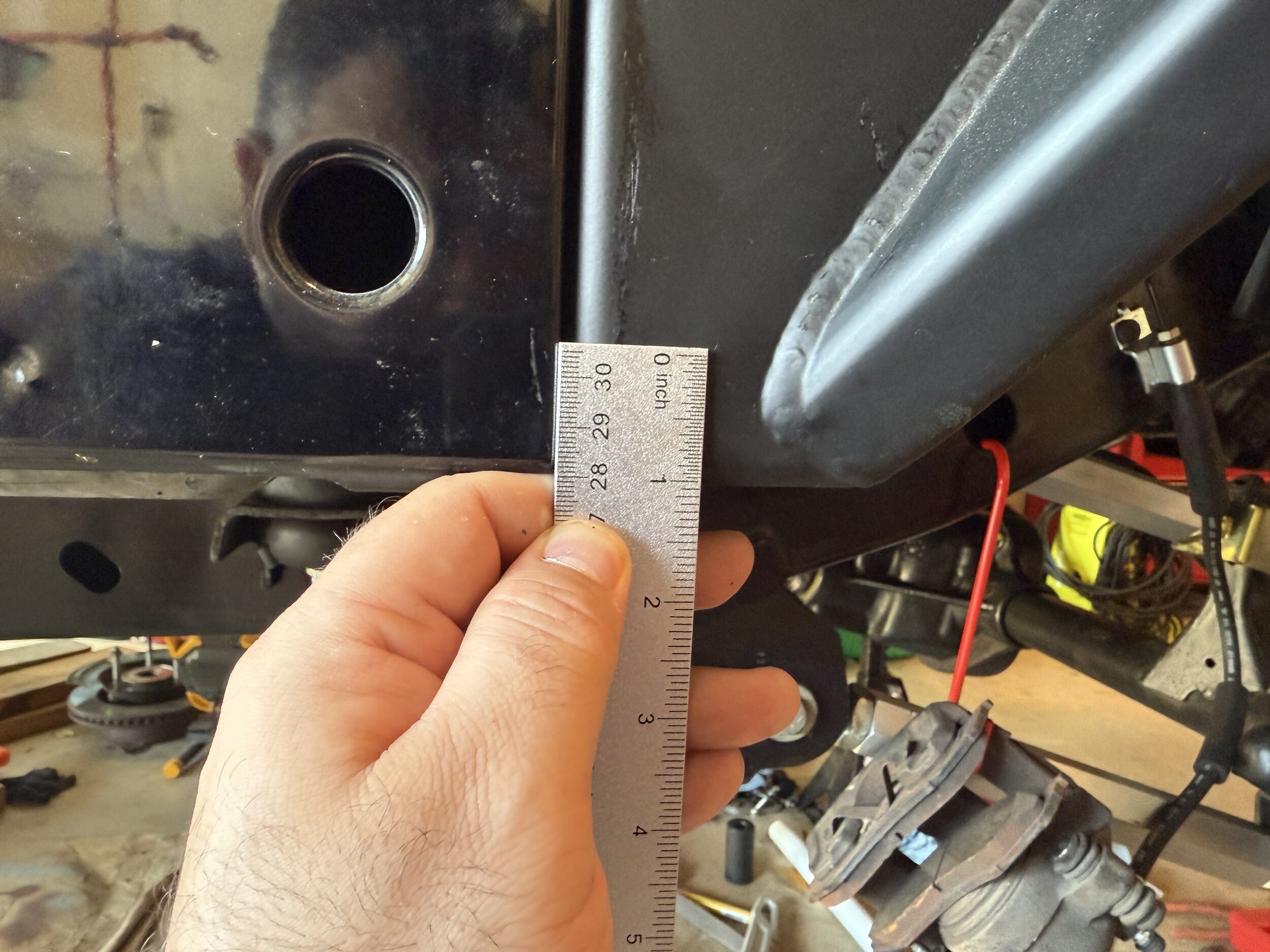

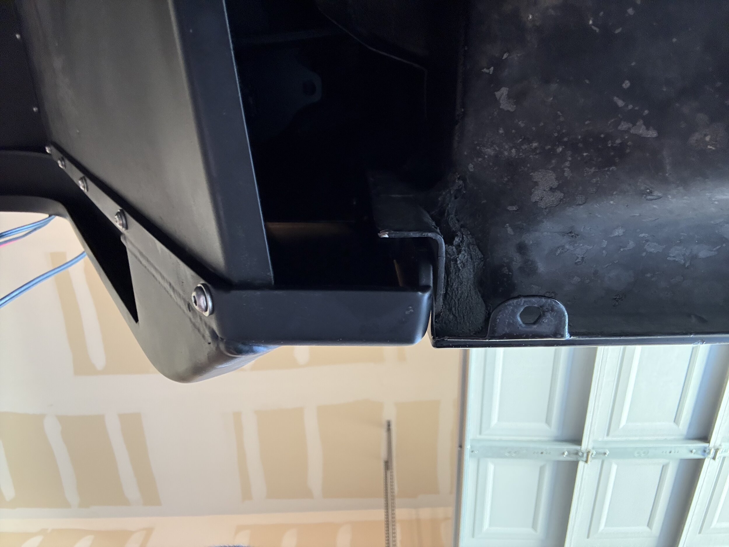

View attachment 608039View attachment 608040View attachment 608041View attachment 608042
All you can do is trim and modify the sliders and fenders to make it all fit together.
