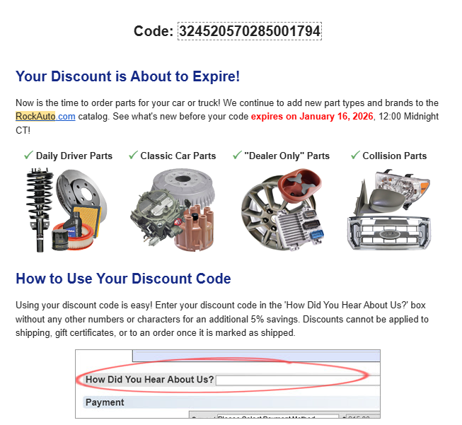

Doing a search for Rockauto 5% will get you a valid code for a discount easily enough reducing the price a bit more too.
