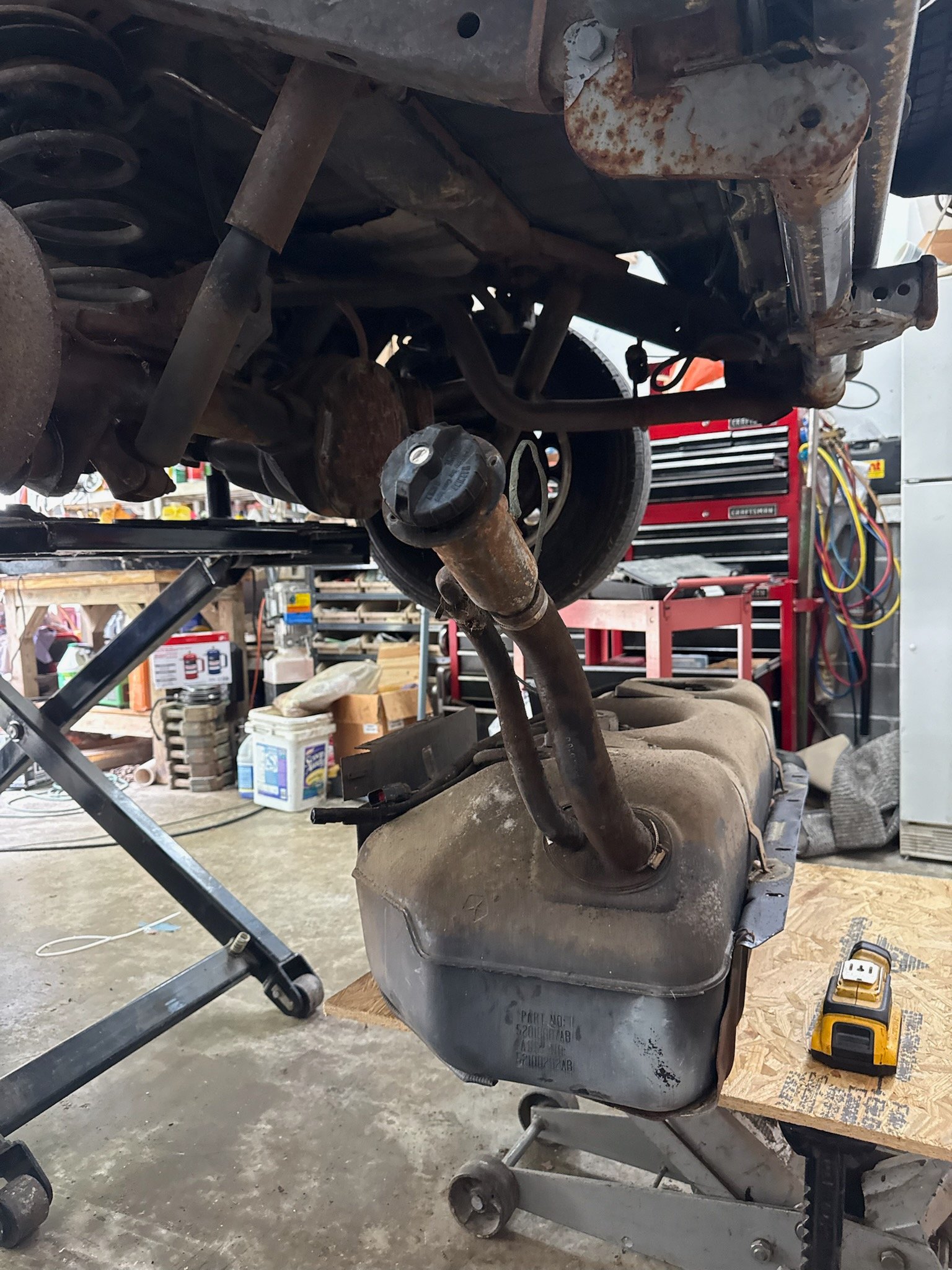

97 Wrangler 2.5 starting issues

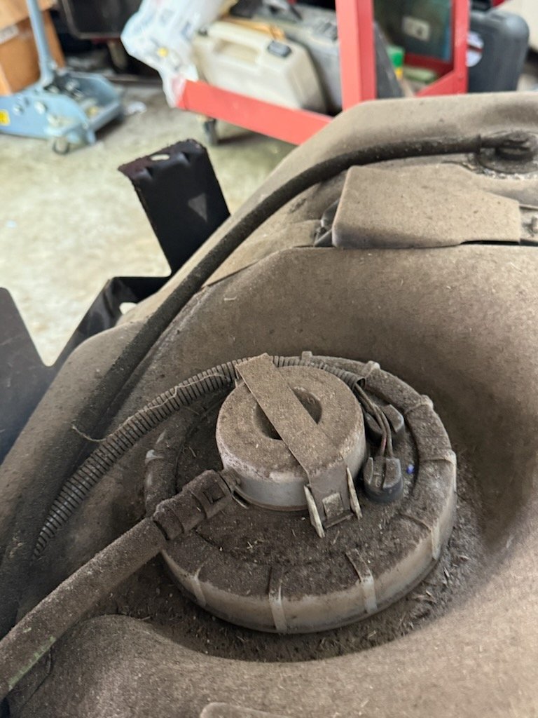

Not sure who put what on this jeep..... I just took the old one out... in this case the fuel pump assembly and to be honest I dont understand saving something that does not work no matter if its OEM or not.

Wanted to finish this thread off. The vehicle started right up after the install of the pump. Bad exhaust manifold to head leak. Can see at least one bolt missing. Drove it and I felt like I was driving a clown car. Seems to need some suspension work, breaks, shocks et al. I returned car to neighbor. At least she can move it around while she decides what she wants to do with it.
Thanks for the help
