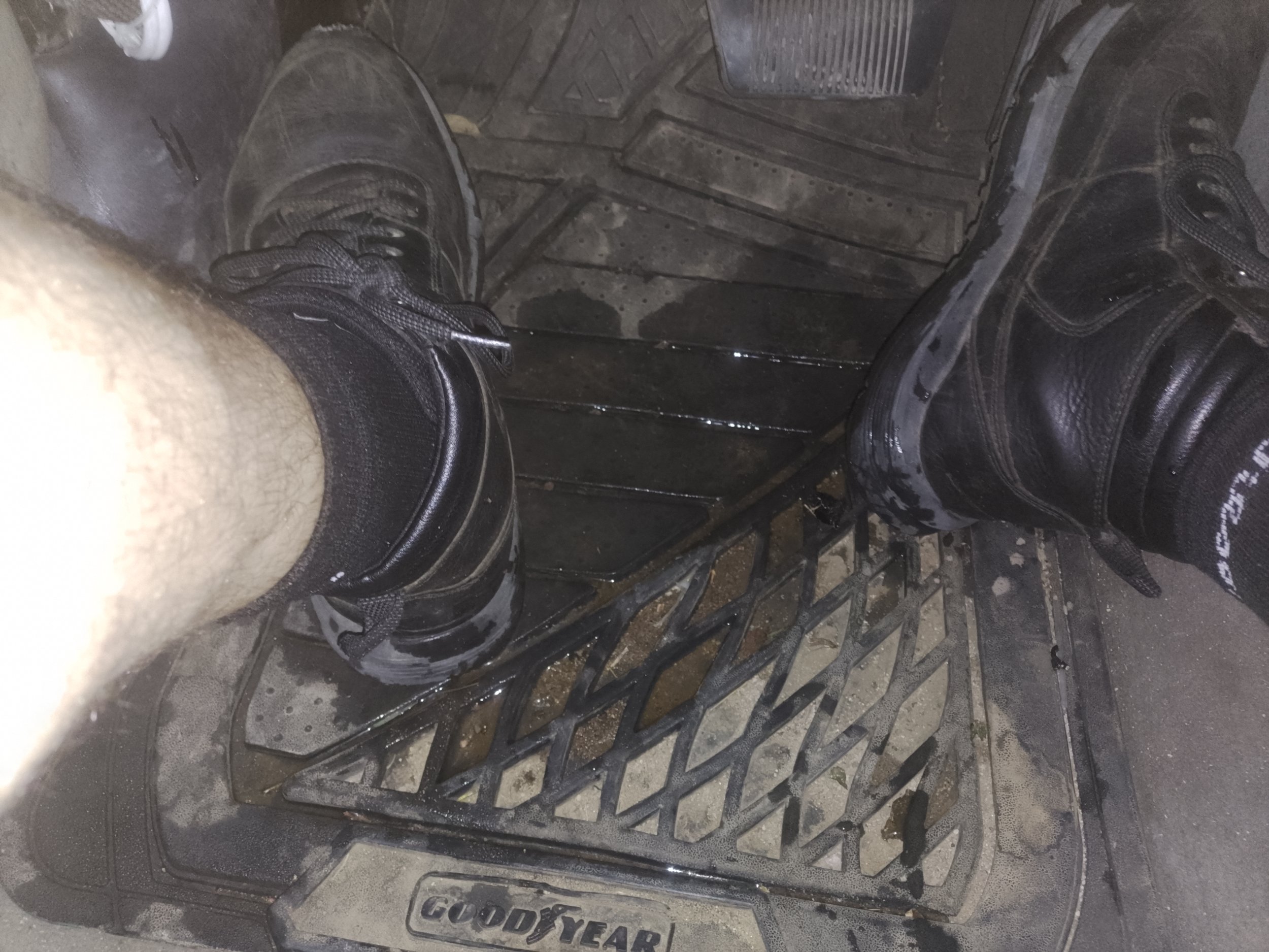

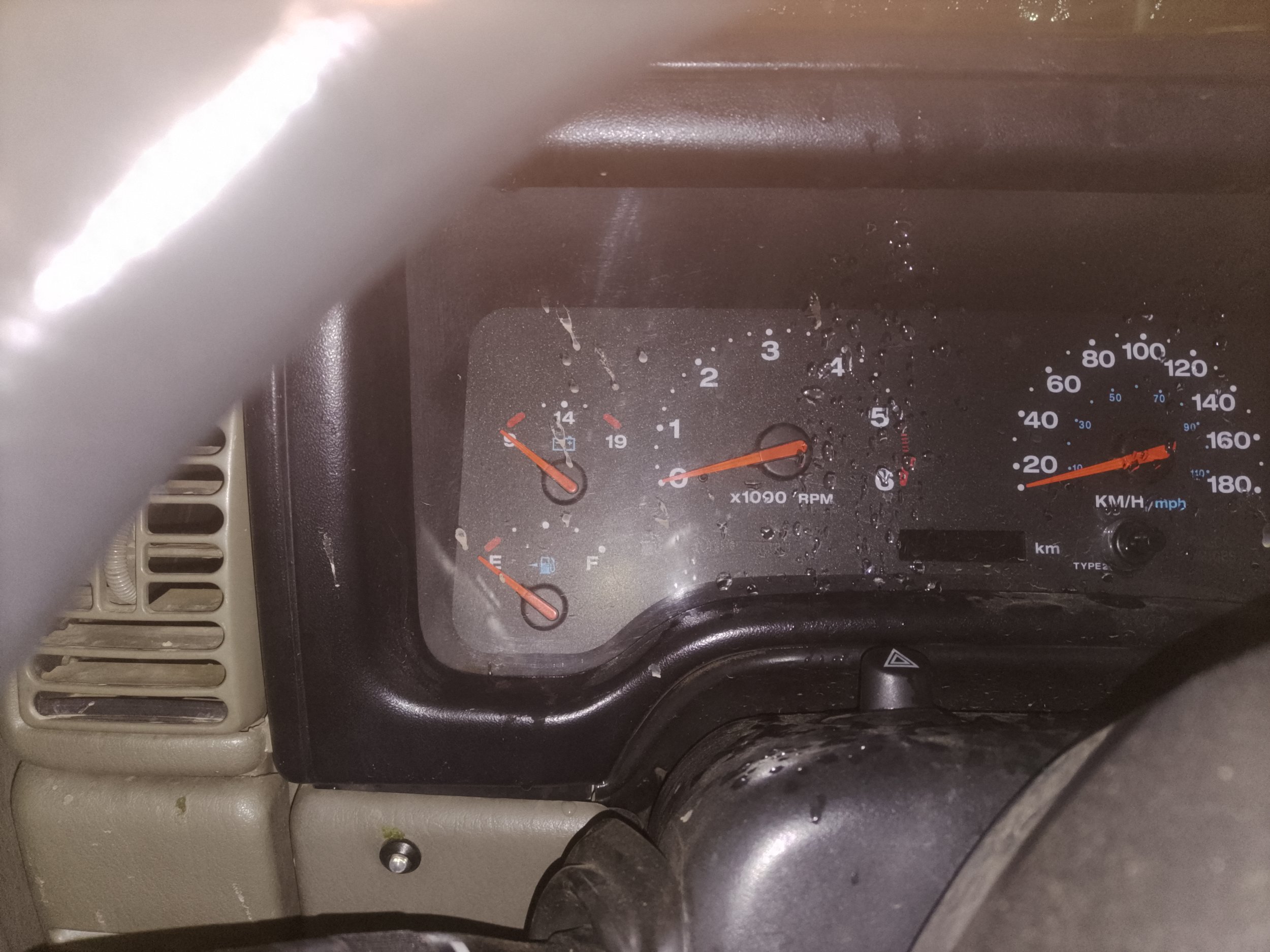

I was just caught in a heavy downpour in town. I felt a drop on my knee and then saw that there was water dripping down where the windshield frame meets the roof. I was in a parking lot, so was not going fast, but may have been facing into the wind. I went into the grocery store and when I came back out there was water on the odometer lens and on the floor mat. Seems to be just on the driver's side.
Odd thing is that I was caught in heavy rain in the mountains a few weeks ago and was pleased because I didn't find any moisture getting through.
Is this a common issue? Is there a solution?
The big photo below shows a single drop on the window frame when it first started. The odometer and the floor mat are when I got back in the jeep.
