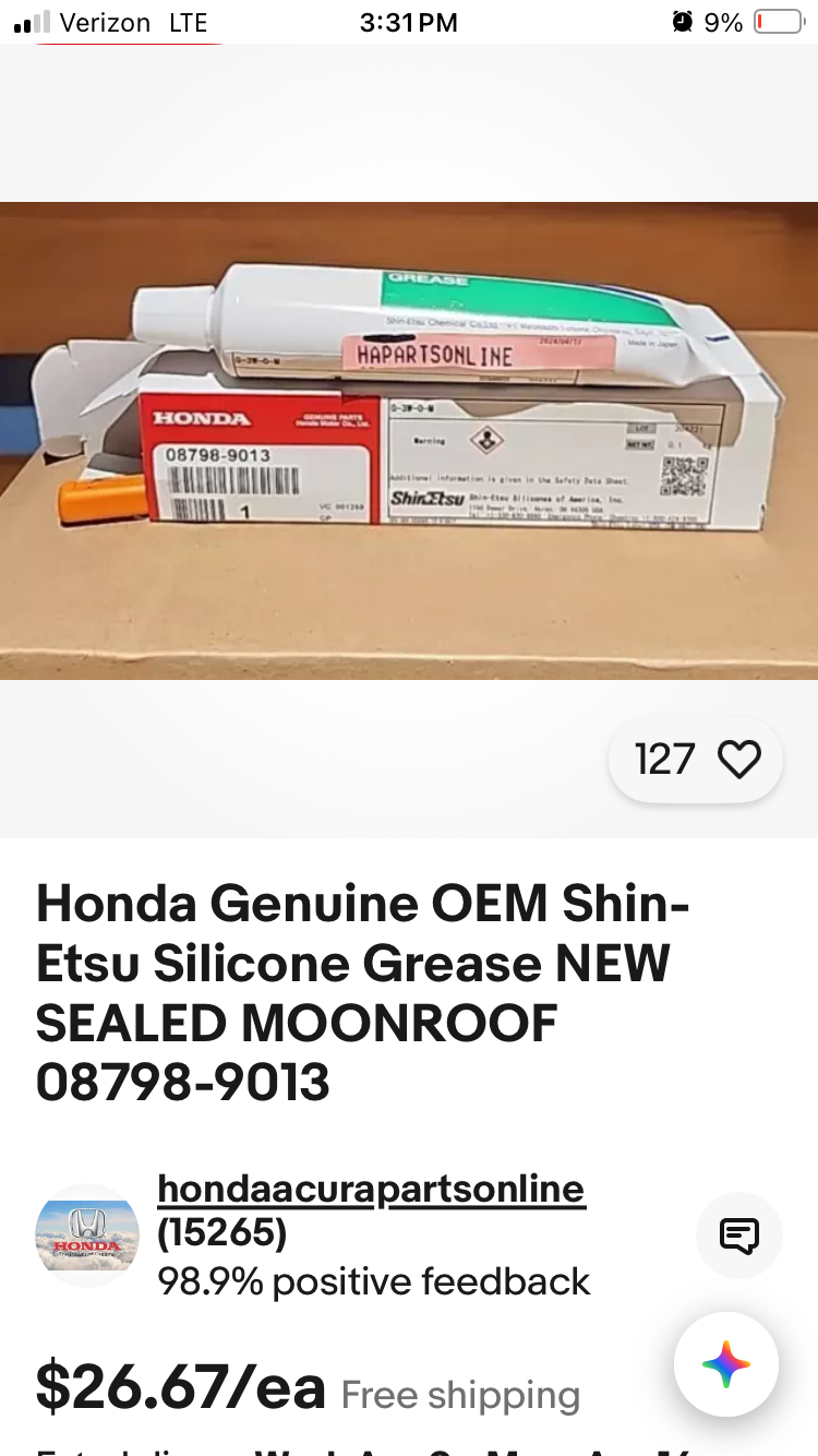

somewhere on the forum i read about some silicone type grease that is made by/for honda that i’ve used on my door seals to help break them in. see pic.
