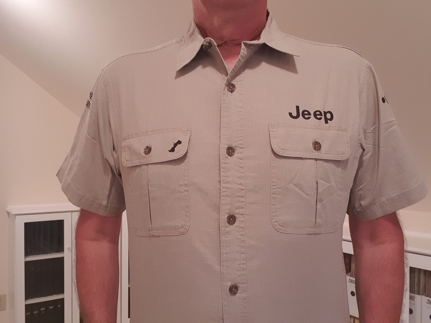

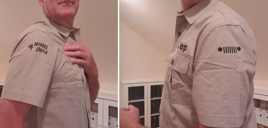

Recently I was asked by an apparel manufacturer to do some designs for Jeep apparel so I've been doing more graphics...
I made iron-on transfers of the graphics with my Cricut to create sample shirts for them. A few of the design ideas...
I don't know if these will end up on the market; the apparel company is in the process of applying for a license from FCA for permission to use the Jeep images and if that's granted maybe these will be available sometime soon.
Comments and suggestions welcome on the shirt designs above, these are just the first few quick ideas I prototyped, if there's something else you think would be good on a shirt let me know.

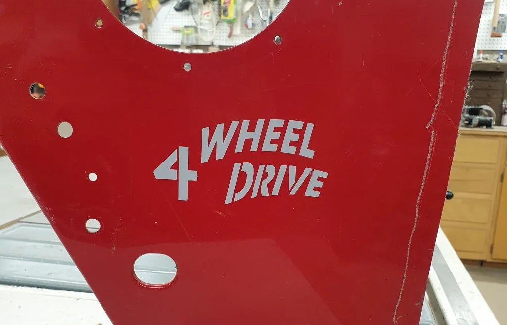

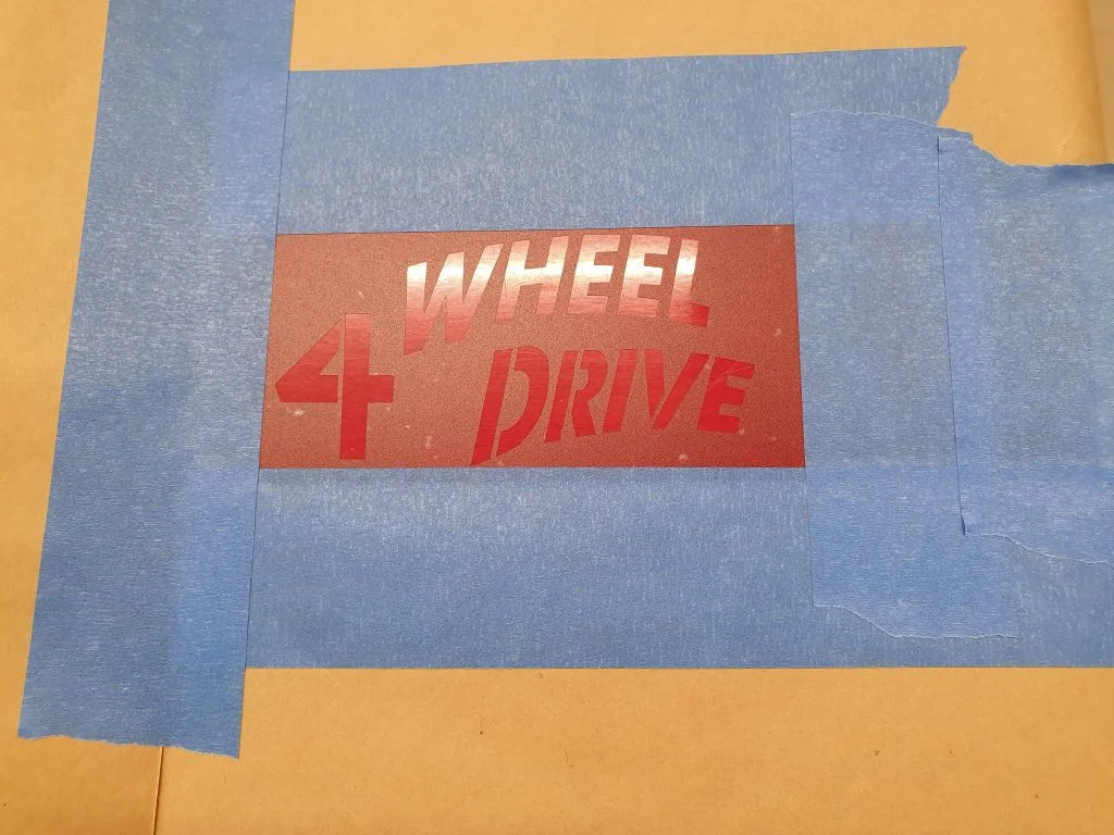

The other day I got a promotional email from Cricut offering 50% off supplies, like decal vinyl. While browsing their site, I discovered that they offer material for cutting stencils. Since the early Jeeps (40's/50's and maybe some 60's) had graphics painted on through stencils, I decided to get some stencil material to try.
Many of the early Jeeps had this stenciled on the tailgate:

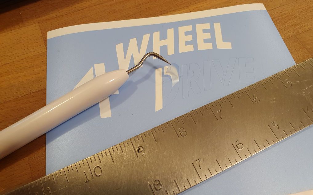

I'll cover the steps in case anyone is interested. First, I cut the stencil on my little Cricut Joy machine:

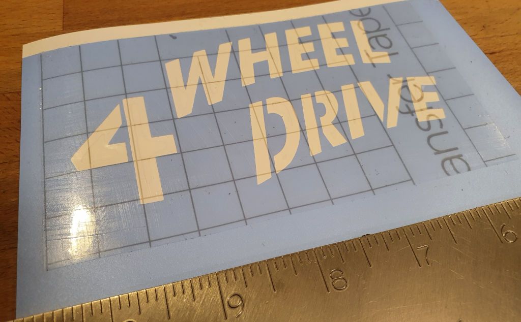

Then the cut stencil is "weeded" (that's the term Cricut uses). The part to be painted gets removed. When making a decal, usually the background is weeded away but since this is a stencil that is to be painted through, the image is weeded out.

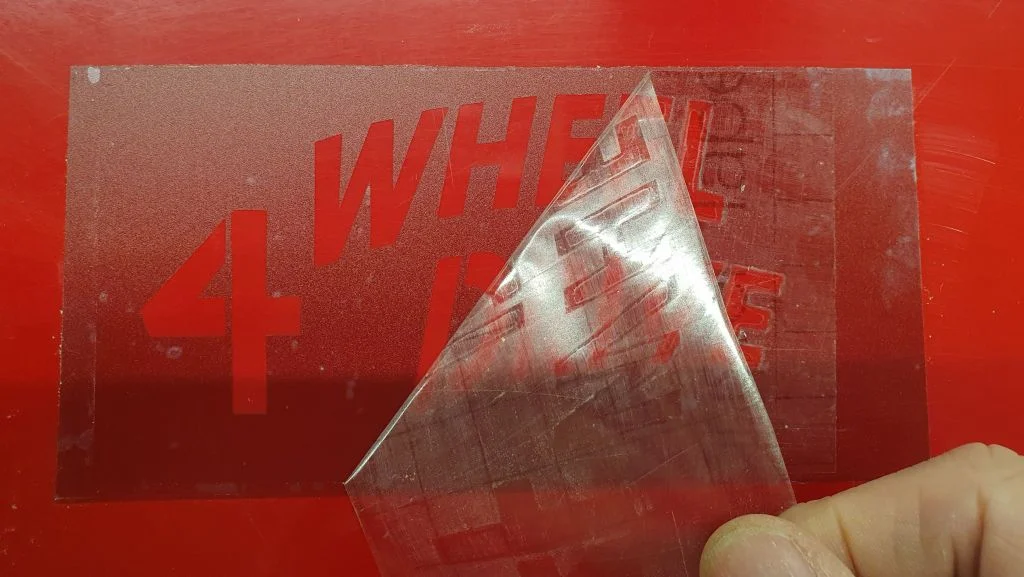

To transfer the fragile stencil to the surface to be stenciled, clear transfer tape is applied over the stencil:

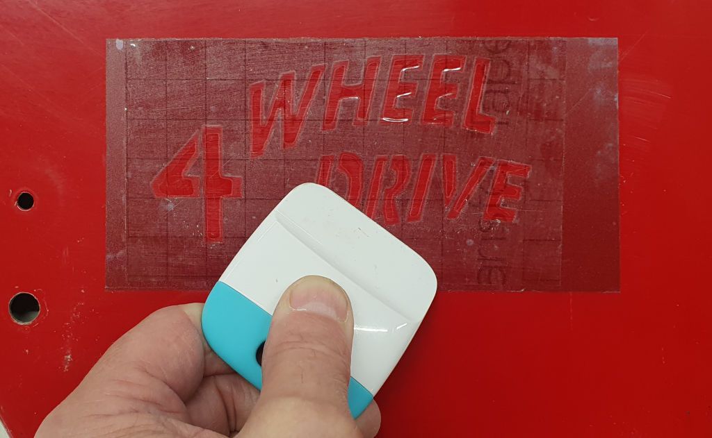

The backing is then peeled off the stencil and the stencil is applied to the surface which in this case is a piece of the tub left over from when I made my pickup.
Applying to the surface:
Peeling off the transfer tape:

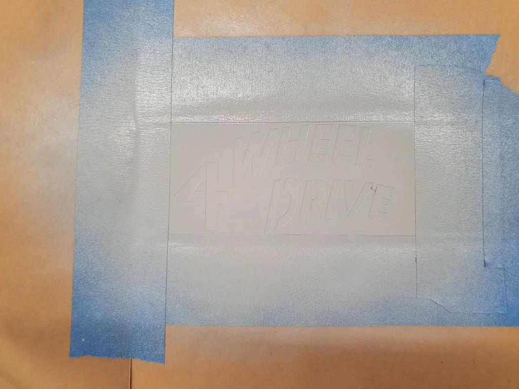

I covered the area around the stencil with masking tape to protect the surface from overspray:
Rattle can painted:
Done.
Looks at least as good as the original stenciled/painted on graphics on early Jeeps.
I'll continue to do most graphics in vinyl, but it's nice to have stencils in my array of possibilities.

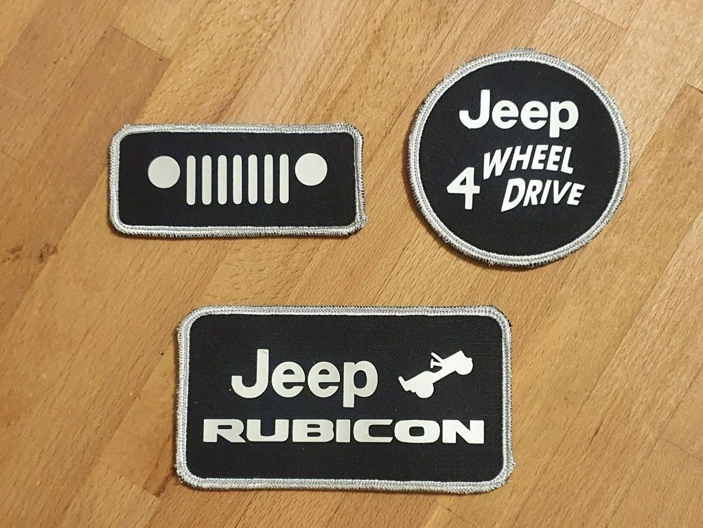

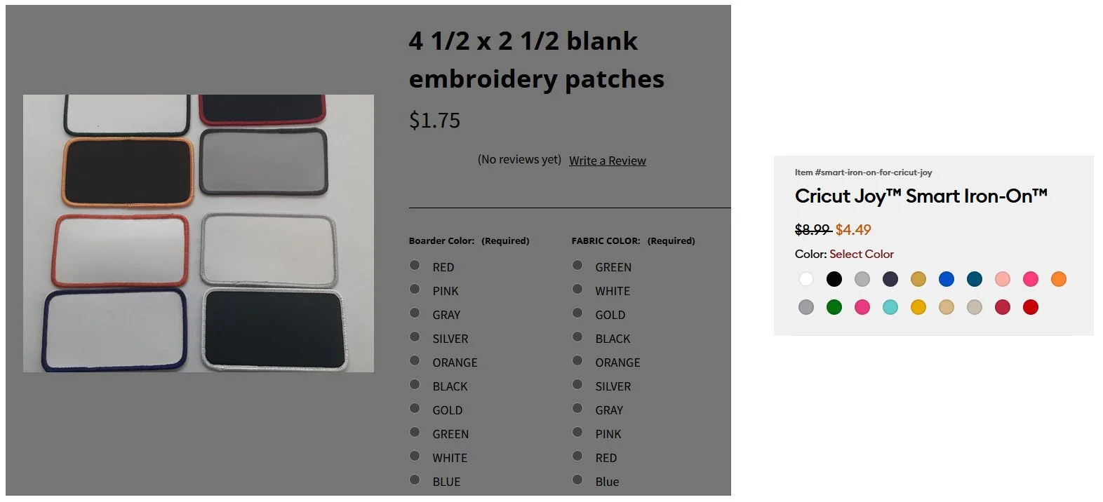

Another Cricut project - making patches.
I wanted to try making patches using the Cricut so I ordered some blank patches and did some quick tests with Circut Iron-on material. I just used images I already had, so the Rubicon one is a little incomplete - it should have a hill under the Jeep for it to climb.

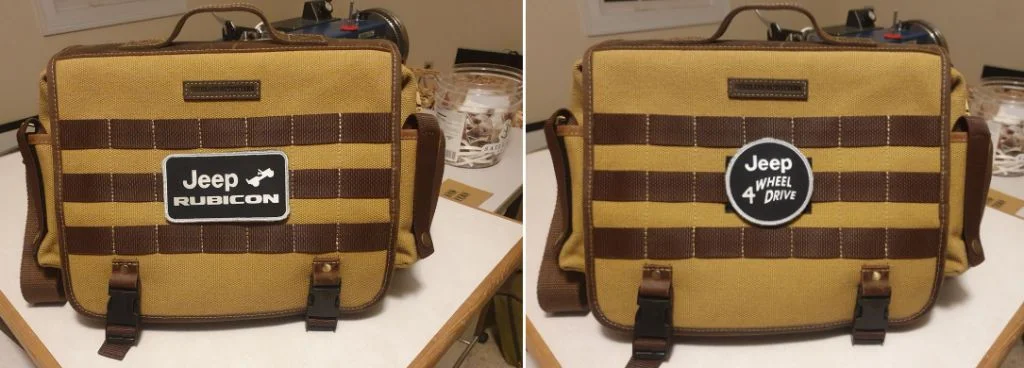

I added velcro to the back so I could stick them on a prototype Overland Outfitters Tactical Tool Bag, which has velcro loop behind the MOLLE grid.
These worked out very nicely. A range of different colors of blank patches are available out there, and Cricut Iron-on comes in a wide range of colors, so many different patch designs are possible, including using multiple colors of iron-on on the same patch. These are screen shots from one of the patch places I found on the internet and the colors of iron-on from the Cricut site.

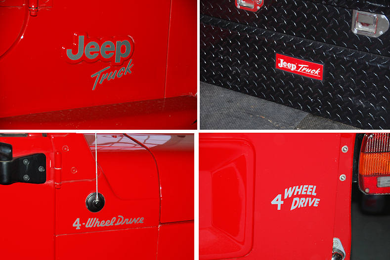

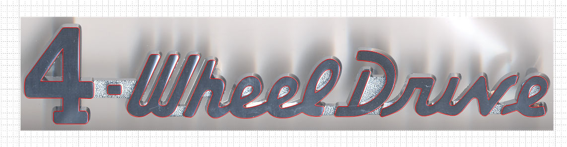

When I was doing the graphics for my Wrangler pickup, I wanted to have "4-Wheel Drive" decal to match the metal emblem that was used on the classic Willys pickup so I scanned a metal Willys emblem with my scanner, imported it into my drawing program and traced it. This image shows the scan of the emblem and my tracing in red:
Sometimes I'll take a photo, being careful to be perfectly 90 degrees and on center so the image isn't distorted, and I'll trace that. Some of the decals on my pickup were done that way, here are the graphics I did for the pickup.

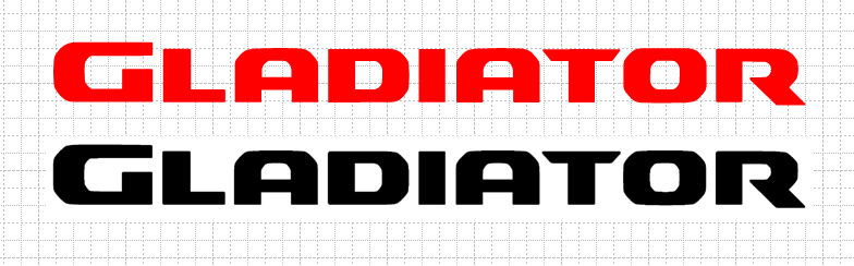

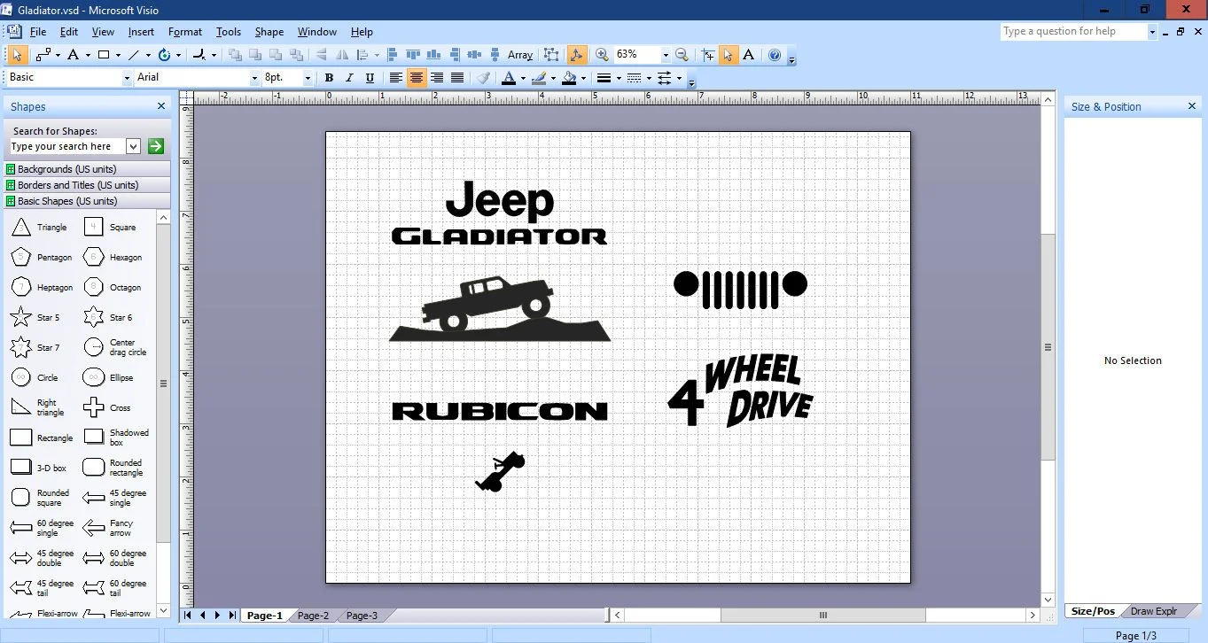

And sometimes I'll find an image file online and I'll trace that. Recently I did a Gladiator logo; in this shot of my drawing program the black one is the image I found online and the red one is my tracing. I separated them for this screen shot so you can see both.

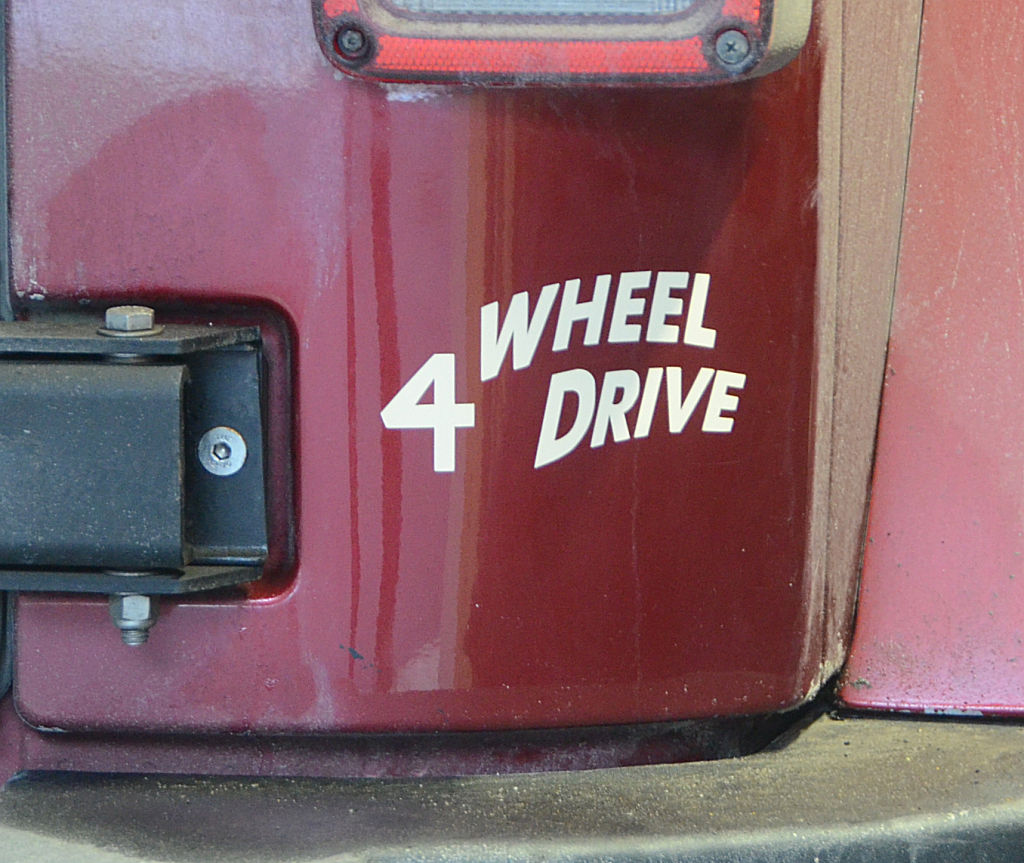

If I'm doing something to replicate a factory emblem or decal but might need to change the size, I print a test on my printer and hold it up to the place on the Jeep where it will go to see how the size is. I might do this a few times until I'm happy with the size and then I'll make the decal. I did that with the decal on the rear corner of my JKU, it's a replica of a Jeep factory graphic but I adjusted the size so it looks right:

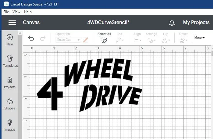

To cut a decal on my Cricut, I'll save it as an SVG file from my drawing program and import it into the Cricut software.
