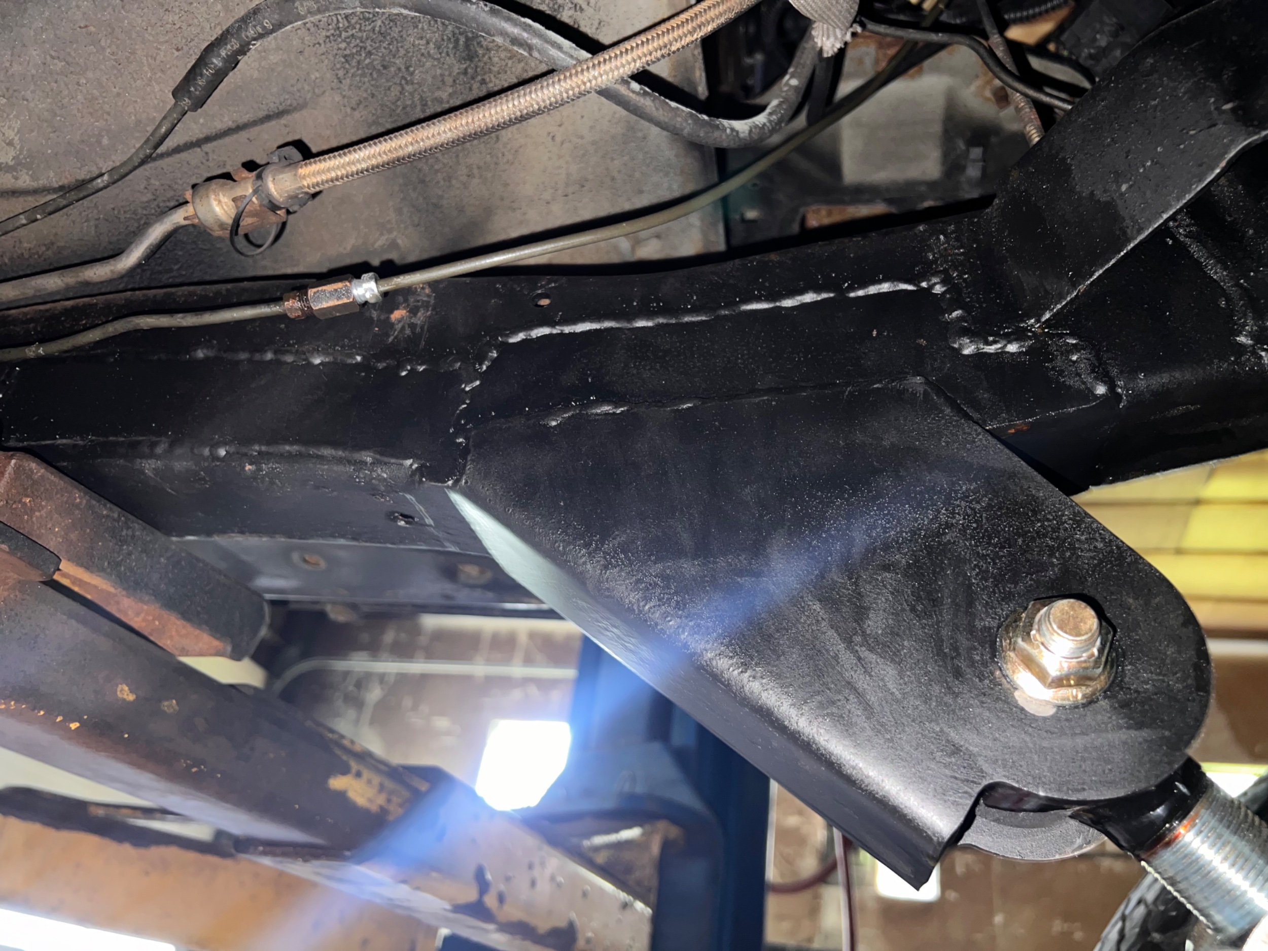

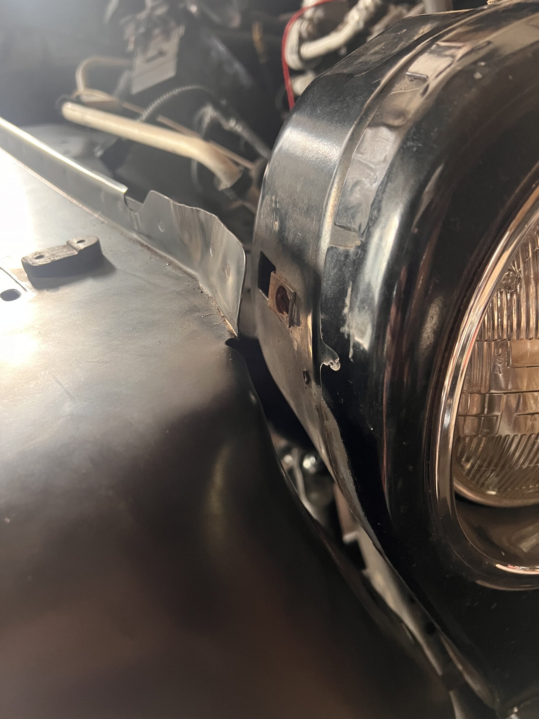

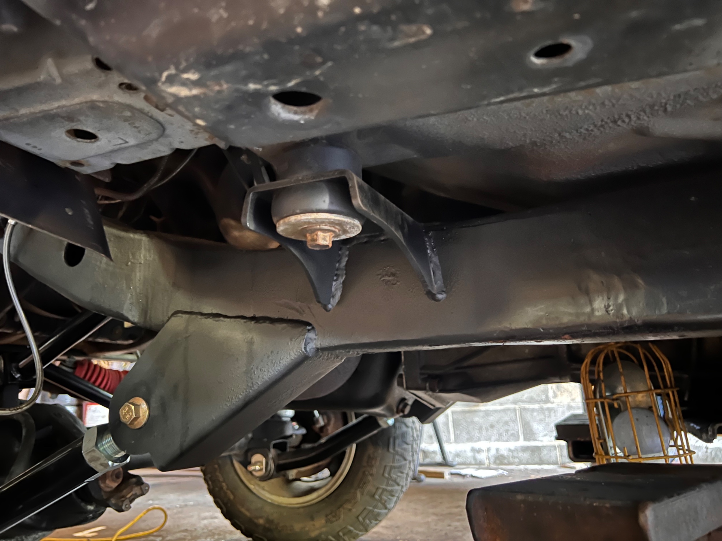

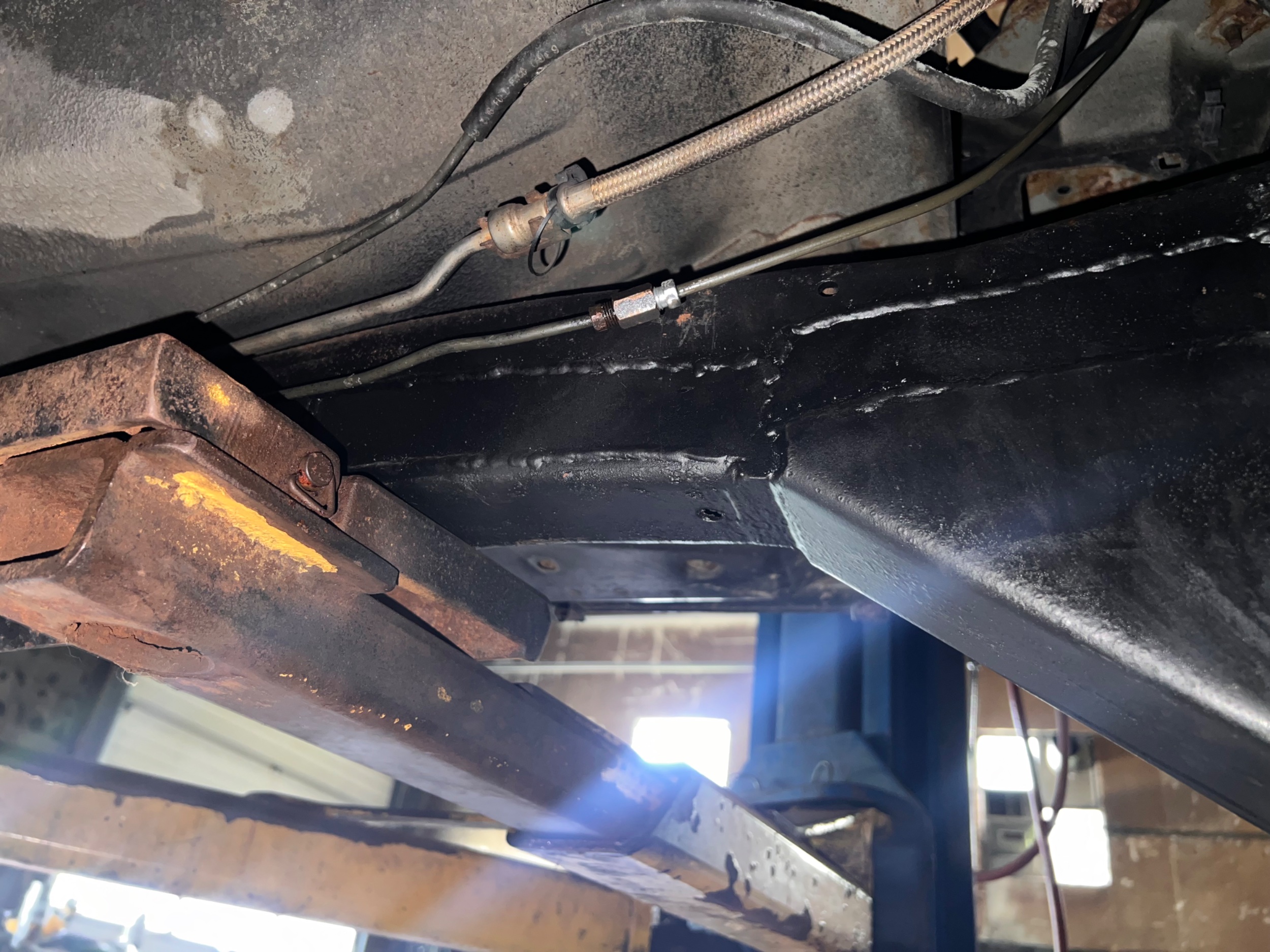

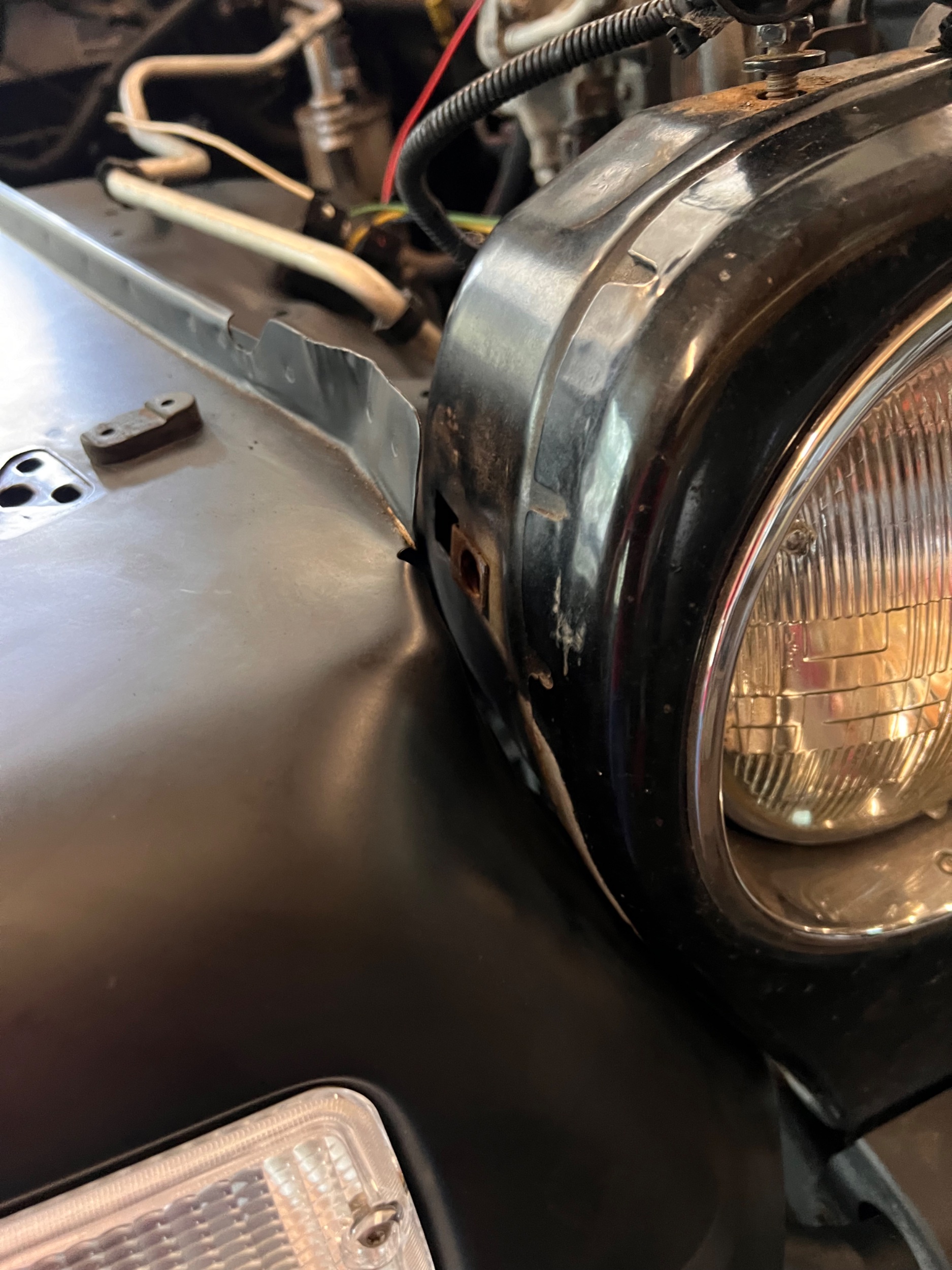

Hey all. I’m in the process of repairing my Jeep tj and lifting it up 3-4”. I had to start by repairing the lower control arm mounts frame side, and patching some thin spots as well. I removed the front axle and suspension to get easy access to everything and made the welds and repairs. However when going to reinstall the fenders I found that the front of the jeep appears to have dropped. Today I tried cutting some relief cuts into the frame to see if I could bend the frame up a little bit, but had a heck of a time getting deep enough with everything pretty much put back on. I could also probably shim the front grill but I’m not sure the best way to do that while also making everything look right. Any help would be greatly appreciated, and I can provide more info if needed. Pictures have been attached with different views of what has been done and what I am dealing with. This is so frustrating that I’m on the edge of dropping the project.
Did your repairs involve cutting away sections of the frame, and then welding in patch panels?
Yes. I only cut away one side at a time to try and keep the geometry of the square tube. Probably should of had support in the front to keep the distortion down but this is my first time doing a project of this caliber so live and learn I suppose😅

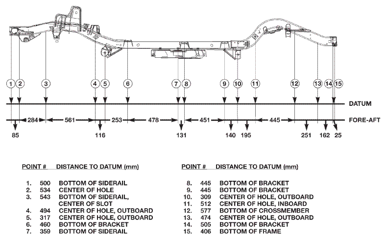

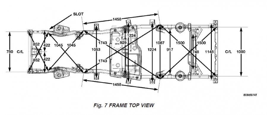

First thing I would do is to assess how bad it is. If you have access to the service manuals here on the site, I believe that there is a measured drawing of the frame somewhere, including elevations from a reference point (generally the floor) for points along the frame. That would help you identify where the warping occurred. I don't know exactly where I've seen that diagram, but others here have posted it, and hopefully someone can point you to it.

@johnny Jeep posted this a few topics down...
-Mac
Just an FYI, this dimensional information and more is available in the body and frame sections of the service manuals. For anyone new, you can grab PDF copies of these in the resources section here...
An update after messing with the frame today. Chained the frame to the lift and jacked up the front of the frame with a 4 ton hydraulic jack as much as I felt comfortable. The holes started to align and after seeing the relief cuts open at the bottom I felt good welding it back up. Leaving it rigged up I tried to keep it as cool as possible while welding to prevent further distortion. I let it completely cool before letting off the jack, and while it did not completely get me to where I wanted to be, I will feel a lot more comfortable shimming it up the little bit it still has to go. Tried getting sag measurements as best I could, but with a concrete floor and no jig, there's only so close I can realistically measure. Overall as frustrating as this project is I am hopeful that the end product will turn out decent.
