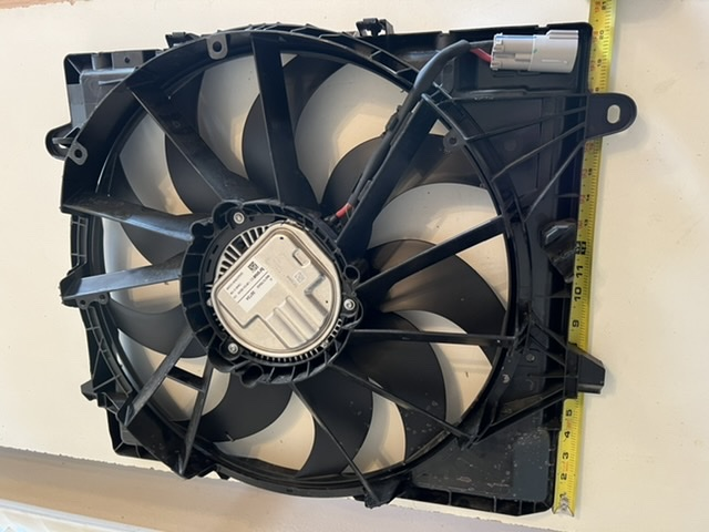

Grabbed this off that iPirate thread you'd linked... Looks about 22.5" X 20.5"
This is the MoPar 850 watt version. https://www.moparpartsgiant.com/parts/mopar-radiator-cooling~68272755ad.html

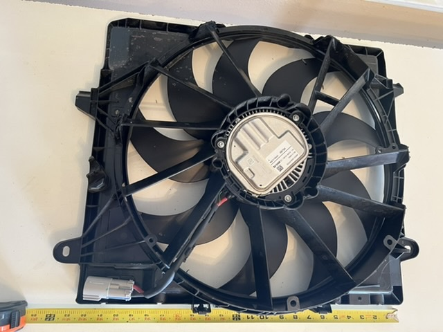

Again grabbed this off the thread...

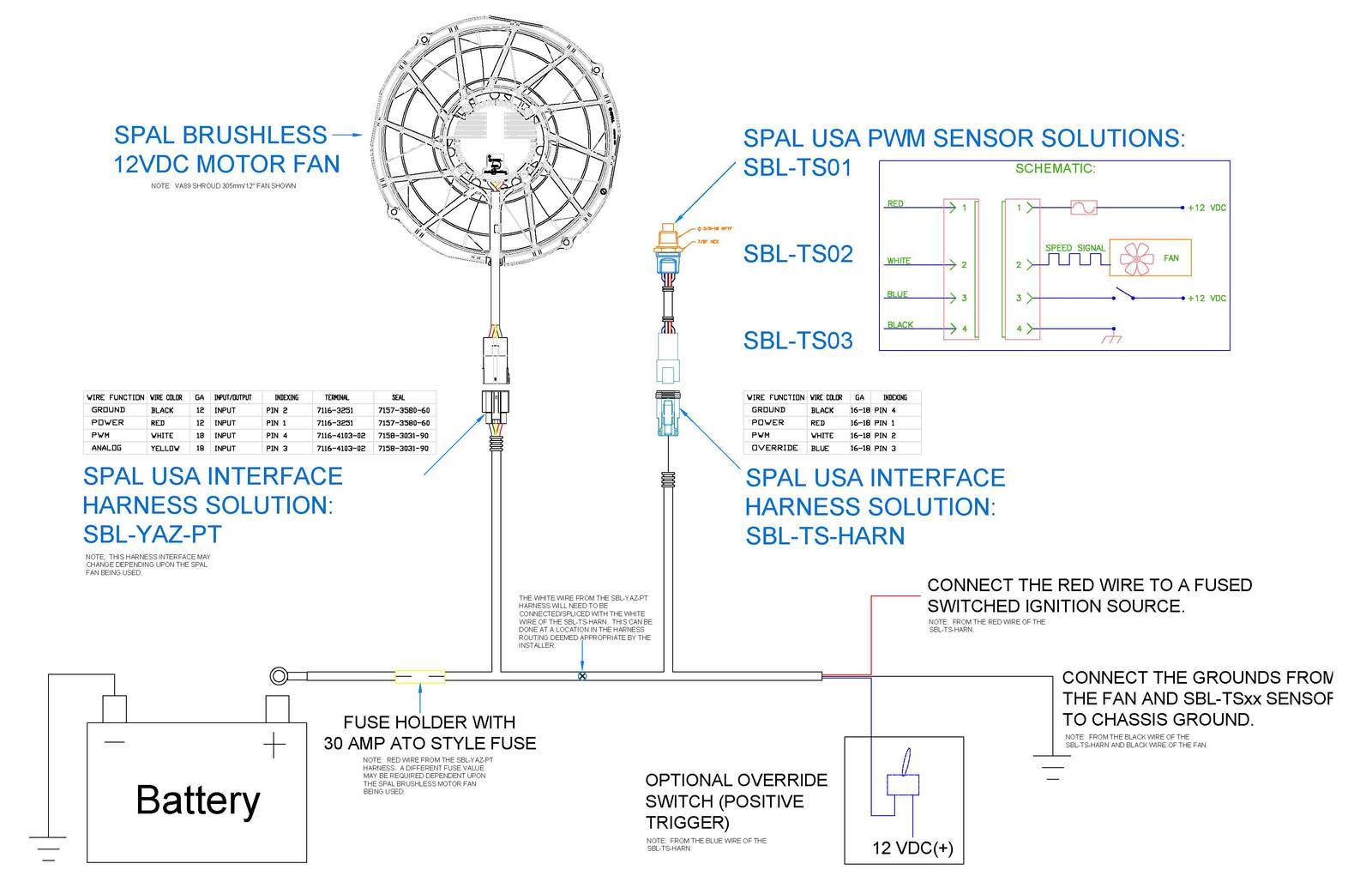

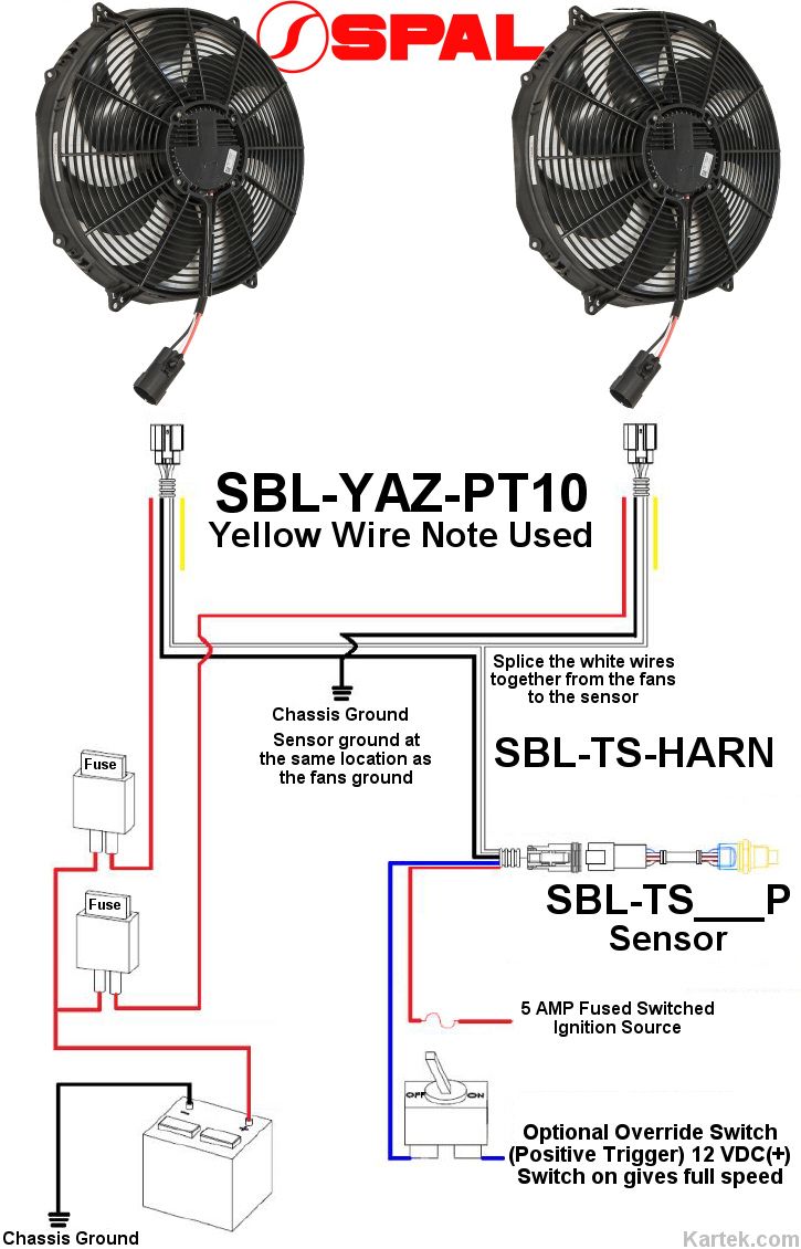

The Spal sensor (which you are not using) outputs a PWM or resistance signal to the fan, sorry I should know this but cant remember, the fan can read either one. (Doesn't matter in your case.)
You are going to send the PWM through the white wire, which is the (smart wire).
IF YOU ARE RUNNIG DIRECT WITHOUT PWM OR VARIABLE RESISTANCE AKA POTENTIOMETER.
The sensor white goes to ground.
The yellow switched goes to power.
You need both connected to run the brushless direct.
The reasoning is that you would run the white wire on a old style temp switch that contacts to ground. The yellow is switched on and off. Otherwise the fan would run when the power is turned off or there would be no temp switch to turn it off or on.
SPAL Temperature Sensor wiring
And SPAL fan wiring again....

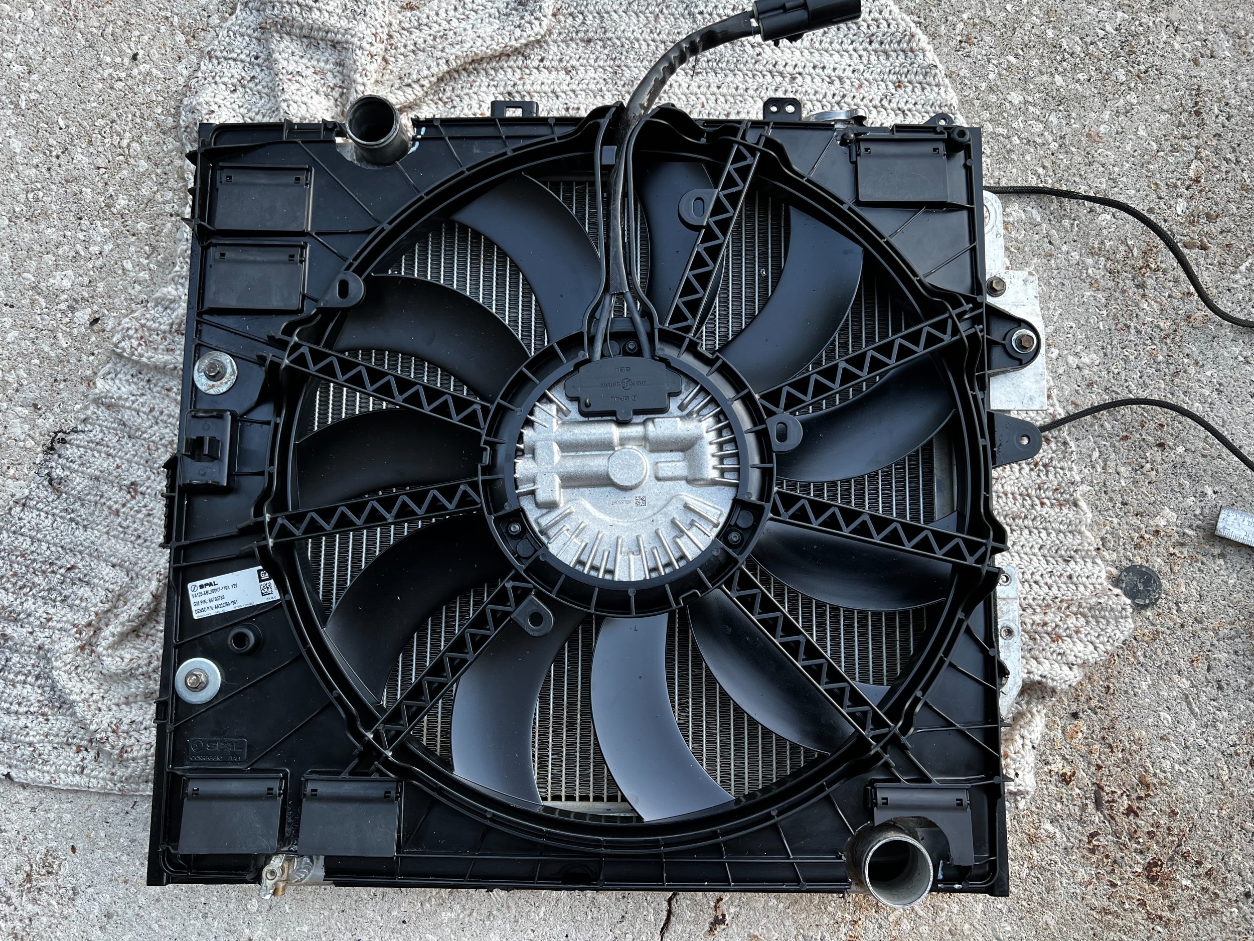

@Wildman are you planning on trying to adapt the Mopar 850w fan to your TJ radiator? I’m extremely interested in this or the Camaro fan. You might remember my overheating issues we discussed on the daubies hemi swap thread. I am still struggling with my hemi overheating. I had the explorer 11 blade fan and clutch on it and absolutely hated the noise from it. It also still overheated at idle or low speed and ran 220+ at 70mph. I currently have the Chrysler 11 blade fan (Dorman 620-082) and clutch which is significantly quieter but same temperature though. I can run topless with no air conditioning and run in the 205-210 range on the highway but when I stop and idle (like a drive through) or low speed off road it will overheat at 235-250+. If I run the AC then it will run 215-225 on the highway. I was able to run most of the winter and spring with little to no issues but in the summer heat (and I feel the humidity has a noticeable impact on the operating temperature of my engine) my cooling system can’t keep up. As an experiment I tried starting my Jeep at home and getting it up to 200 and then opening the hood. With the AC on full blast it idled for over 30 mins and only got to 226 degrees. So I reluctantly cut up my hood to install Genright louvers. Still over 235 in a drive through for less than 5 mins the next week. My next attempt is a Flowcooler water pump. I’ll update when I get it changed but the temps are cooling off a little some my results might not be relative until next summer if I don’t get it done within the next week or so

I did measure the thickness early in the thread of the fan removed from the shroud. It was 68mm. I think the shroud probably added about 10mm of depth (total guess) of on the front, and has negligible additional depth on the backside. The backside is straight up flush with the fan motor connection protrusion.
