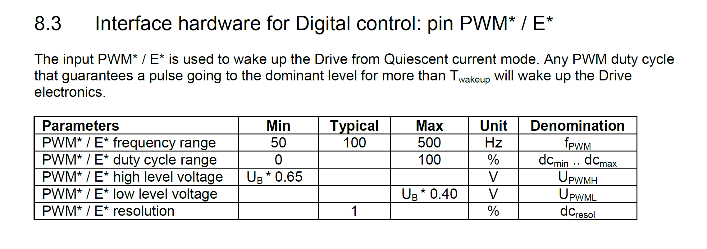

From a different SPAL guide I have on hand:
Edit: Note that this is a SPAL aftermarket fan, and I believe the PWM % logic is inverted in the OEM fans. Might have to test to be sure.
I'm really glad you posted all of this, and THANK YOU. But the first line in this table is particularly interesting because it suggests the 122Hz I could get with the Arduino Uno R3 (or any ATmega328P board)....and possibly even the default 490Hz, would have been perfectly fine....at least for an aftermarket SPAL fans. And I don't have any good reason to think the OE fan wouldn't have the same tolerance.

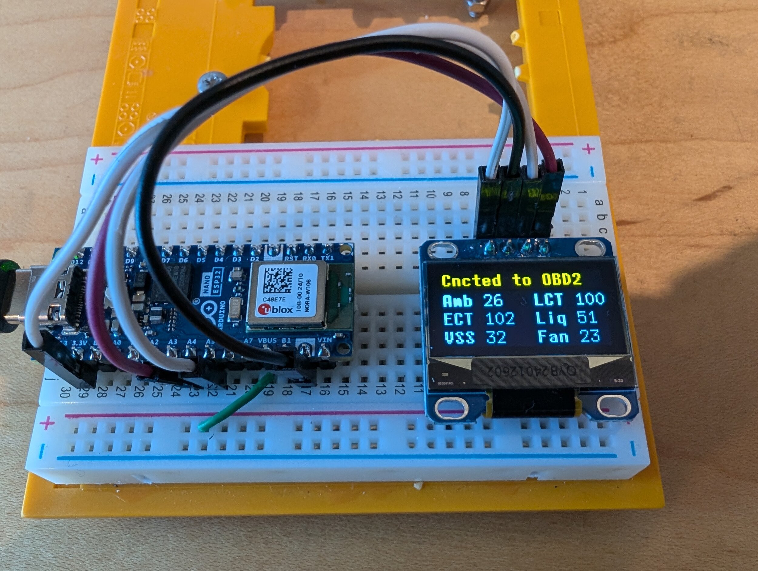

I got a teeny little OLED display and I'm gonna put the main control variables and fan speed output on it, as well as OBD2 comm status. So if things go wrong I'll at least have a decent idea why without having to plug in a laptop. I've got my eye on a little enclosure with a clear cover so I can see the display inside.

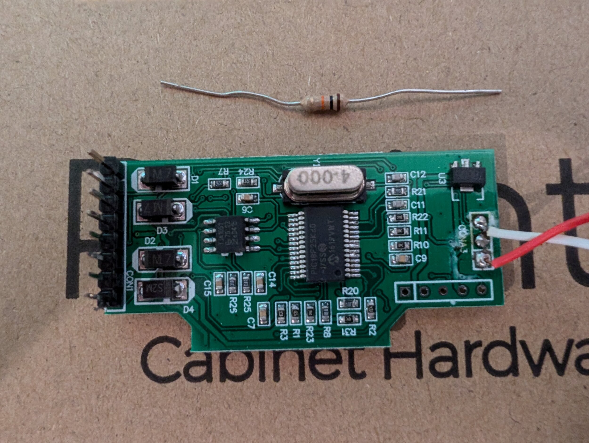

I haven't heard anything from Sparkfun on the UART - OBD2 board. I ordered an OBD2 reader with an RS232 interface on a DB9 connector. I'm still going to try to intercept the UART pins directly but I'm not the most skilled solderer so if the traces are concealed or just too small for me to work with, I can get a TTL - RS232 converter board at $10 for a pack of 3.

I was highly overoptimistic about the idea of soldering into a commercially manufactured board.
Turns out the OBD2 to rs232 scanner I got uses the small version of the chip so the pins are on a 1.27mm pitch instead of the 2.54mm that hobby parts use. There's not a snowballs chance in hell I'll be able to put anything on those pins.
If I want to use this I'm gonna have to use an adapter in between so I'll be going TTL to RS232 back to TTL. I don't know how to tell what scanners use the large format of the chip without buying them and taking them apart so I'm probably not gonna keep looking for one.

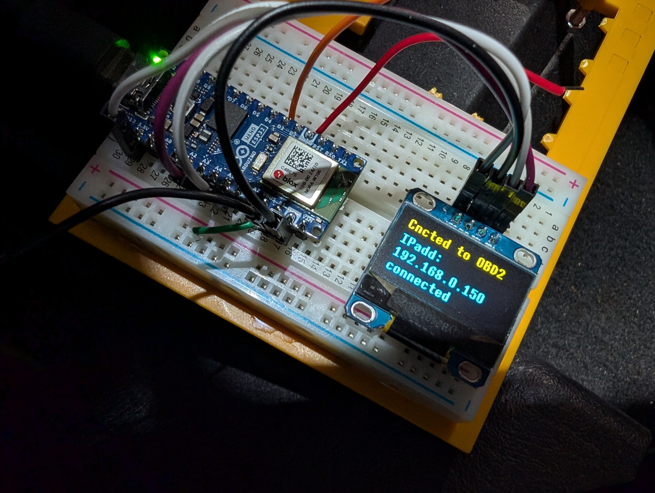

Spent this morning figuring out how to use this display (Values are just placeholders).
Then spent way too much time this afternoon trying to figure out why the sketch that worked perfectly on the Uno R3 kept locking up the Nano ESP32 in a boot loop. At one point it got so bad even the bootloader wouldn't free it up and I had to use the firmware programmer to unbrick it.
I got it fixed though I'm not sure I found a smoking gun. What I *think* was happening was
1. On the Uno, my averaged temperature variables re-initialized to zero on every execution of the loop. On the ESP32, it seems to hold it's value from the last cycle so it grows every program cycle and I need to actually assign it to zero before adding all the samples together.
2. At some point it becomes something that mathematically doesn't work in my NTCsensor() function, likely the natural logarithm of a negative when it overflows and wraps around.
Would have been quick to figure out with a line by line debug like I'm used to but if Arduino supports that I haven't figured out how to to do it yet.
Hope to have some time to get it connected to the Wi-Fi OBD2 scanner tomorrow.

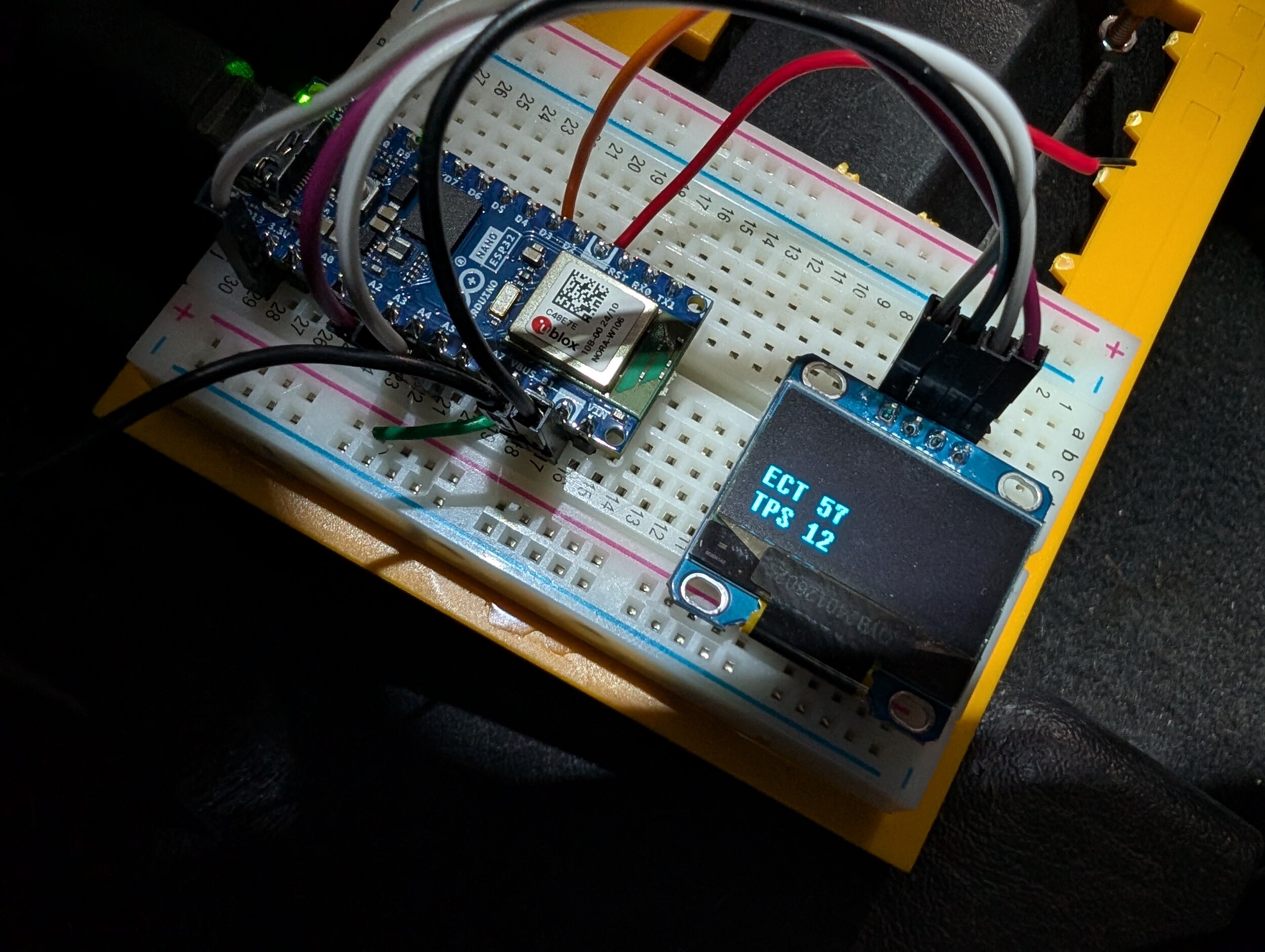

It's connecting, and it pulls data, but only for a few seconds and then the ELM stops responding and it doesn't update again.
I don't plan on using TPS but it makes for easy troubleshooting because I can change the value sitting in the garage without driving or even starting the engine. If I can get it to actually update continuously then I'll start working on the values I actually care about.
Reactions: Rickyd
Frustrating day. Not much actual progress other than just eliminating reasons why I'm not getting a continuous data stream from the PCM.
I get responses to the first 9 polls I make (after the initialization commands and the automatic first poll of PID 00 which returns the first group of supported PIDs, bitwise encoded. Doesn't matter if it's one PID or multiple, doesn't matter if I wait a second between getting a response and the next poll or just going rapid fire as soon as the response comes in, so it's not a time thing. I tried that thinking maybe the constant polling was overwhelming any of the components.
I get the same behavior when I plug the elm327 into my truck, so it's not just the jeep. My torque app works just fine with the elm327, indefinitely, so it's not the scanner.
Working theory at the moment is that there is a read buffer that isn't being cleared and it just happens to take 9 polls to fill it up. I know it clears the serial input buffer on every poll but I need to dig in to both the WiFi and the ELMduino libraries to see if it's a different buffer to clear. There is a code example for using Wi-Fi but it's clear the focus was TTL and Bluetooth so I can't assume anything about how well it's been proven out using Wi-Fi.
I also need to look into the WiFi library to see how to check the connection status after it's been established, to see if what's actually happening is losing the WiFi.
