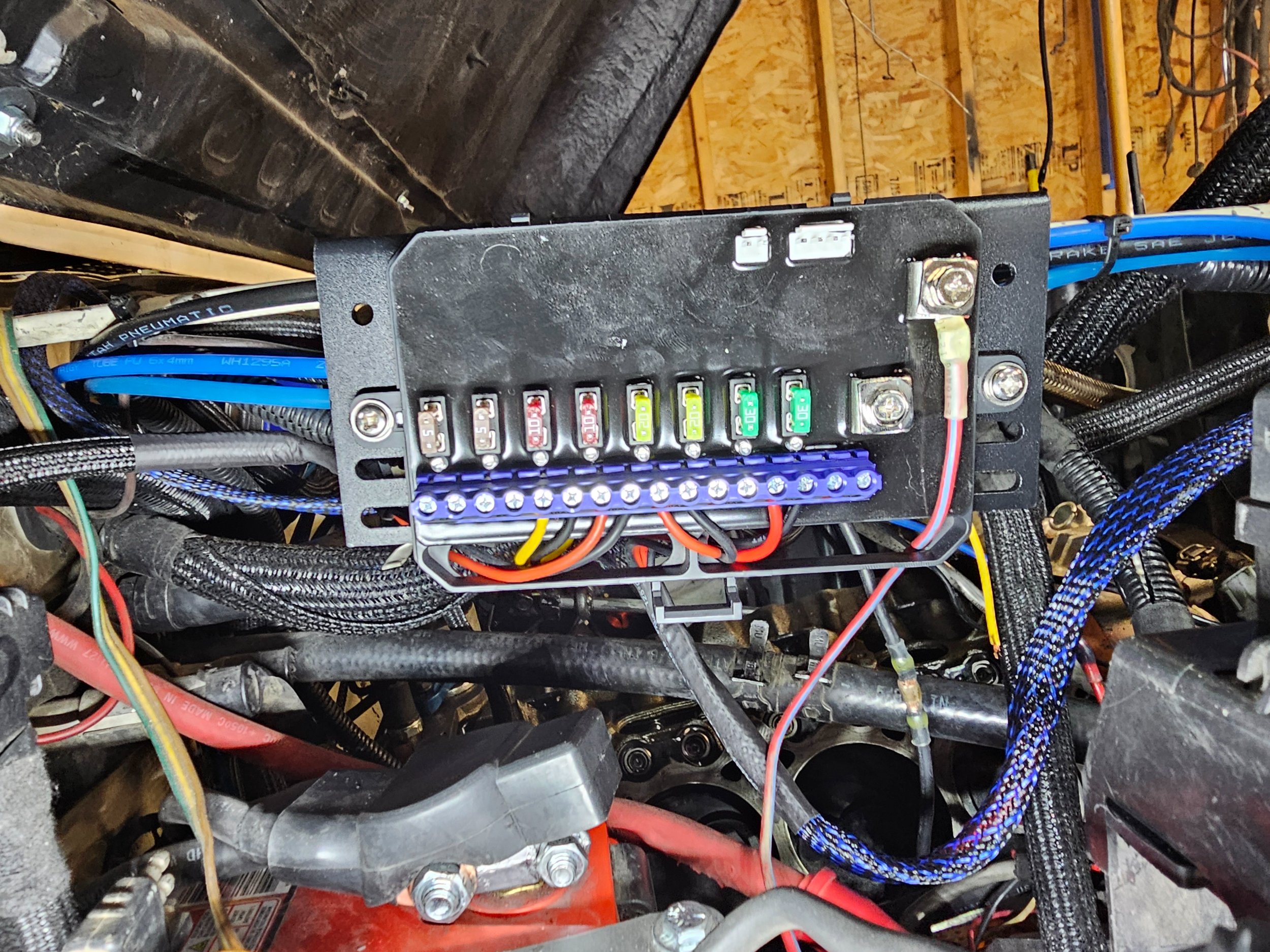

what switch did you end up running it too? they do run to many amps either do they? that's good to hear that both wires run to the auxbeam, i haven't gotten a chance to look at mine just yet but im excited to get it installed
I'd have to go back & look to make sure but I think I used the 5 amp spot for them since they don't require much.
So nope I hooked it up to the 20 amp terminal but I don't think it's required. Could have used the 5 or 10 amp circuit too I'd guess.

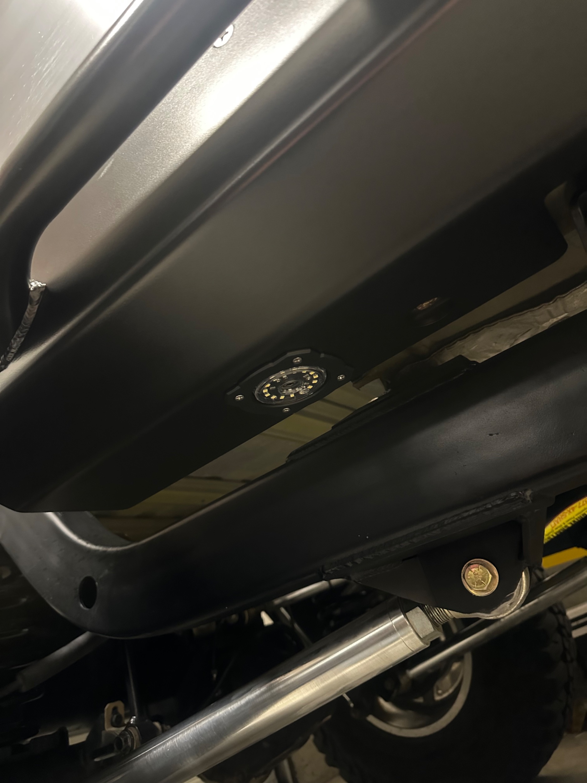

Do the KC Cylones bolt through the back? I don't see mounting tabs? I'm assuming the lense pops off since they're replaceable and there are holes through the light that you hit with your aforementioned nutserts?

I used their flush mount brackets in a similar fashion. I wish they were made so the light sat slightly deeper in the bracket.

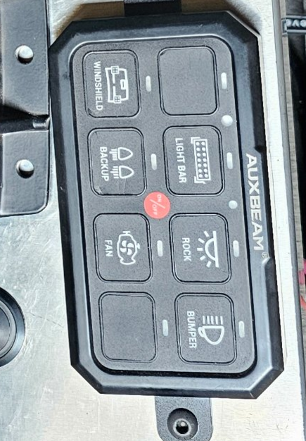

that's great to hear, right now i'll only have 3 sections filled out. it'll be weird not using the other 3 empty buttons lol. once it's all wired up i'll send some pics once the lighting and mounting arrives
Reactions: Wildman
I used a 5 amp for the rock lights.
The sticker sheet has a few blanks. Use as needed.
They kinda loose their stickiness after a while so don't change them too often.
yeah i kind of figured once you peel em off a few times they might start to peel. they sell another sheet from what i've seen so it shouldn't be to bad if i need extras, but again that's more money that I'd have to spend on lol
I've moved a few of mine twice I think and yes they start losing stickyness. I've bought some spare stickers myself already for just in case.
I too bought an extra sheet of stickers. However, once I got them to a point I was pretty sure I wouldn't be moving them I gave the back of the sticker a light shot of 3M Spray Adhesive, let it set and stuck them in place. Have lost one since.
