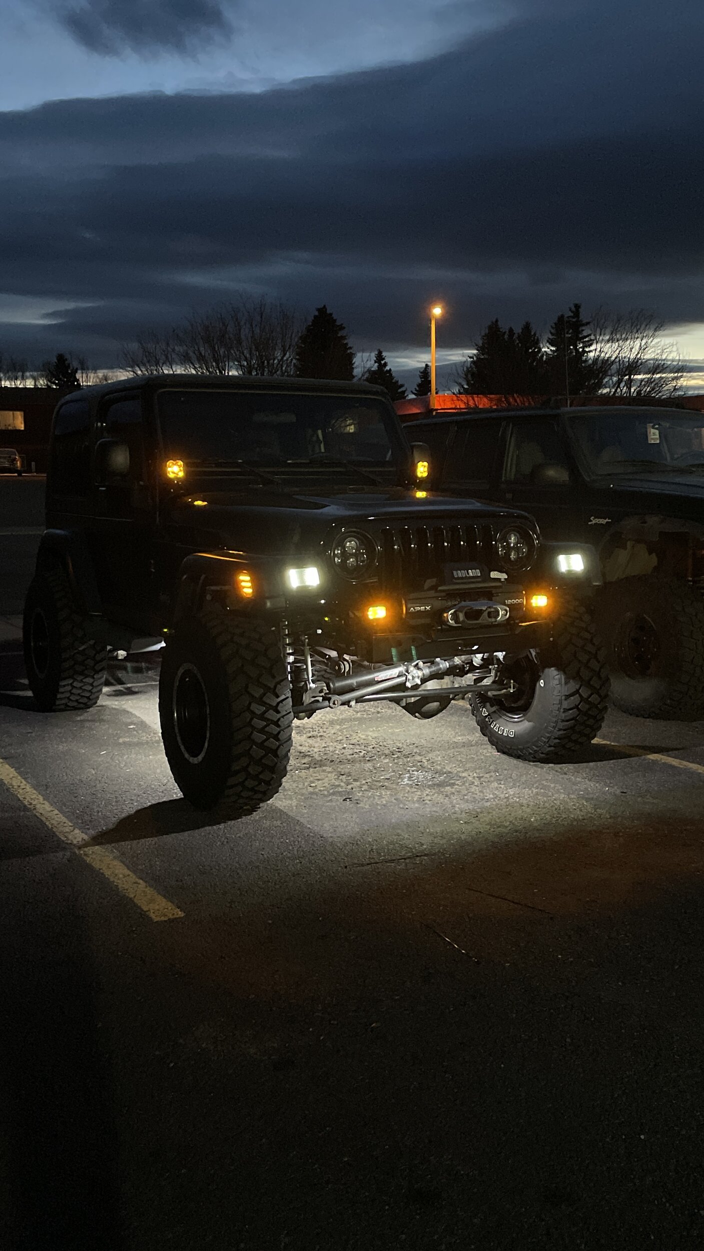

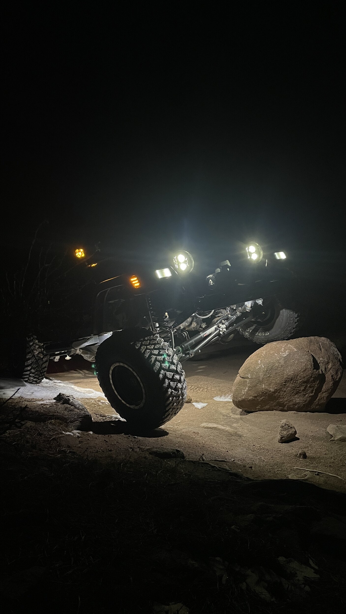

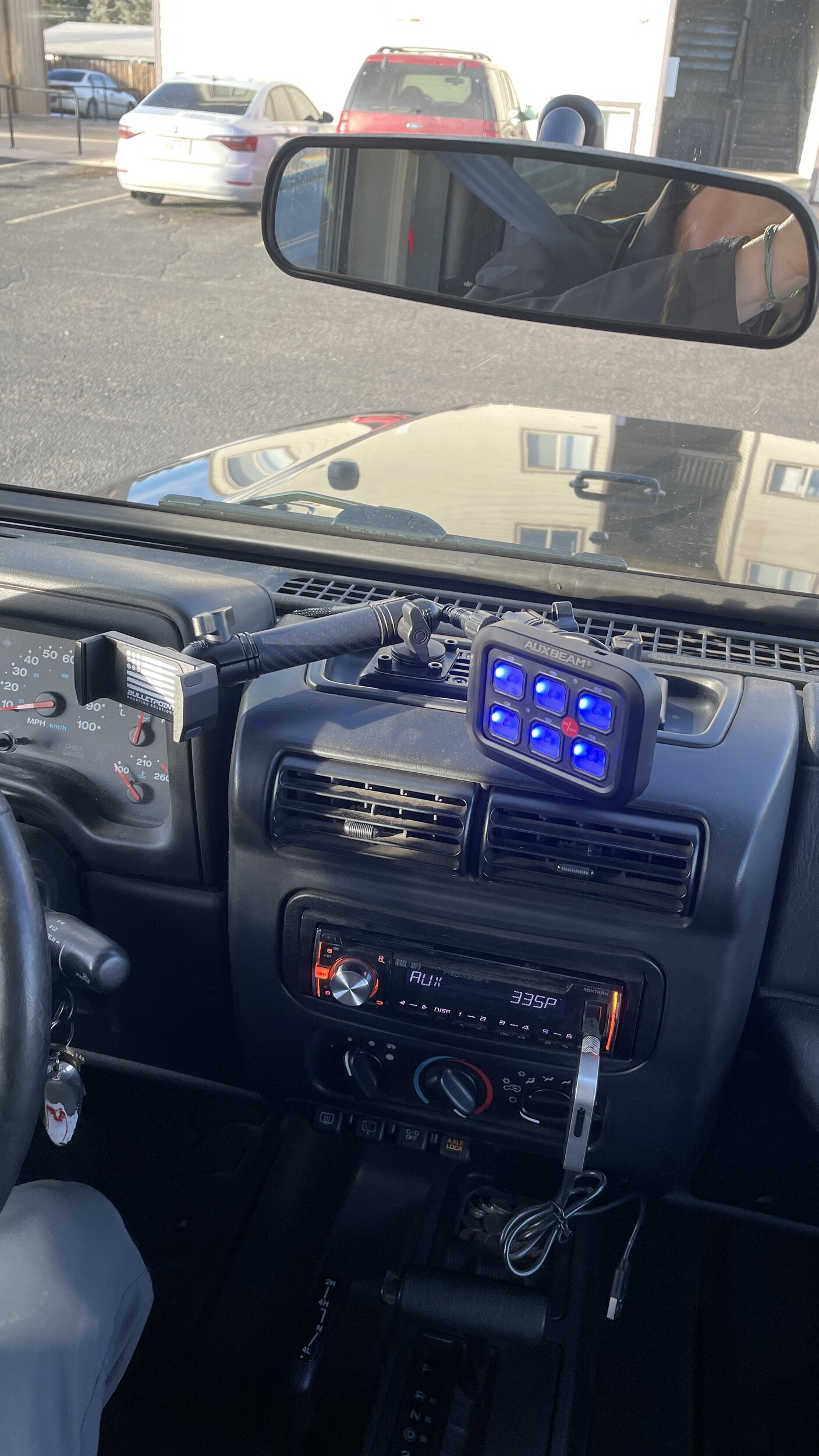

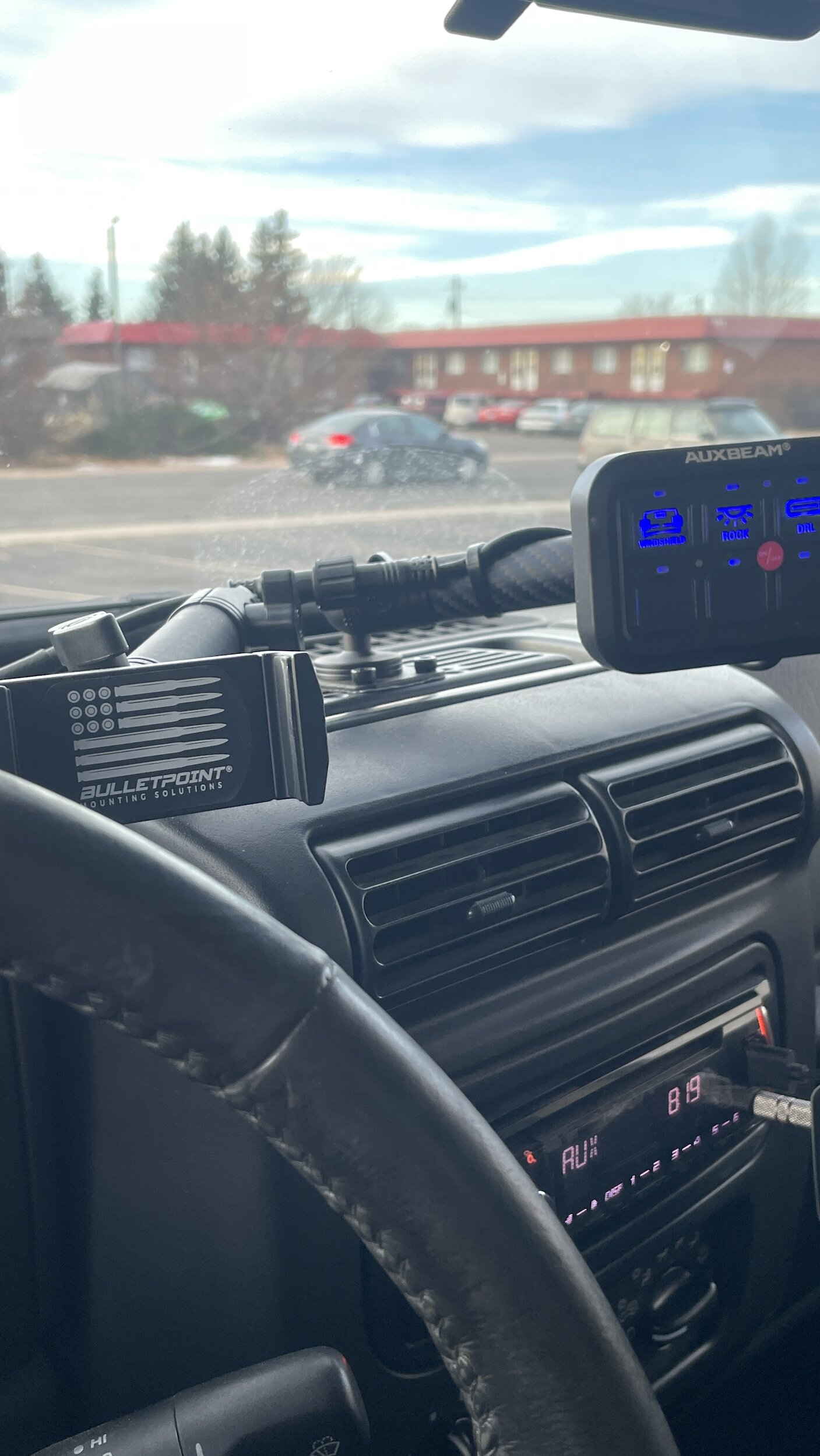

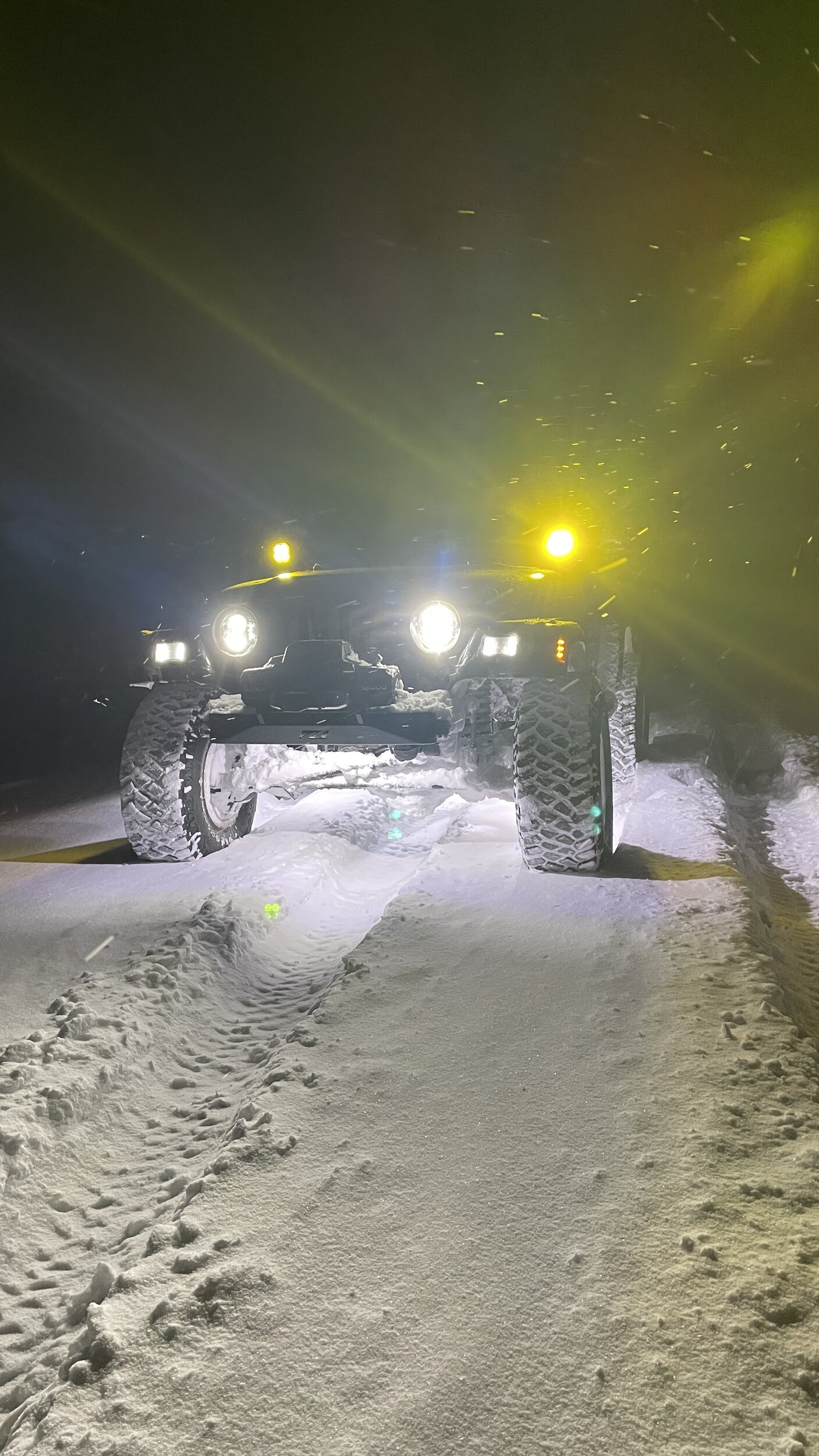

Here are some pics over the few days of having everything wired up. decided to go with bulletpoint mounting solutions since it was a lot cheaper than 67 designs during BF. love their system its really sturdy and quality, over the other few pics went with lux rock lights, installed 3 in the rear, one on the passenger rear upper control arm mount, one centered just about over the rear axle, and another on the driver side more or less right where the rear passengers put their feet. 3 were installed up front, 1 mounted on both driver and passenger side right before the fender flare and one mounted on the front body mounts cross-member. great light output and I can see everything underneath including parking spots lol. next for pod lights I went with diode dynamics for the a pillars and front bumper, the lights I purchased came with amber backlights, drive combo for their beam pattern on the SS3's and fogs for the SS2's. they're white in color but I bought yellow covers in event of inclement weather. SS3's are wired up to the auxbeam panel and the fogs are wired into the oem fog switch. However both backlights on the SS3's and SS2's wired into one switch on the auxbeam. absolutely love the added lights and the Auxbeam panel, it helps a ton when I decide to go night wheeling or needa blind the guy who doesn't know how to turn off his high-beams 😂 after everything this jeeps been through and rebuilding it after the rollover its looking damn good.

Looks great. I need to get mine out at night and take some pictures with all the different lights on. I'd say going with 6 was the correct option.

i think if i was running 8 lights i'd put one on either side at the middle of the vehicle so i could get more output on the ground but even without them it's fine as is. I will say though the light that sits just above the rear axle had just a little bit of wire left to where it'd reach the topish of the firewall. had i gone back any further or mounted one between the rear bumper and gas skid i'd be screwed and need to lengthen the 10ft wire
