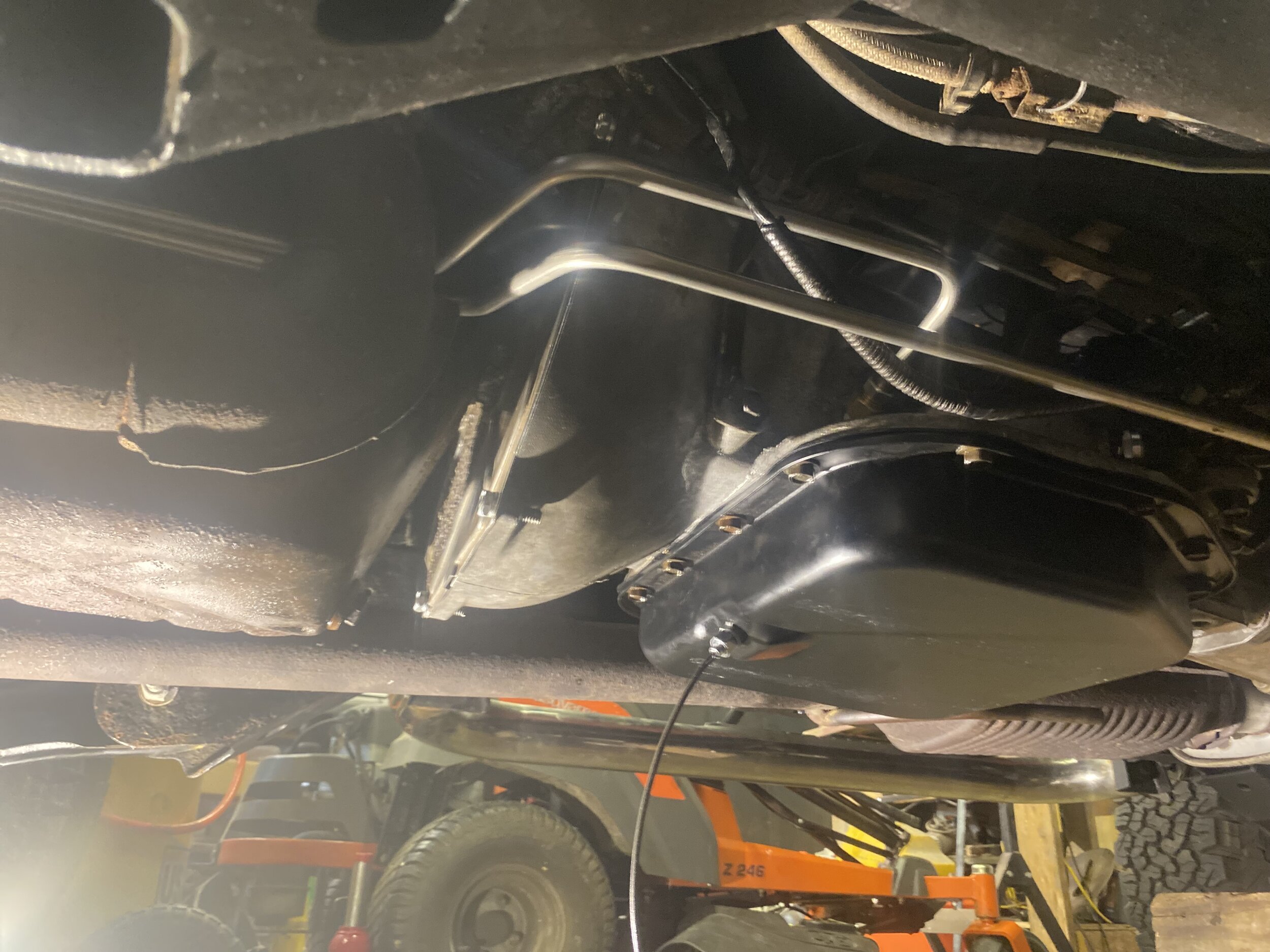

The ProKing CR90 fit! We mounted the transmission without prefilling the converter to test the bolt holes and it worked, so we pulled it apart and prefilled the converter, plus lubed up the pump seal and converter shaft. Got the transmission and transfer case bolted together, and hooked everything up except for the 4WD lever, which I can't quite get to actuate at the bar that sticks out of the transfer case.
Got the front driveshaft prepped to put back together and pressed in a u-joint, couldn't get it to sit properly (probably because I might have bent the yoke removing the seized old joints), and then mangled the plate where the CV joint ball sits further trying to take the u-joint back out. It might be salvageable, but I threw in the towel and ordered a new OEM replacement.
At this point, I am a mere few hours from the first startup with the new 32RH (plus new driveshafts and a new starter; yay, I guess?), so I'm pretty anxious to see if it works okay and nothing leaks. All that's left is the dipstick, hooking up the front of the cooler lines to the radiator, bolting on the starter and the cover plate, strapping on the driveshafts, and slapping the skid plate back on.
