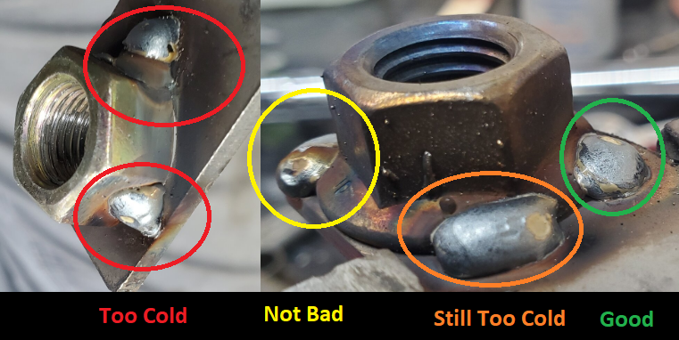

Some small tacks/welds. The muriatic acid worked really well on the zinc, I wasn't expecting so much effervescence though!
This was my first one. I took a grinding disc to the sides of the nut I was welding. I torqued my track bar bolt to 130 ft/lbs (MC specs). The tacks held, but my bolt stripped at 100ish ft/lbs. When backing the bolt out with the impact, the tacks broke free. My welder volts were setting "D" and wire speed was 8.
Built another one with a piece of scrap and this time used the muriatic acid. This one held together and I was able to get to 130 ft/lbs. Same settings, Volts on "D" and wire speed at 8.
Yeah, zinc is highly reactive and loves the chlorine in the acid!
I'm waiting for the welding experts to chime in, but your welds look too concave convex to me, which indicates not enough voltage or too much wire feed speed. If it were me, I'd try turning the wire speed down first. But I'd really like to hear the experts chime in!
I'm waiting for the welding experts to chime in, but your welds look too concave to me, which indicates not enough voltage or too much wire feed speed. If it were me, I'd try turning the wire speed down first. But I'd really like to hear the experts chime in!
Correct, but I think you meant convex. Voltage is too low or wire feed speed is too high. Also could be you're moving too fast or the zinc is preventing fusion. IIRC "D" is the highest voltage setting? Try lowering your wire speed & tack the full length of the side of the nut instead of just a small spot.
Yes, D is the highest voltage setting. Will play with wire speed a bit.

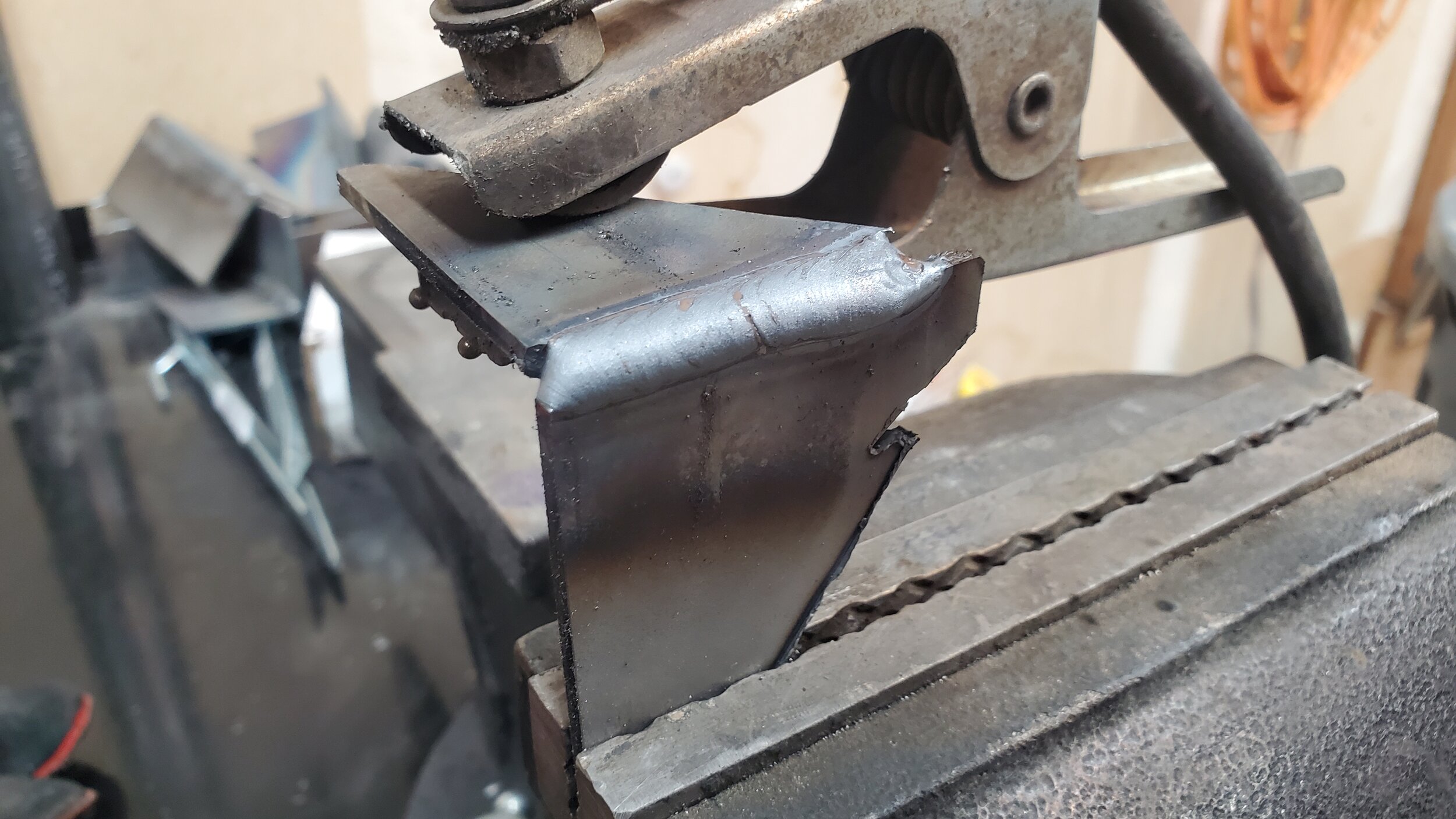

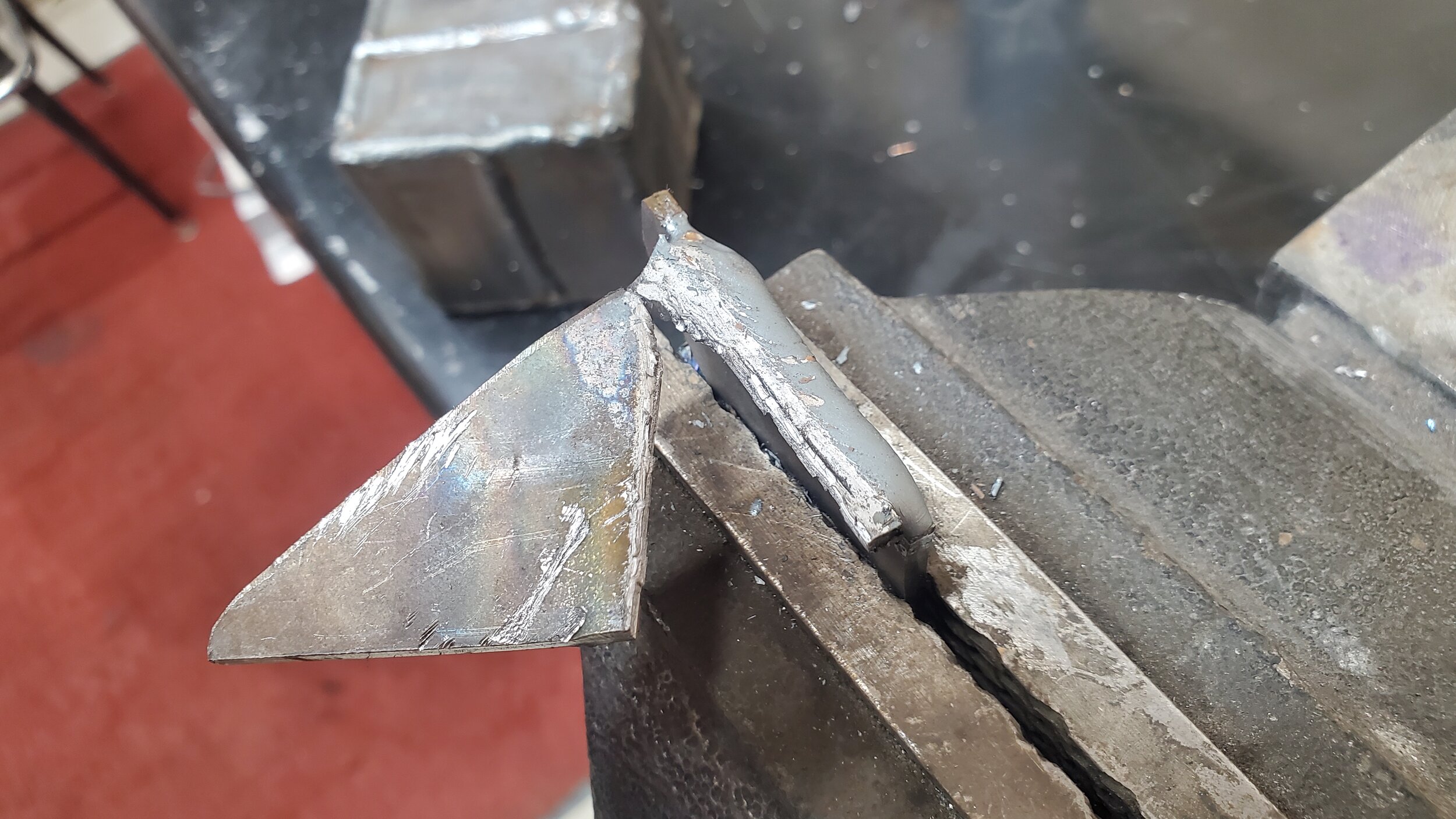

In case anyone was wondering, this is what happens when your settings are too low or you're moving too fast. This particular butt weld was made on 2 pieces of aluminum at approximately 100A & I moved really fast. For reference, this thickness is usually welded around 130-140A. I should have snapped a pick of the weld before I broke it but I forgot. You can see half of the weld in the first pic. Appearance wise it's not terrible, a little cold but that's what I was going for & I had difficulty keeping that pace.
Anyway, that bottom picture you can see that the base metal & weld metal did not fuse together. Actually the base metal didn't even melt into the weld at all. The weld just sits there on top. Both sides were welded, but I ground down one side so I can break it at the joint easier but clearly even 2 passes was not enough heat to fuse the plates together. You wont have this drastic difference with steel because aluminum cools faster because it dissipates the heat better than steel, but it's a lot easier to demonstrate this with aluminum. A lot of people don't see a cross section of a weld so I thought this might help some people.

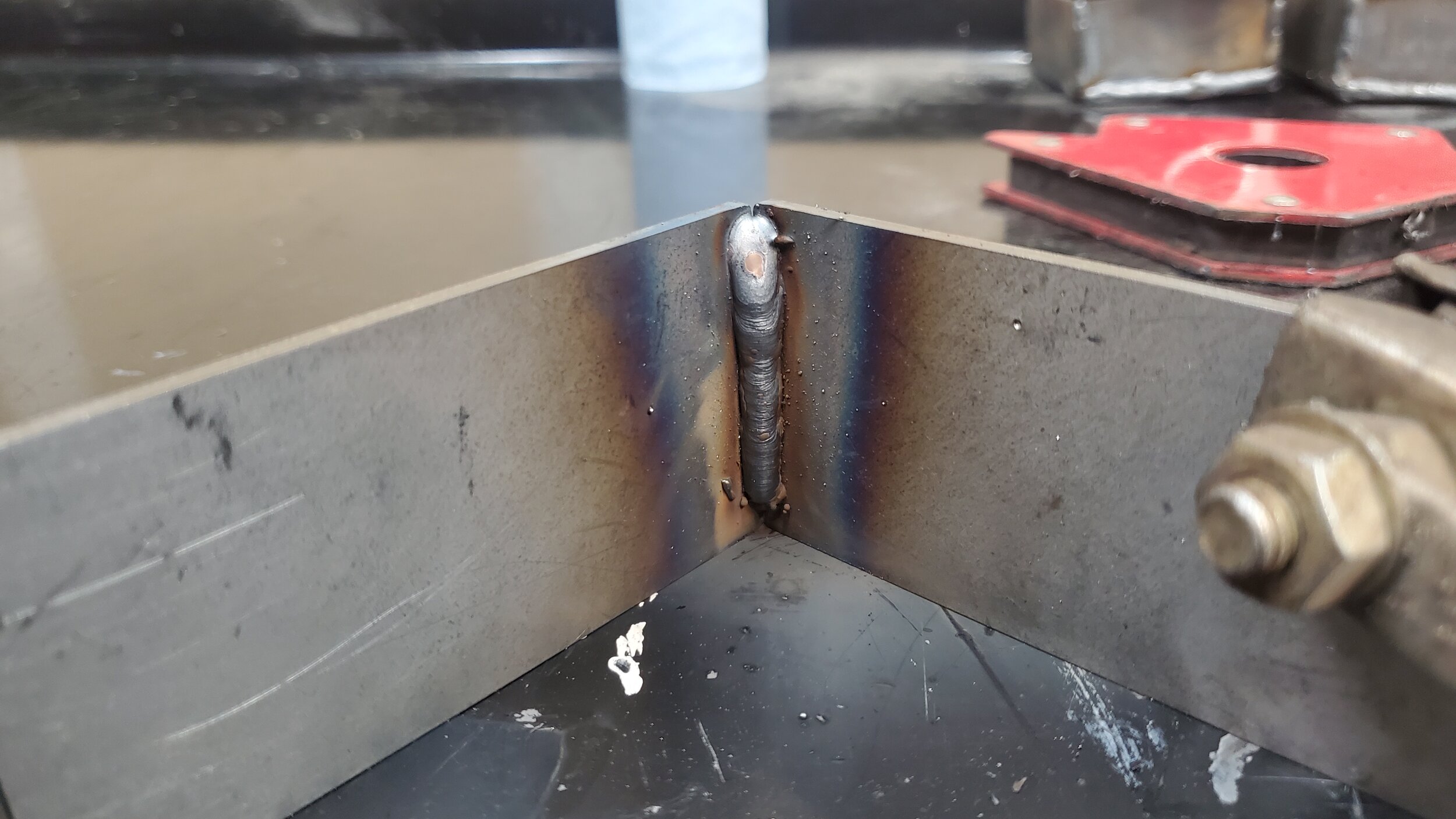

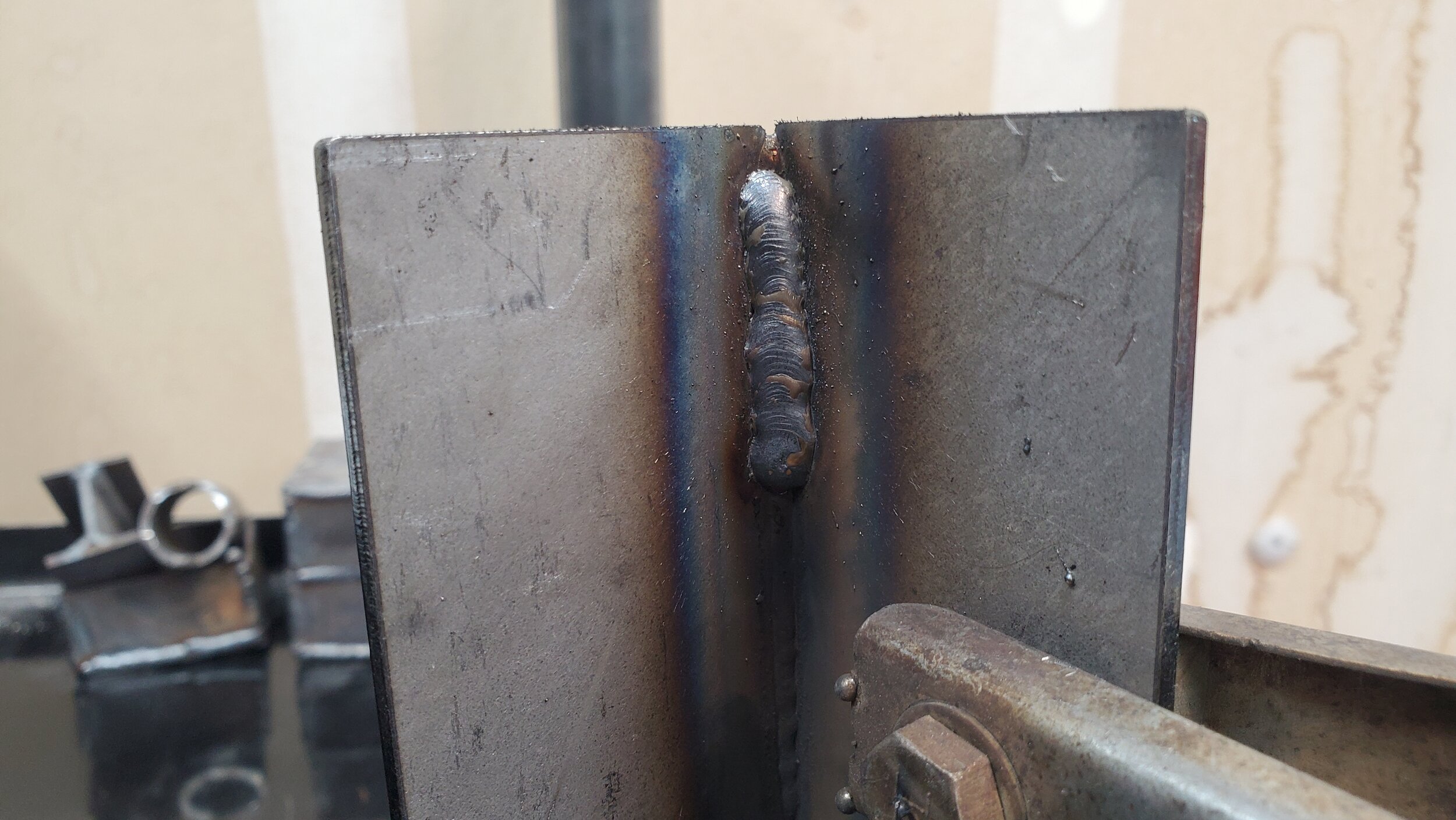

Voltage D. Wire speed 9. Whip/pause.
Voltage D. Wire speed 8. Straight push
Voltage D. Wire speed 7. Uphill. Whip/pause
Voltage D. Wire speed 8.5. Whip/pause.
Voltage D. Wire speed 8.5. Downhill. Whip/pause
Reactions: JMT
Not too bad, but here's my honest feedback
First picture: Excellent fusion, a little too much wire. Most likely moving to slow
Second picture: Excellent fusion, way too much wire. Definitely moving too slow
Third picture: Don't whip & pause vertical. Straight drag up & watch the sides for fusion
Fourth picture: Excellent fusion, a little too much wire. Most likely moving to slow
Fifth picture: Some fusion, but again don't whip & pause vertical. Slight side to side motion just to get fusion on the sides.
I could probably tell you more if I saw the back side and you break them & give me a clean picture of the break

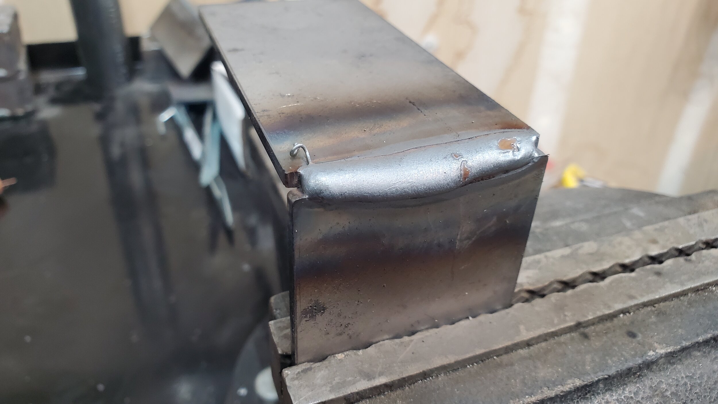

Well. The weld didn't break 😅
Backside
Placed it in the vise and repeatedly twisted with a pair of channel locks. The coupon itself tore just before the weld.
I'll try and cut it it in half with a cut off wheel tomorrow
Backside
The base metal is supposed to break first. I just wondered how it would break & if the weld broke first I could identify any problems.
Your penetration looks really good, except for that little bit towards the end of the weld on the backside. If I had to guess I'd say you had a tack there which takes a bit more voltage to melt the thicker metal from the tack.
You done good tworley
That's exactly what it was too, a tack before I placed it in the vise to fully weld. Thanks!
