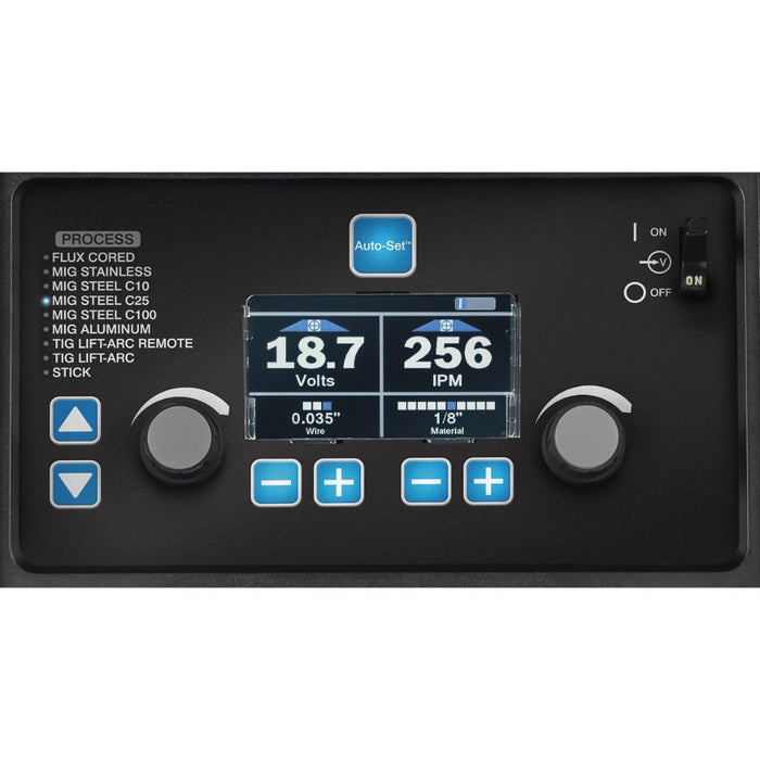

Interesting - they removed a selection for gas type?
you also select the process being used which covers the gas.
My 235
Reactions: tworley and sab
Oh, yeah. I just remembered that mine also has a material selector (aluminum, steel, stainless, etc.) That's probably why they had a gas choice, too.

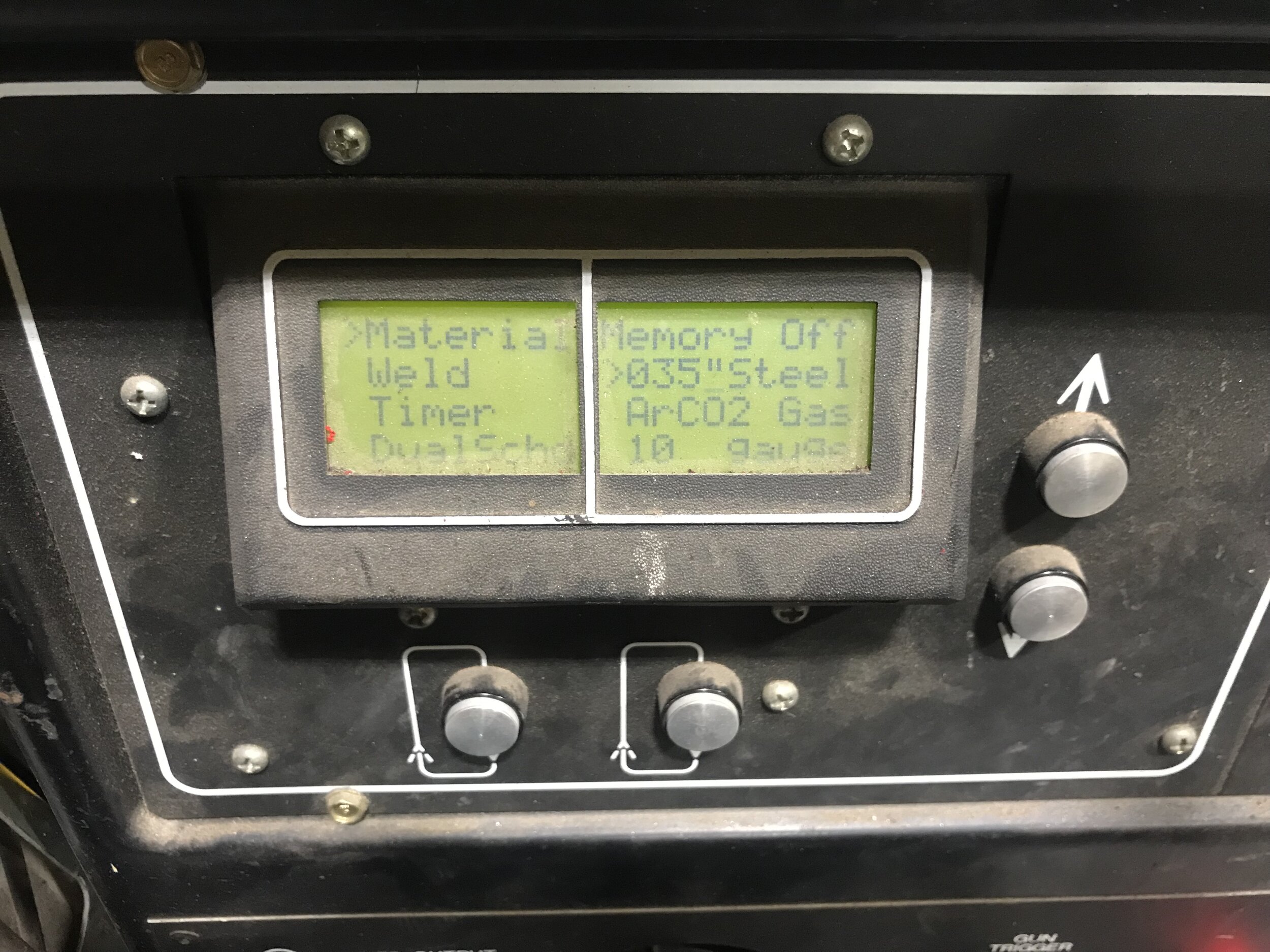

I'm curious to hear how the modern Auto-set works. On my old 250MP, I set the wire size, gas type, and material thickness, and it sets the wire feed speed and voltage for me.

I think that's why the 250MP didn't last long. Back in 1992, I don't think there were as many guys welding in their garage because we didn't have YouTube or even Internet forums to learn from each other. The Auto-set feature is great for those of use who don't weld every day!

That's purdy! I'll have to take a pic of my controller tonight to show what state-of-the-industry looked like three decades ago...
Here's what 1992 Auto-set looks like:
And I need to try some .030" wire. I've always used .035", but do occasionally struggle with it.

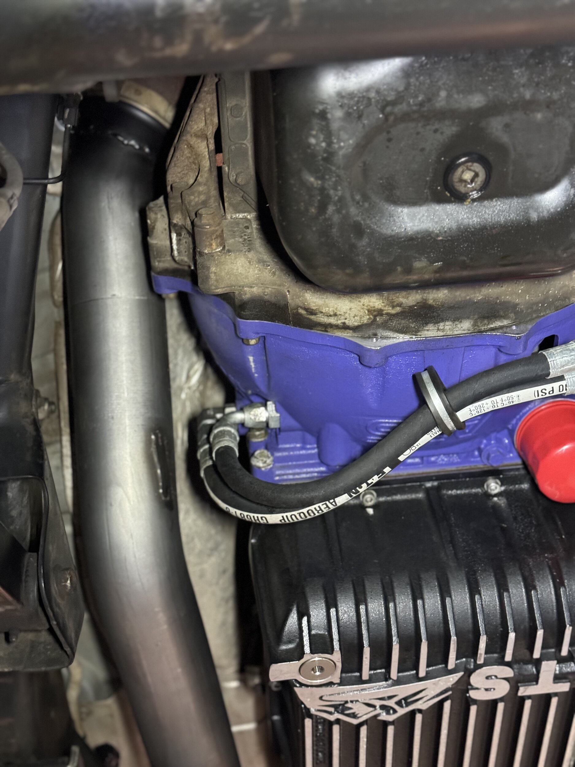

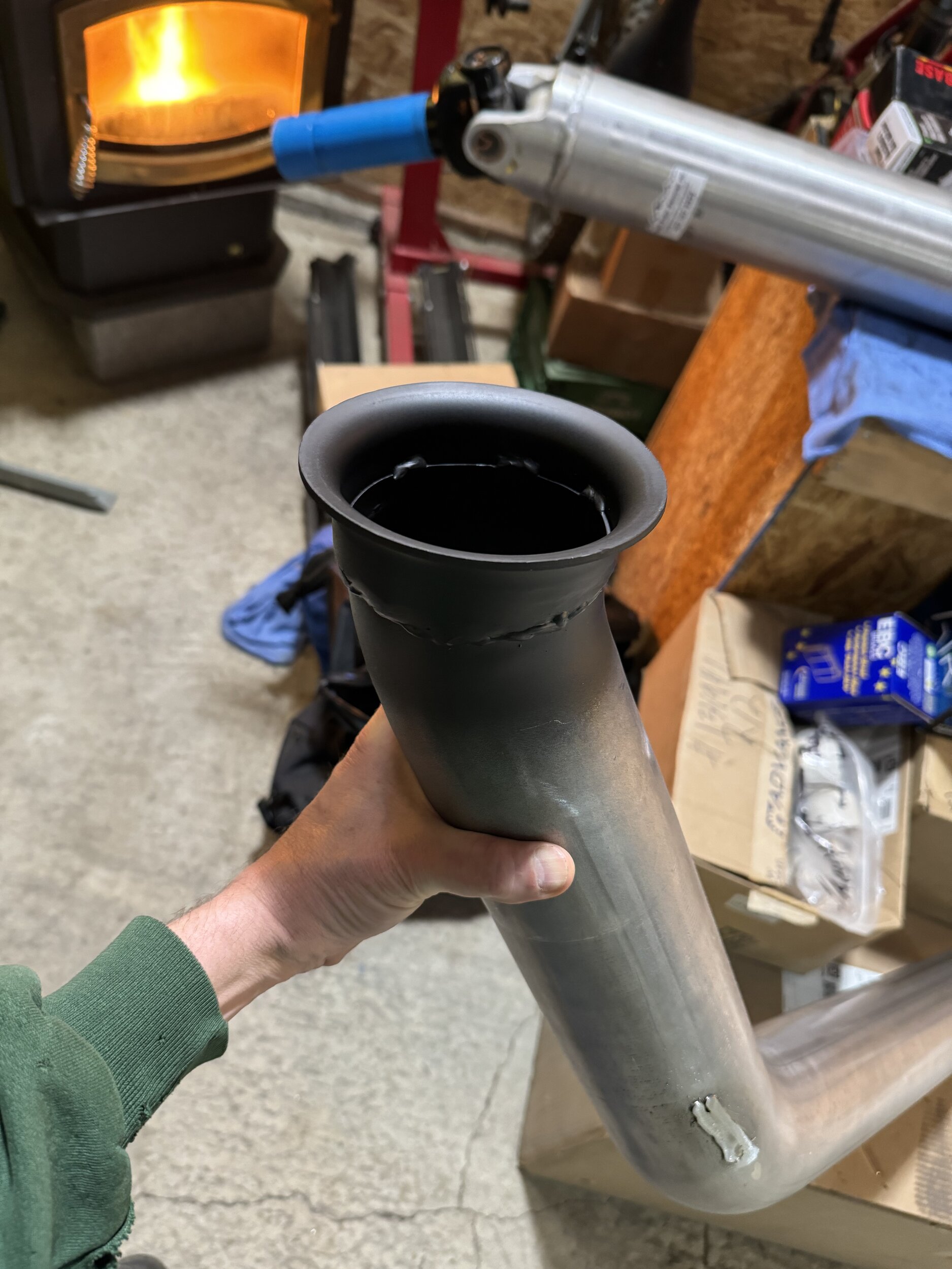

Yes, if you call success sticking 2 pieces of metal together. I put a down pipe on my '08 6.7 Cummins from an '06 5.9. Both are 4" but the turbo outlet is bigger on the 6.7. So I had to cut the flange off the stock downpipe and weld it to the new one. I don't have any pics of the raw weld. It was hard to do. You have to move way faster than I'm used to. Here it is after I sprayed it with high heat paint which I did in case my technique was too hot and messed up the corrosion resistance, which I guess is a thing. I did get a small bottle of Tri-mix to use.

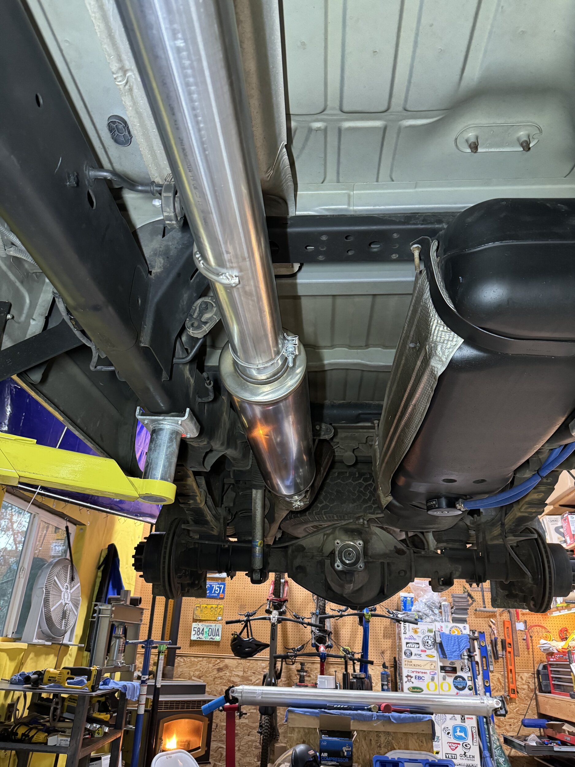

The only other thing I had to weld for that project was to bend some stainless rod for hangers and tack them on. Also surprisingly difficult and not pretty:
