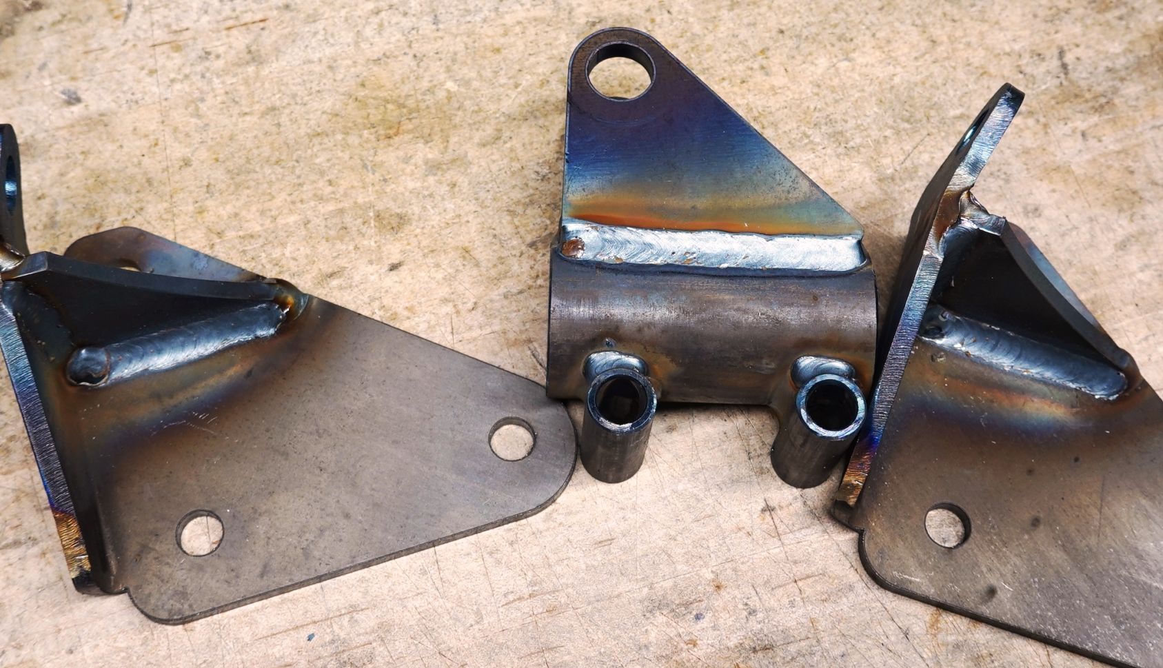

Alright, I’m looking for some constructive criticism here. I am very inexperienced at welding and struggle with consistency and general lack of knowledge. I bought a welder 2 years ago; Miller Multimatic 220. It has autoset, which helps but may hurt by not making me figure the settings out myself. I also took a class at a local community college (not a real class, just a community outreach thing that was 5 or 6 evenings for a couple of hours where they would have a process theme for the night (MIG, stick, TIG, gas welding, using a torch etc.). Then you were basically given some scrap metal and turned loose with the equipment. No real teaching. It actually just seemed dangerous, given the experience level of the participants. I’ve used YouTube, of course and stayed with MIG. I’m aware that one big problem I have is, I’ll go for months without welding then pick it up for some project and wonder why I suck at it. Anyhow, here are my latest welds (a Genright cross member for my TJs transmission as part of a Atlas and higher tuck project). Here is the crossmember:

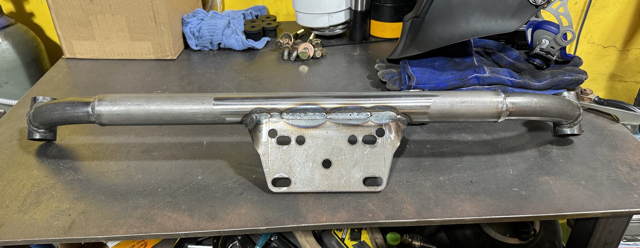

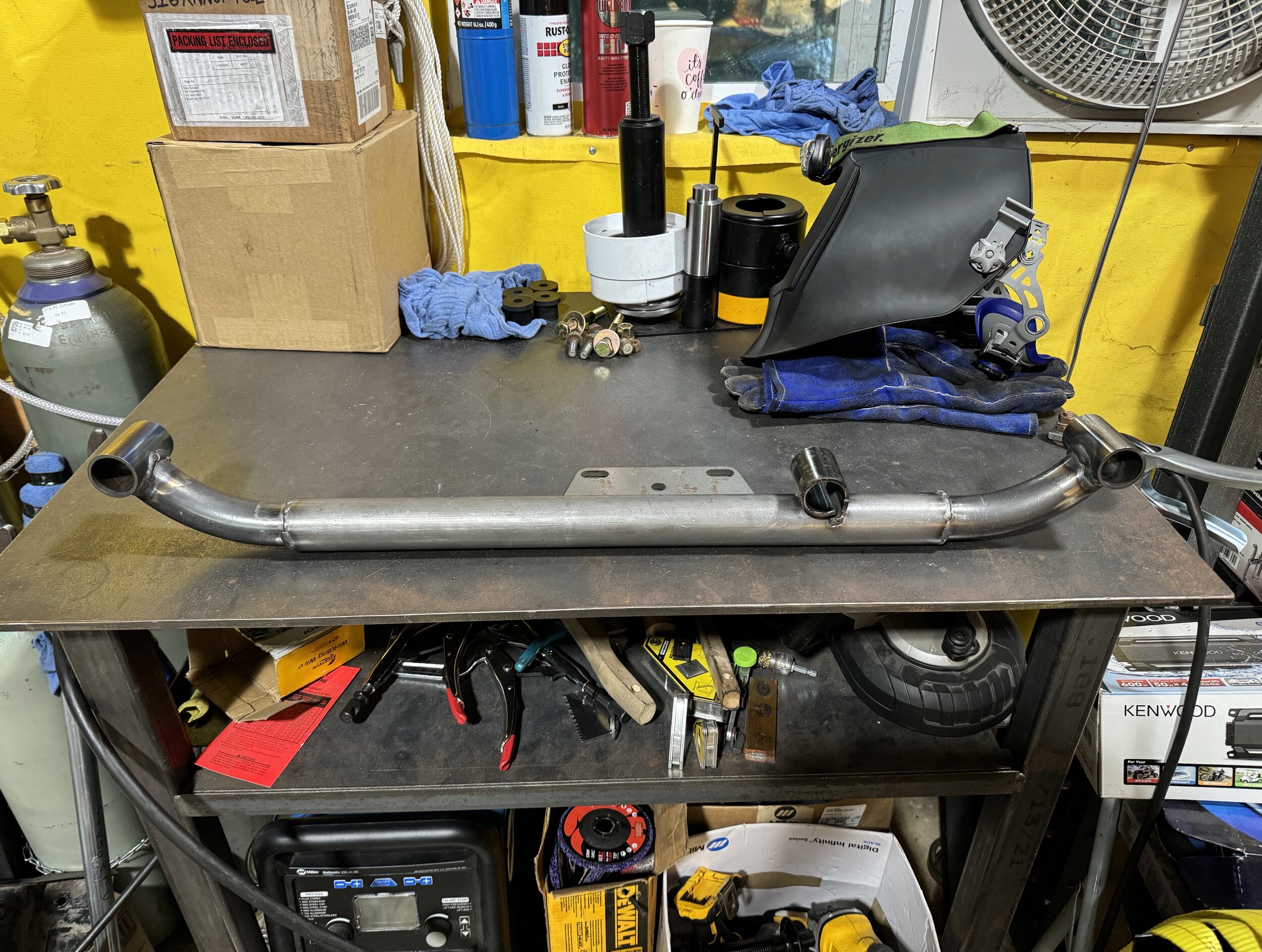

I was happy enough with the welding of the stamped piece to center tube. The side tube to curved tube went OK and the smaller diameter to larger diameter welds look awful.

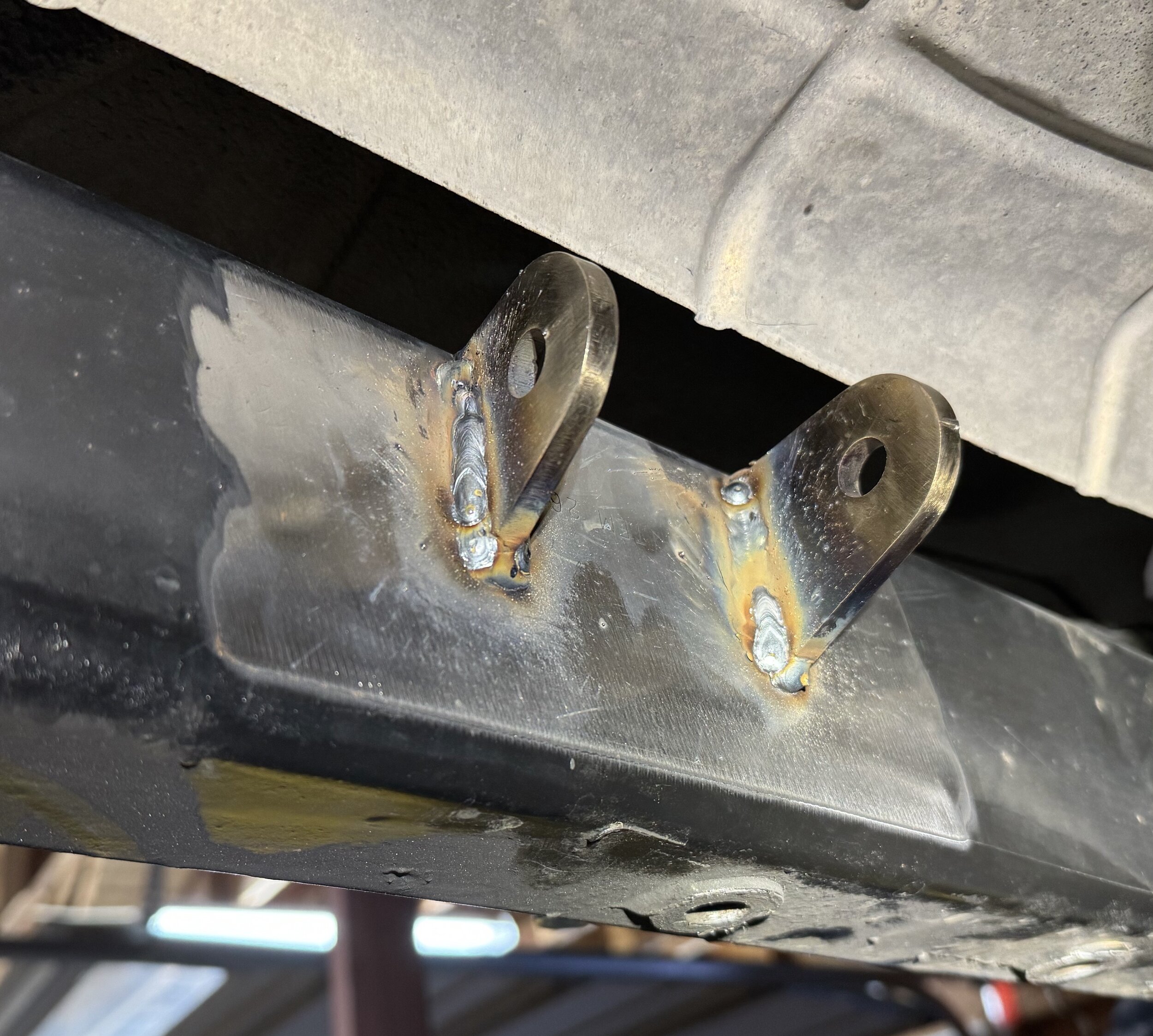

Then there was welding the tabs to the frame.
Passenger before wire brush:
Driver after wire brushing:
In my estimation, they look marginal, at best, even for a beginner .That was very awkward. My technique consisted of turning the voltage down a bit and pushing the weld from the bottom up after tacking them. I tried both welding half of each side and switching as well as doing an entire side.
What do the experts and pros see? Just give up? I know I need more frequent practice but what else would anyone suggest for these particular welds? Thx for looking.

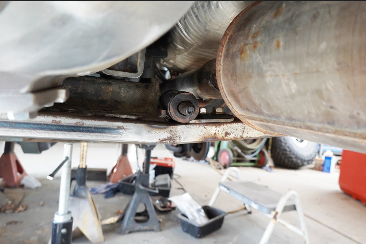

Not for nothing but welding that exhaust hanger to the crossmember is a mistake. We make that part bolt on because it traps the crossmember. You have to slide that off of the exhaust hanger rod to the rear and you can't do that with the tabs locking the crossmember in place.
Good idea. My exhaust has V-band clamps so it's not real hard to separate but still that was going to be a PITA. Time for a slight change. Thanks.
You couldn't ask for a better weld on that stamped piece to center tube, very nice. The tabs on the frame don't look too bad either, you should be proud & don't give up. On the driver side tabs, there's a lot of soot & spatter which is most likely gun angle or wire stick out. Focus the gun nozzle more on the puddle & less of the direction of travel. On the passenger side tabs, the one on the right isn't bad but the one on the left looks "cold" meaning you didn't have enough voltage.

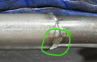

The tube welds look like too much WFS or moving too slow. Those types of joints are tricky, especially on smaller diameter tubing because you're not moving in a straight line. Sometimes you have to just put down a small weld, like 1" at a time & grind down the end of the previous weld to give you a good place to tie in the next weld.
How did you weld the large tube to the small tube? Vertically or horizontally? When I can I always try to position what I'm welding to the easiest position possible. Also, it looks like you've got some porosity on the right side. Everything looks pretty clean so It might not be from bad welding technique.
Whenever you seal off a tube you need to let the air inside cool off before you put the final weld. The heat will increase the pressure inside the tube & force the air out through the weakest spot which is your weld puddle.
Other suggestions I'd make are more for better structural strength. Whenever you have corners, it's best to continue the weld around the corner. The starts/stops of a weld are usually the weakest part. When you couple that with the corner, you're putting 2 stress risers at the same point which can lead to a failure. Also when you start & stop on an existing weld, grind down the ends which will help you put in a better transition.

One thing that will help is to swap to .030 wire if you aren't already. Lays down less material and makes it easier to get out of being rusty a bit easier. It is a more forgiving wire size since you can weld slower with it.

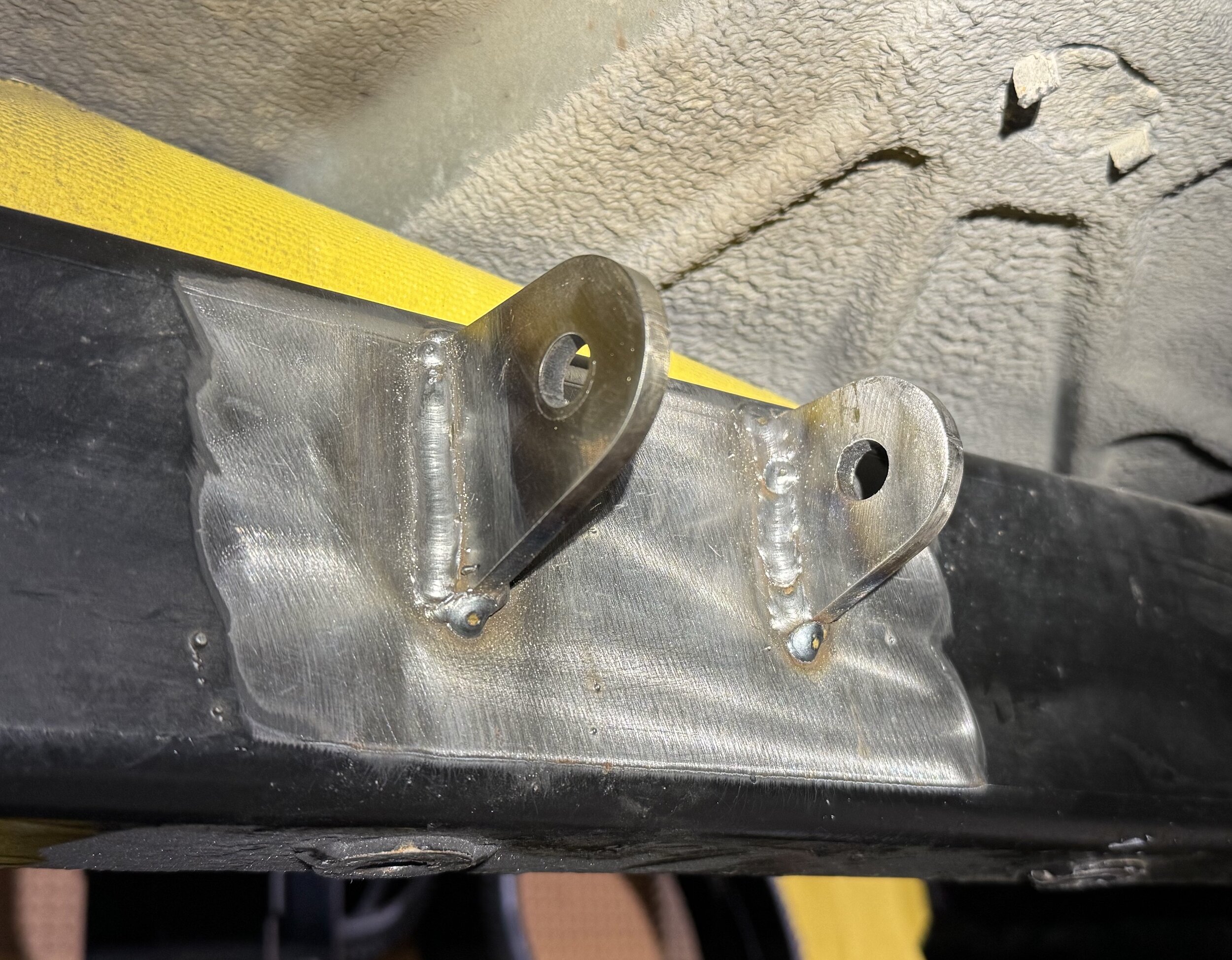

If you are like me, you have 2 problems following best practices and advice. 1, you don't weld often enough to stay in practice. 2, you will never be good at uphill Mig and even if you practice enough to get good, you will lose it in short order if you don't keep practicing.
What I do instead, is get really good at downhill.
This is all downhill, they will never fail, and I need something I can do every time that will give acceptable performance that doesnt' look terrible that I can get right back into the swing of doing in fairly short order.
You run your welds really hot. I'm not saying that's bad. I usually tell welders to run as hot as they can handle without losing control of the puddle.
I do, on purpose. I like to keep it right on the edge of being too hot where I get spatter. I try to stay just back of that edge. Iffen you're gonna be a fucked up welder, at least compensate with some penetration.
