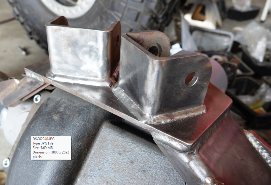

The small bits of slag on the surface tend to throw things off a bit.
The red spot is a reflection from a gas jug sitting beside the axle.

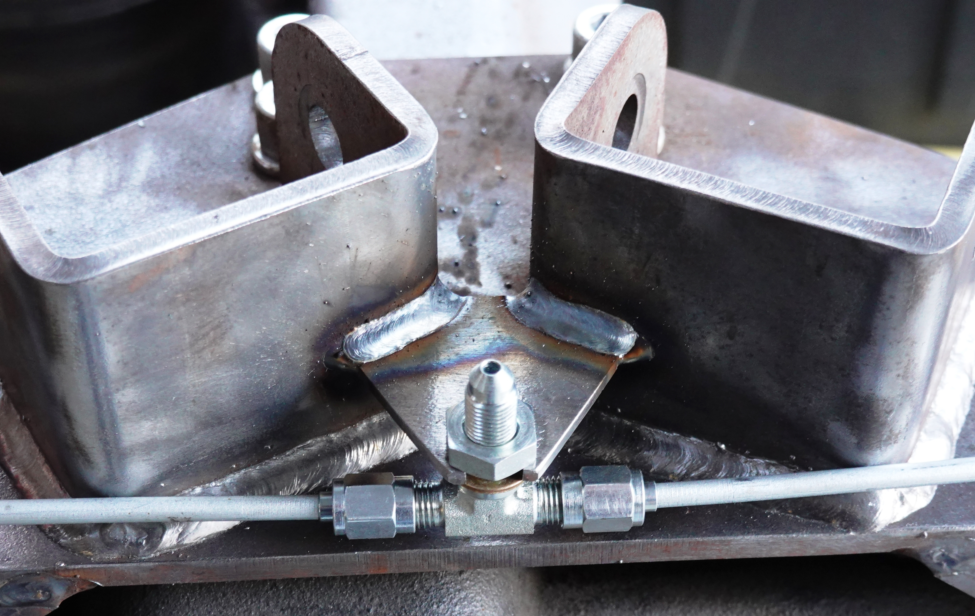

Center brake line tab.

Do you ever have issues with heat distortion or warping?
All welds shrink when they cool so they will pull no matter what. I just do a tight fit up where it matters and work around the rest. That truss you see bolted down has lots of tendency to move around. The truss that it comes with is 1" taller with a bent double bend tongue with the 4 front bolts in it. The bends start just behind the bolts, step up 1" and then back, with a down flange at the rear. Older version-
We lop that off level with the top of the diff casting or straight back from the bolt platform which leaves the two side legs with the 3 bolts at the base. Then we cut out that flat section the uppers weld onto as a platform and weld that to the two truss legs. I know it is going to pull and move so I tack it with the legs biased as far to the outside as possible so when it pulls, it will move them back to centerish. My goal is to not have to monkey with the bolts and a drift to remove and replace the truss.
I select which welds to do first and do the ones that will lock it down with the least amount of movement before I weld the ones with a higher tendency for displacement.
