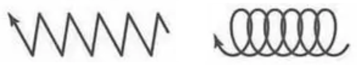

GMAW patterns will vary depending on the joint geometry, see reference below . The simplest pattern is no pattern at all, usually called a stringer where you’re just moving the gun along at a constant speed in a straight line. A stringer is sometimes necessary if you’re welding thin material & need to move fast. I think beginners struggle with this because of its simplicity. If you don’t know what you’re looking at then you are just going through the motions. This is the main reason people suggest starting with oxy/fuel welding because you have to carefully watch what the puddle & base metal are doing or “reading” the puddle.
Believe it or not, you can learn the same thing with GMAW using a “whip & pause” pattern. Essentially what you’re doing is quickly moving the wire tip to the leading edge of the weld puddle then letting it fill up then repeat in a consistent pace. What this is doing is allowing the arc to heat the base metal to a molten state “digging” then letting the weld puddle fill that up with the melting wire. This will help you understand what is happening to the metal & what to look for.
Once you learn to read the puddle & you can lay down a nice consistent stringer then you can begin trying other patterns.
For reference:
Flat - Zig Zag - Make sure you're getting enough penetration in the middle & focus on tying in the side edges of the puddle to the base metal.
Horizontal - circles or cursive “e” - Your up stroke should always be on the leading edge in the direction you are welding. Also, a slight pause at the top of the loop & moving faster along the bottom will ensure even distribution of weld metal because you will be fighting gravity.
Vertical Up - Chevrons or upside down “V” - Spend more time tying in on the sides & quickly move to the other side. The weld puddle will naturally fall to the middle so the peak of the chevron will help keep the puddle from pouring out. A slight upward gun angle will help (5°-10° from perpendicular to the weld)
Vertical Down - Crescent moon - Again, spend more time tying in on the sides & quickly move to the other side. You will need to move faster because the weld puddle is going to fall if you can’t control it. A slightly more aggressive upward gun angle will help (10°-15° from perpendicular to the weld)
Overhead - Depends - If I’m pulling the weld towards me I’ll do a quick little zig zag motion, but if I’m welding side to side I’ll do circles. With overhead you really need to watch he puddle and move fast so I try to avoid this if at all possible.
There’s dozens of patterns but these are the basics that will help you chose which one you think works best for you.
