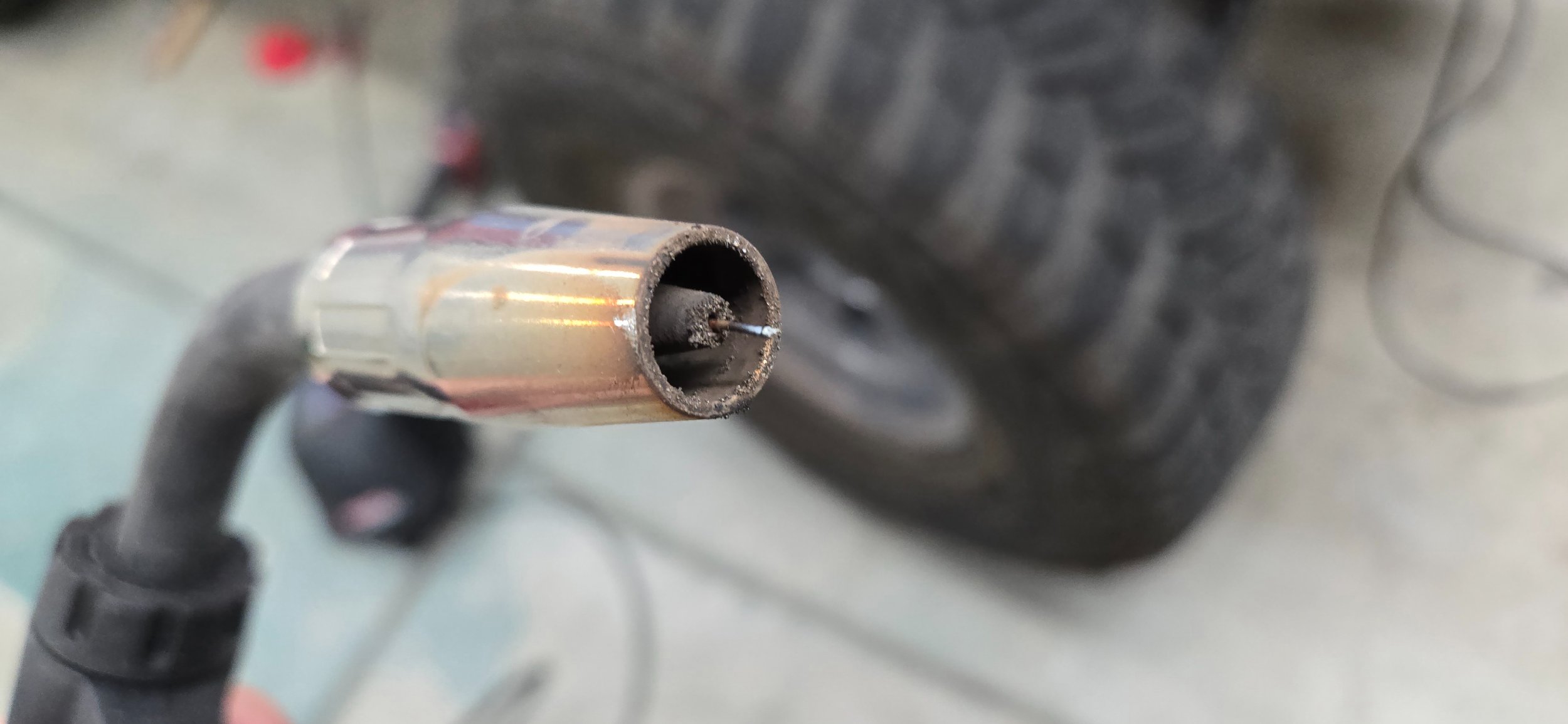

Have you changed anything on the gun recently, like the shroud or the contact tip? I think I remember @hosejockey61 having some issues due to a change in contact tip length that caused turbulence in the gas flow. I tried to find that post, but either I'm mis-remembering, Google isn't finding it, or both.
Edited to add: I wasn't mis-remembering. Here's the post:
So I thought it was my gas fitting to my tank as I had a slight leak there. Fixed it and no go.
Welding has been hit and miss enough to drive me crazy. I turned the gas up to help overcome the issue. Still intermittent.
Then I remember changing nozzles out a little while back. After struggling, I went through everything with a fine tooth comb. I remember comparing nozzles and they are the same length. What I...

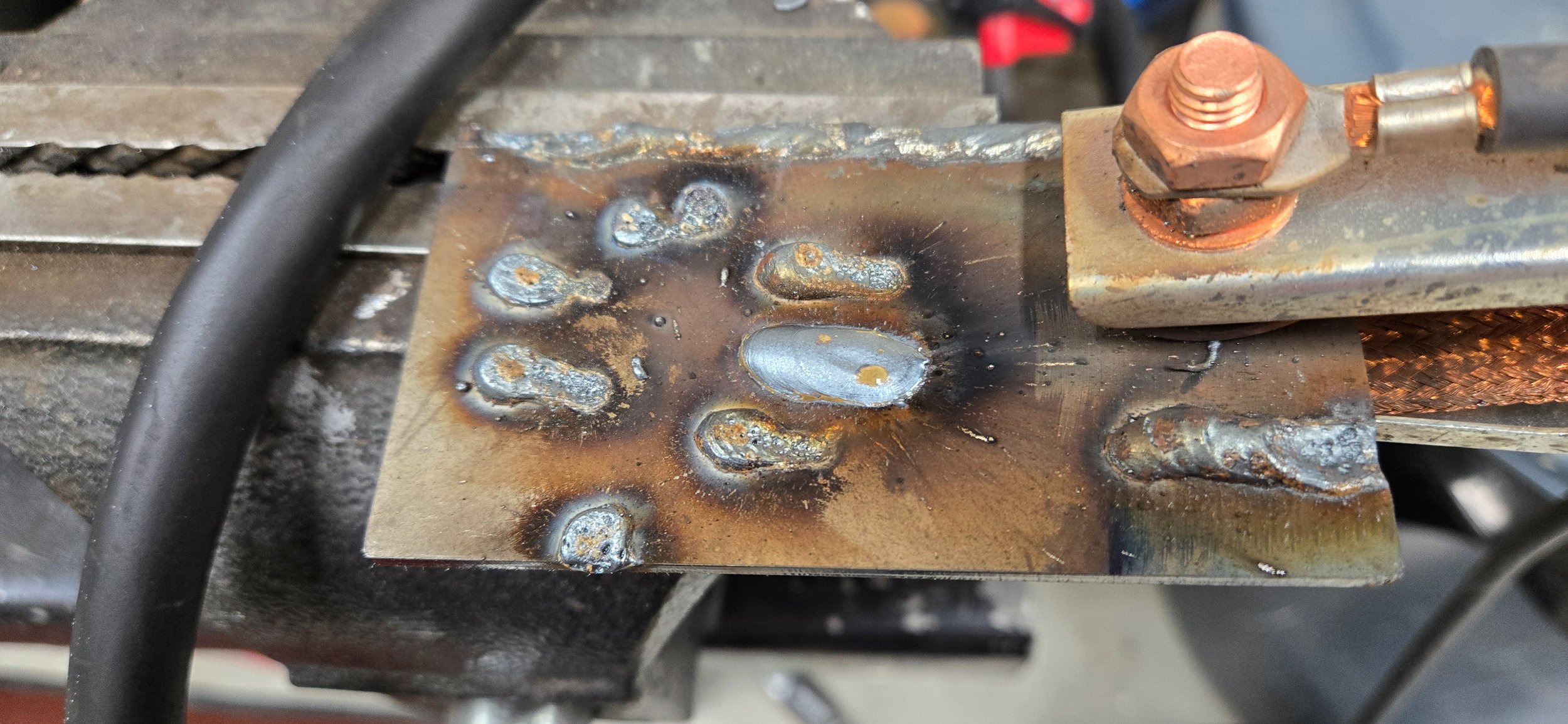

Blue flame means it's oxidizing somewhere. Check all your gas connections & hoses for leaks using soapy water in a spray bottle. Do you have a picture of the bad weld?
