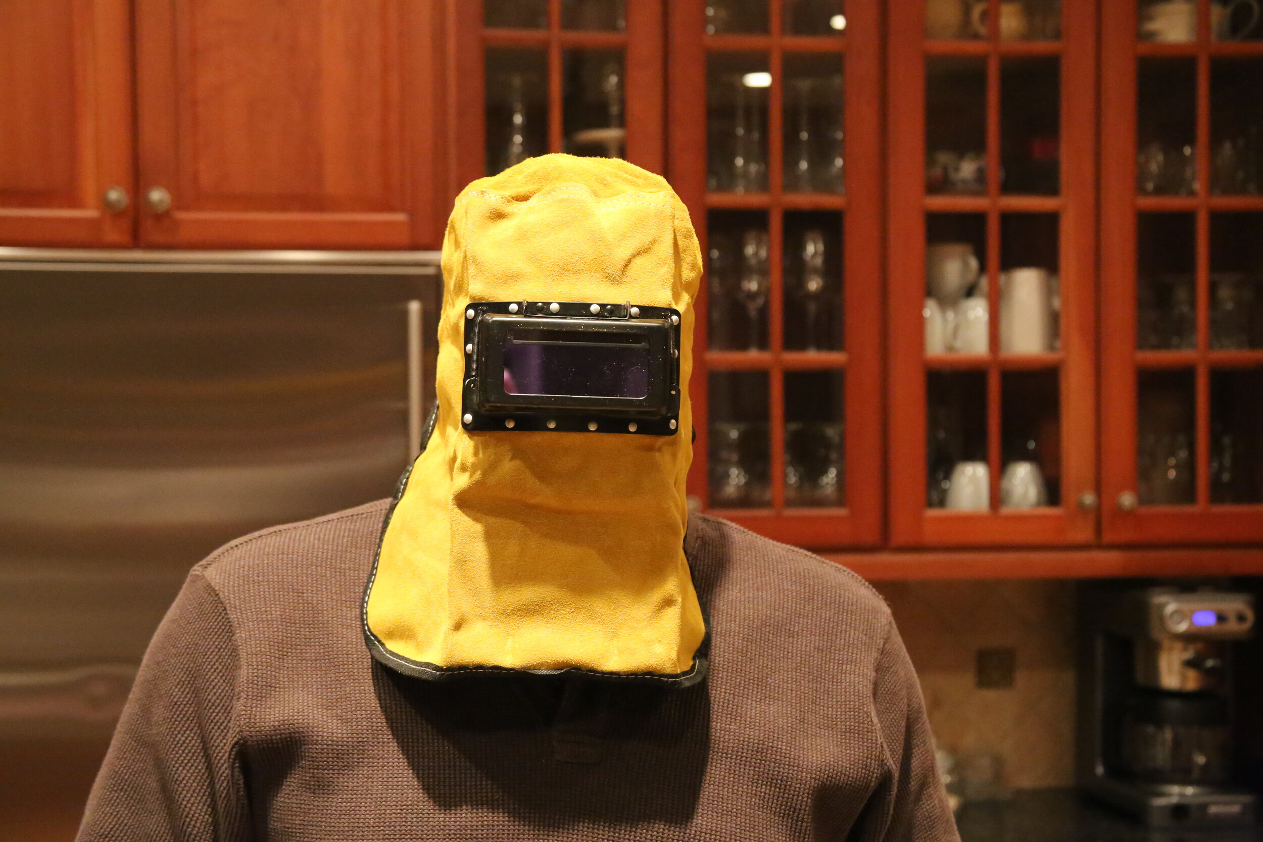

Also I ordered one of these to make welding under the Jeep easier so hopefully I'll have some feedback soon. Leather welding hood

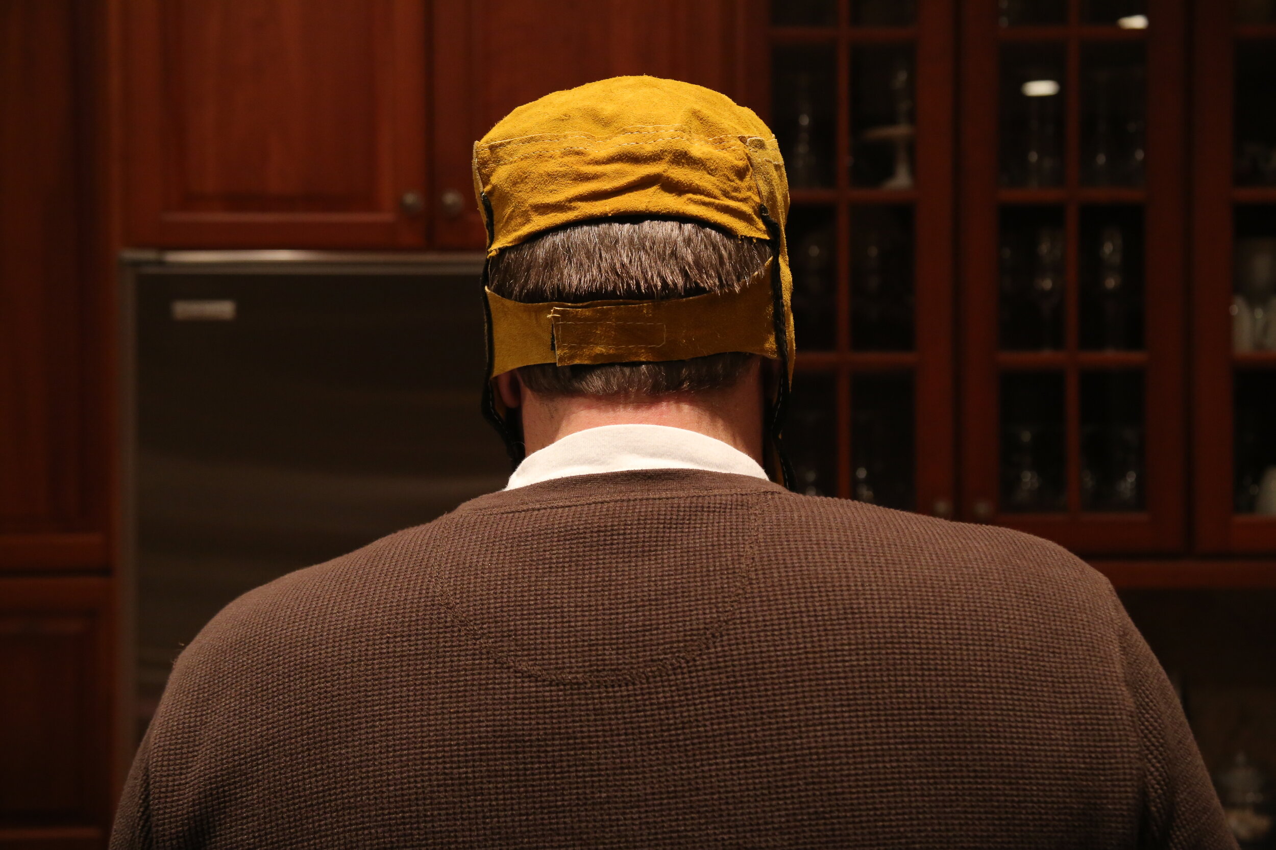

I carry a leather hood very similar to that one in the rig. Works very well on the trail, and takes up very little room when stored.
How does it secure to your head so that the lens doesn't move around?
There is a velcro strap which goes around the back. It’s also fairly snug on my big noggin, so it doesn’t move around much at all.

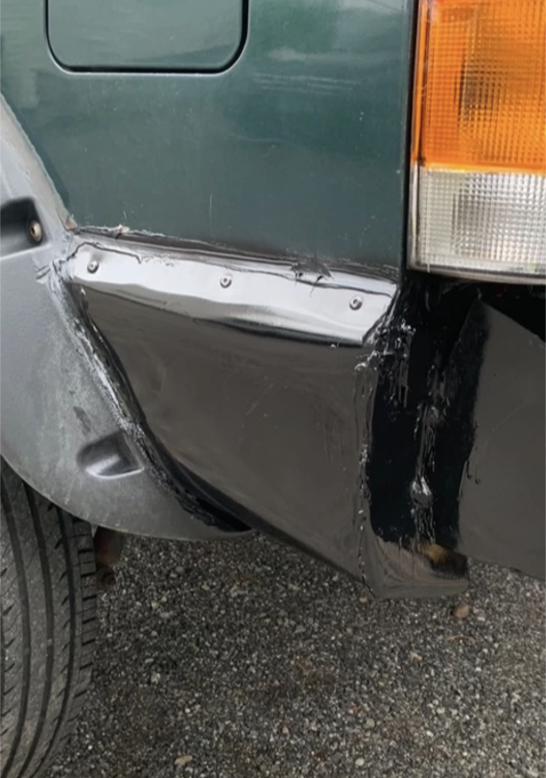

Eventually I’d like to take a class and learn how to weld, but I’m exploring hiring somebody local to get my rocker panels patched sooner than later.
Correct me if I’m wrong but in this guy’s auto repair pics, shouldn’t he be doing butt joints and a full seam? I’d think that overlapping the patch and just tack welding is a recipe for more rust.

In body repair at the restoration side, there are a couple of methods that are pretty well acknowledged as being correct. One is the fully welded butted ends, then flanged and plug welds.
However, I have never seen the overlap style like that guy does with the patches and just short welds at the overlap.
I suspect that is due to just getting a vehicle to pass some sort of inspection to get another year or two out of something that rust is going to kill anyway.
If you study how the TJ is put together, it is mostly flange and plug welds. If I was fighting a rust issue that required new rockers, I'm not sure which way I would pick other than not his.
Can one of our resident experts here explain how to use flange and plug welds in body repair? Im planning on welding butted patches for my body panel repair, but im curious about these other methods if they might be better. Looks like the Classic Enterprises panels come flanged, which might be beneficial if I use the whole piece. I’m here to learn! Thanks
I believe the flange serves as a support for the weld joint. It also provides a backing which can make welding it easier. This will help to prevent you from blowing through the sheet metal. The section you would cut out will be smaller than the patch piece with just enough opening for the raised portion of the new panel. This seam weld would be stronger but you would need to weld only portions at a time & take it slow to manage your heat input to minimize warping. As Mr.Blaine mentioned there's a plug weld method that essentially a hole in 1 piece but solid piece behind it. You just fill up the hole with weld & make sure you fuse the weld to both pieces.
Edit: I'm not familiar with plug welding body panels so I'm not sure which piece gets the hole. I'm assuming the existing panel. Keep in mind that plug welds or only welding on 1 side wont keep water from getting between the 2 panels. You should put some type of sealant there as well.
