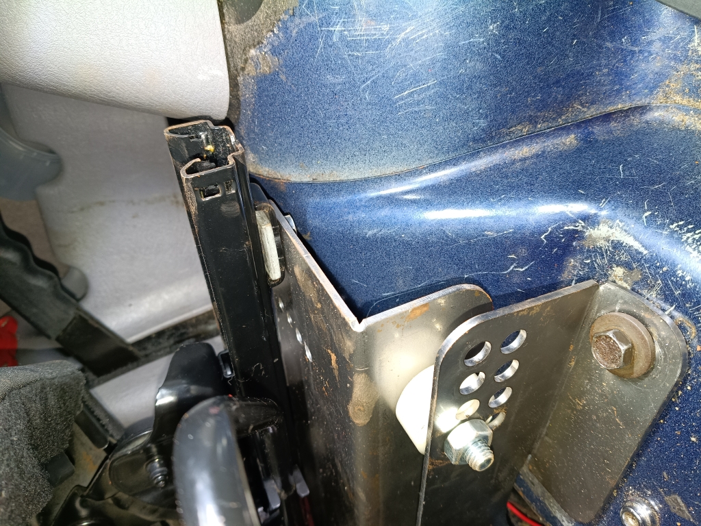

So just to be thorough - this is what I did yesterday with the pivot point at the front of the seats. First one show old pivot and new one with the nut to the left. Then as installed with the nut and the bolts I bought as I destroyed the stock ones getting them out. I moved the holes about 23mm down but I'd do 20 if I had to redo as I had to deal with some bumps in the metal that far down.

So here are some picks of them installed. Lowering the pivot point did help the feel. I might be able to reduce the spacer in the back but it seems ok still so I left as is. *edit* - I did swap them down to 1/2" as it seemed better.

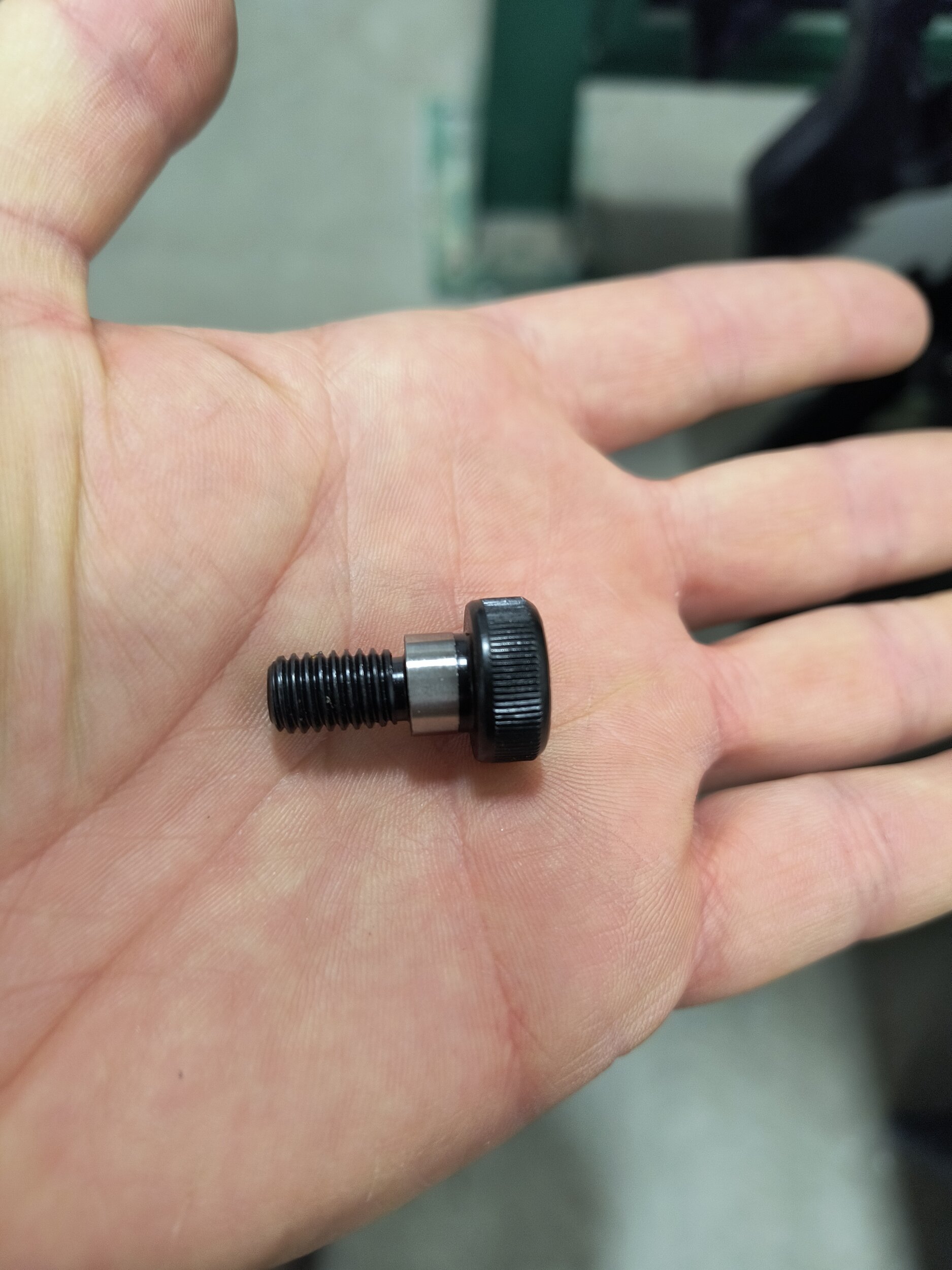

Also 92981A815 is the part # of the shoulder bolts from McMaster Carr.

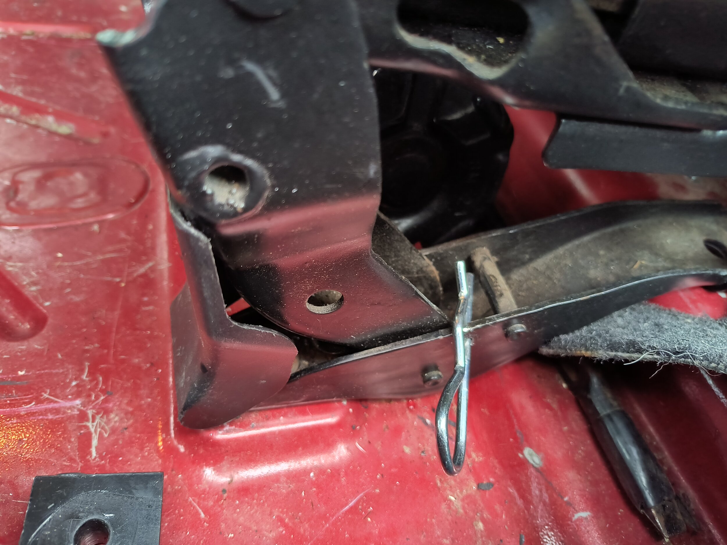

To protect my new future windshield I will need to add a stop to the tumble. The current stop is circled in red, new one would be where blue line is approx. Might do a cotter pin style so it can be removed as needed.

So here's what I did for the limiting. Just added a trailer hairpin. You need the full tumble to access the back bolts but if you carefully initiate the tumble and then relock the seat upright you can do the full tumble at the base without hitting the windshield.

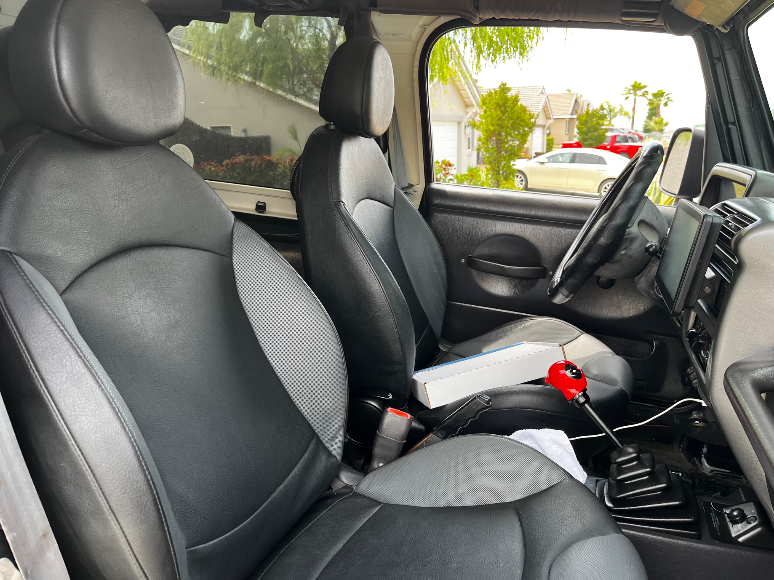

Sat in the jeep most of Saturday with 4wdbc run and they definitely keep you from moving as much but my back was still stiff. However my tailbone didn't get sore like the stock seats. Overall they're keepers.

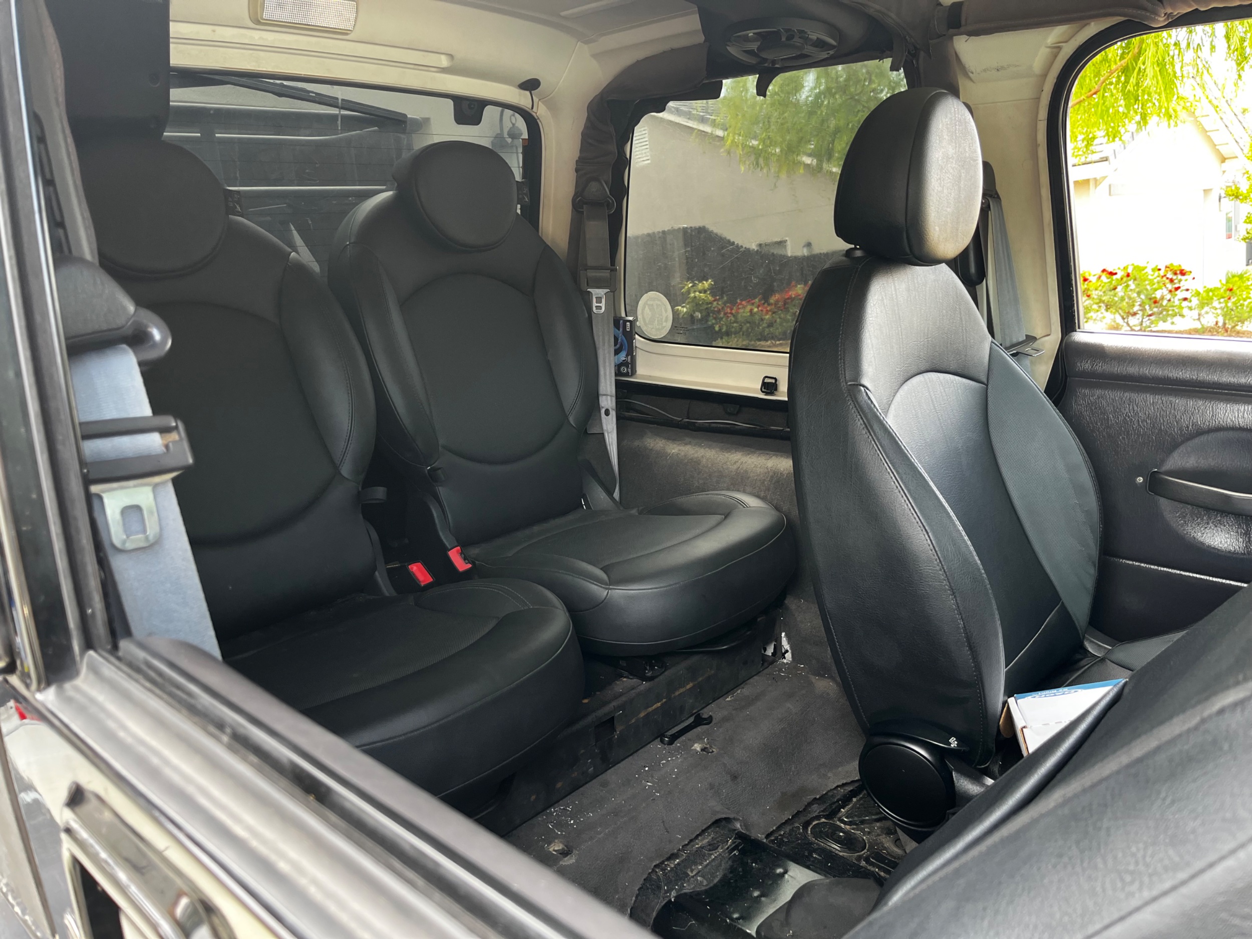

So got some 2012 cooper seats from a local yard.
We spend this Saturday testing things out.
Used some custom bracket to see how they fit and used the cooper sliders.
The cooper runners are spaced much more widely than ones on the original jeep seats.

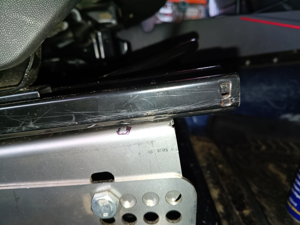

The custom brackets I used are pitched with the front higher that the rear. The Mini seats and sliders are designed to mount directly to the floor, so the extra height and pitch aren't ideal. Passenger side is fine since they don't have to manipulate pedals, but the driver's position is awkward but it works with my 6'2" height. I would love to find a way to mount them properly level.
I mounted the Jeep seat belt receivers between the slider and bracket in a position relative to the seating, but it won't move when the seat is adjusted. It's just fine as long as you ensure that where you mount it ensures the lap belt stays as a lap belt and not a thigh belt or a waist belt no matter the seat position.

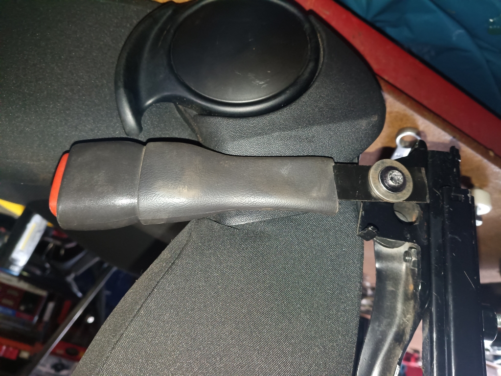

Did not use the mini cooper seat belts but removed the mini cooper seat belt buckle latch and shorten de original jeep buckle and attached it to seats. Grinned the mini cooper seats a bit at the front, lowers the angle a bit, not much room to lower further, the transmission tunnel is in the way.
