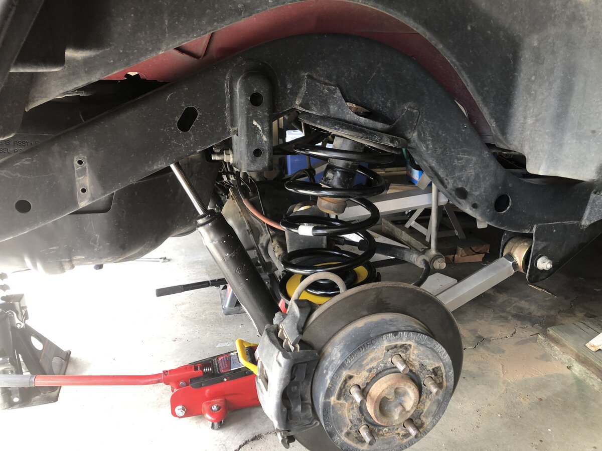

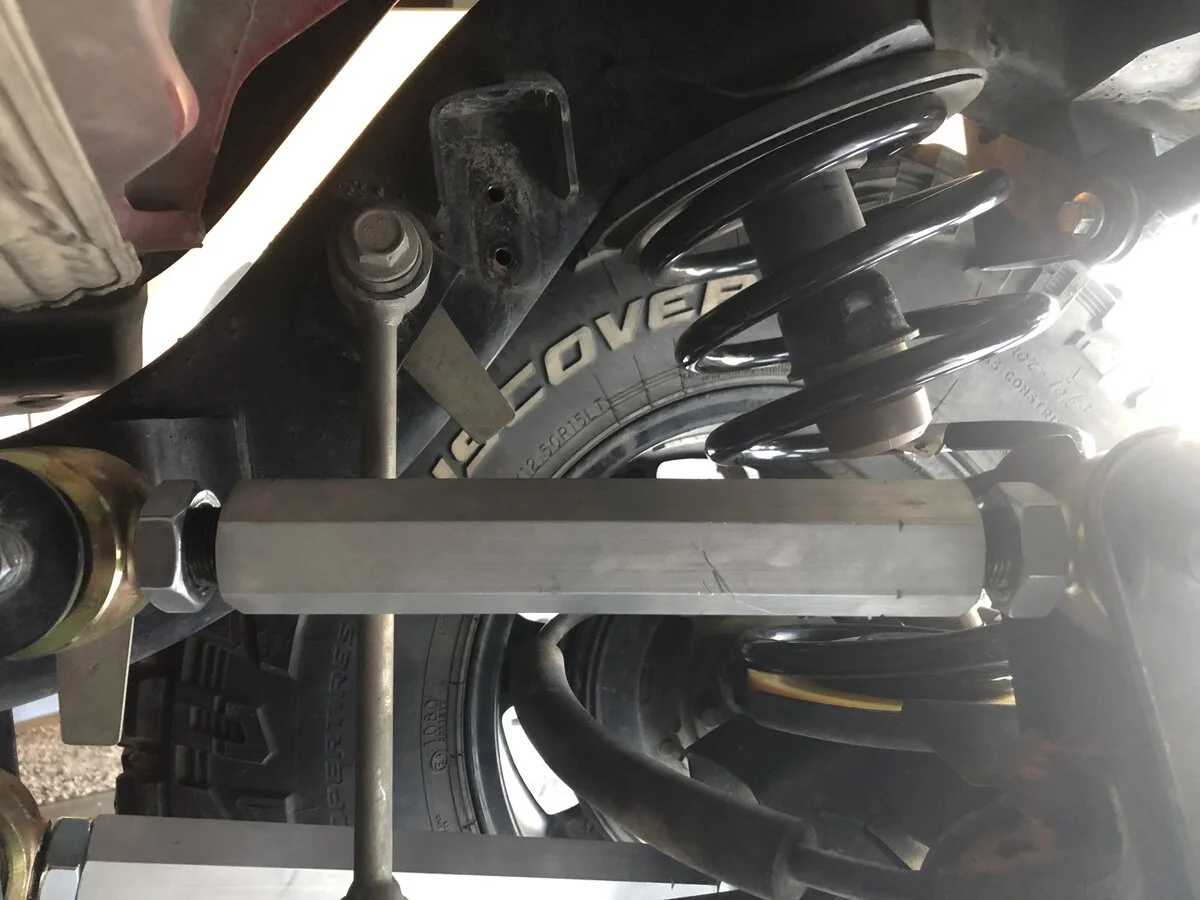

I'm assuming the axle is pulled forward in the wheel well? Hard to tell from the pictures. What does the top control arm look like (in terms of adjustments)?
Here’s where the lowers and uppers are
Lower
Upper

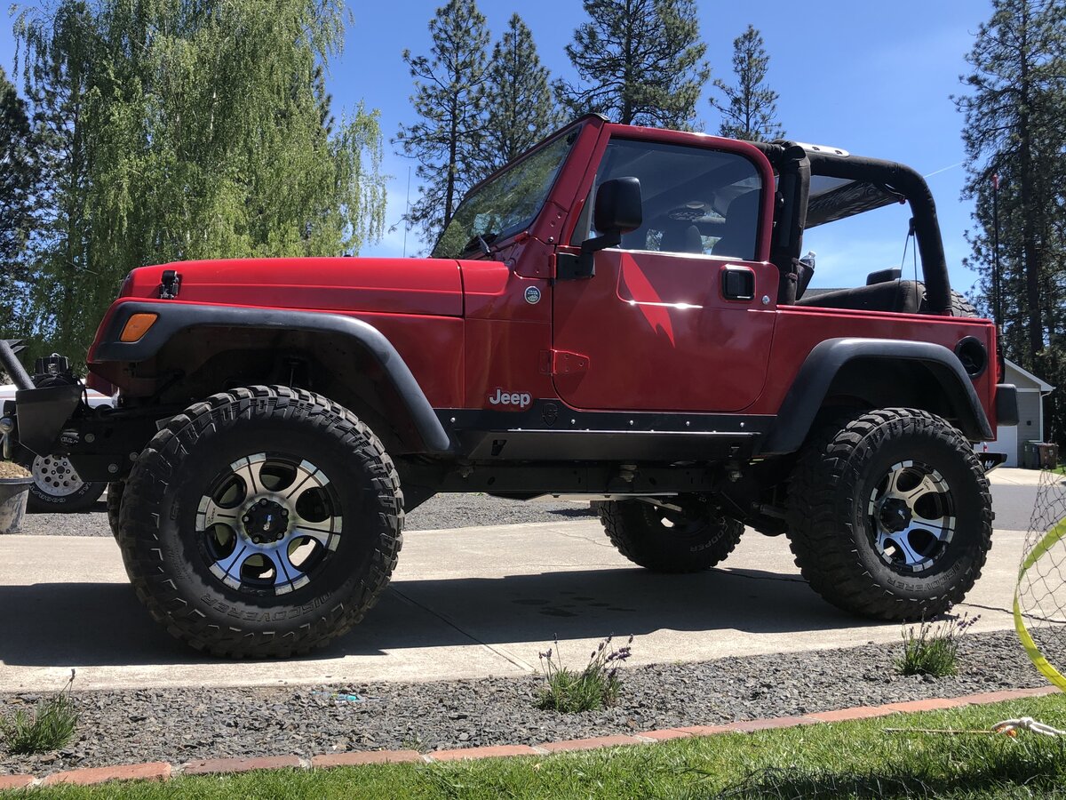

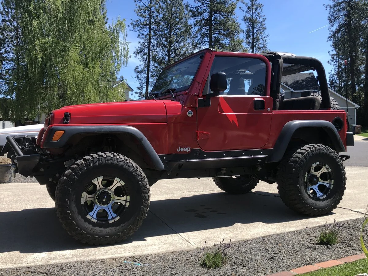

Took her for a drive. No vibes up to ~70mph. Less vibes at idle. Smoother shifting with my console moved back to stock position. Really nothing to complain about other than the rear trackbar situation.
18 pinion/20 driveshaft
Did I say I was tired?
Need to take the rig in for exhaust work, fix the trackbar situation and I’ll be done. Right now I’m just driving with the crossmember
I went back and tried to re-read but still didn't see anything. I might be blind, and this is a dumb question: What is wrong with the rear track bar?

It’s crashing into the front of the gas tank skid and before I get to full bump for the other components it hits the crossmember. 🙄

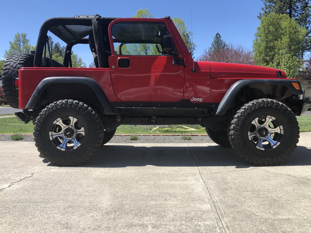

A strange anomaly is I gained at least 0.75” rear suspension lift. I’m not too happy about this, it puts me at almost 3.5”. My front is at 3”, so I have a rake. I’ll work it out though.
Here’s how she sits now. 16.25” at the center on flat ground. 18” at the frame. My 33 MT‘s are 25,000 miles in, so I’ll need some new before Moab 2020.
