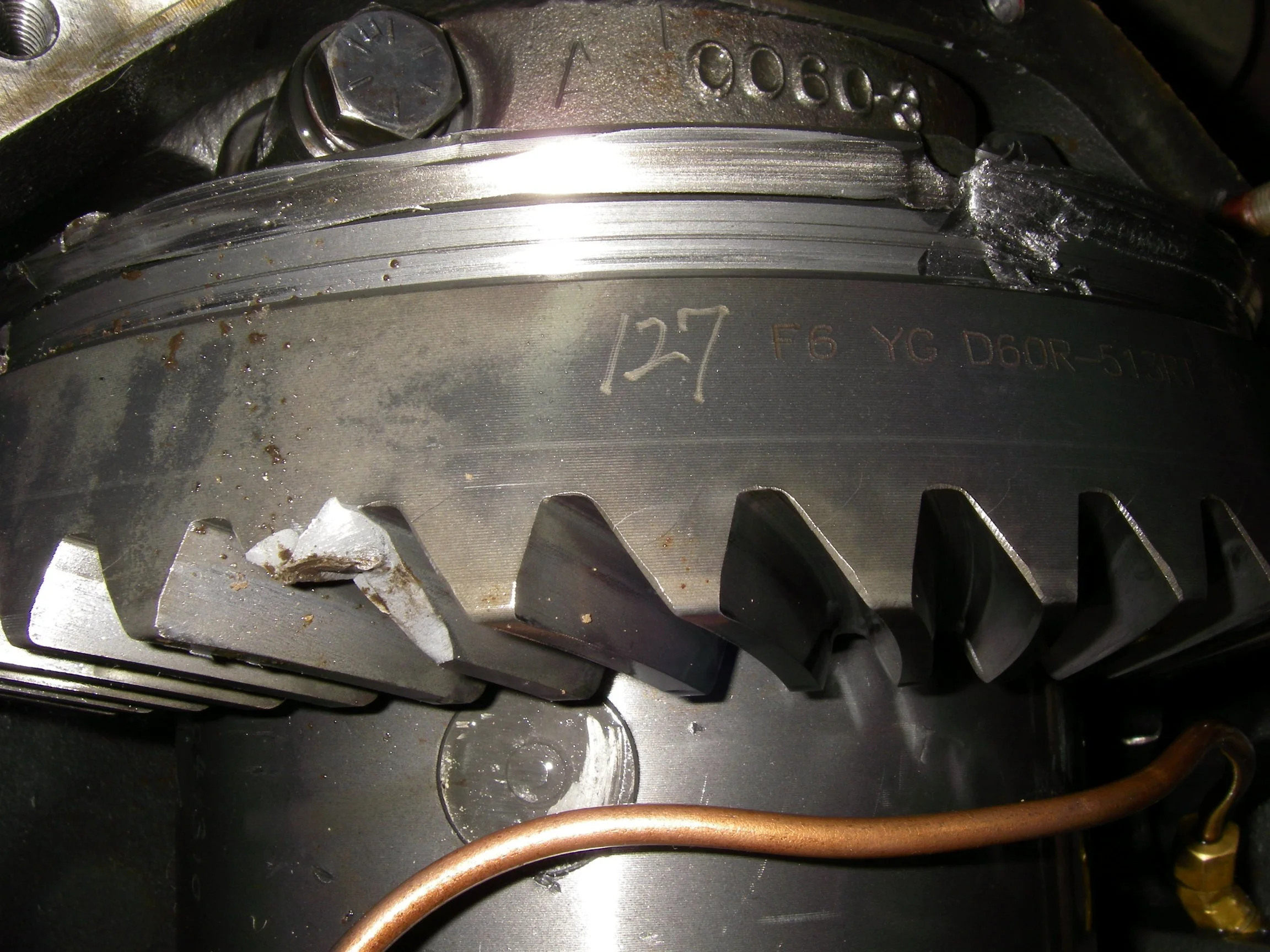

I think it should help some.. From what I know about how stuff works it's ring gear deflection that is causing the damage.
If you look at how the teeth on my ring gear broke that seems to prove it.
This was the setup pattern from the last set that broke & I only had maybe 2K miles if that on it. But I only broke the pinion teeth too.
