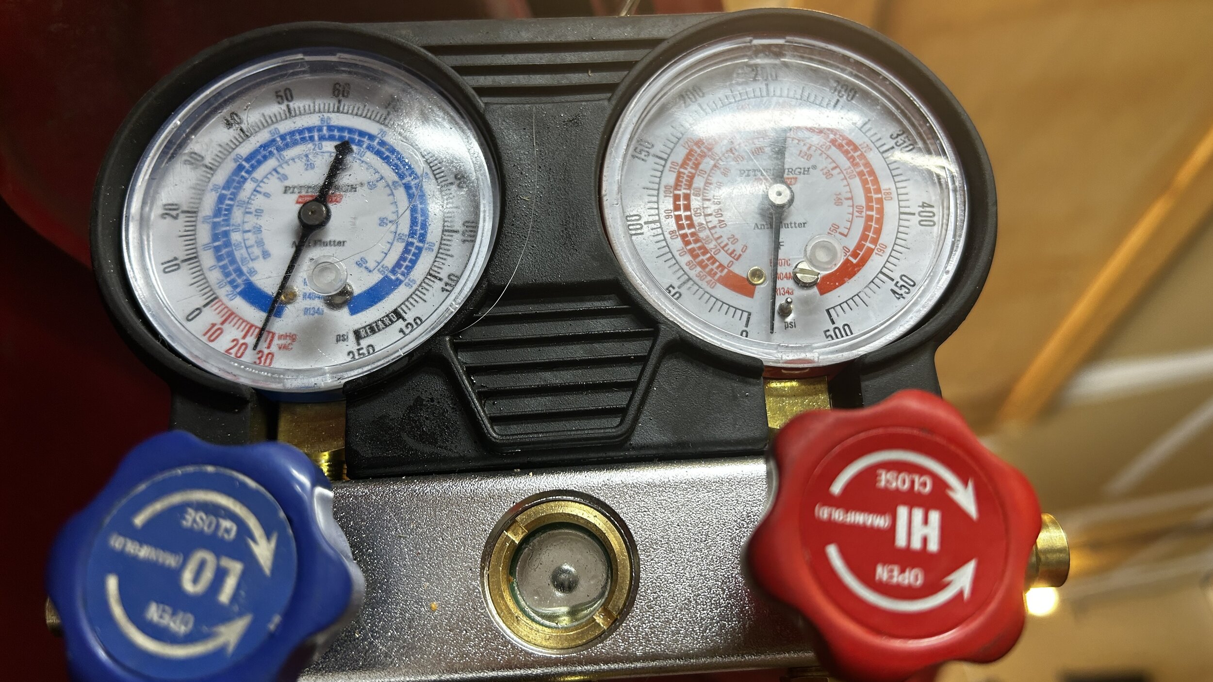

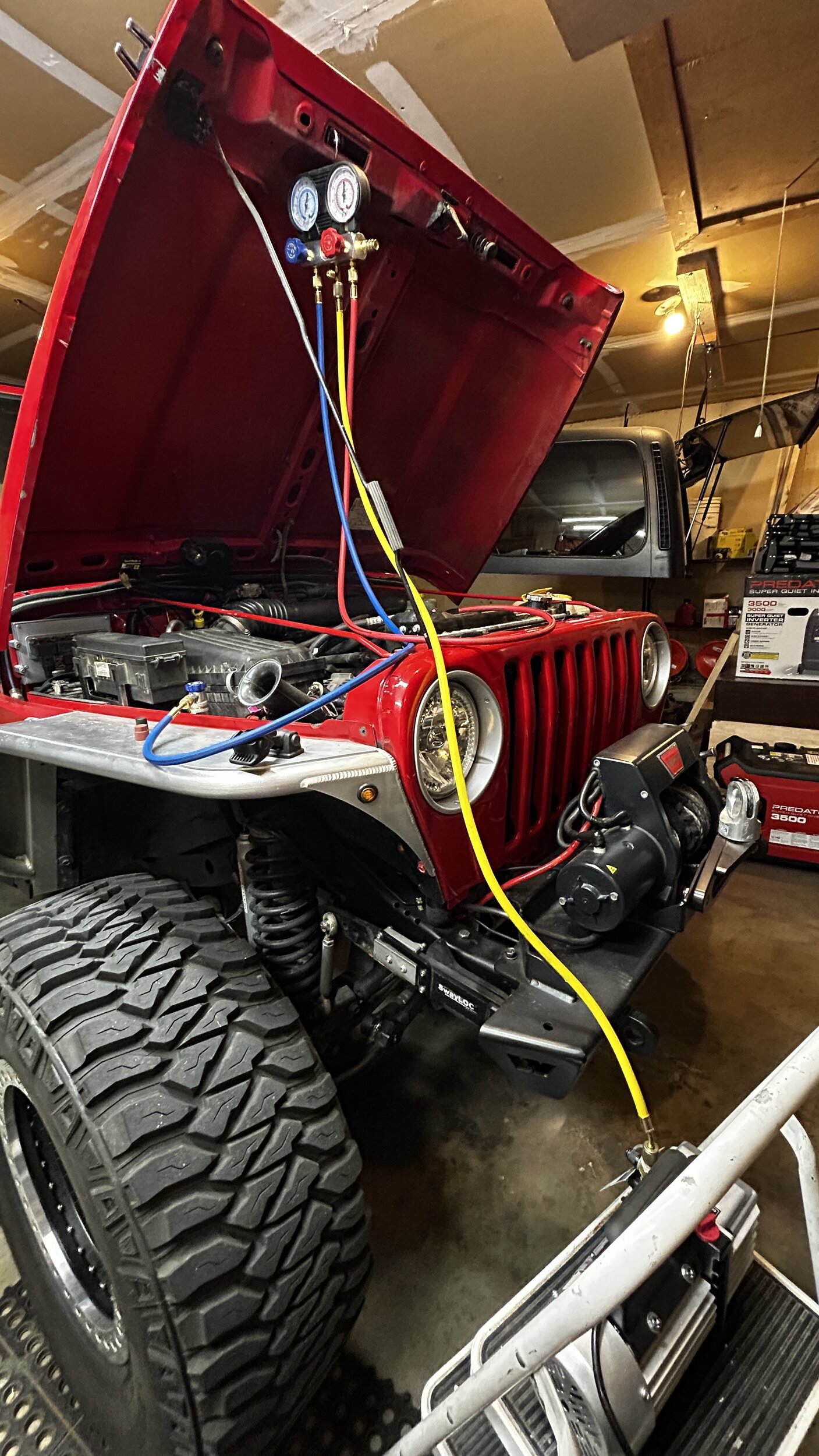

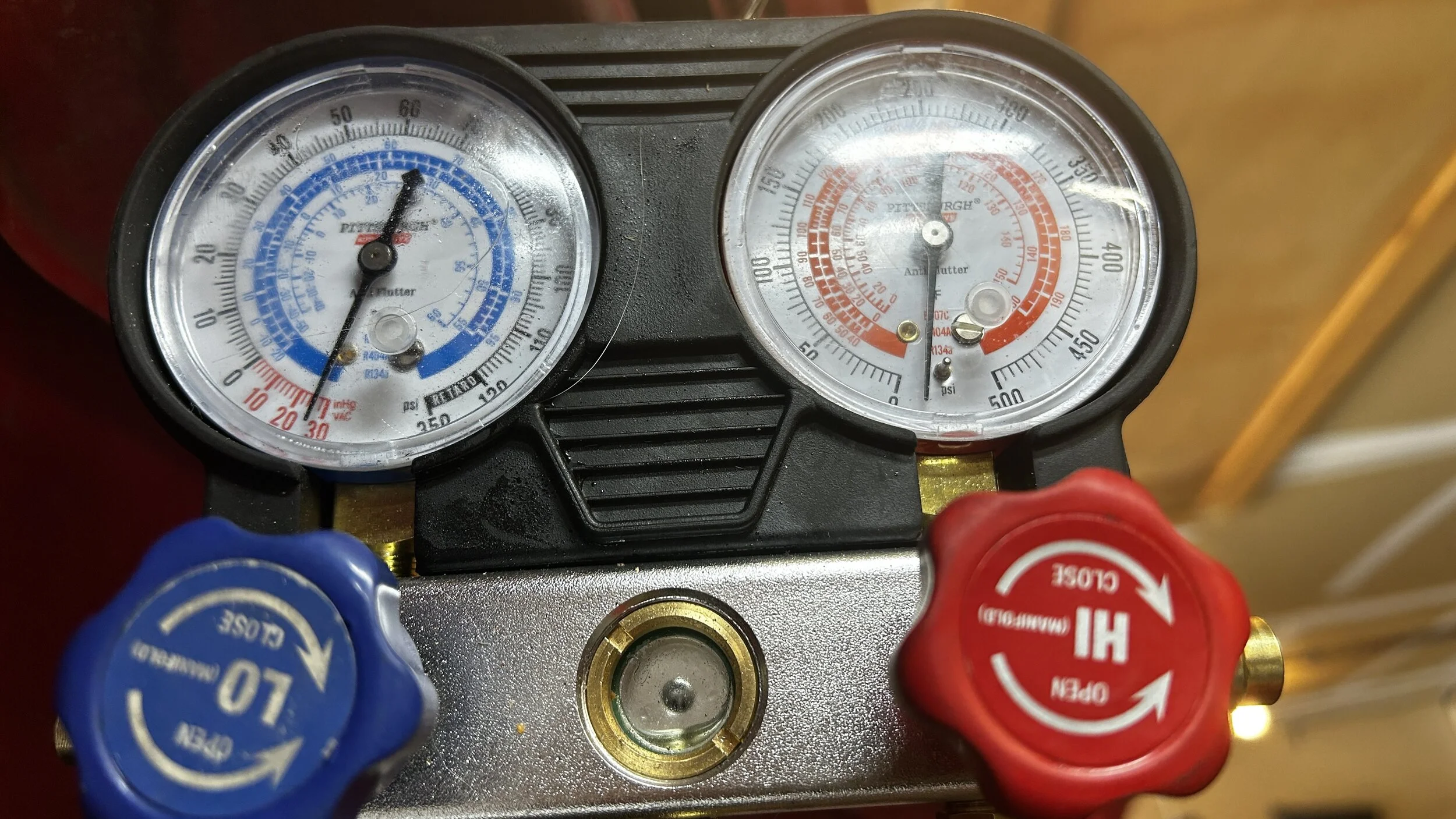

Pulling vacuum on the AC. I haven’t had AC since I bought the rig when I lived in TX in Dec 2016. I had a mechanic claim to fix it in 2018. I had cold air for 3 days and it cost me $600. Soon after we moved to WA. I don’t need AC except for about a month out of the year, and even then the top is off, but I want everything working.
Before the auto swap I had the system evacuated and during the swap I installed a new evap in the HVAC box. I also went through some of the system and replaced seals and valves. I’m just now getting to seeing if it will hold a vacuum. I’m keeping it under vacuum for two hours because the system was open for a few weeks. If it holds I’ll add some PAG 46 and then my refrigerant and we’ll see what happens.

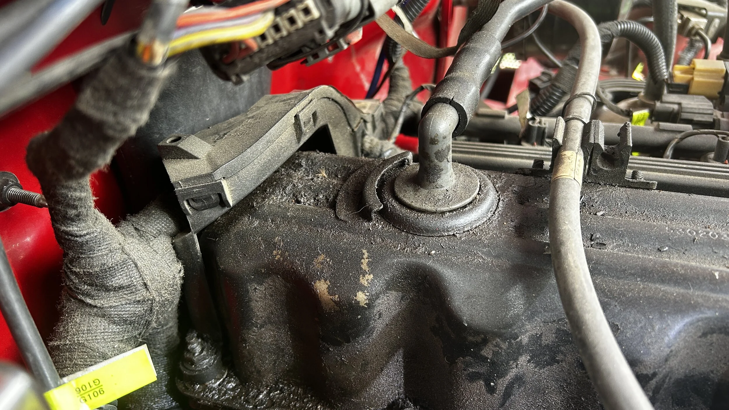

When I did the auto swap I also did the RMS and a new oil pan and gasket. With the transmission out it made access easier. I didn’t have any leaks initially. After three weeks I noted a drop. I thought my RMS may have failed. Then I noted that the CCV valve cover was pretty gunked up around the CCV gasket, so I cleaned it all up and replaced it. That’s the second time I’ve replaced it IIRC. The first time was pretty early in TJ ownership.I hope this solves it.
What gauges and pump do you use? I’ve been thinking about getting some, but don’t really know enough about it to know what I want. LOL
Make sure you fill it to the system spec. Overfilling isn't a good thing.
Check the pump by the clutch for oil stains. Any oil at joints indicates a leak. When doing o rings or other connections use the compressor oil as lube and sealant.
You really ought to replace the accumulator/drier if the system has been open or had a leak that let out all the refrigerant.
I replaced several seals and used compressor oil. I did not replace the drier. I’m onto this $200 plus the $600 6 years ago.

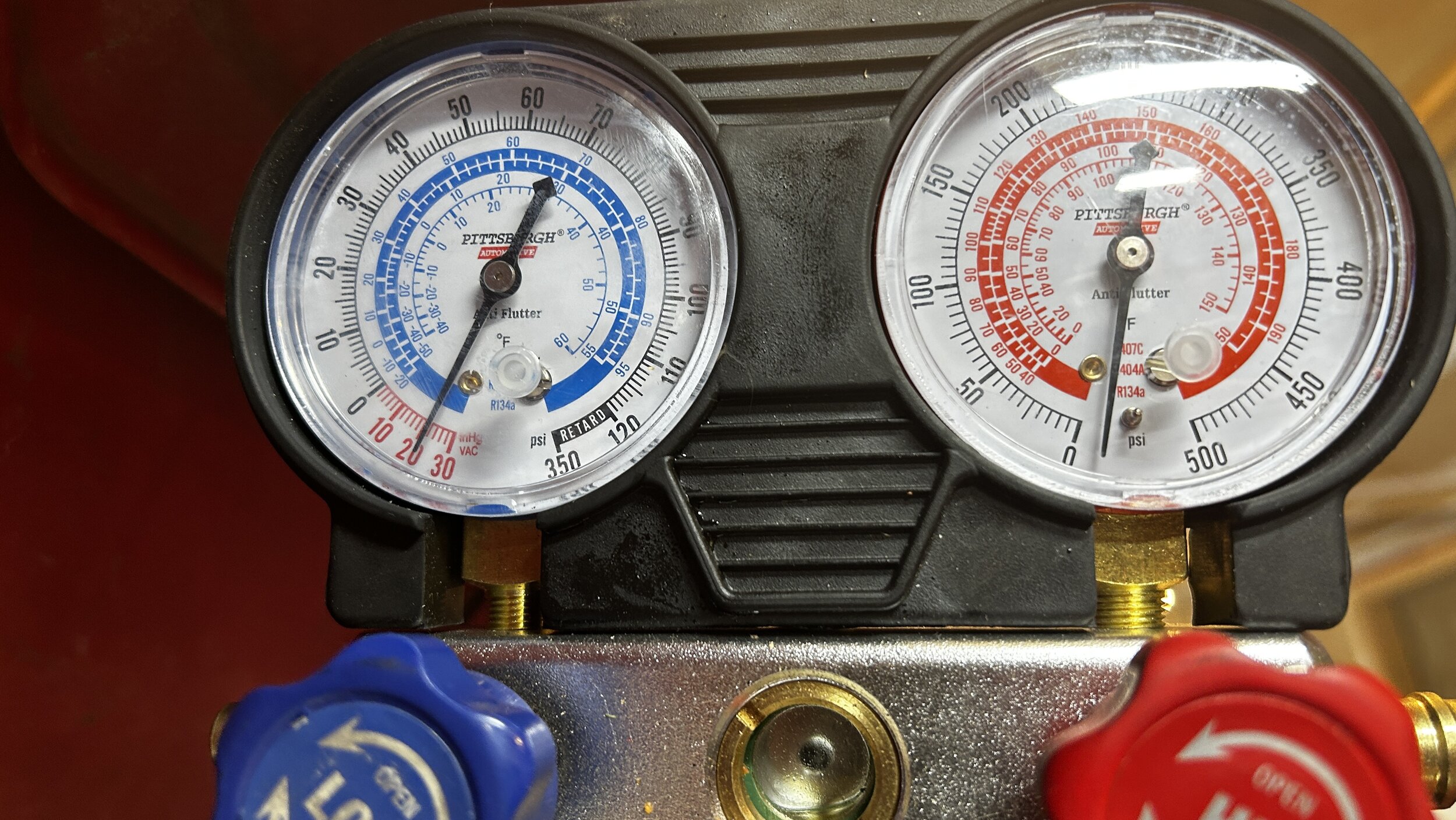

I’m tired of messing with this. I vacuumed the system for 2.5 hours. After that I left it for1 hour and the low pressure port gauge went up from -29 to -21. I’ve got a leak.
It’s all Pittsburgh stuff, so HF.
Did you already replace your schrader valves for the service ports? That’s a common leak point
Yes, I replaced all the Schrader valves.

I might as well just send you my valves since my system has a leak anyway. So annoying. At least it’s only summer for 1 month here.
Do the vacuum check first and see if it holds. No use filling just ”to see.”

Ran a vacuum hold test once before when the compressor went on my wife's prior WK. Already had a set of the HF gauges. Grabbed the HF vacuum pump then. For these once-in-a while efforts, the HF tools worked well.

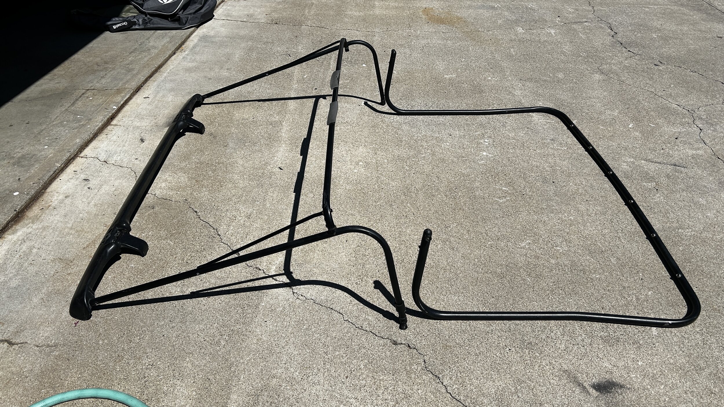

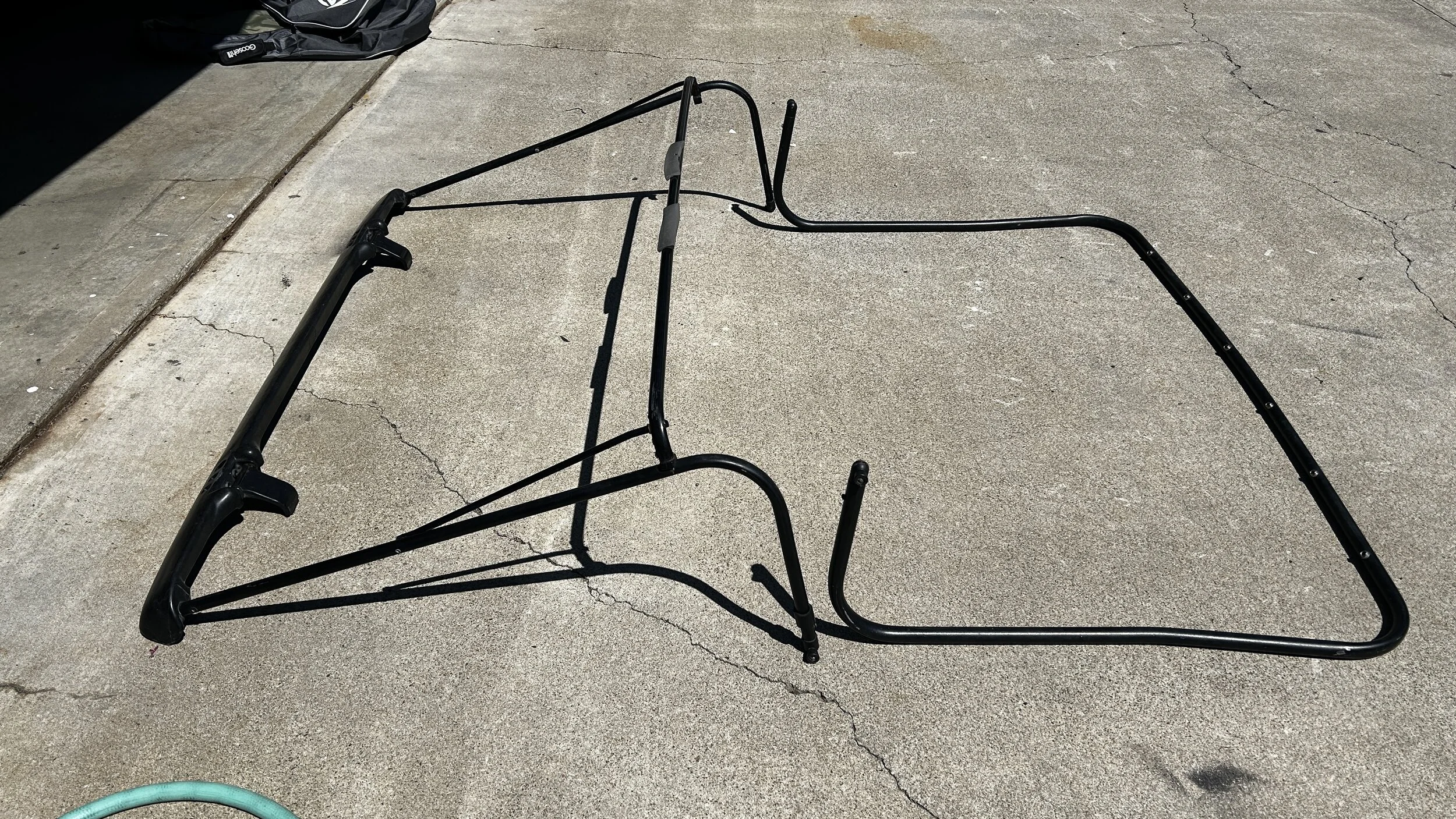

Found a Soft Top Frame. He was giving it away. I was second in line. Tried to get it. Offered $25. He said the first guy planned to get it the day before but didn’t and now was waiting. Later he said, it’s not worth $25, but $10 would be nice. So now I have a frame. Just need the top now!
Are you getting a new fabric top or going to get used?
