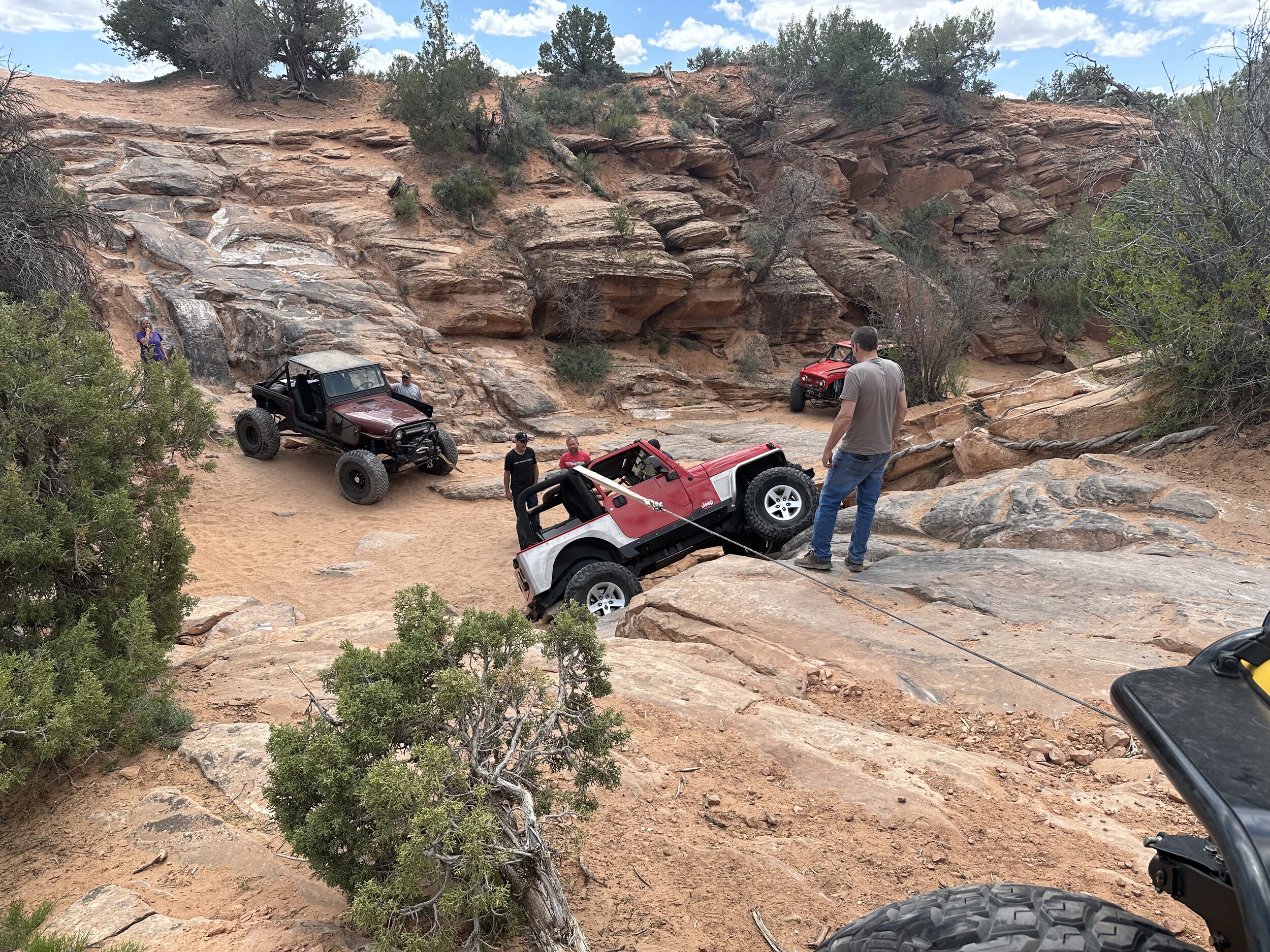

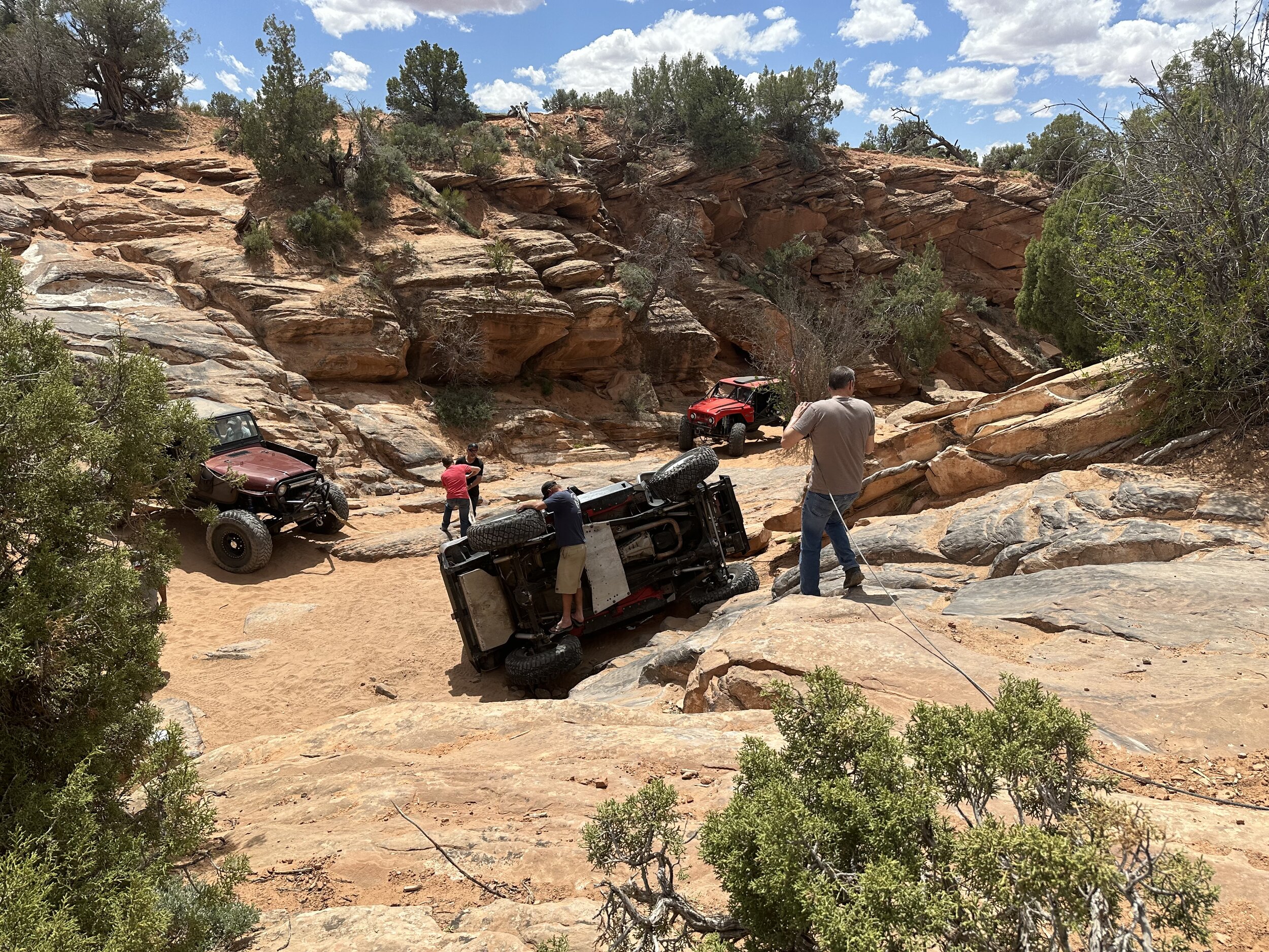

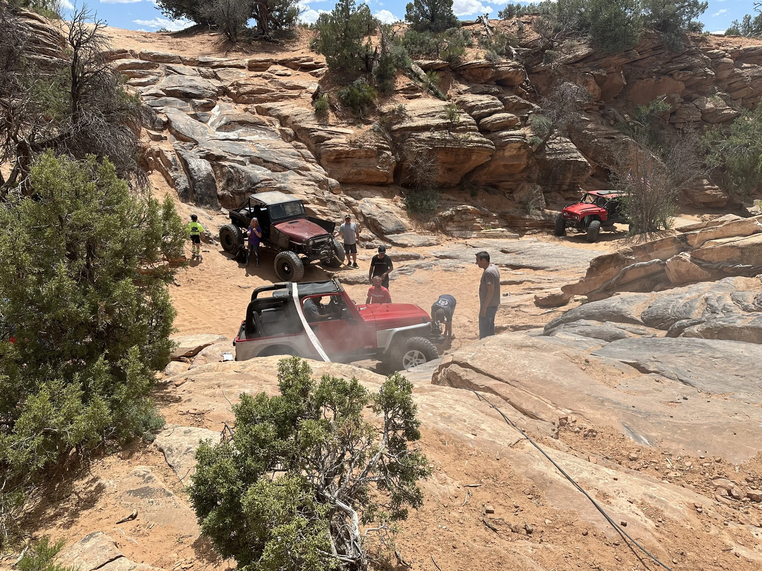

Meh, you can do a lot on the rocks with 2.5"+1.25", 33's, stock gears, and your TCase shovel! I did it, and I think a guy named @lBasket did a whole lot of stuff in Moab on a pretty much stock rig!
You can do 90% of the trails here in the PNW on 33" tires and 35" tires just make them a little easier. Of course if you add the length of a LJ to the mix you'll be making 3-5 point turns where with a TJ it's a 2 point turn.

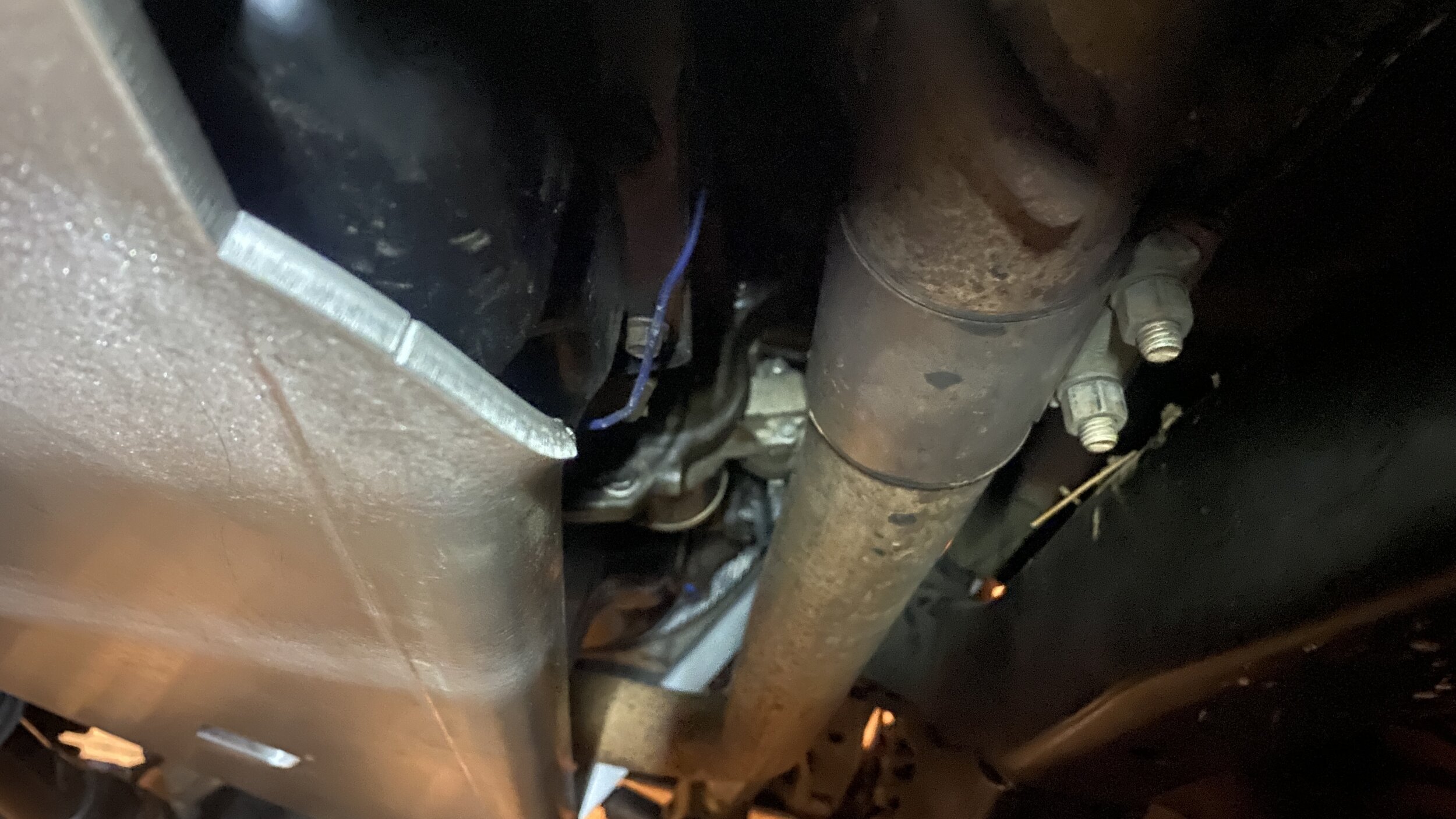

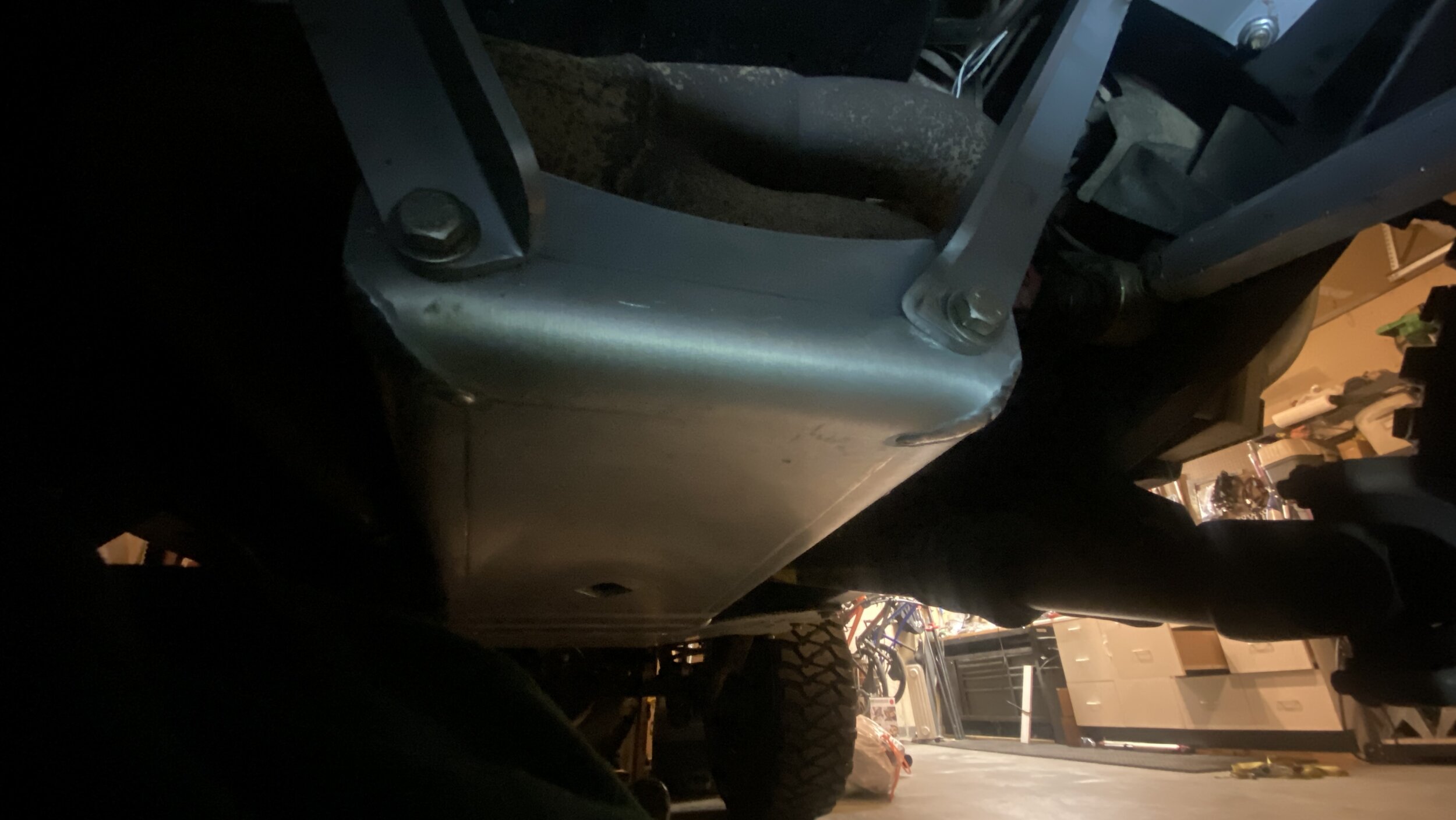

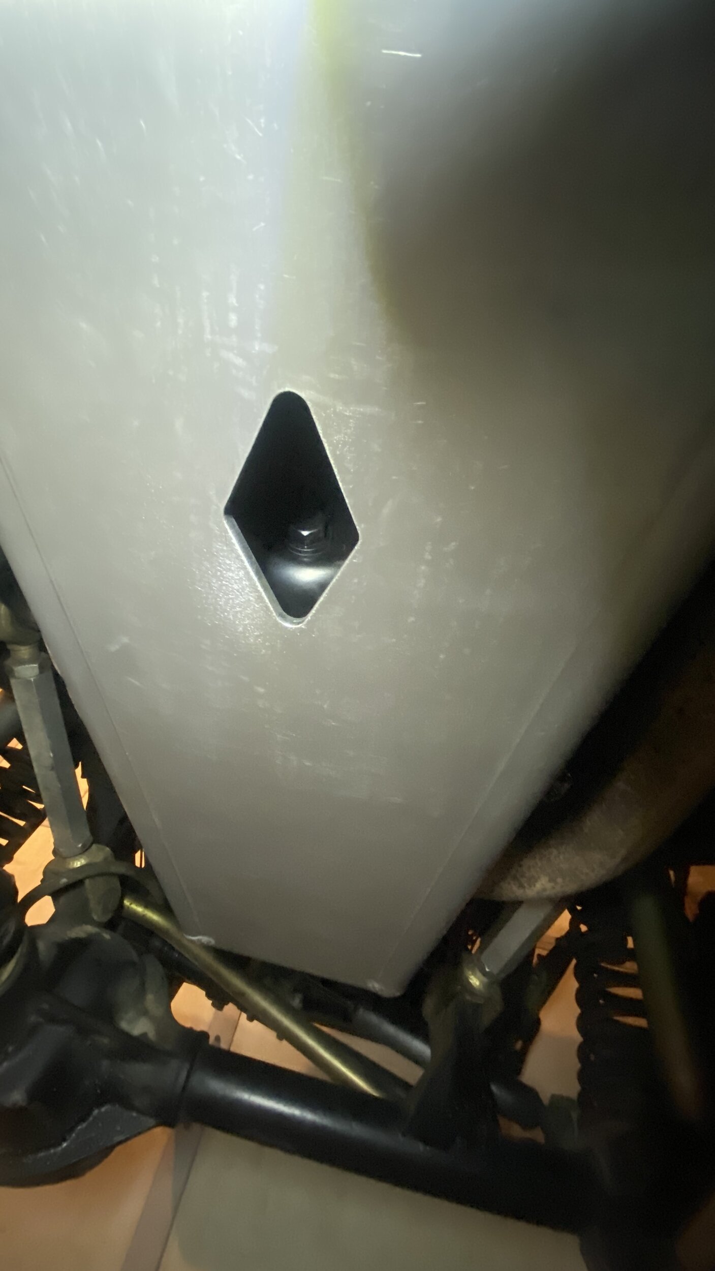

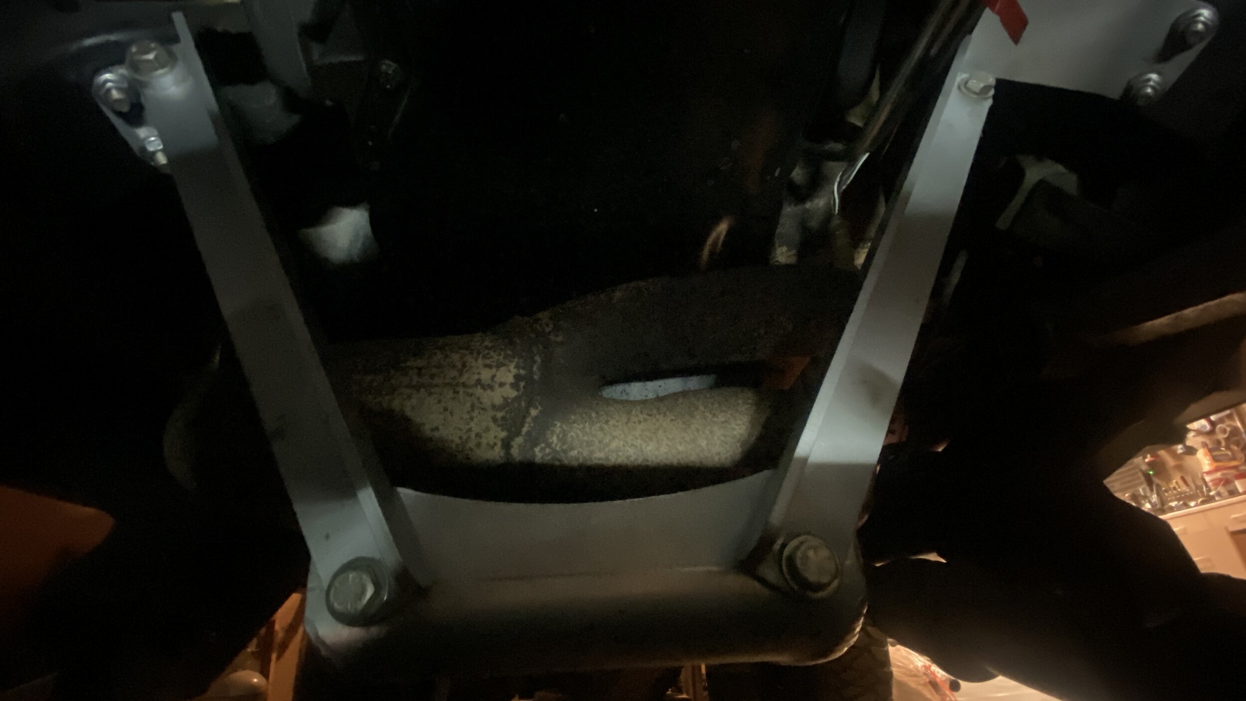

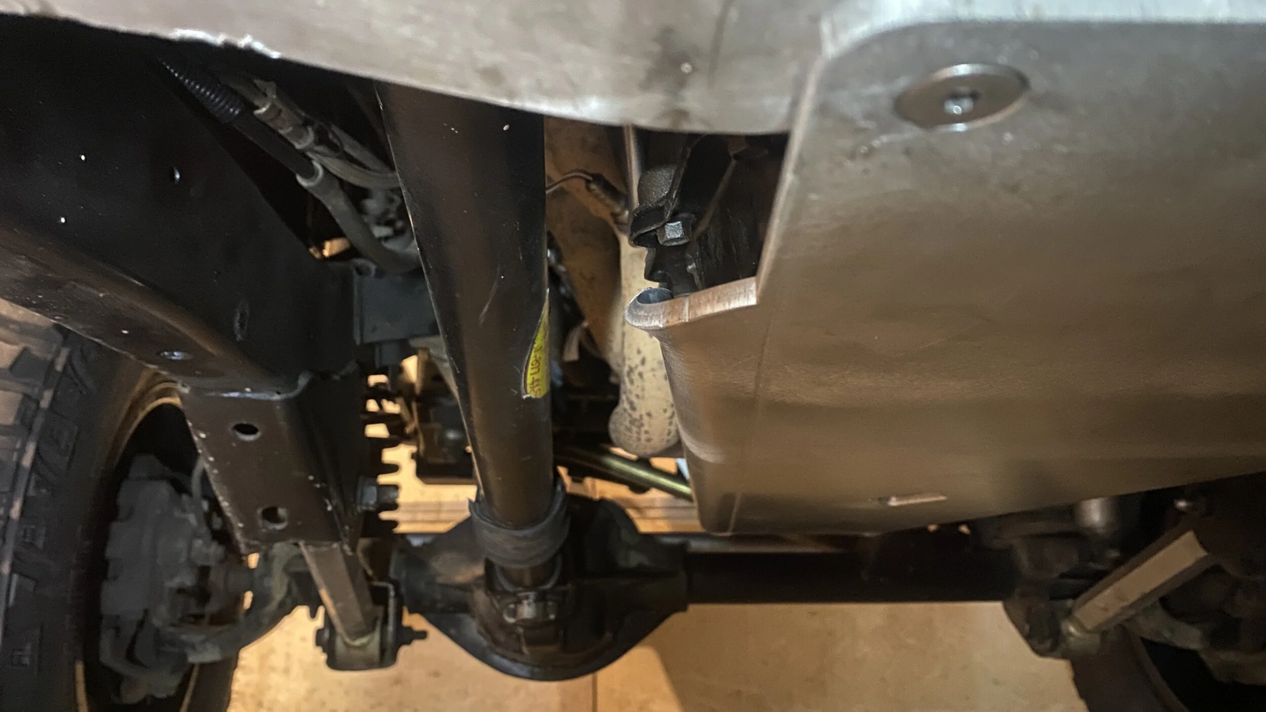

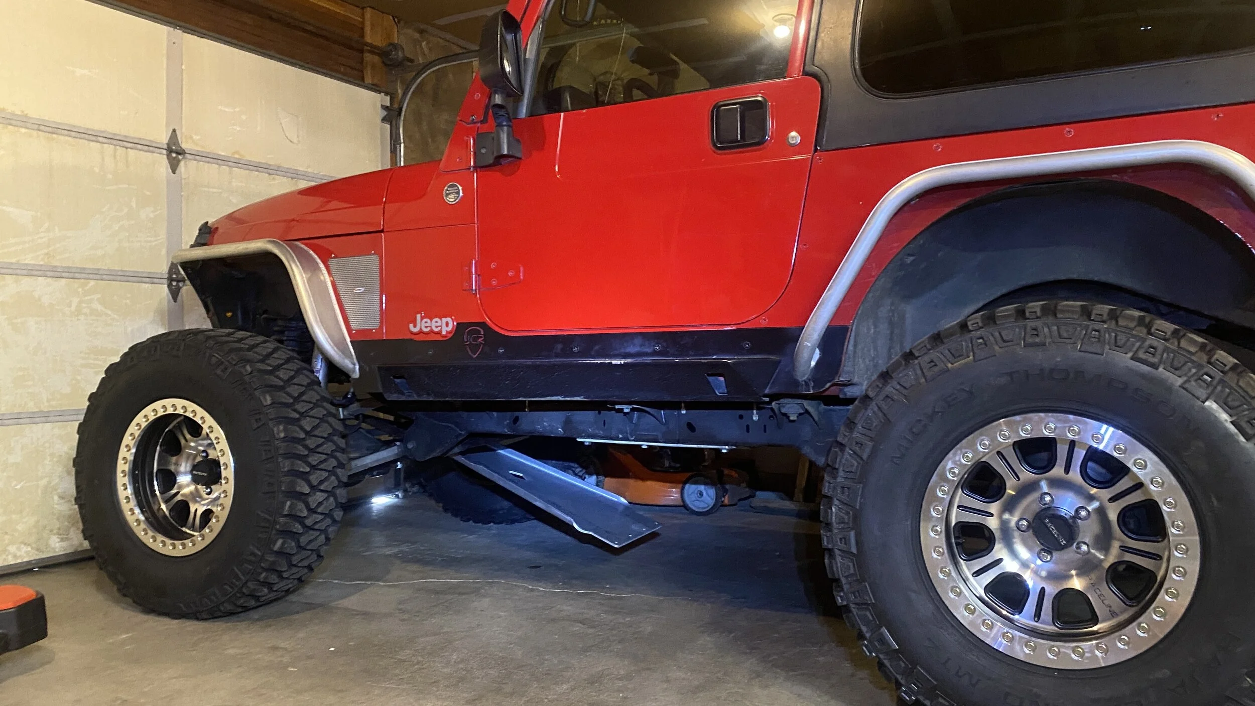

Back home last night so I finished up the Savvy Engine Skid this morning. The main thing is to position the skid where you cover the transmission pan entirely and yet leave enough clearance for the front driveshaft. You can bend the struts to get the front back positioning so you have enough overhang to attach to the TCase skid. Where it ends up is where it ends up relative to the oil drain plug.
The struts look better with the two angled portions inboard. I was able to use the lower front holes on the skid to position it as high as possible. I had no interference with the exhaust pipes as some have. Excepting fitment trials, leave all the bolts loose till you’re done and then tighten them all down. It makes things easier. I used a spot weld cutter for the 4 holes needed to mate the engine skid to the TCase skid. Savvy forgot to send those 4 bolts and nuts, so I temporarily am using some Allen head countersinks I had. I much prefer #4 Philips. It’s nice to finally have the transmission and oil pan protected.
Trying to get a decent pic of the front, but a little hard to do.
Driveshaft clearance is the same for the transmission pan as it is for the skid.
The exhaust side looks good too.
Drain plug easily visible and accessible. I’ll be getting a quick drain system.

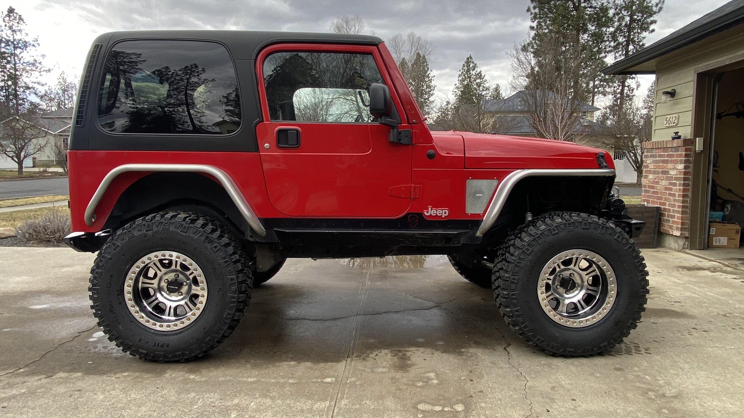

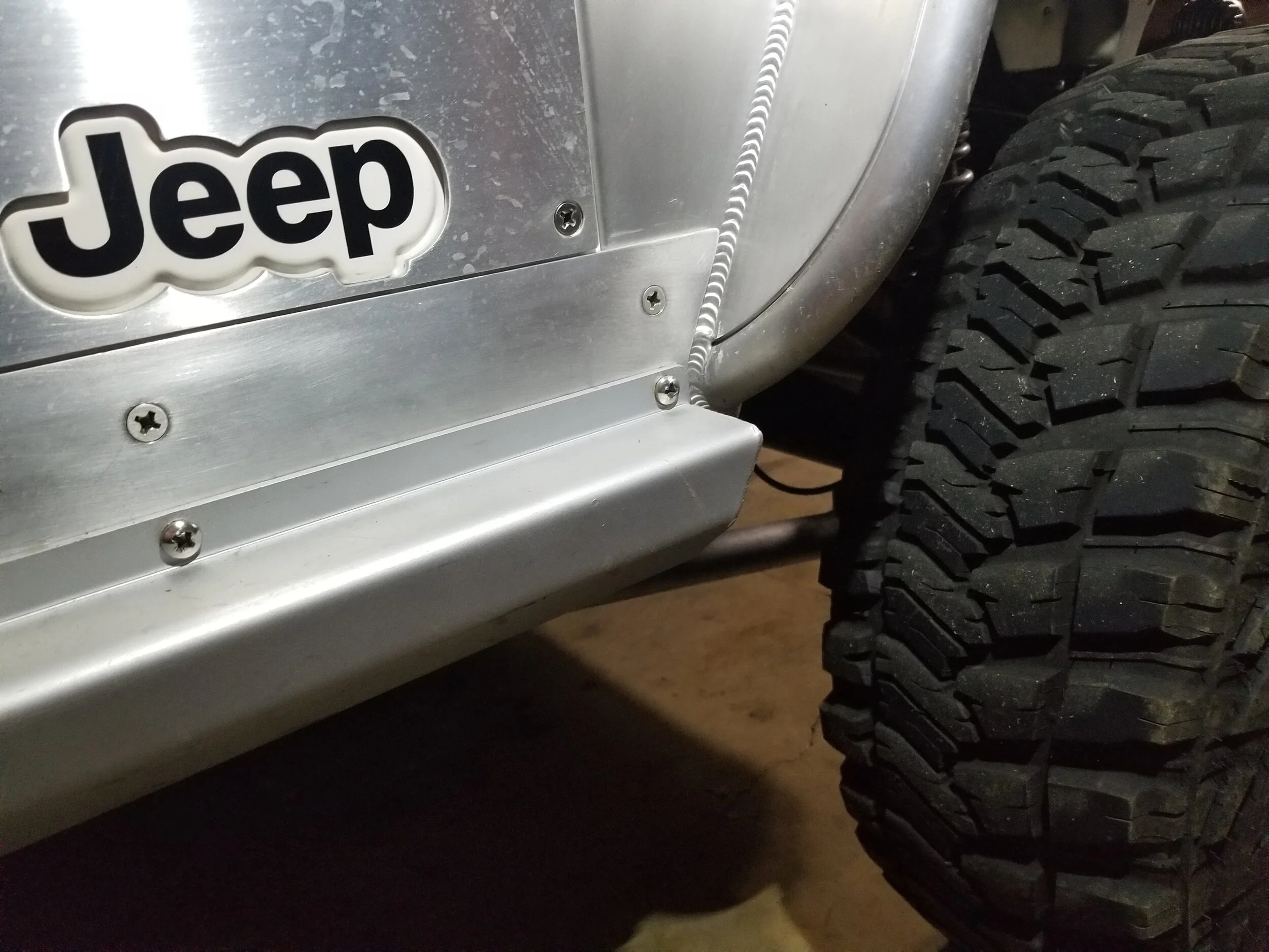

I’m planning to remove the rock sliders (again), cut the top of the backing plaste flat across the top, fill the JCR logo in with weld, and paint it aluminum color to tie in with the GR fenders. I think it will improve the look, but I’m open to opposition.
Sounds like a lot of work just to change the color of that part of the jeep that gets most of the abuse on the trail. Your bumpers are black, so it ties in to that part of the jeep just fine. If you paint them aluminum, it might be tougher to touch up than black.
Just the backing plate. The slider itself will stay black. It is kinda a bunch of work for no functional advantage. Just aesthetics.
Reactions: PNW_LJ and Wildman
I don’t see being able to really match the aluminum with paint. But I do wonder what it would look like with a red color matched backing plate
Reactions: JMT and tworley
I thought about color matched red too, and I thought, then I'd have to buy the paint and clear and go through all the paint gun stuff and cleanup. Arghhh.
I've got an aluminum color match paint, so I thought that would be easier. It may not look that great, but I've always been attracted to the red with silver accents rather than red with black.
If you need a project, you can surely find something more beneficial that all that.
Yeah, I agree. I'm still working on renovating our laundry room, and I'll post up that project when I finish. I'm in a lull right now on that one. I am dreading grouting the tile on the wall.

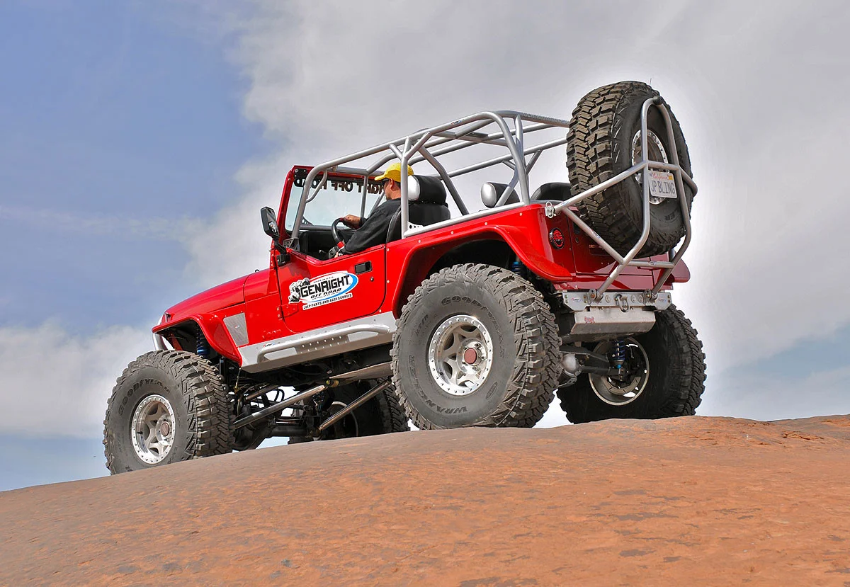

I always kinda liked this paint scheme on the GR YJ, but it is a little different with the color matched fenders/flares.
