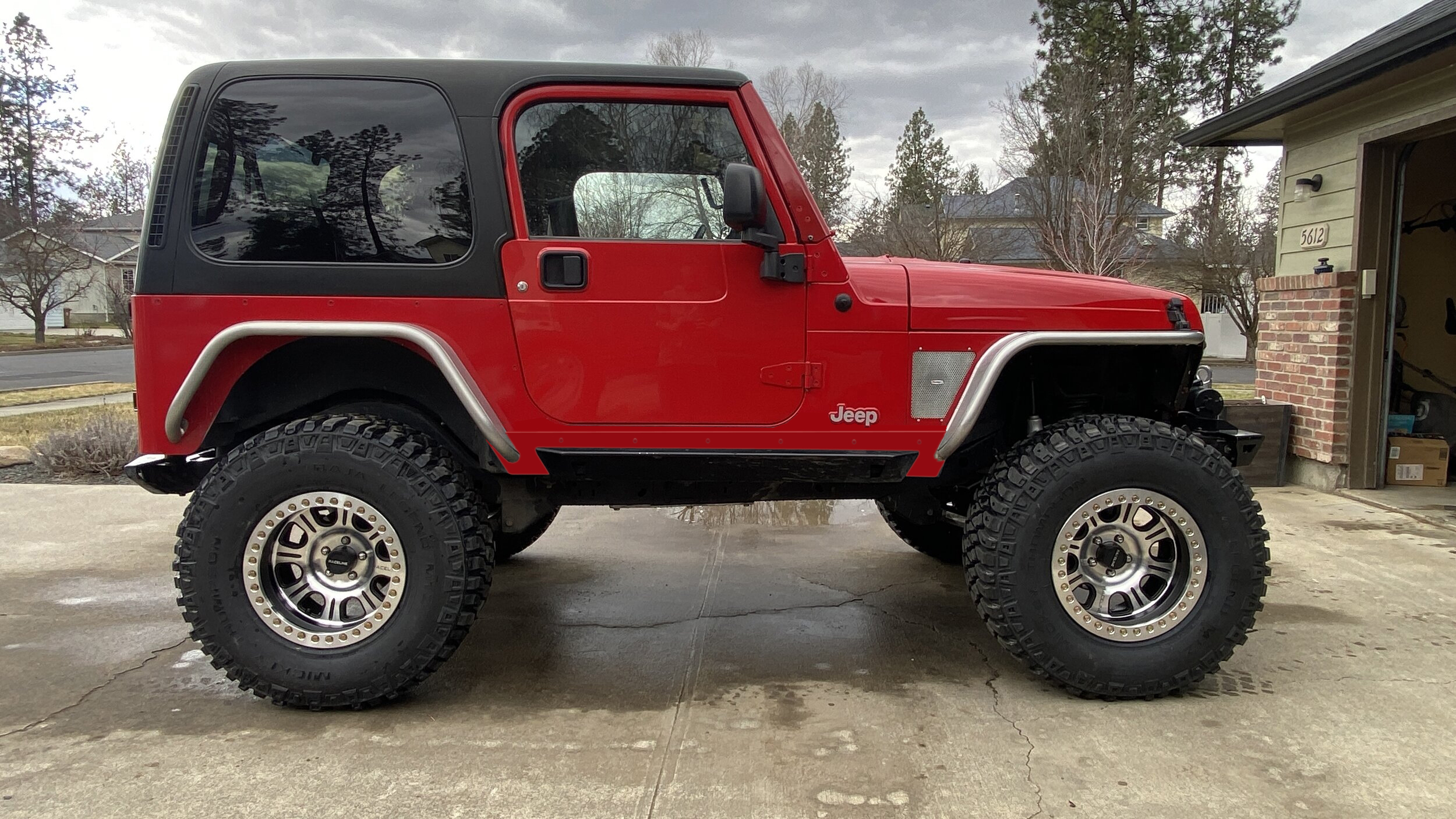

I'd lean towards body color myself, if not leaving it black

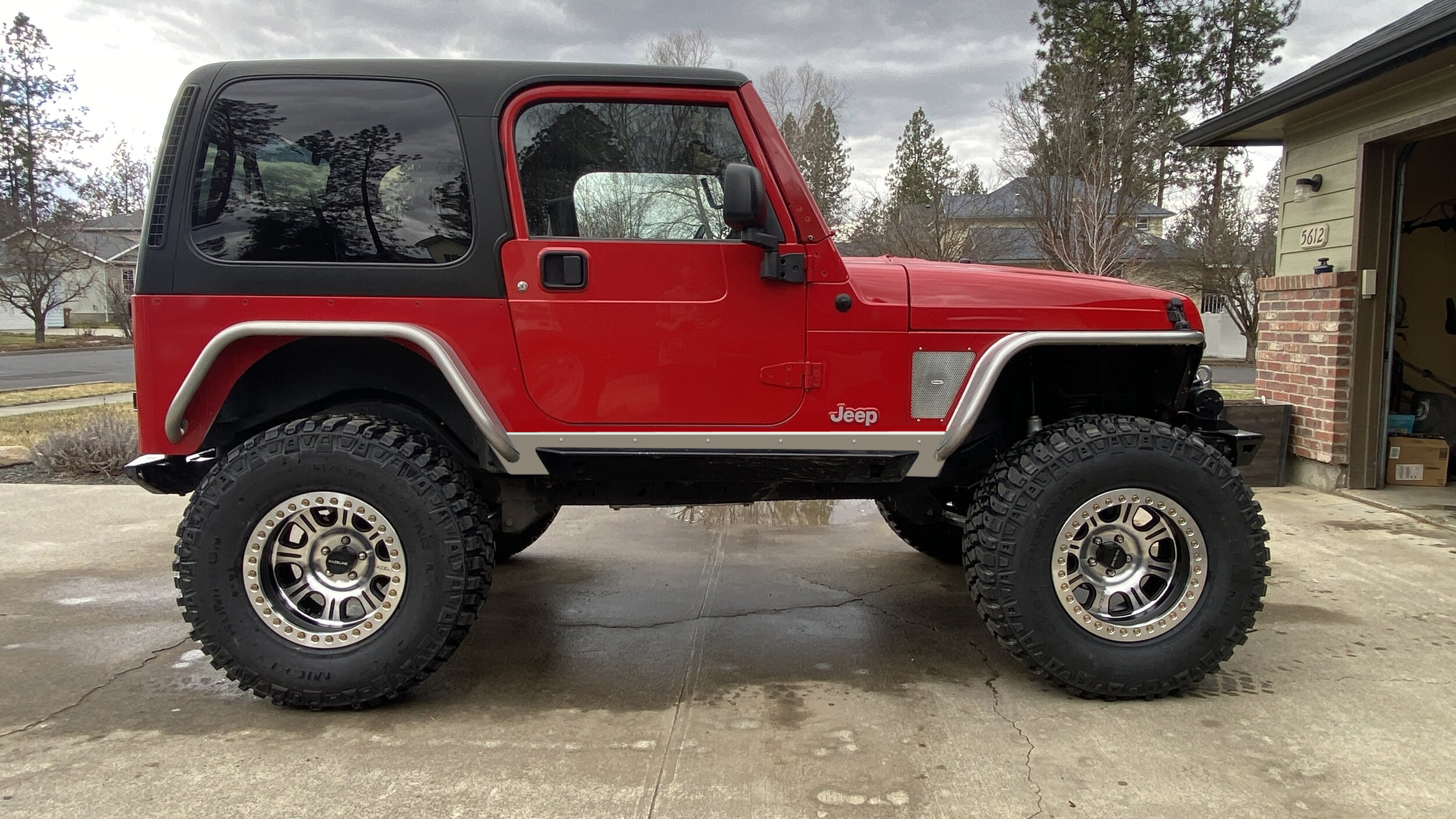

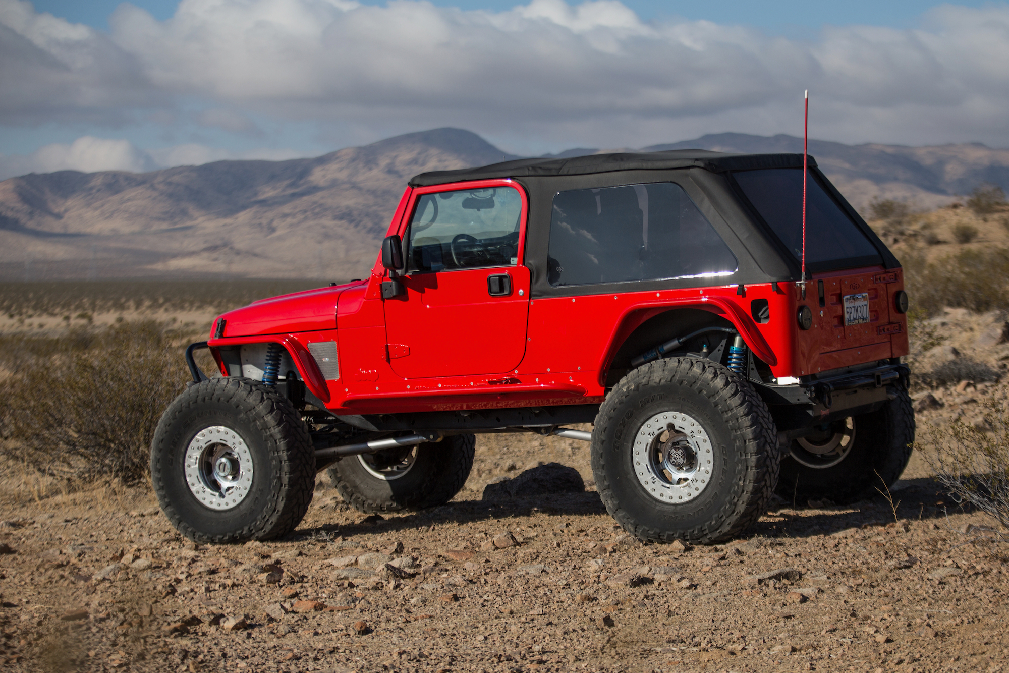

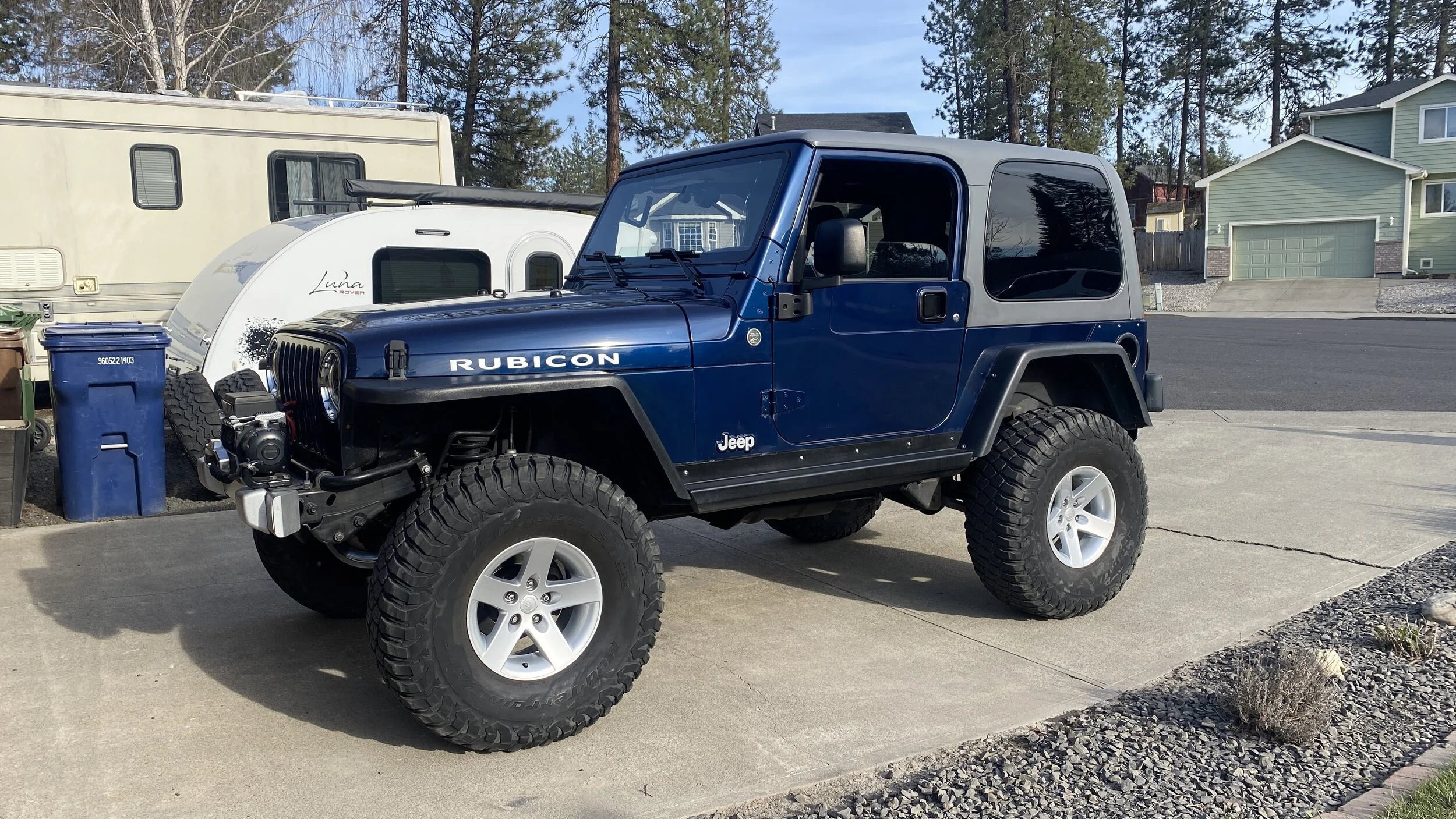

I'm interested to see what you can come up with as far as color. I've tried three and lost interest before getting a "match".

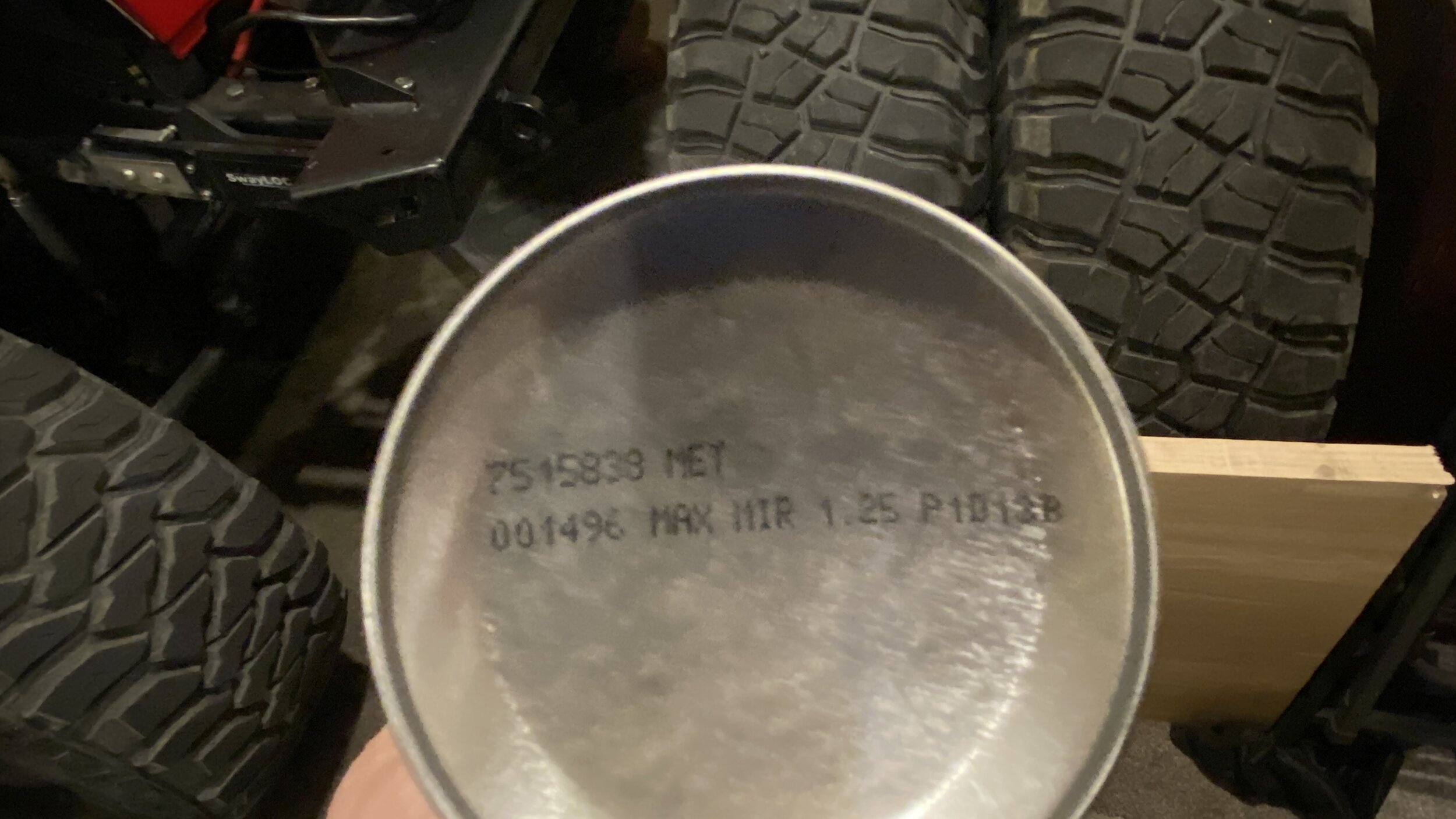

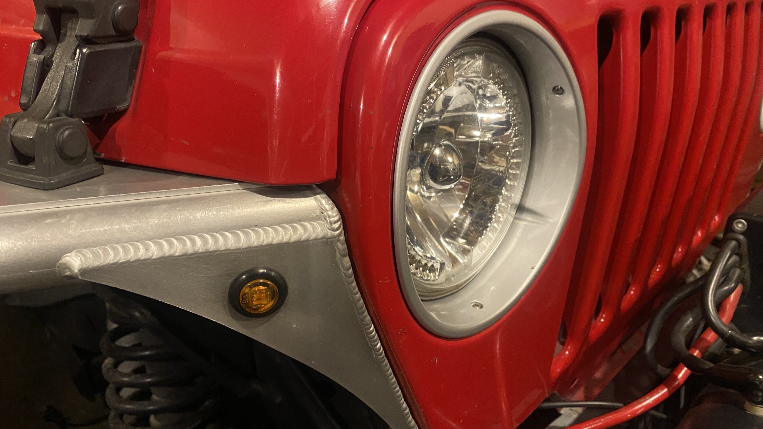

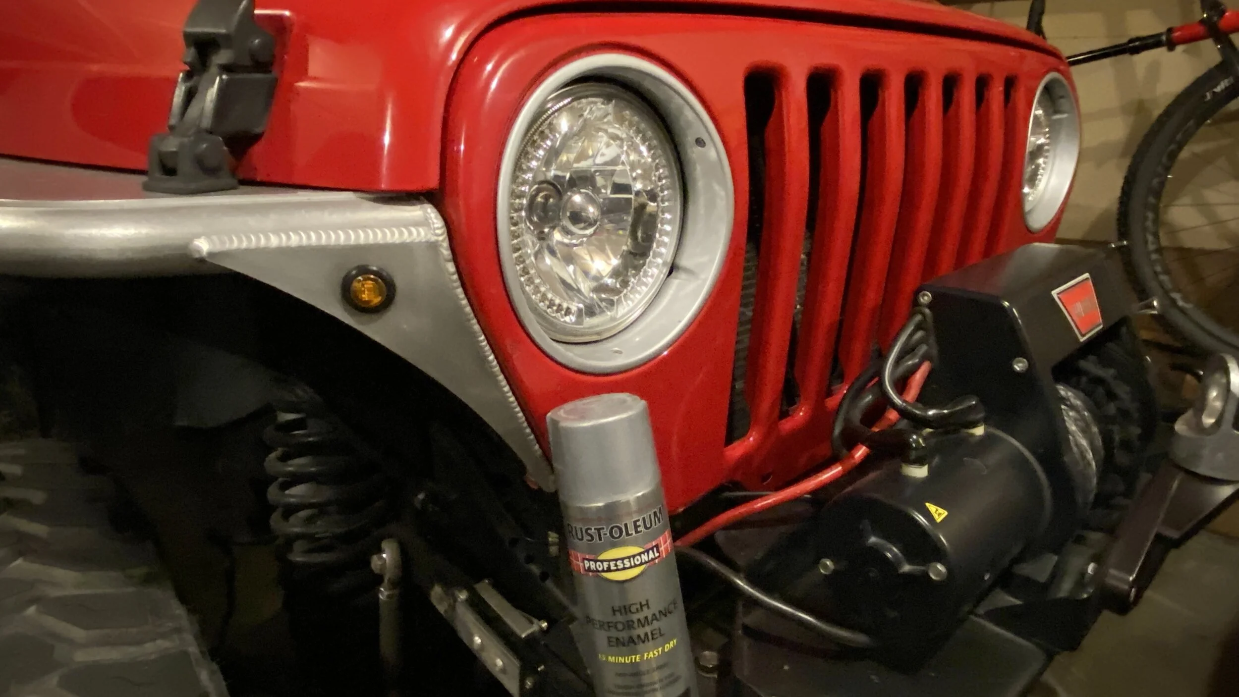

The headlight bezels next to the GR fenders. The paint doesn’t have a color name, but is a metallic enamel. Here’s the numbers on the bottom of the can. It is sufficient IMO, but it would probably not please everyone. I think yours looks very good and I’d be interested in knowing what it is.

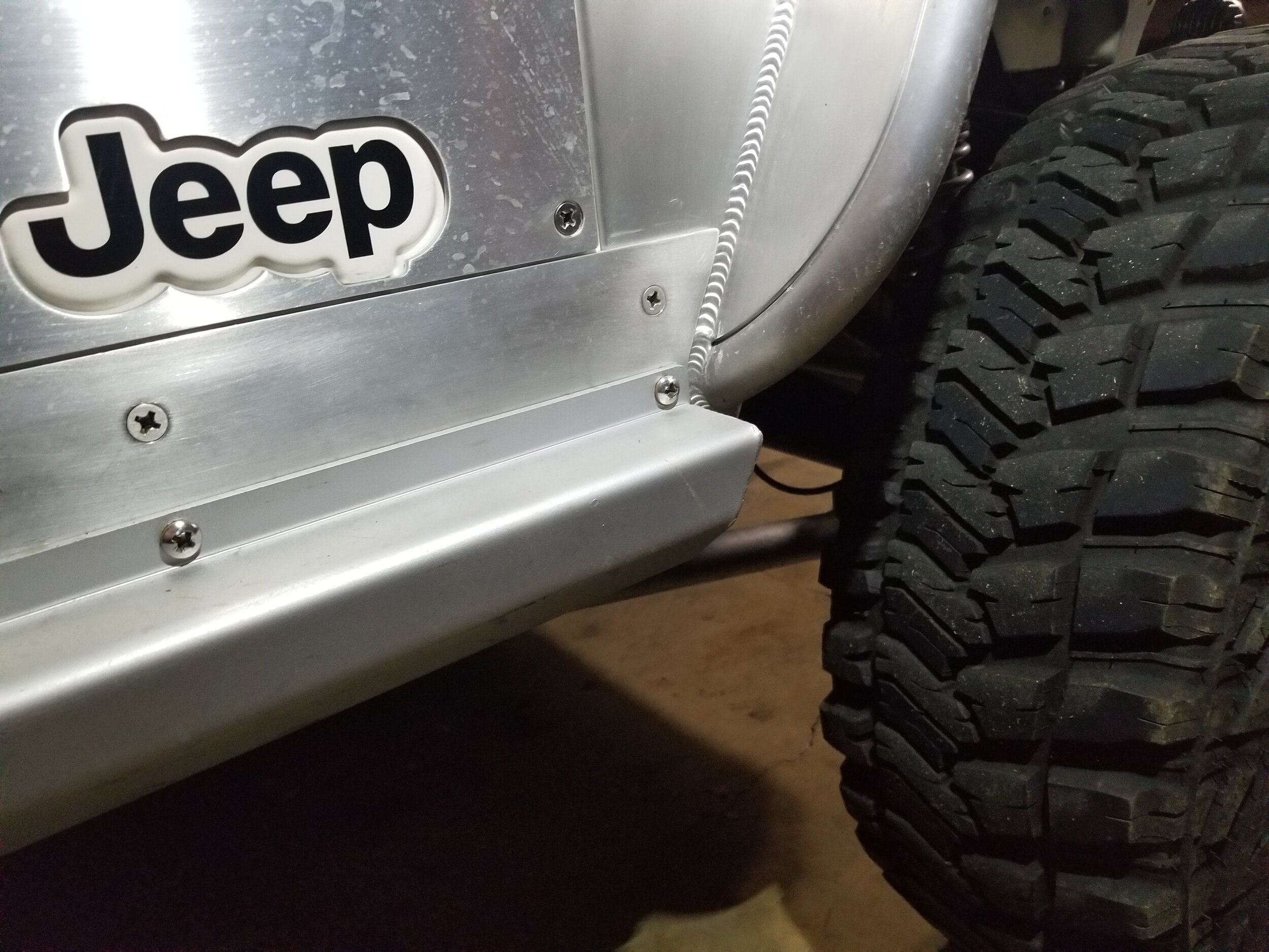

I think that was the first can I tried. It's impossible to get a perfect match in my case having three different pieces of aluminum of three different "ages". The color in the picture I posted is Aervoe 309 suggested by mrblaine.

Do you or did you do any sanding on your aluminum to even out the color? I use 320 grit across the various aluminum pieces to even out the color. I may do an experiment with aluminum and the paints to see how close I can get with different grits to the Rustoleum I have and the Aervoe 309 Blaine suggested.

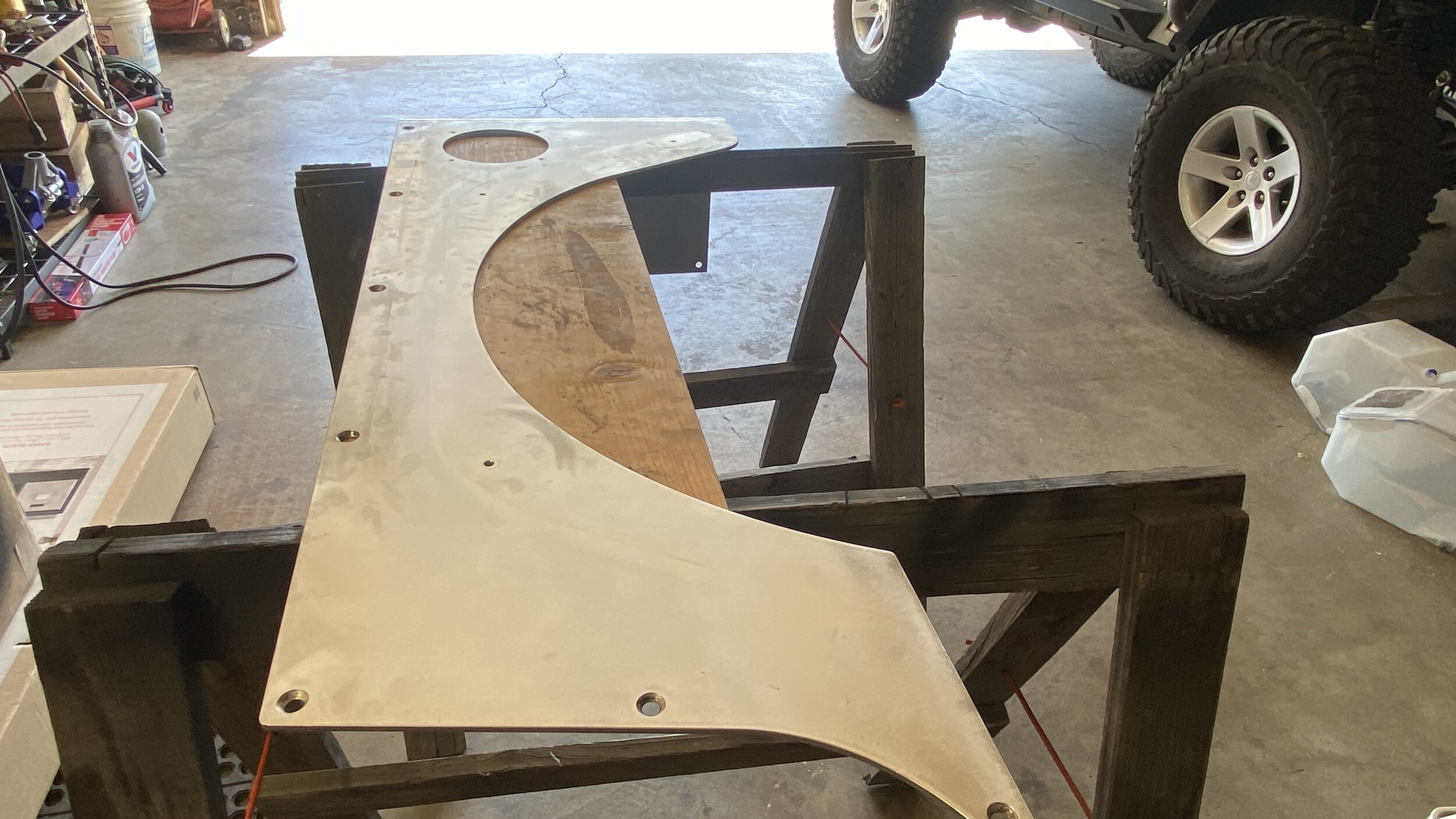

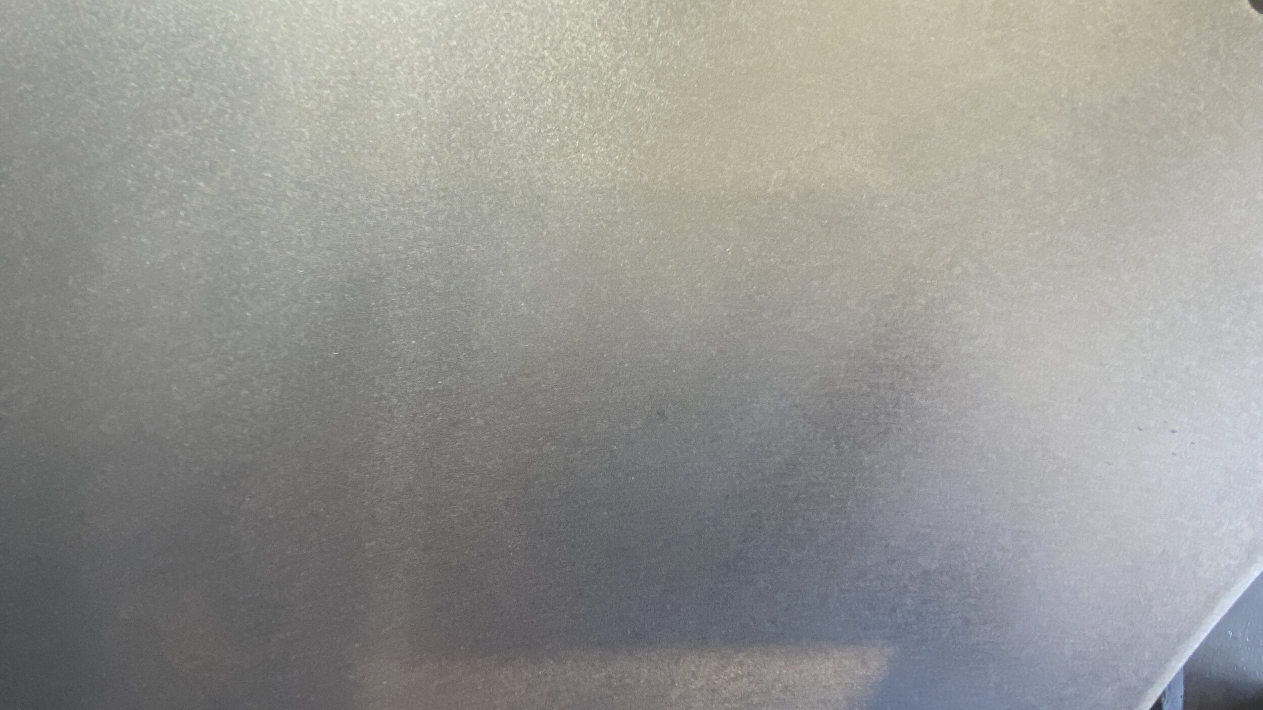

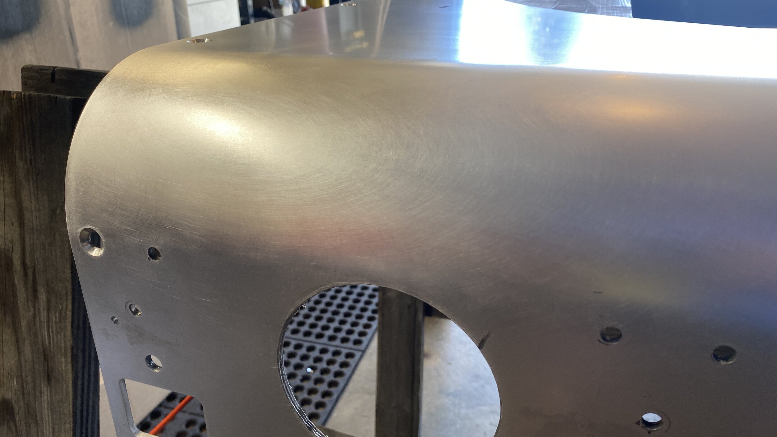

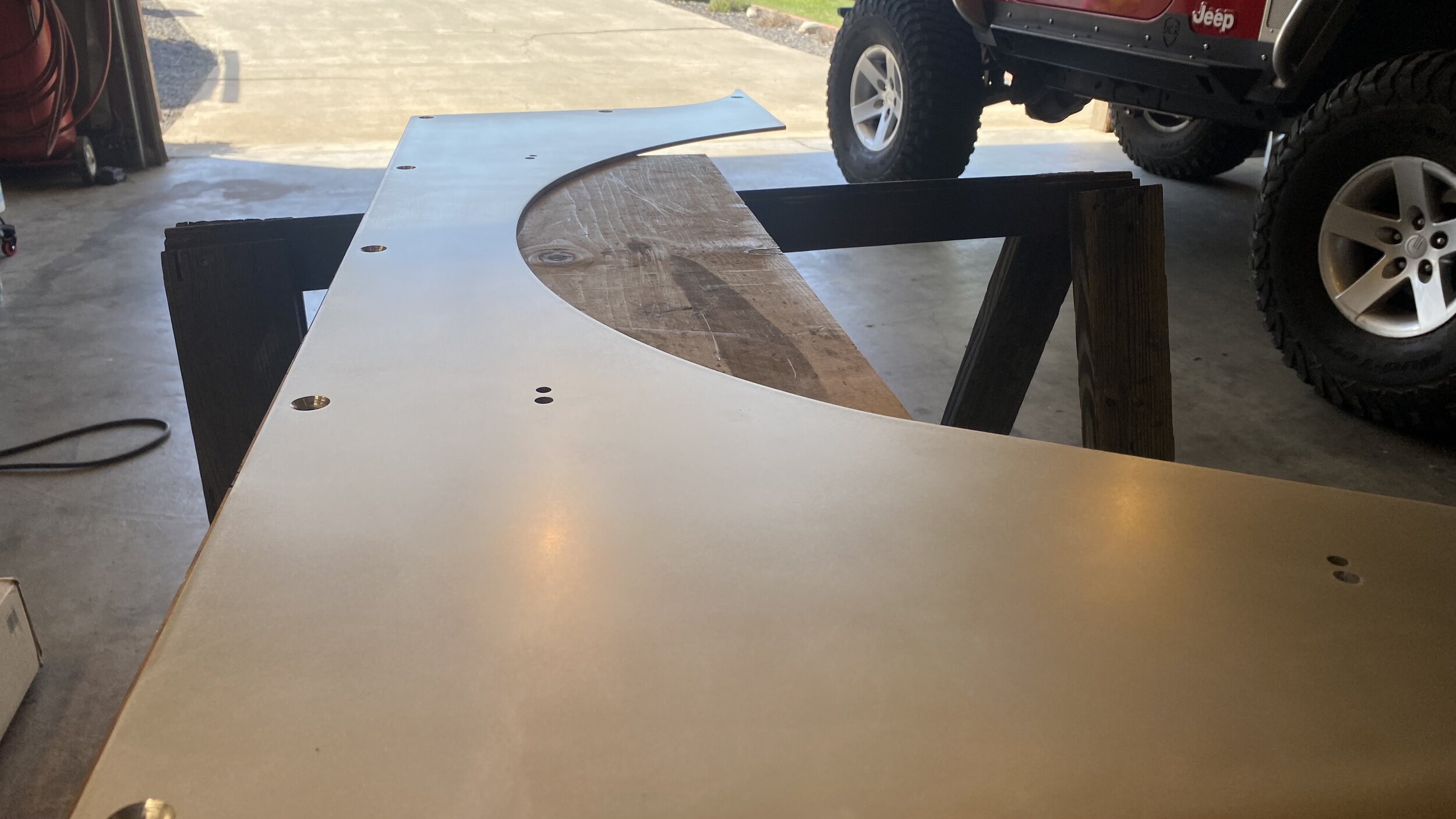

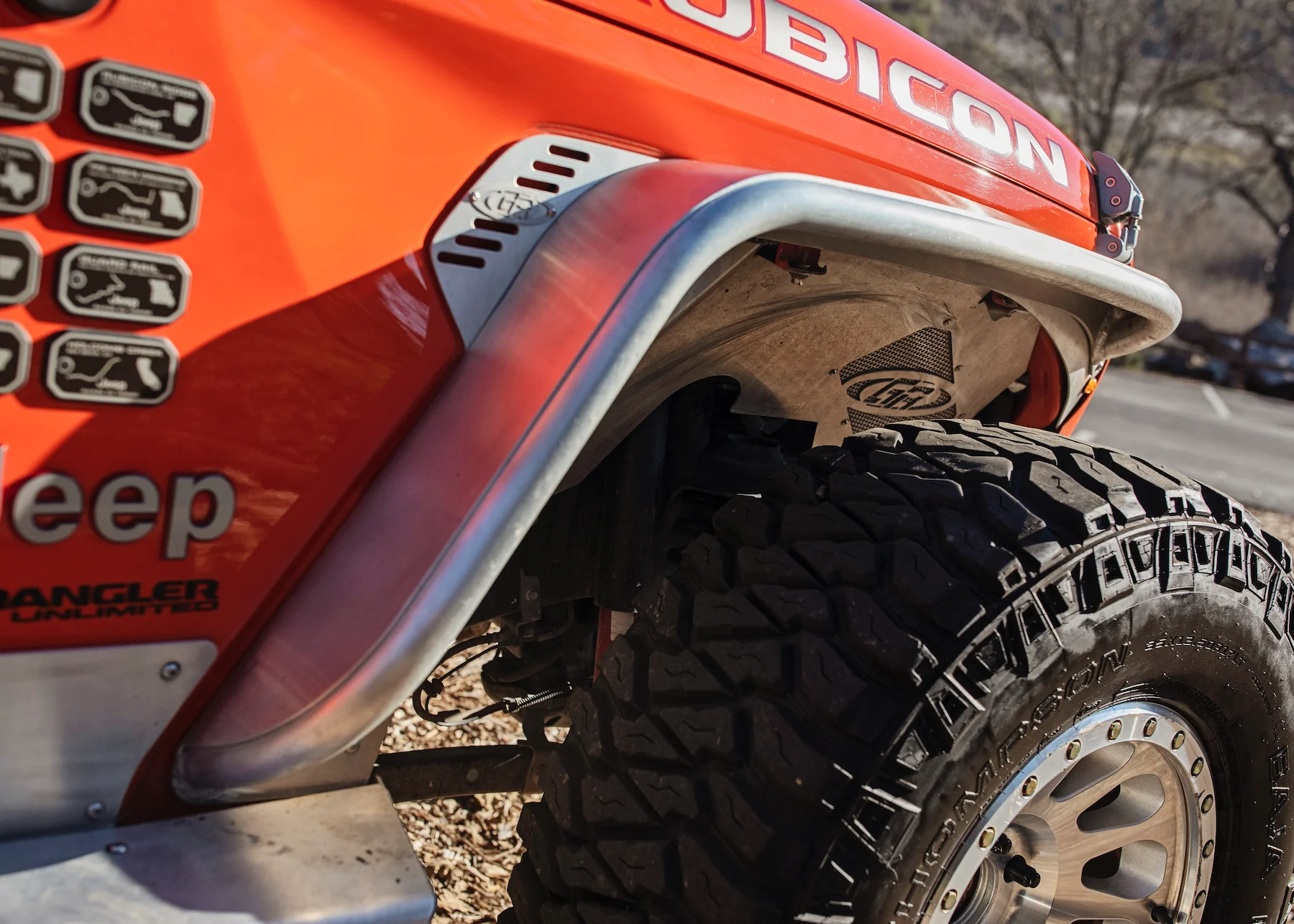

I clean the aluminum with a mixture of white vinegar and distilled or reverse osmosis water (1:1). After allowing any residue to evaporate I sand with appropriate grit. If I'm trying to remove scratches it depends on depth, but 120 is a conservative start. Then move to 220, then 320. If no scratches I just go straight to 320 on an orbital sander. Edges or curves can be more difficult. I've used orbital on the radius of the corner armor, and I've also tried hand and block sanding, but it's less even, so I always try to figure out a way to use a 5" orbital sander. Aluminum is amazing and if you go to 3000 grit it will look like a mirror. I've never gone that far, but I've been tempted just out of interest. The pics below were prep for painting, but they could be left simply as bare aluminum. I'm going to go over my fenders like this sometime this week.

I like the silver, or stay black!
Thanks @dla. Great skill you’ve got there. Now I don’t have to just imagine what it would look like. Very helpful.

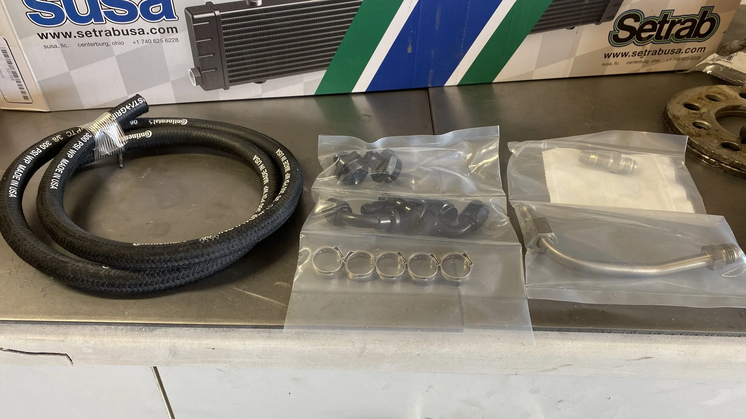

Received some great “cooler” parts for the Setrab from @mrblaine. The quality looks fantastic! I’m excited to have it all “right” with the best so I don’t have to be concerned. I’m kinda looking forward to digging into this project. I think it might be a bit more than I expect. I’ll try to start Thursday when I’m off work so I can get this rig on the trails without worry ASAP!

I like the body color or stay Black... IMO I'd stay Black for now until you have a real reason to pull the sliders.
