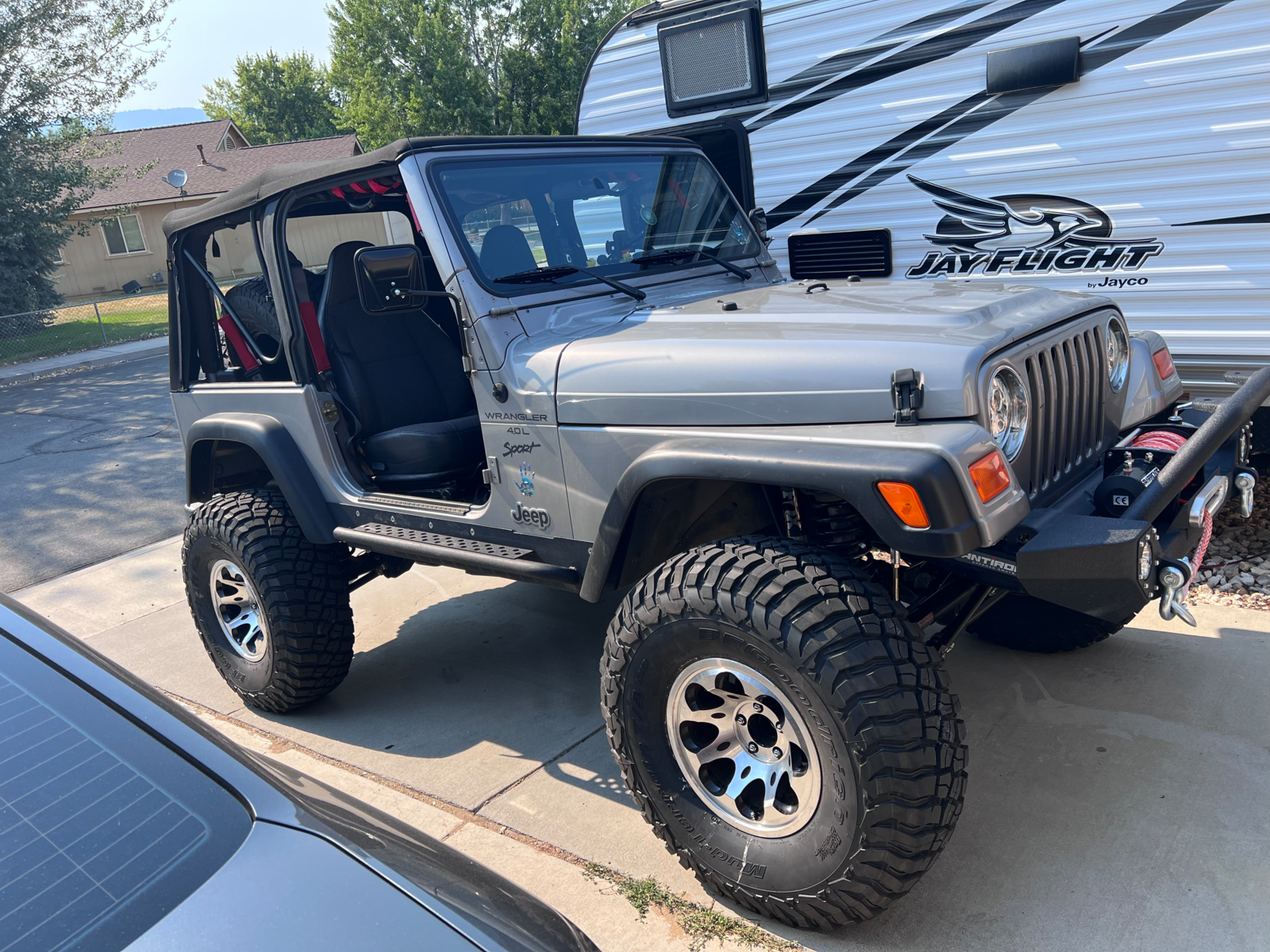

Here's a picture of my Jeep with new shoes now that she's fun again.

Glad you are up and running. 🙂 I like the unique look of your wheels.
Thanks, I love these wheels! Only wish I could find a fifth to ride on the back. I'm just rocking a steely for the spare currently.
BTW, ISO 15" American Outlaw Ranger 5x4.5 lug pattern, if anyone looking to sell one happens to come across this post ;)
