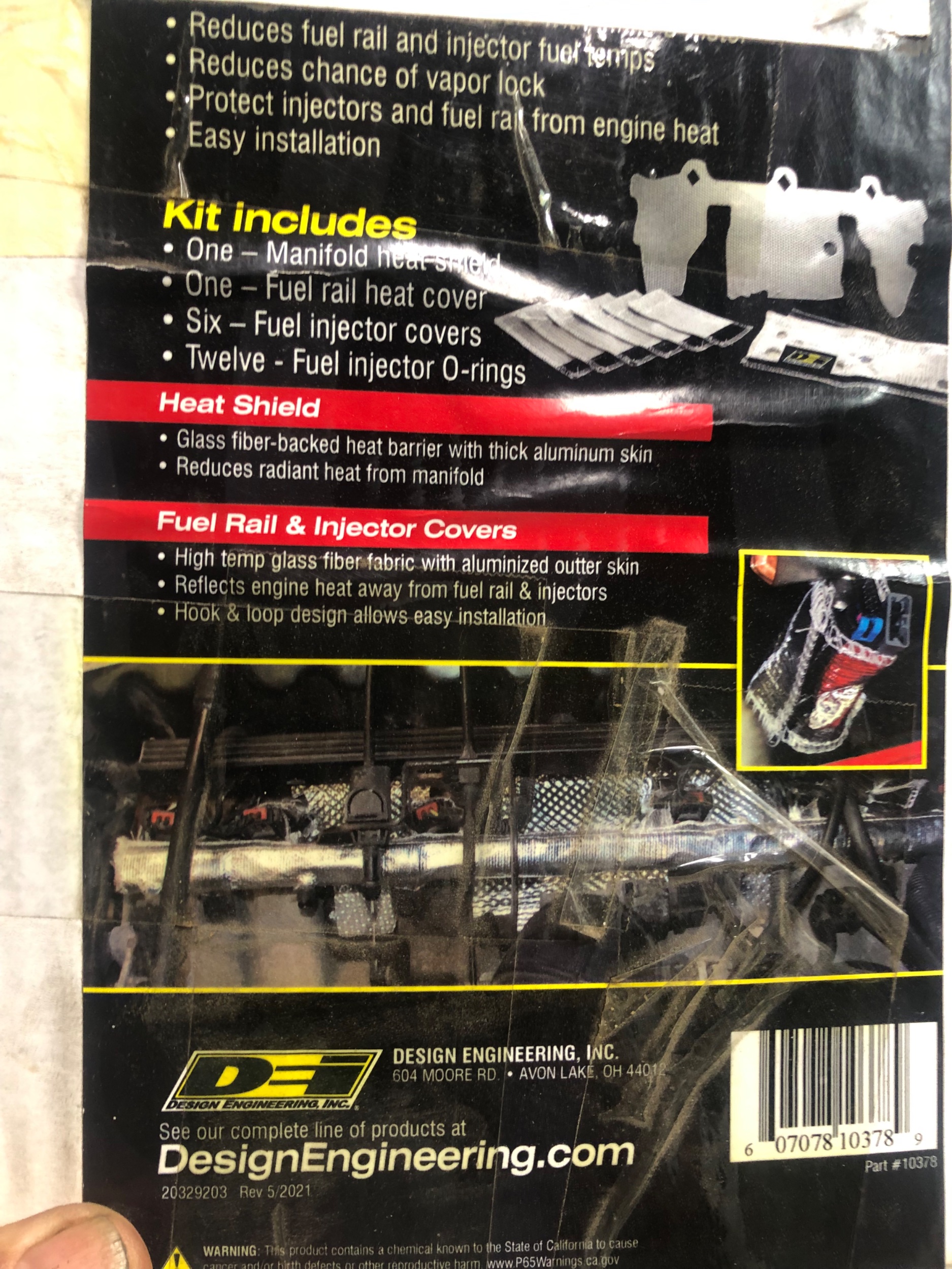

I replaced what was left of the OEM heat shielding with a kit from DEI. I bought this,4 hole injectors and new wire pigtails fro K Suspension. I regularly run in the desert heat and never had an issue.
