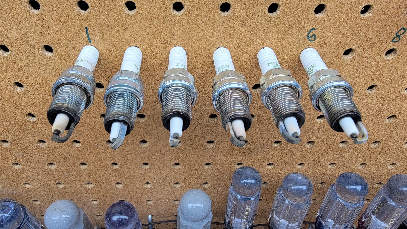

I did a compression test on all the cylinders. If it seemed low, I added some oil in the cylinder and did it again. let it do 3 compressions on each.
Here are what the plugs looked like. 1 and 4 maybe look a little orange? they are in order 1-6.
Compression test results were as follows in psi: (snap-on compression tester)
Cylinder 1Cylinder 2Cylinder 3Cylinder 4Cylinder 5Cylinder 6
115 (125 after adding oil)130130113 (120 after adding oil)125135
