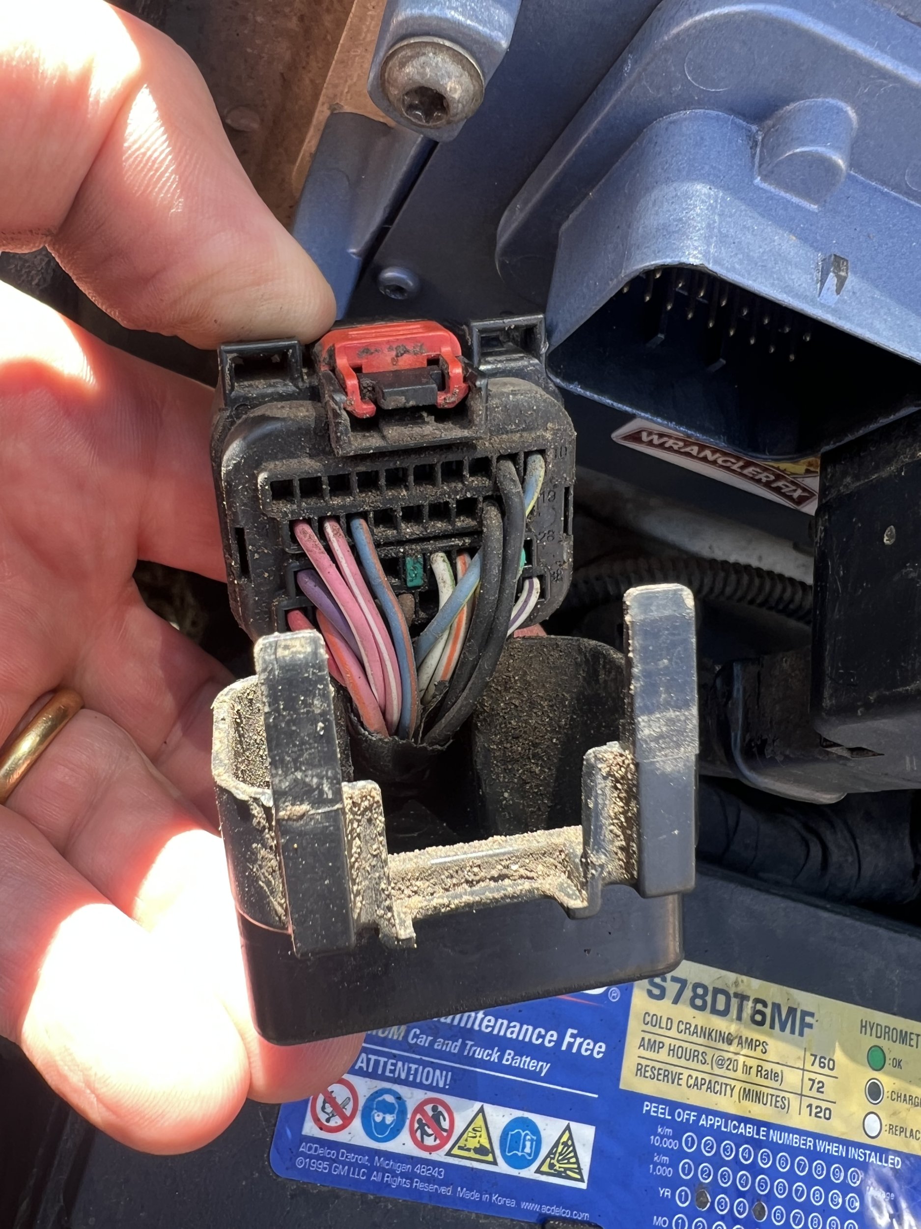

Does anyone have the info on what terminal pin crimps I need to be able to add wires to my ECM connectors?
Jump pins 11 and 12 together on connector C1 (farthest left). As to the wires I used, I had one of the OEM terminal kits that had wires and connectors in it.
It might be possible to do with just a paperclip.
Thanks! That gives me a start!
I'm looking for the actual wire ends and seals for the connectors. I have something to experiment with but I need to add two wires.

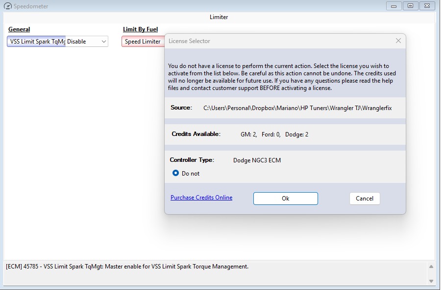

Hello all.
Recently my 2005 Rubicon PCM started to fail so i ordered a @Wranglerfix PCM.
I had a @Flyin' Ryan Performance tune installed on the OEM PCM with HP Tuners, now i want to put the tune on the new PCM, first, i know i have to buy new credits for the new PCM, i bought 2, but when trying to license the new PCM won't let me.
I have contacted HP Tuners support and they say the new PCM don't have VIN or Serial number, but when i ordered WranglerFix PCM it asked for the VIN.
Traed with both stable and beta versions of VCM Suite.
Anyone knows how can i register the new PCM on HP Tuners?.
Regards
Mariano

You might just be running into an issue with the wifi connection or need to perform a resync interface in VCM editor. The laptop has to have a wifi signal to register and resync and then often this would clear up.

Call mark @Wranglerfix and talk with him. He will know what's up.
Reactions: ColoJeep
Hello. Thanks for the advice. I have full wifi signal at my garage. Sure that's not the problem.
Hello. Thanks, in advance for have full wifi signal at my garage. Sure that's not the problem.
Yes, but a problem with resync interface will give that sort of issue with the licenses registering. I'd also susggest reading the new PCM first and storing that. Mark has mentioned that he applies some minor adjustments to the standard profile and it would be helpful if you need to go back.
I almost mentioned one other problem. I've had some trouble getting the MPVI3 to seat really well on the ODBII port lately and tonight I got something to the effect of no interface found. Eventually I got it on the pins just right. I had a bit of an issue with the MPVI scanning a friend's Camaro the other day, so I need to take a look and see if there is an issue with the positions of the pins on the device.
Emailing the good fellow at Wranglerfix isn't going to hurt you either.
