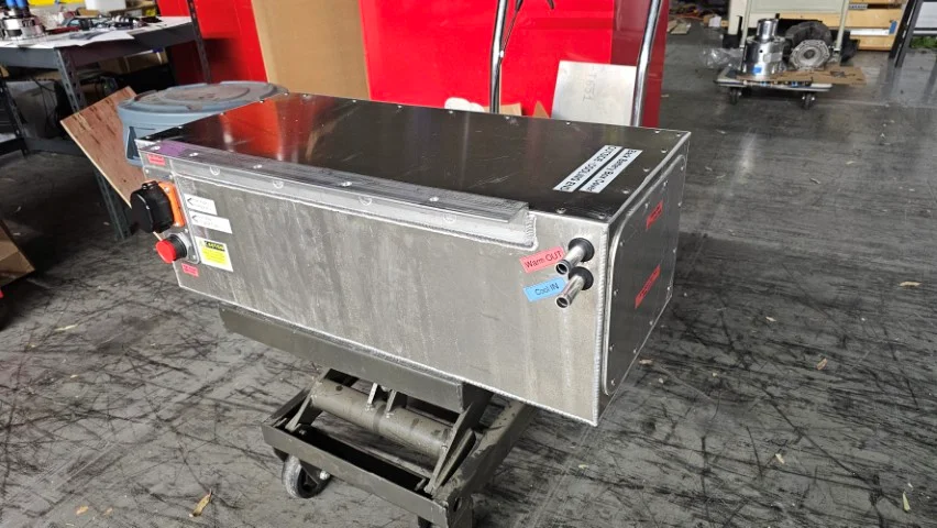

The Back Battery Box is in and fully finished. It looks like this when out of the Jeep:

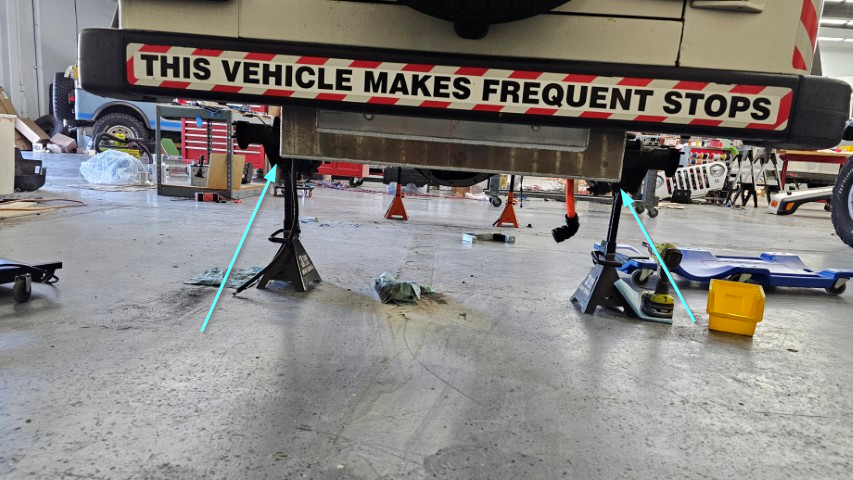

It's designed to fit into the exact location of the stock gas tank. There are only three designs we do, CJ, YJ and not the TJ version.
This is mounted using existing bumper bolt locations plus 4 added 5/16" RivNuts into the existing gas tank cross member under the Jeep.
From the back, this is all you'd see:

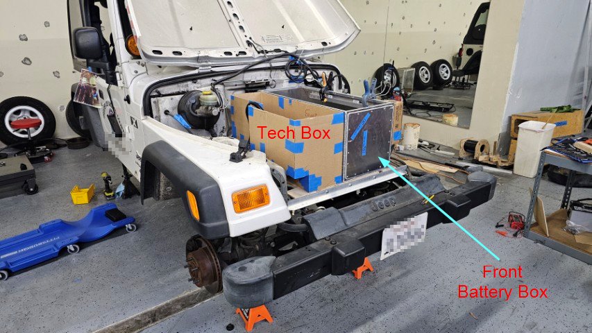

At the moment, we're working on the Front Battery Box and the Tech Box.
The Tech Box is divided into two parts; the HV-JB and the LV-JB.
NOTES:
- HV-JB = High Voltage Junction Box (144v nominal)
- LV-JB = Low Voltage (12v) Junction Box
Here's a snap with the fender on to work out clearances and stuff:
The cardboard part is the Tech Box and the thing next to it is the Front Battery Box.
My design process is pretty straight forward;
- Cardboard and blue painters tape
- Plywood (if necessary or I have to build stuff that attaches to it)
- Aluminum
I'm under the gun with the City so I'm moving as fast as I can to get this first one done and out the door.
Okay, I'm sure this is enough to wet your appetite, ask anything but if it's insulting, I've learned, it's better to just ignore.
- Patrick

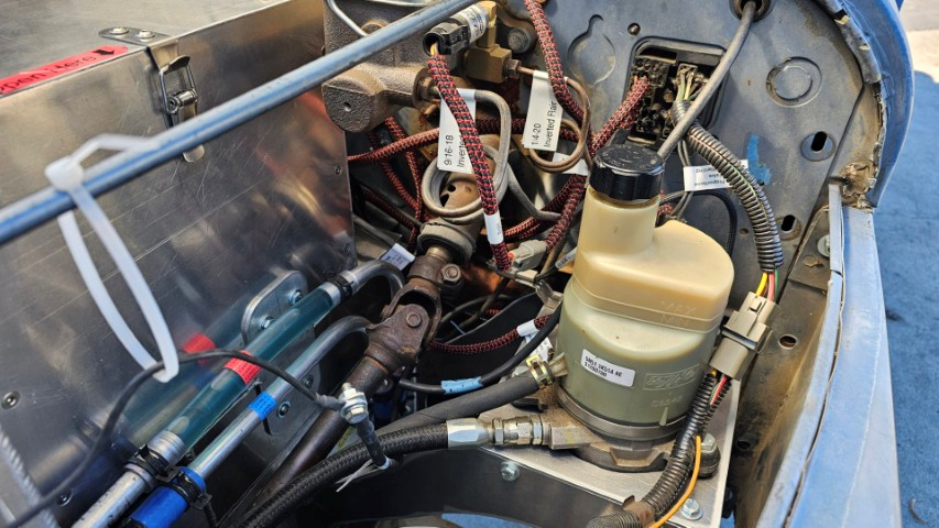

I think there would be some interest if you could expand on the details of this swap.
The Volvo P/S unit is available on ebay for around $300. It's almost plug and play. Did I mention it's made by Fo-Mo-Co, they've had a very long relationship apparently, who knew...
Anyway, yes, you need to braze the stock nuckly plumbing to two new connectors for the pump, add a 60amp fuse and a 1 wire Enable switch that can be attached to a relay to your key-ON switch. Honestly, it'll take you longer to rig up the mounting bracket and remove all the stock P/S stuff on the motor then it will to hook the 'new' P/S pump up.
The reason it's such a good swap candidate is it's a self contained unit - the pump and reservoir are in the same unit. You get an immediate ~12-18% hp added back to the ICE motor from the vane pump being removed.
Here's one that's on our demo CJ:
Yes, we love our label maker....
Okay, back to work, those Jeeps won't wire themselves!
- Patrick
