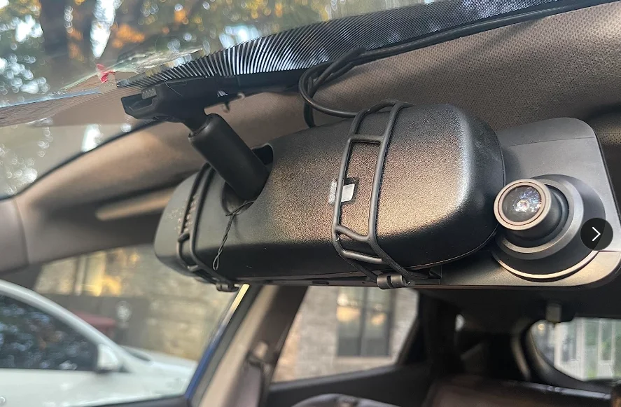

1. See if you can find a system that is not just essentially strapped/rubber banded/clipped over an existing mirror. It not only looks janky, but also doesn't give me confidence that the attachments will not fail at some point due to exposure to UV/IR from sunlight and hot car interiors in summer time. And how well it fare if you take your jeep on the trails? Considering that you are going to this replacement effort to make something better .. try and find something that isn't a step backwards in function.

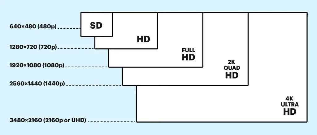

3. Most will advertise and lure you in with "4k ultra high definition" and you might think super amazing clarity like in a good desktop monitor or home TV watching Blu-ray. The sensor may be capable of recording in that, but the display itself will likely not be anywhere close to 4k. Be aware that the clarity you perceive is a combined function of the screen size, screen brightness/sharpness/contrast, screen resolution and the viewing distance from driver's seat. The "4k" number in most of these is for the dashcam - which you aren't going to be viewing as you are driving, even if that small LCD monitor were capable of displaying that in full resolution. The backup camera typically is usually lower resolution. The screen resolution itself maybe just 1080p or 720p and most likely not 4k (feel free to correct me if I am wrong here). As a guide, 1080p (1920x1080) is 2.1 mega pixels and 4k (3840 x 2160) is 8.3 mega pixels. 4k displays are expensive :)

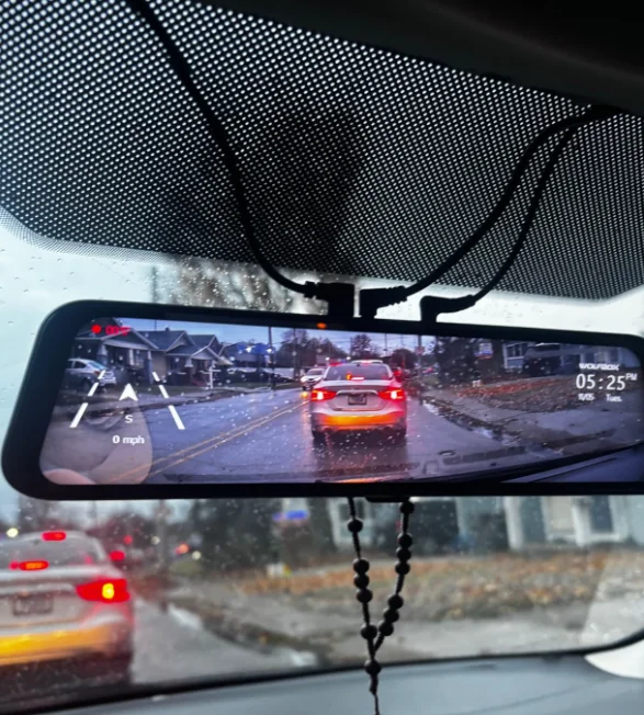

5. Pay attention to overall integration. A lot of the cheaper setups are just a mess as to where they put the various camera input and power input, and you may end up with something like 2nd pic below, that you will be staring at everyday. Even the best possible job of cable routing cannot overcome poor product design.
