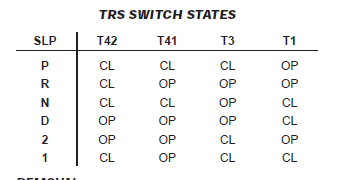

It's not an ohm check, there are multiple switches and a truth table to tell the PCM where the shifter is.
Pull up the FSM under Resources for wiring diagrams, theory of operation.
Overcomplicated....
Edited to add:
You can ohm check it, you'll just need to check all 4 wires.

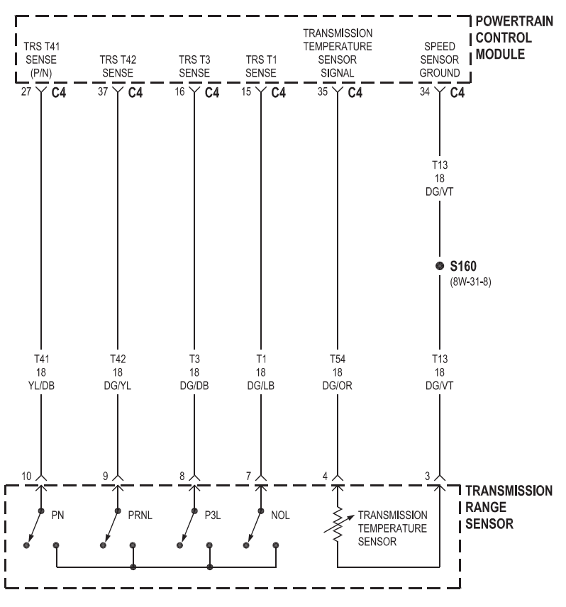

Thanks for the input, I'm guessing i need to trace wires back to the PCM to see if there is a short or open wire? I'm not great at electrical stuff but i know enough to get in trouble. Does the switch plug go straight to the PCM? I have the FSM on the pinouts for the plug where i get confused is to where that leads to.
Tracing the wiring diagrams isn't the easiest thing to do, since you have to jump several pages to follow the whole circuit. What I sometimes do is re-draw it on to a single page (with the FSM page references) so I can see the whole thing at once. But you probably don't have to do that. Find each wire on the NSS connector and see where each one terminates (most likely at the PCM) by just following the trail of breadcrumbs in the wiring diragram. Then you can check for continuity etc.
I'll try to teach you how to fish:
  1. 8W-02-1 has the component index. The transmission range sensor is in section 8W-31
  2. 8W-31-1 has the index. The range sensor is on pages 8W-31-6, 7, 8
  3. It's not crystal clear from those pages which one is the neutral safety, but you can see which cavities & which wires on the connetor go to PCM connector C4. For example the "PN" wire is 18ga Yellow w/Dark Blue trace that goes from cavity 10 on the range sensor to cavity 24 on PCM connector C4.
  4. You can find more info on the connectors themselves in section 8W-80.
  5. ???
  6. Profit
It requires a deeper understanding of the starter circuit to know how the NSS signal allows/prevents the starter relay from closing. It's described in section 8F-32, and you can work backward from the starter/relay wiring diagram to see how it all interacts.
