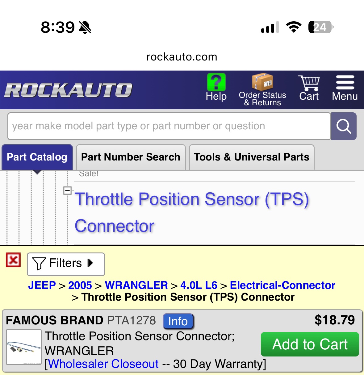

Guess I don't know what the 'big' plug refers to. Found a replacement at Rockauto. Thanks.
Since you didn’t give a link I googled that part #. Looks to be a throttle position sensor?
