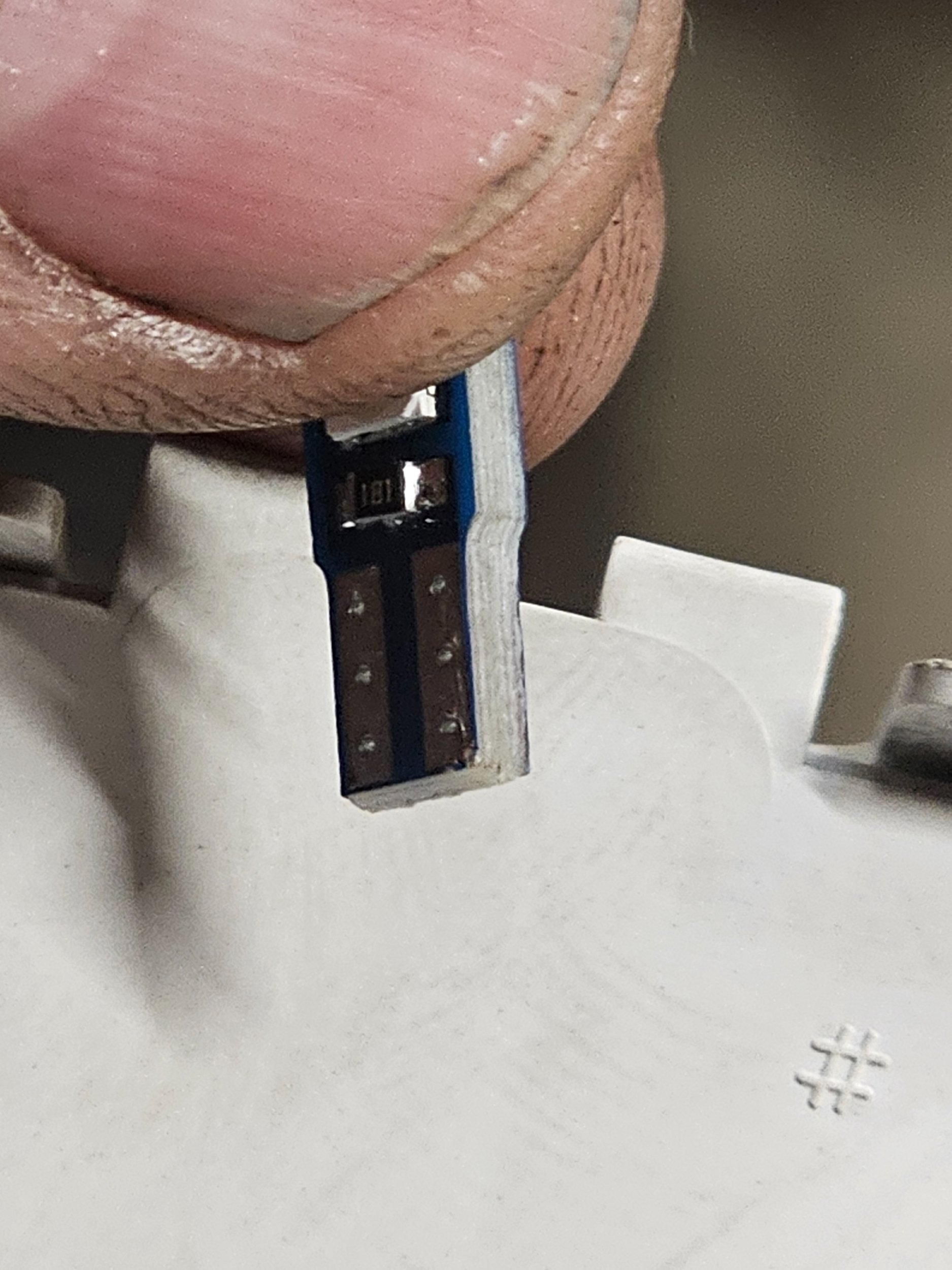

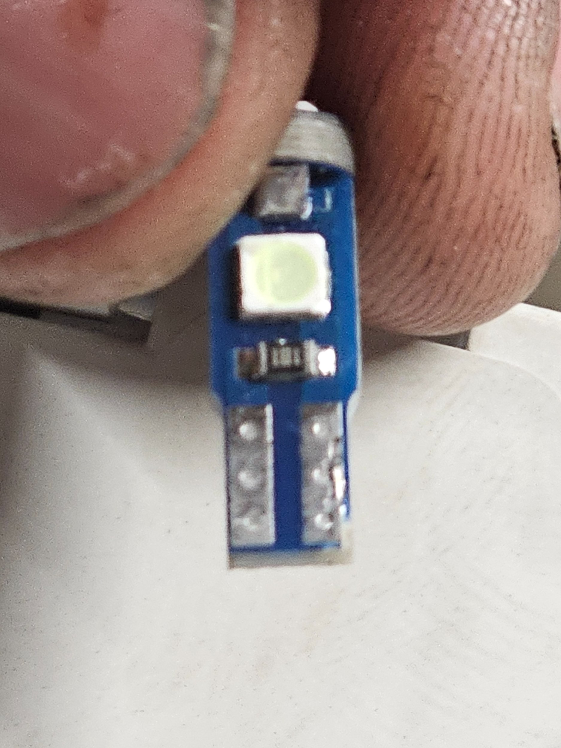

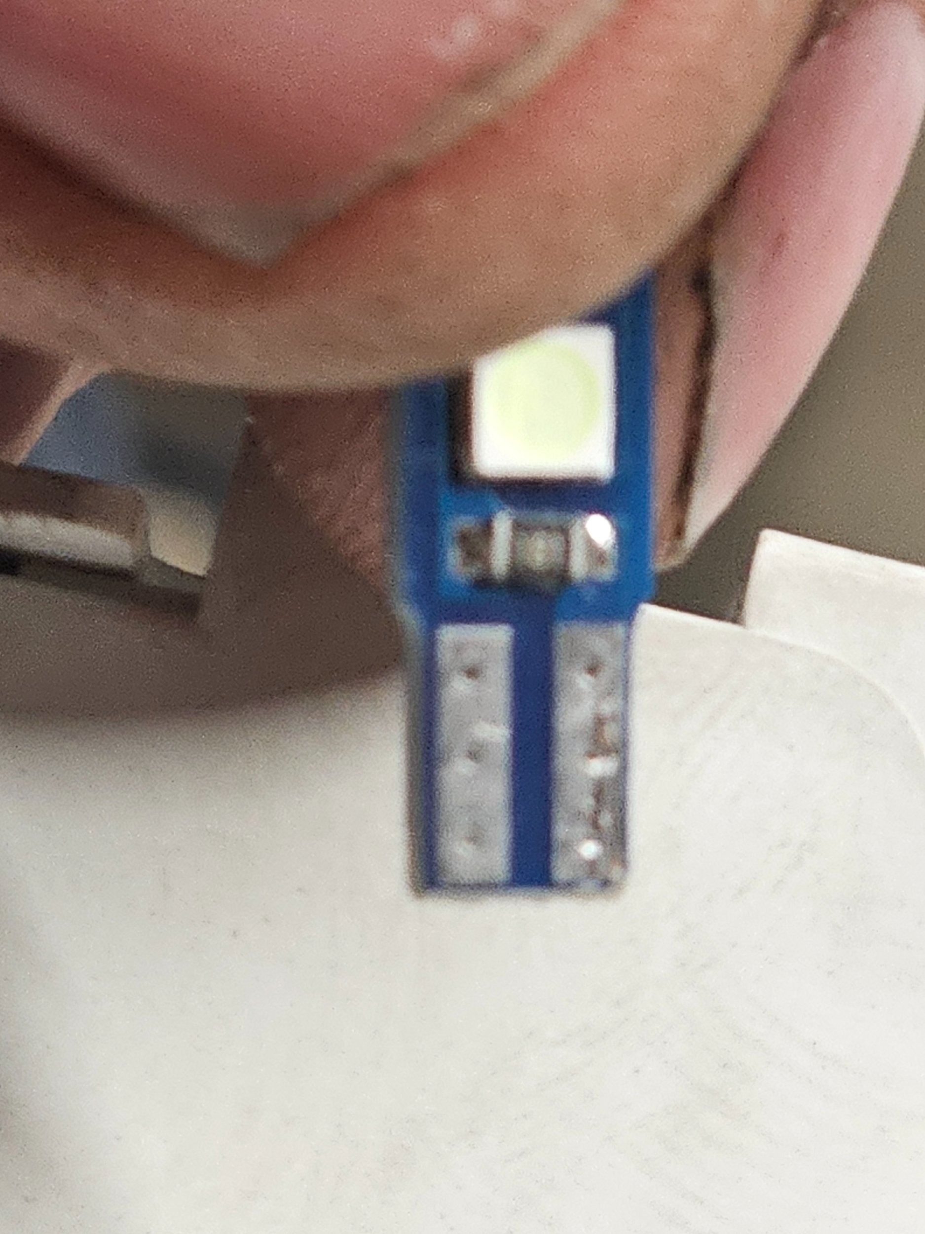

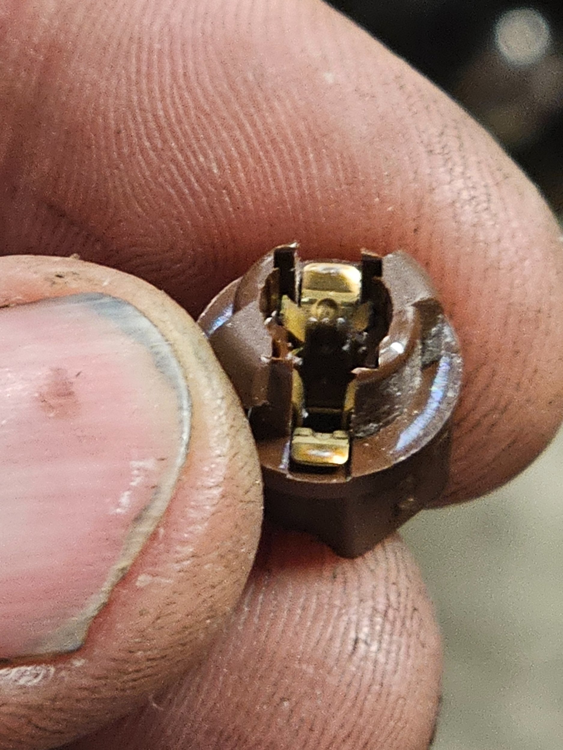

Here are the LED bulbs. You can see they have 2 strips on either side of the bulb. How it does it I can't tell you but it picks up the + off one side & the - off the other.

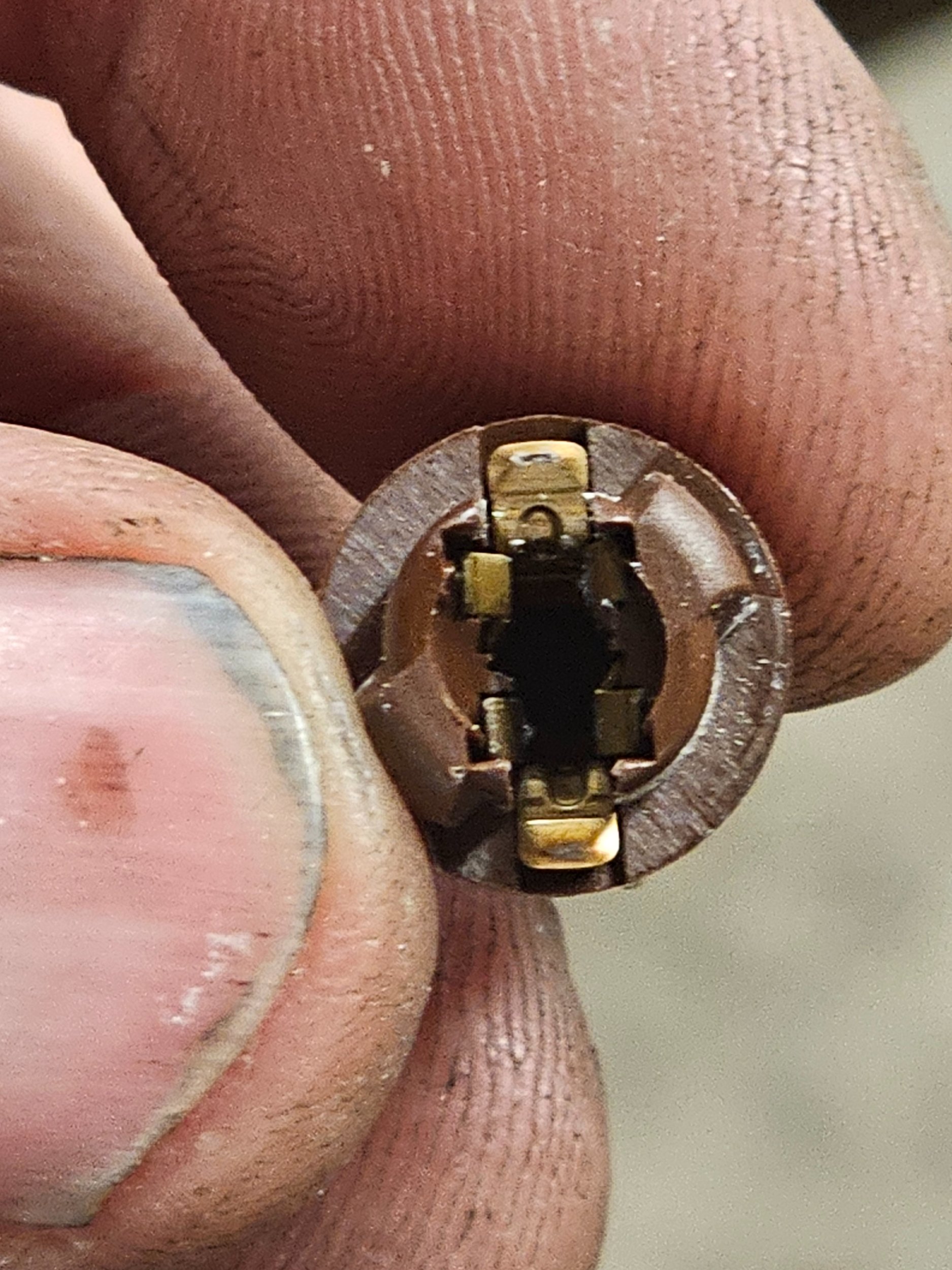

The socket has 4 contact strips in each socket with one being + & one - on each side.

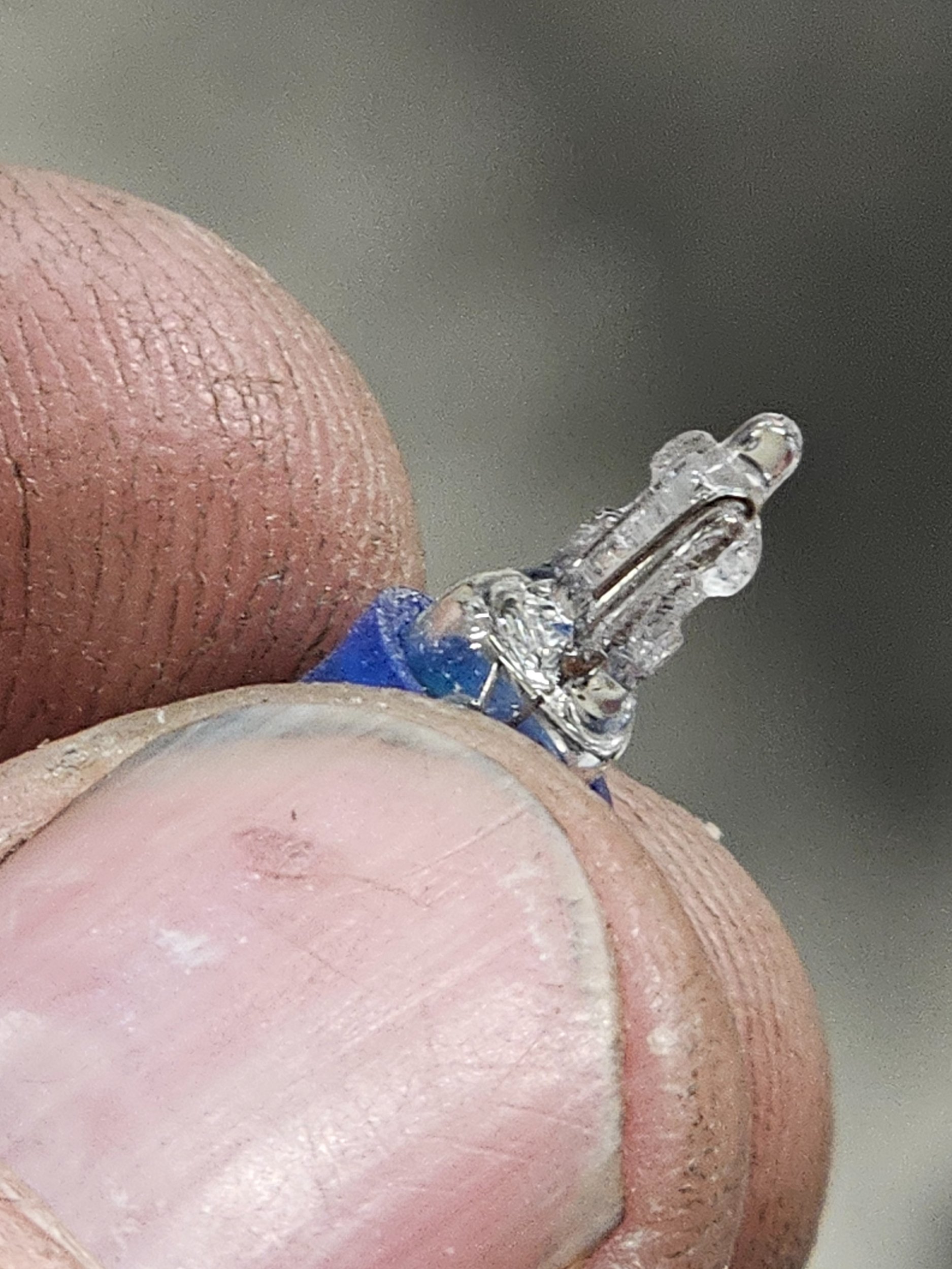

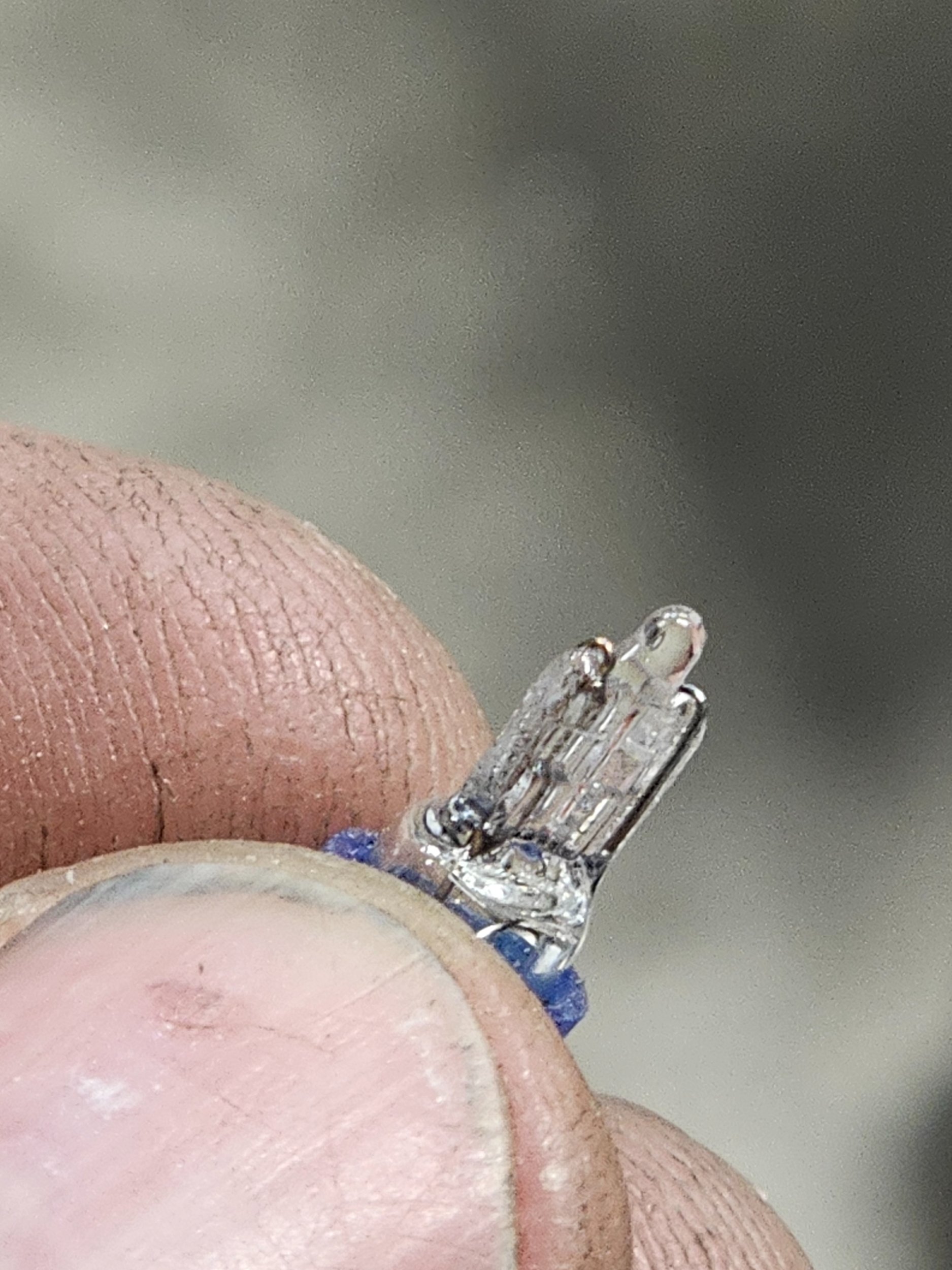

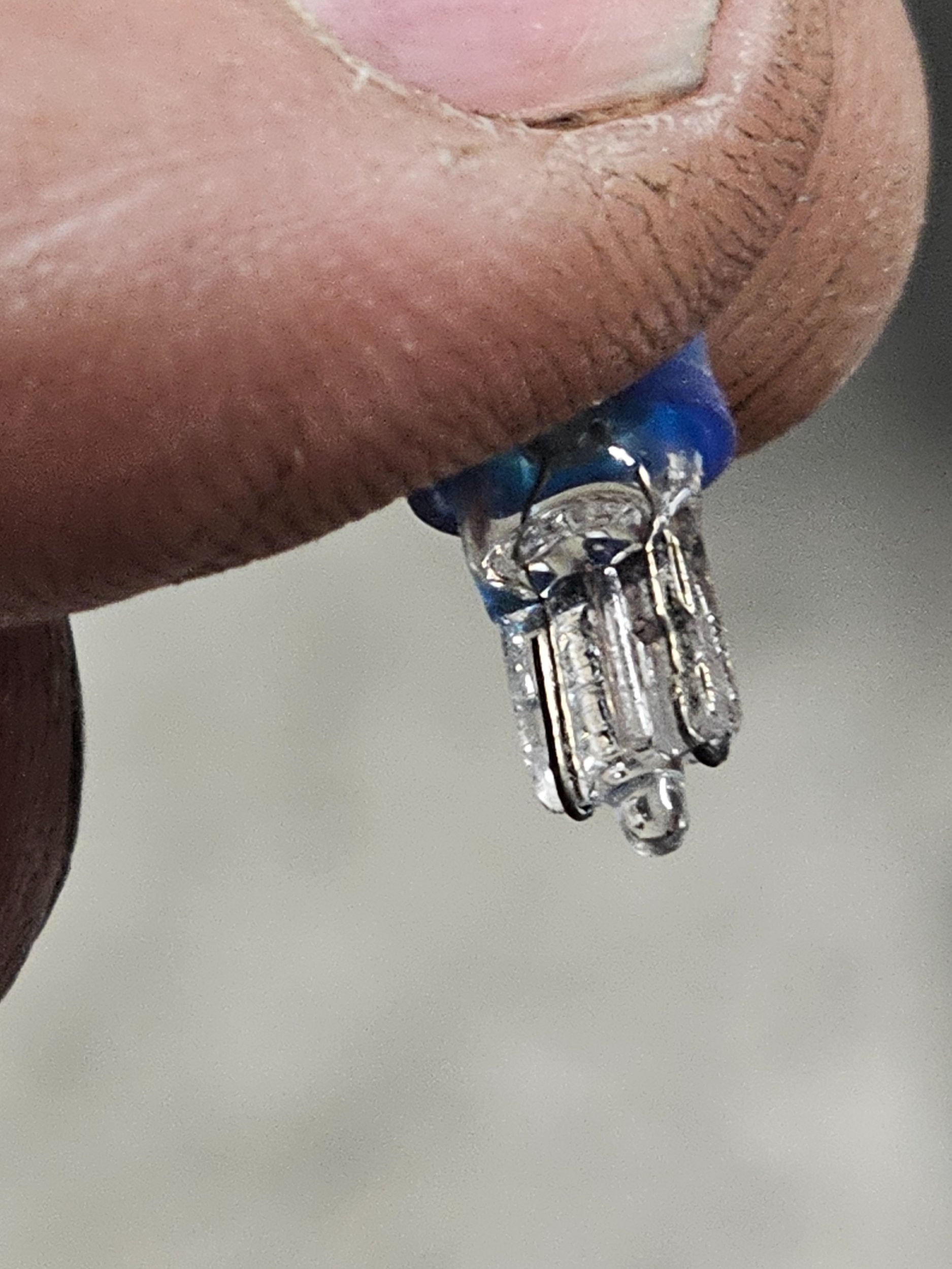

The incandescent bulbs has a wire on each side. One picks up the + on the contact strip & the wire on the other picks up the - on the other side.
The contact strips in the sockets could be why a bulb wouldn't work or? but just to test my theory I installed a bulb one way & then the other way to see if they would work & they did either way they were installed.
If I am remembering my electronics 101 when you hook a diode up backwards it's as if the circuit is open. So either way you plug it into the socket the positive of the led is hitting the positive of the socket and the negative hits the negative the other 2 terminals on the led are reversed so they don't complete the circuit...

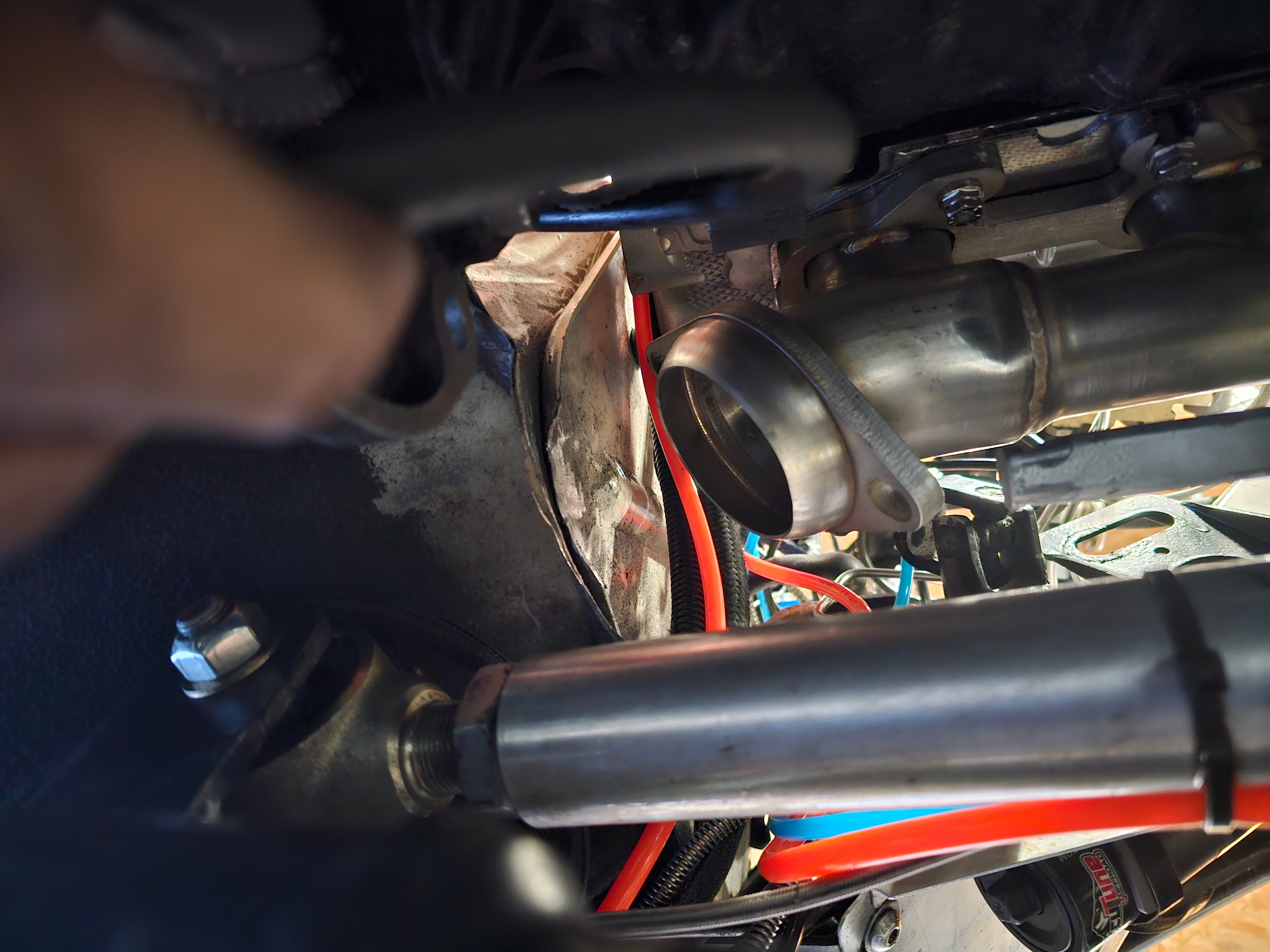

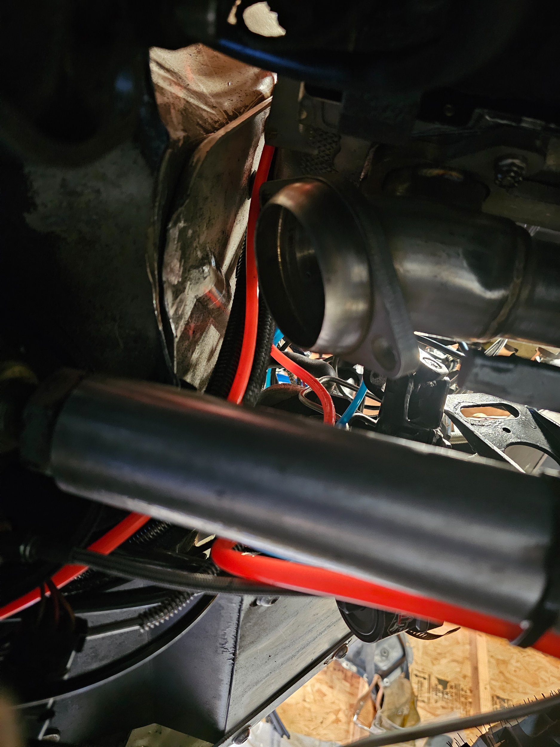

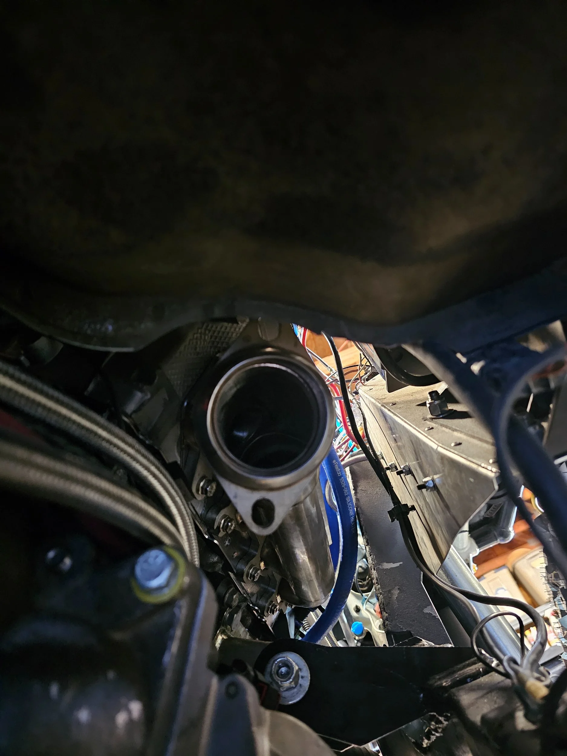

If I can get the exhaust system mocked up this weekend I'll be happy.

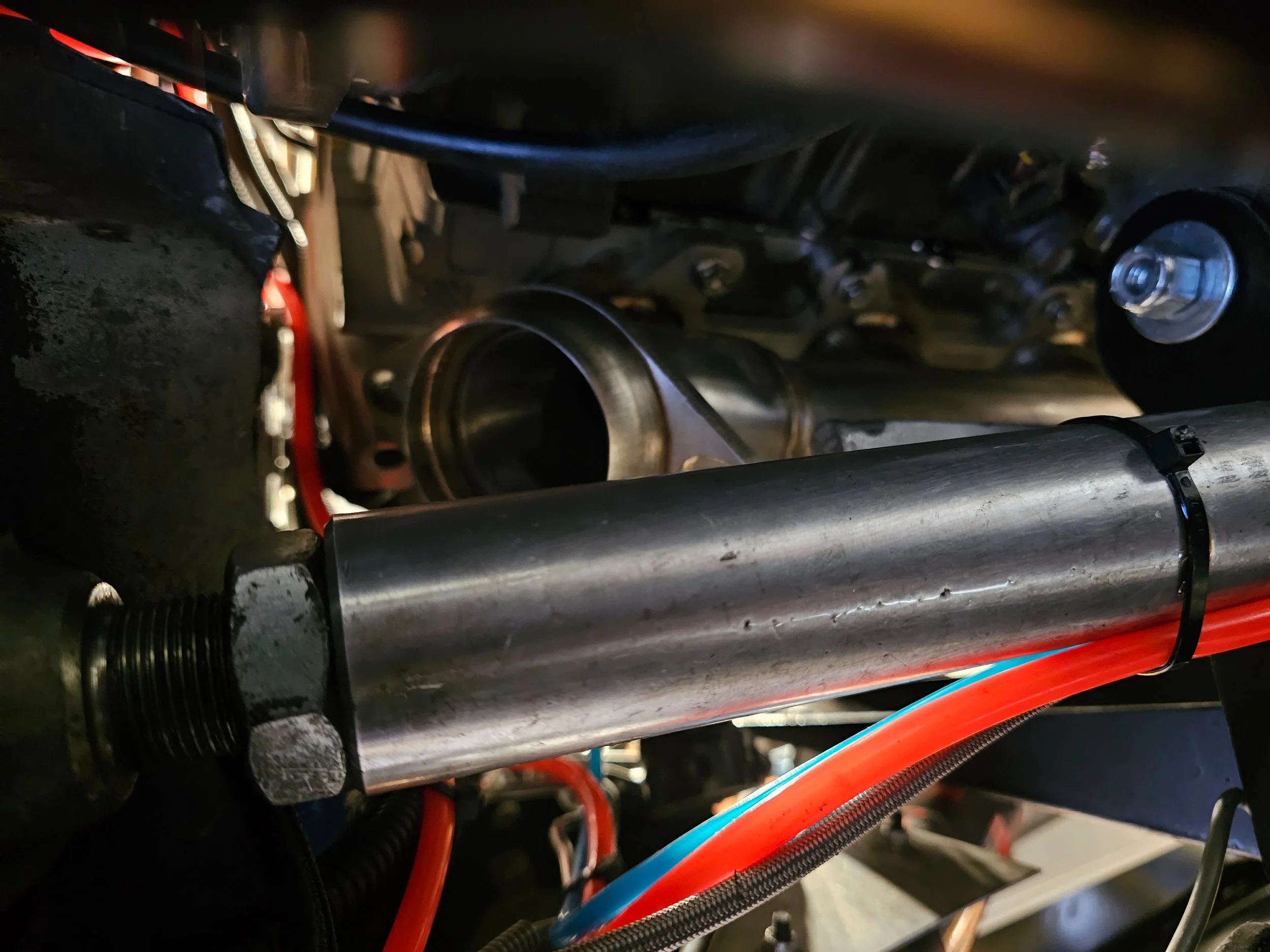

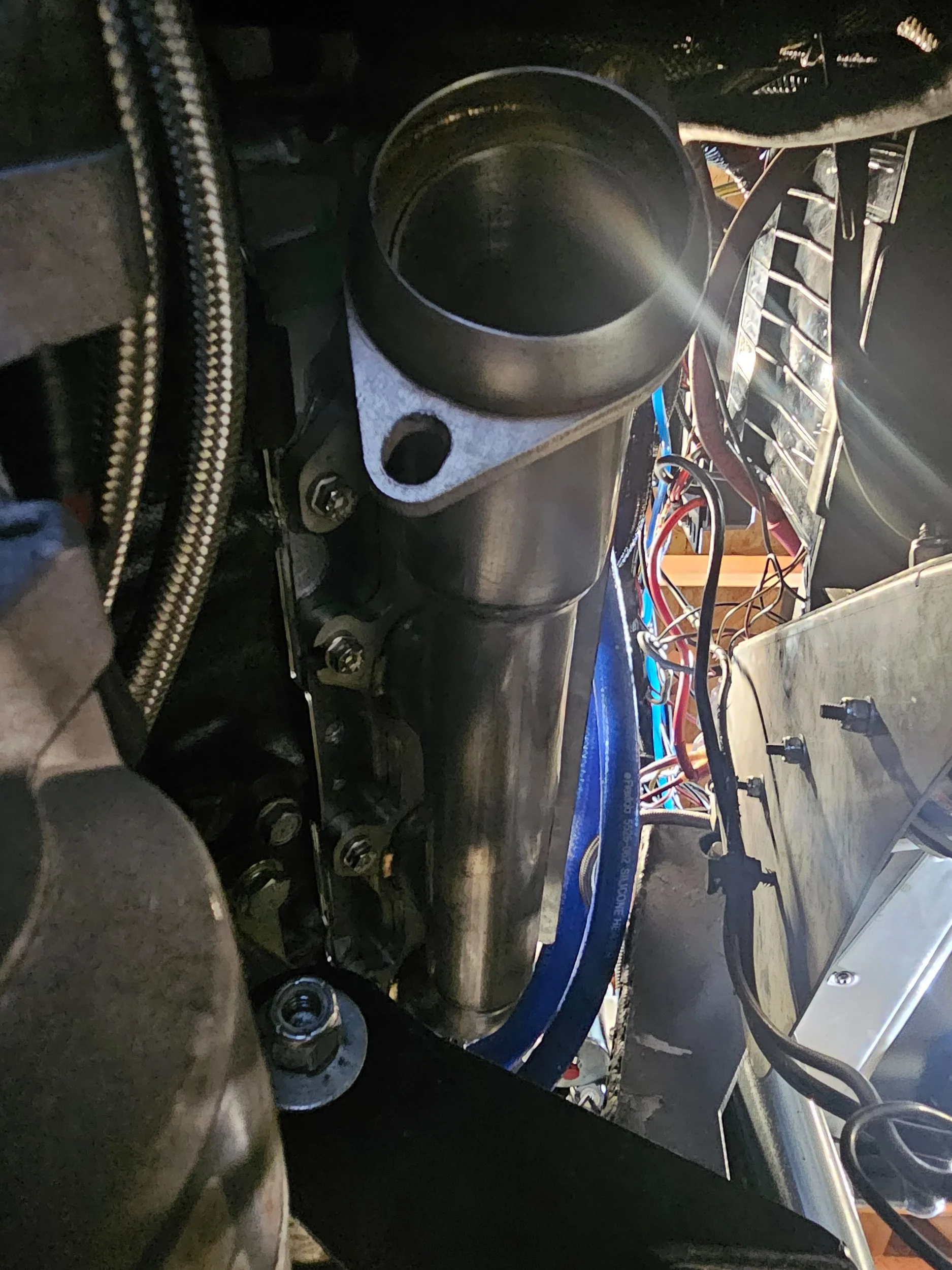

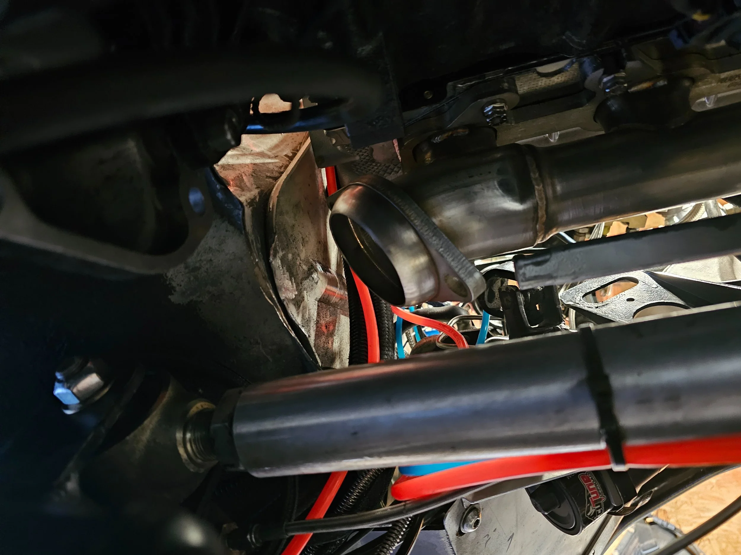

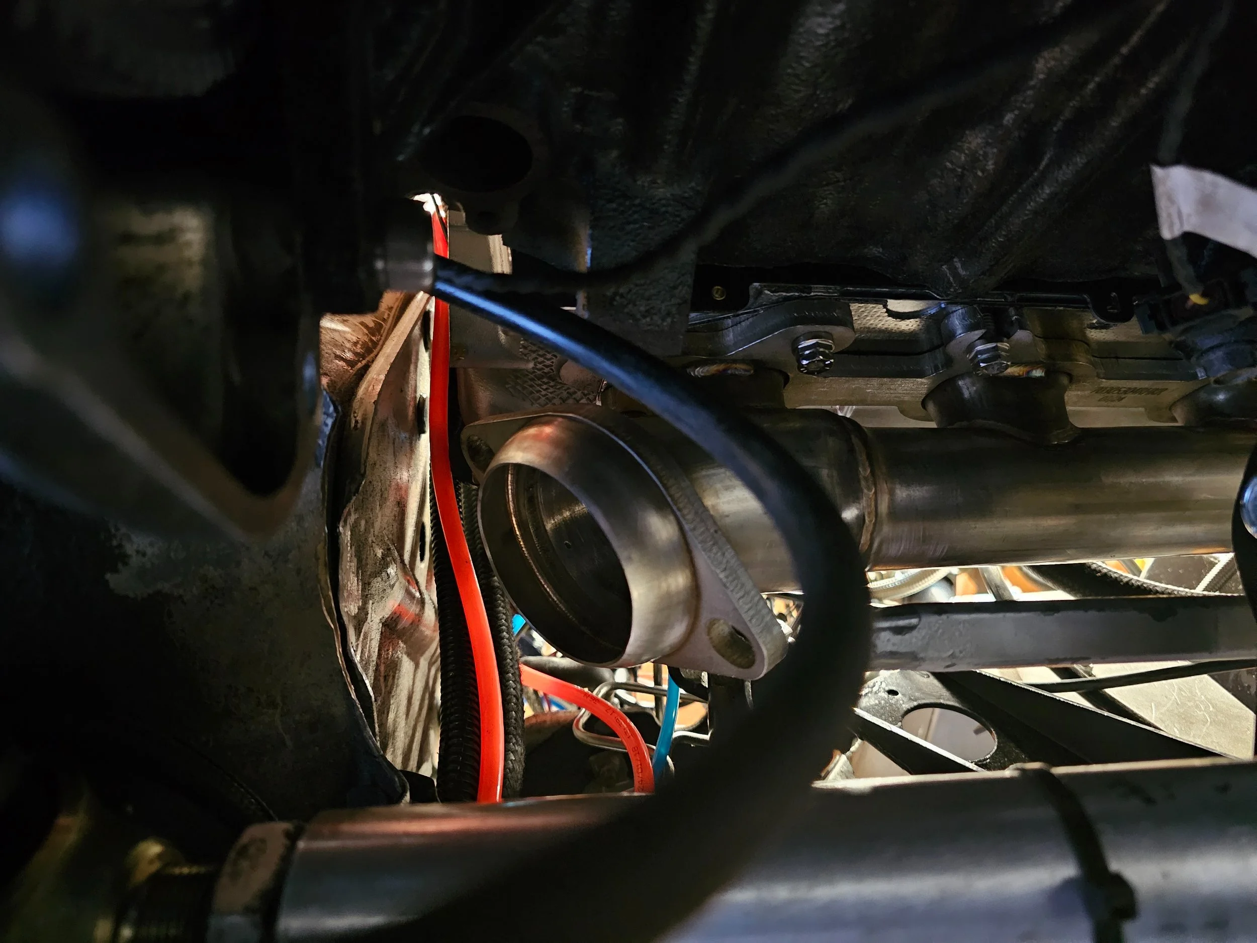

I'm going to start figuring out how to fish the drivers side exhaust over to the passenger side. But I like how it looks.
Stock exhaust bolts are torqued to 18 lb ft. But the instructions for these headers say 28-30 lb ft. I'm using the Stage8 fasteners and they say to follow the parts instructions.
