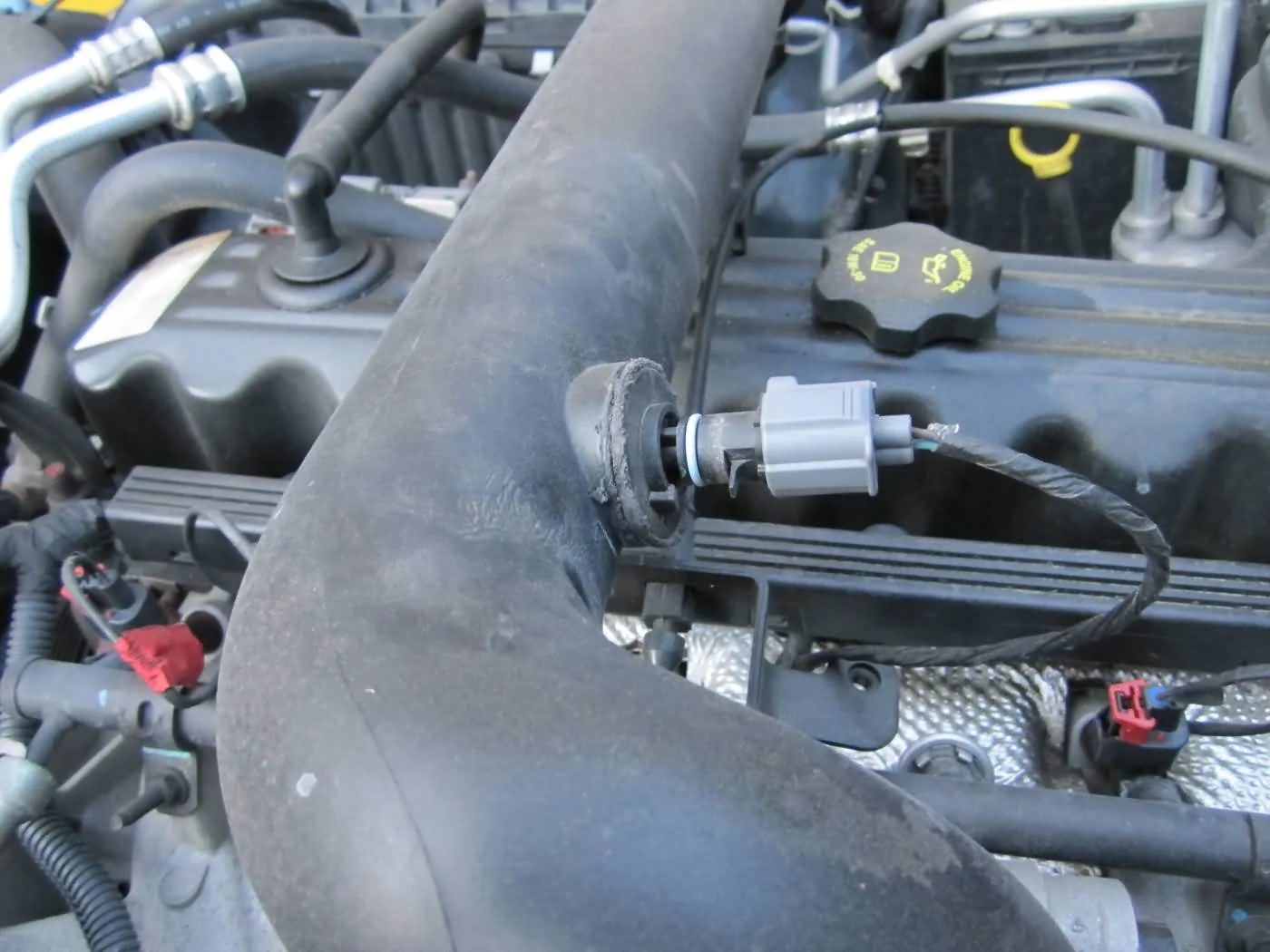

Anyone know what this sensor is? It's on the air intake tube on my 05 Rubicon. My Banks air intake doesn't have a provision for it so I'm curious to know if it's even needed or not?
Okay I found out this is the IAT sensor. From 97-04 these were installed on the intake manifold, but in 05-06 they moved them to the intake tube because apparently that was a more accurate place to get an air temperature from.

Yes the IAT sensor is definitely needed, go back to the OE tube. :)
Jerry, my TJ came with the banks air intake and my IAT plug has been unplugged ever since I bought it without me even knowing.
Oddly enough it runs just fine without it plugged in and has no CELs at all. However, I ditched the intake for the supercharger and went back to the stock intake tube so now my IAT sensor is plugged back in.

Not unless you know how to tune the pcm for the temp reading differences. This relates to your timing thread. The pcm uses intake temp readings to adjust timing and other things. You don't want to change positions and screw up your timing

It would be interesting to know the difference between ambient temp in the airbox or intake tube and at the hot manifold location. Air is going pretty fast through the intake so it's not going to be the so hot don't touch temp of the manifold. What would the expected result be from the PCM using a lower air temp reading to set parameters? Apparently Chris ran for some time with his IAT sensor just hanging in the engine bay somewhere with no bad result.
