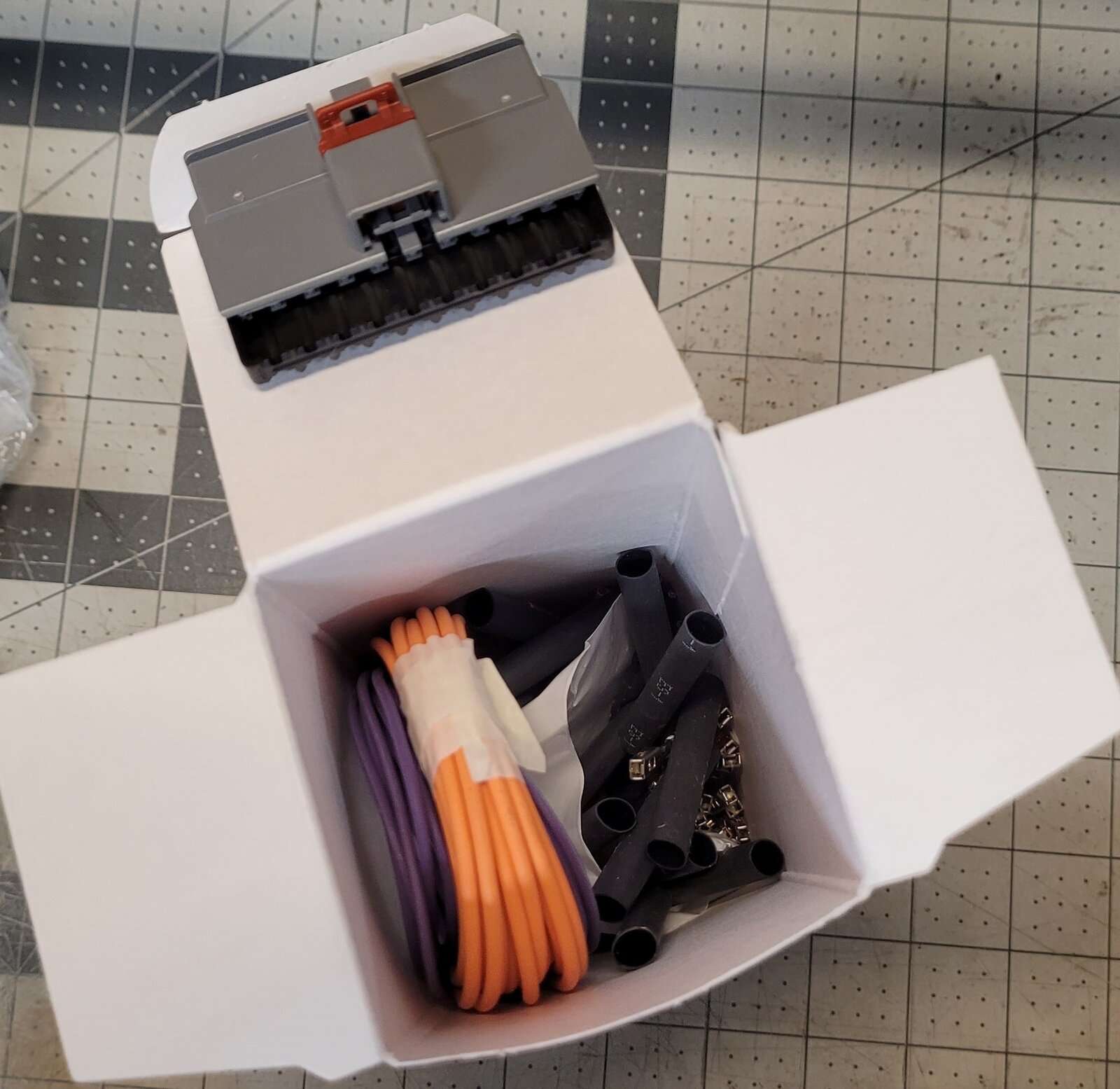

Connector:
Packaging was what I'd expect:
Switch:
Connector:

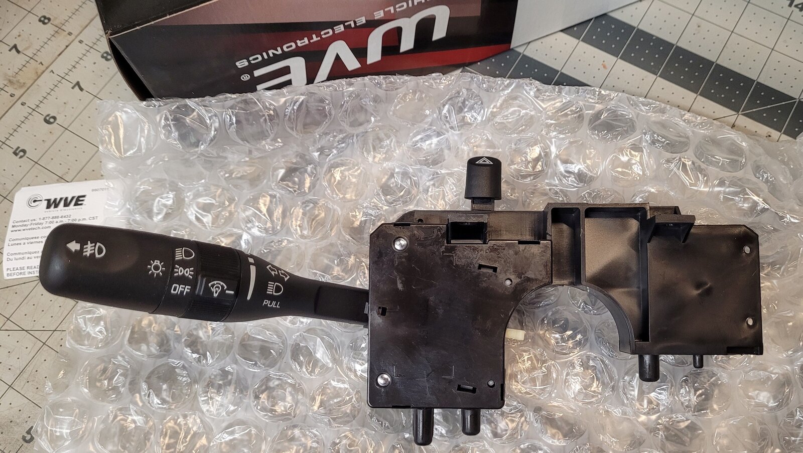

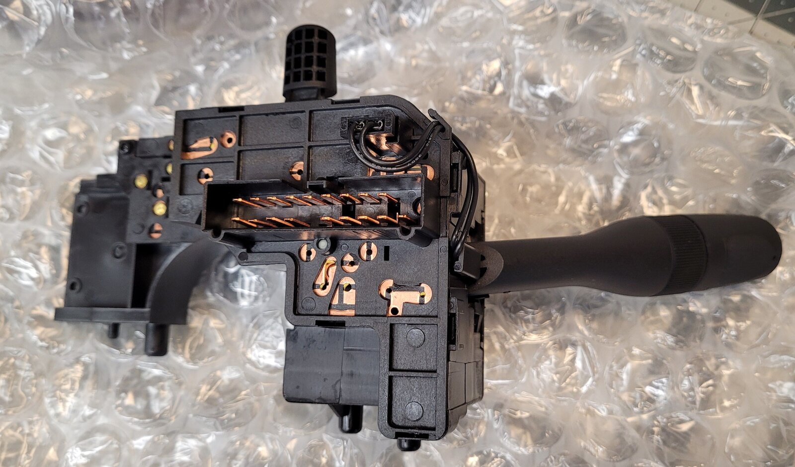

Here is the new switch:
Front:
Rear:

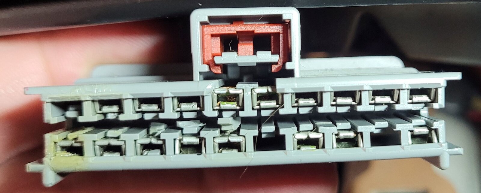

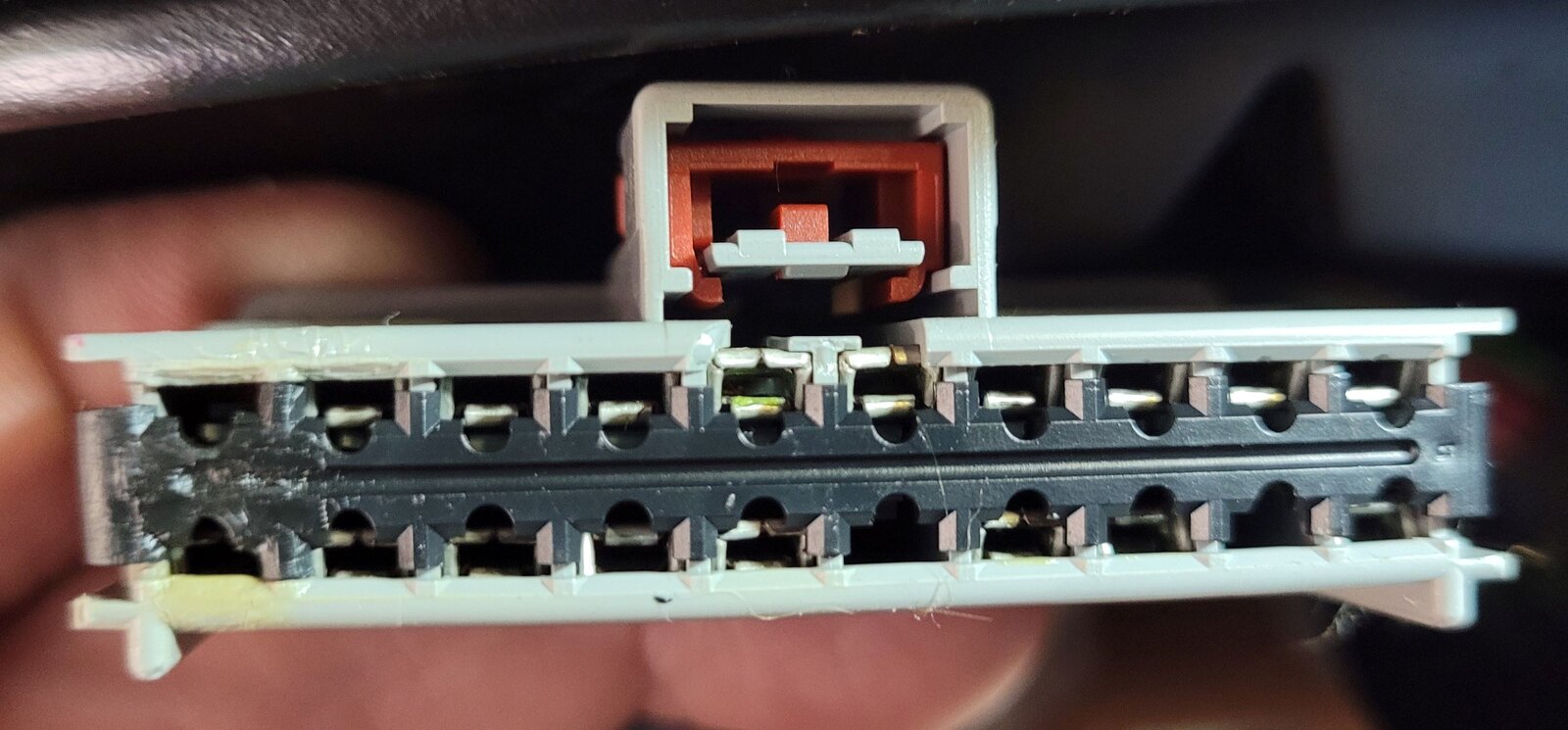

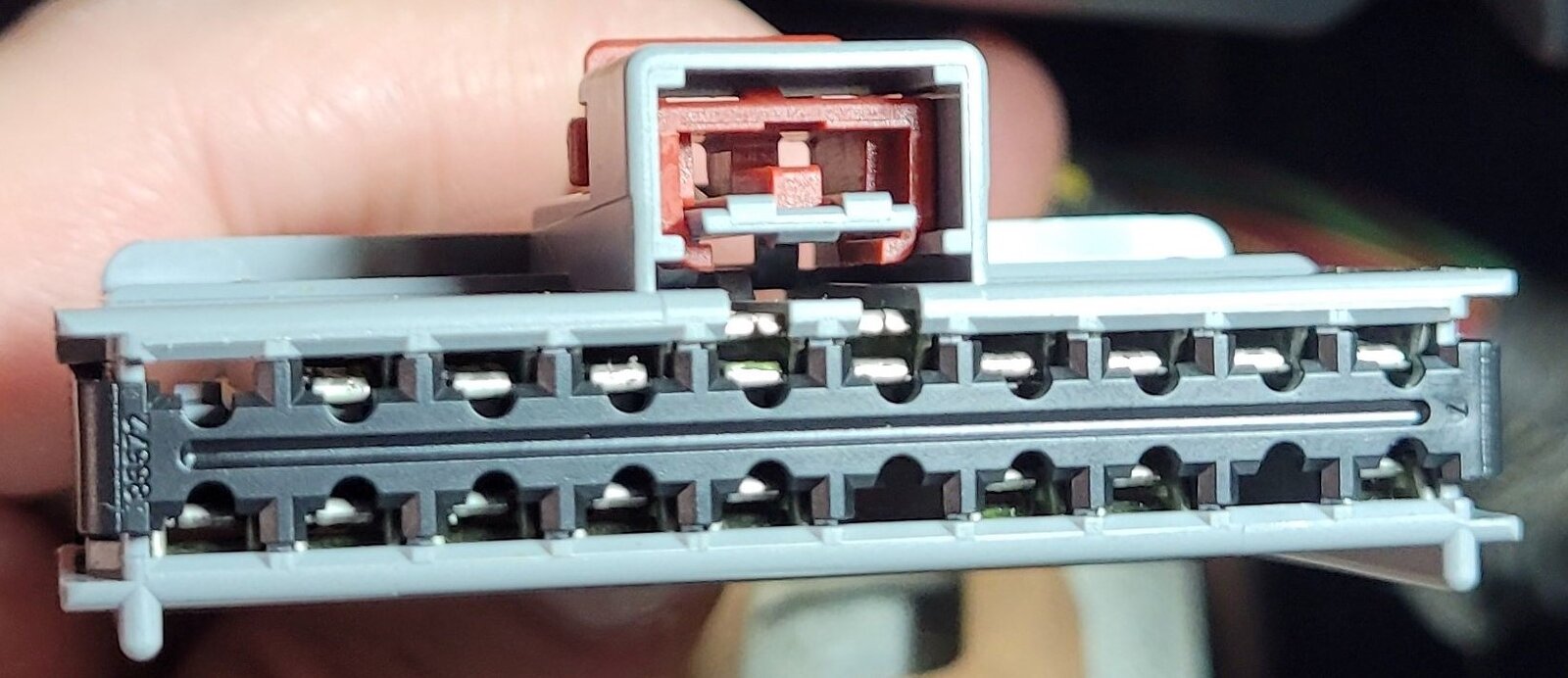

After opening things up and disconnecting the original switch I saw part of the problem, a melted and beginning to disintegrate connector.
Damaged connector:

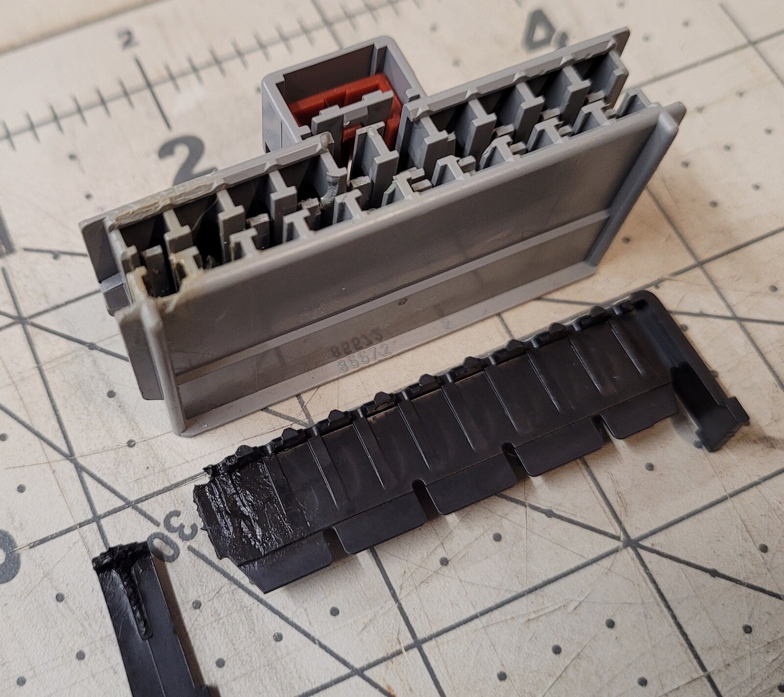

Here is another picture after I removed the black, clip-on face plate. It actually just snapped off at the melted side with slight pressure.
Signs of heat and several broken locking tabs:
Detail of the damage:
I used a small screwdriver to release each pin individually and reinserted them into the new connector one-by-one.
Here is the new connector, all pinned and ready for the new switch:

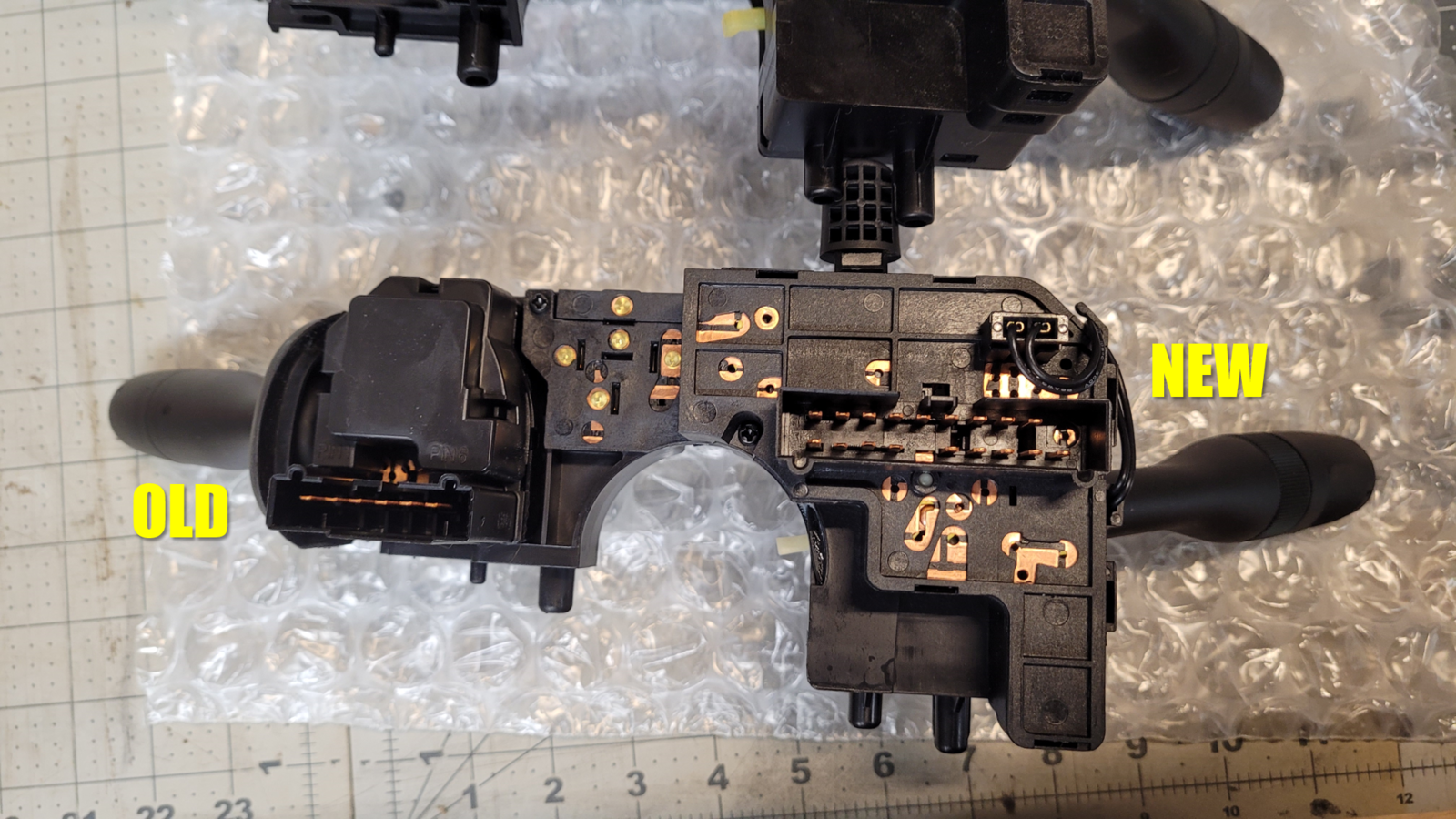

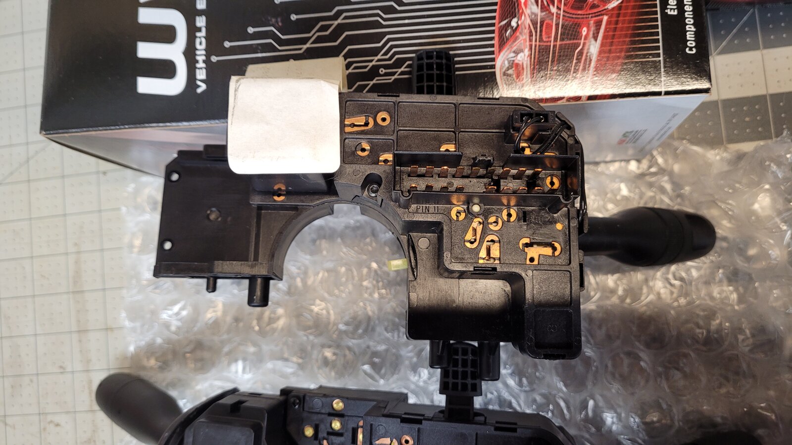

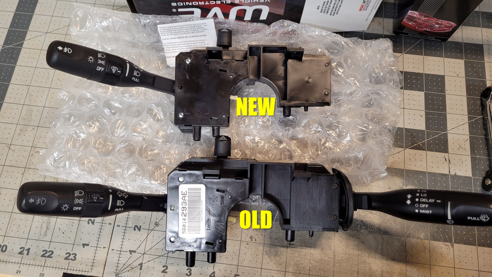

Over at the workbench I got the switch ready.
Here's a comparison of the old and new parts:

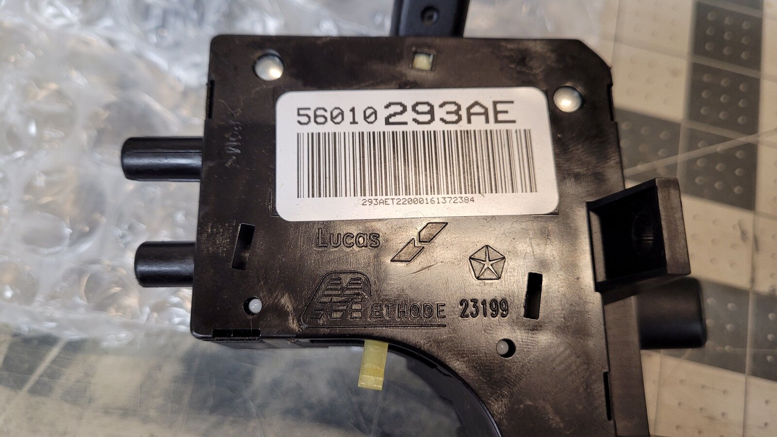

In case someone wants it, here's the detail on the OEM:
The original relay still had a label over it, so I kept it on when I transferred it.
Here the relay is still on the back of the OEM switch:
Here are the old (washer switch) and new (multi-switch) parts assembled:
During reassembly it all lined right up, no surprises in misalignment or odd sizing.
