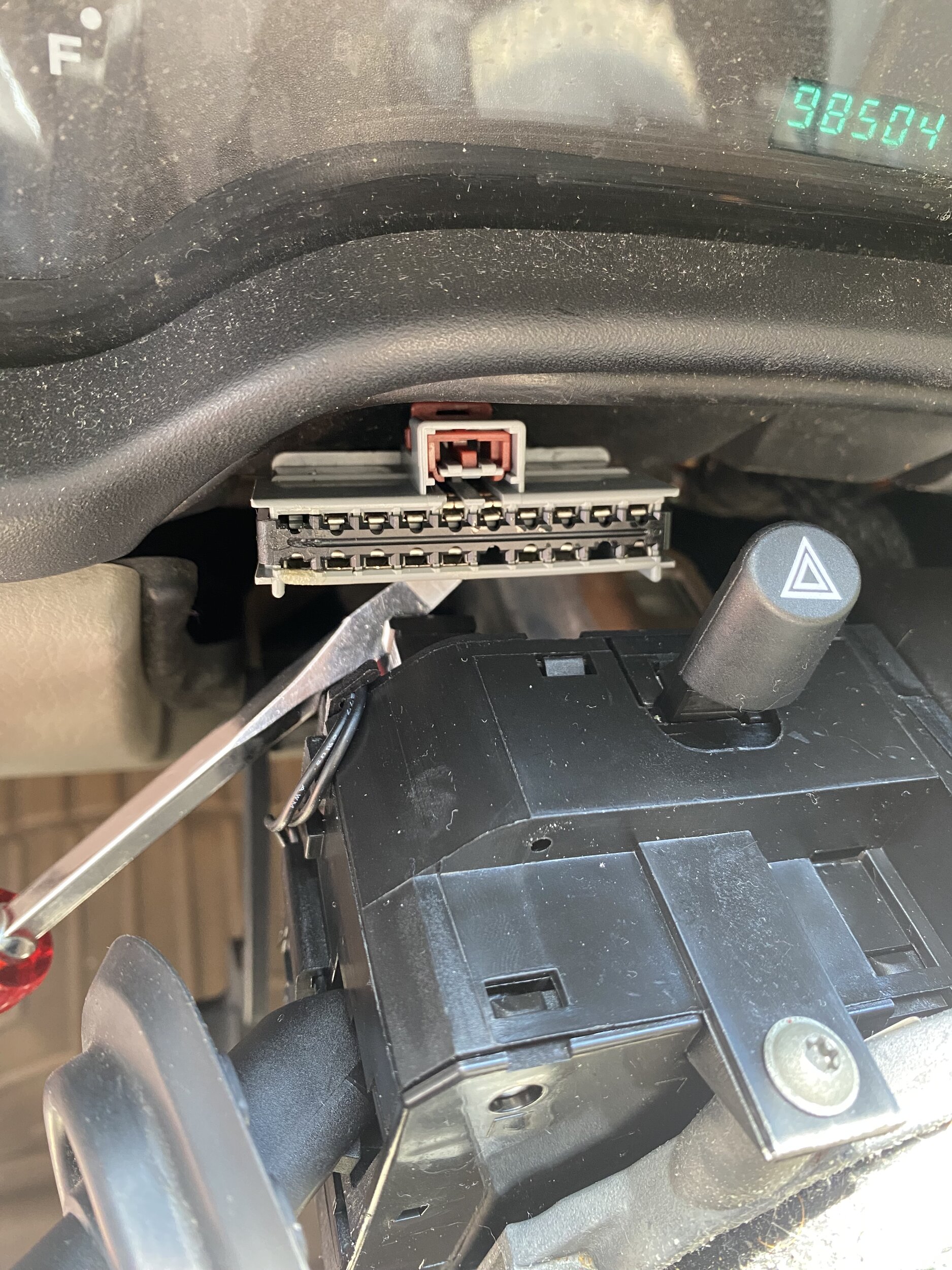

My 2004 TJ has started having an issue with the right turn signal. When I activate it, I get the fast blinking. If I turn on the headlights, the right arrow on the dash lights up and stays lit. I went around and checked all the bulbs on the right side and all appear to be good. Also, no corrosion on the sockets. My next thought was the multi function switch, so I replaced that but nothing changed. I noticed that there was some very slight melting on the plug that goes into the multi function switch, but I'm not sure if it's bad enough to cause this issue and need replacement. One other thing I noticed is that when the right turn signal is blinking, the front turn signal light is dimmer than on the left and when I have the headlights on, that light doesn't go on at all. Does anyone have a suggestion on what else I can look at for a cause?
